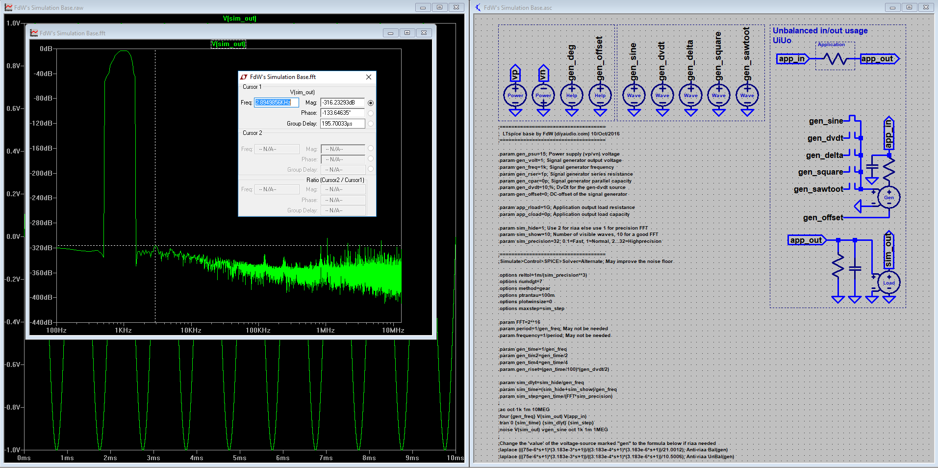

FdW, I get the impression you have some valid criticisms of how I do it based on your knowledge, but maybe you don't want to get into a discussion on it.
Here is what I currently have. I added a trtol line based on empirical tests to find out what seems to work best in empirical tests. Optimizing trtol can get you to -300db in many cases. It doesn't work well if you use more than 10 test cycles however.

You do not need to manipulate the 'trtol' parameter to get at -300dB.
I was working on a paper that I [once] liked to publish [Jan's magazine would not have been a bad place]. For this I developed a 'standard' [default simulation model] setup for low...high precision an high...low speed by changing a single setting.
I add the, current, version to this message, it combines many settings that I learned from reading this form and using spice [LTspice] for a long time. It is not perfect [and will never be] take it as it is and I will answer questions about it [if presented here].
It was posted [in an earlier incarnation] as part of this posting

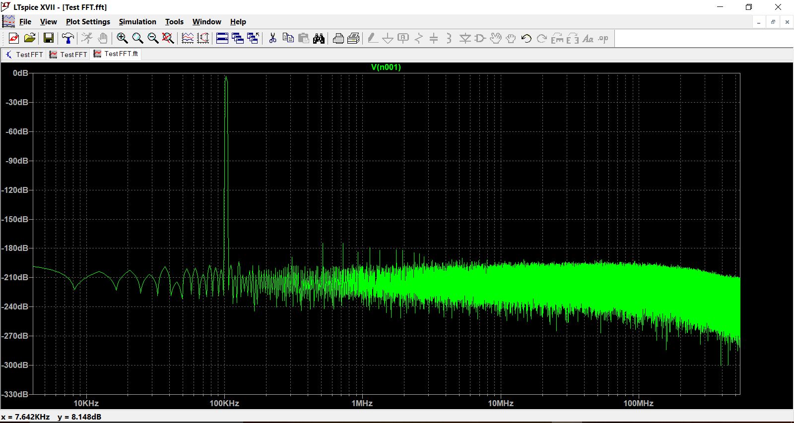

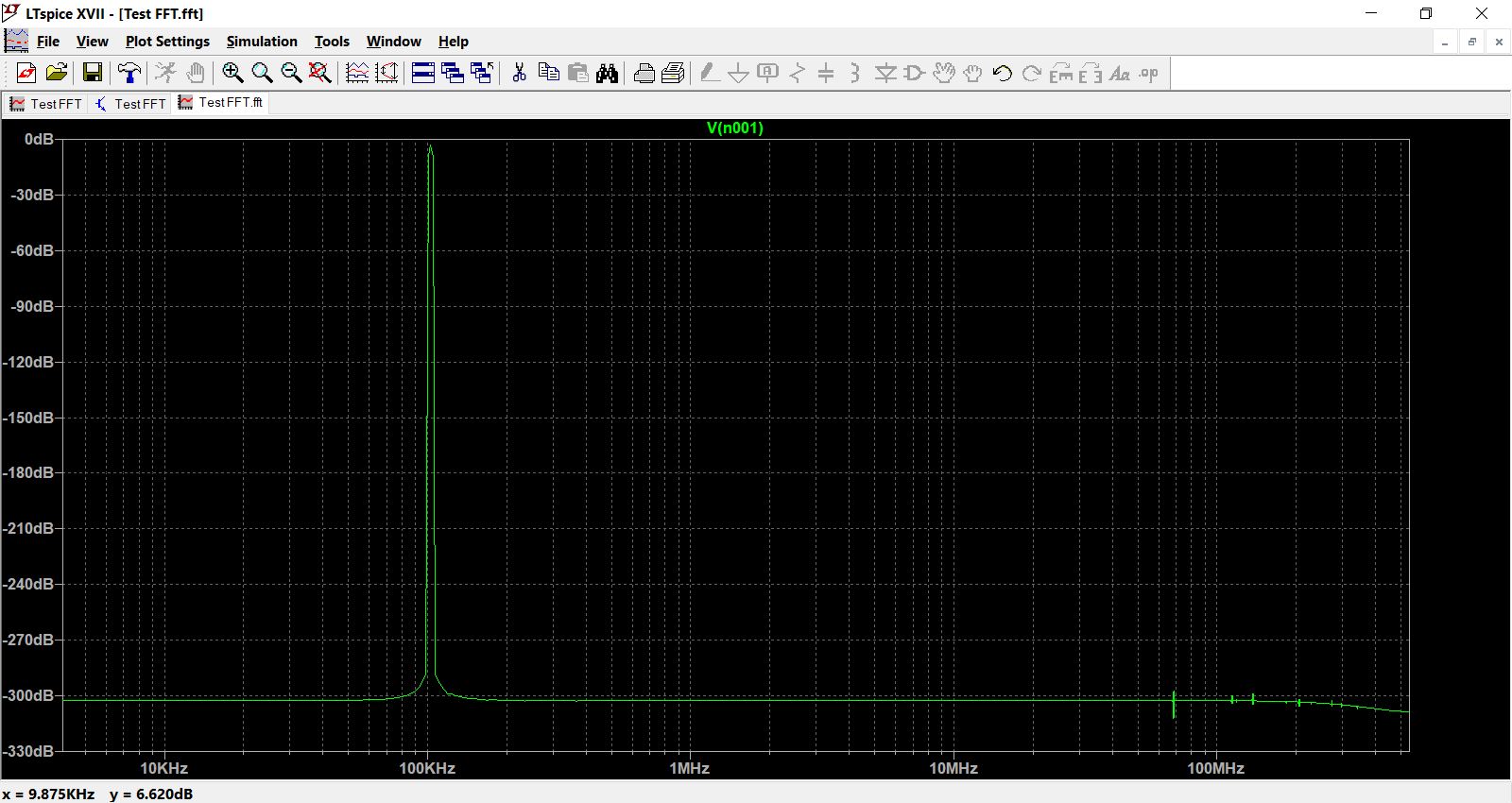

I've found the latest discussions quite interesting, and I'll admit my knowledge of applying many of these commands is very lacking, although the installed user manual gives a good description of many of them.

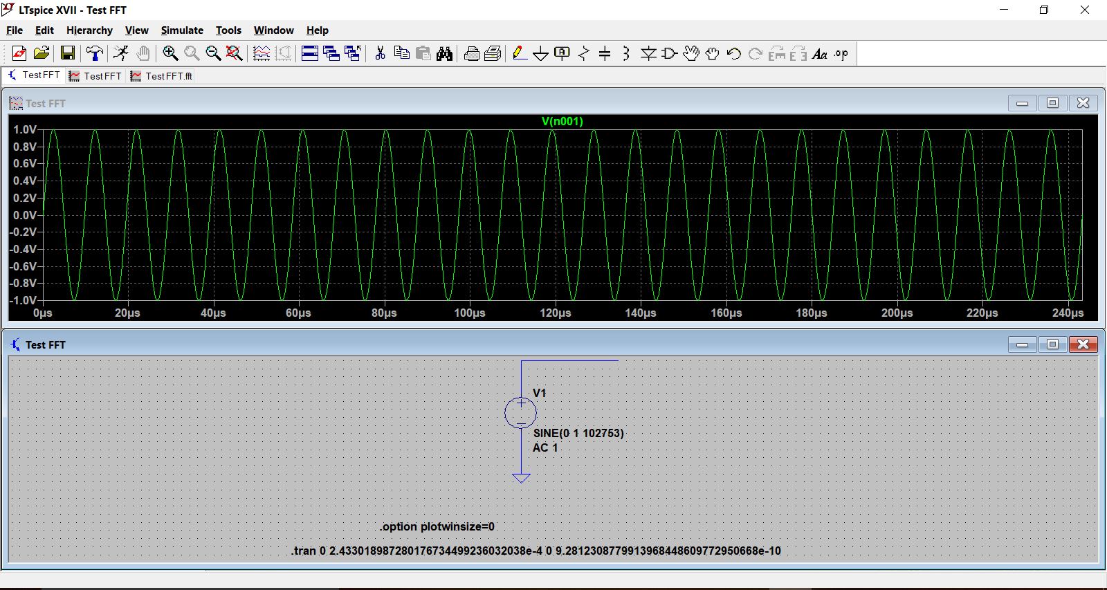

To try and get a handle on all this I picked an arbitrary frequency of 102753Hz that I wish to display for 25 cycles and to then display the FFT.
Using the 'longhand' method and opening Windows calculator it takes just a few seconds to calculate that the simulation run time needs to be:
2.433018987280176734499236032038e-4 seconds.
To set the timestep we just divide the above by 262144 (if we are using that value in the FFT) and get 9.2812308779913968448609772950668e-10
I'm using Windows calculator and so its easy to copy and paste the data directly into the sim.

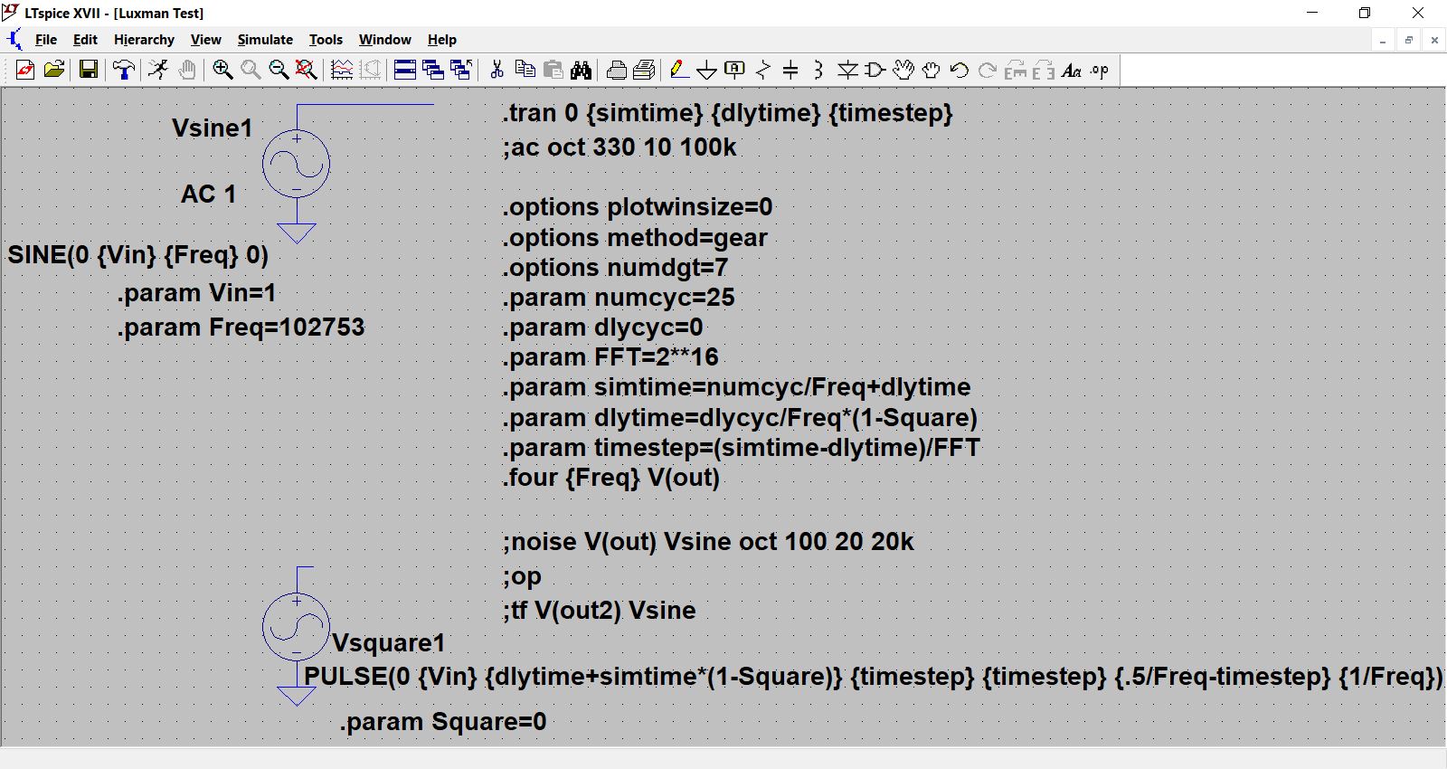

I also tried to make sense of these commands by lifting some of this from other sims I have found on this site. This shows the FFT of the same signal using the other method.

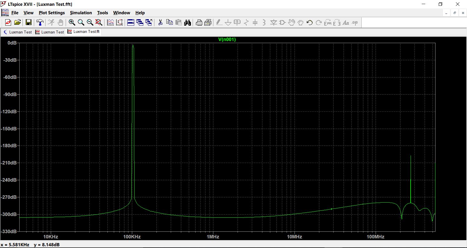

Last shot is the longhand method but with increased precision using the .options numdgt=7 command.
Hi Mooly,
A couple of things, it seems the desktop calculator uses an extended numerical representation since 64 bit IEEE floats (which SPICE uses) have at most 17 digit precision of the mantissa. Secondly your last plot seems to some kind of smoothing, just curious as to where that comes from an FFT of the output of the FPU's sin function has a noisy floor. IME sin(x) is identical across all computers and software packages to 15 digits (except of course special purpose ones).

Why bother, LTspice is perfectly capable of doing the math (to it's own limitations, lengths or precision [as Scott noted]).
I've no answer to that. The only difference between the last plot and the second plot is the addition of numdgt=7 option which sets LT to double digit precision.
Yes, I realise that I think my own limitations are part of the problem here, at least when anything involving mathematical concepts is concerned.
Mooly, you need to have an actual circuit in simulation to get valid results. The integrator behavior will change completely once there is actually something to simulate.
Thanks, that's actually sort of next on the list because I realise that when we are talking of a base level of -150db, -200db and particularly -300db we are down at the kind of levels you might get trying to pick up Voyager
