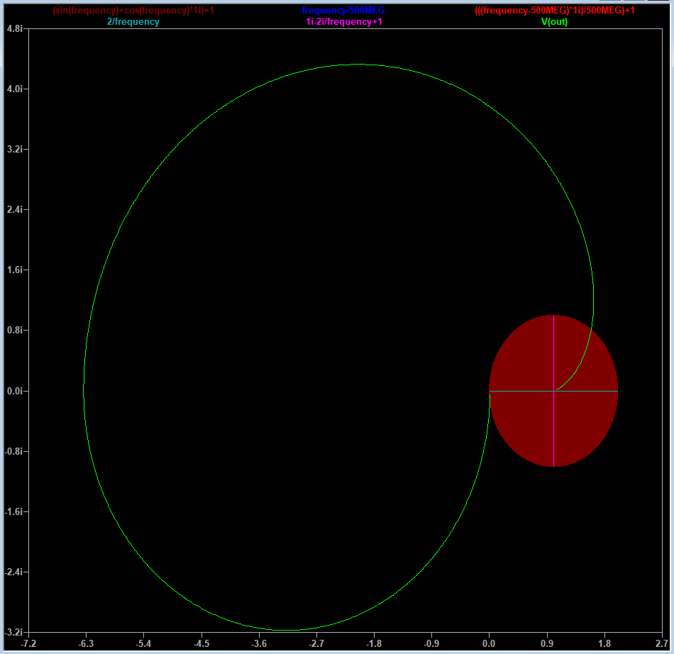

Another one for you if you are bored: How can I plot a circle on the Nyquist plot. Background: A circle can have a diameter corresponding to a certain gain magnitude. If you then draw circles for say 3, 6, 9 etc dB, you can immediately see the gain margin because that is the circle that the curve touches when crossing the real axis. See attached as example (from a 1954 (!) book by Crowhurst).

As we know, the points on a circle are defined as x = cos(theta) and y = sin(theta) where theta varies from 0 to 2*pi.
In a Nyquist plot x is the real and y is the imaginairy axis.
How do I put this in LTspice??
It would be easy in MatLab...
Jan

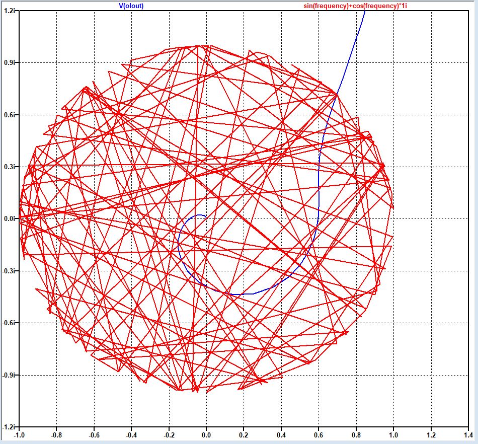

Add this 'sin(frequency)+cos(frequency)*1i'-trace and you will have a circle 🙂
But it is opaque, so you should draw it as first and all others will draw on top of it.
If you then select a dark color, it will look fine

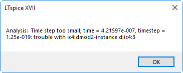

Time step too small...
Hi. I'm trying to implement your system but must be missing something in the instructions.
I've copied your .options .param and .tran verbatim
When I run the simulation I get the error message "Time step too small..."
I've attached a screenshot of the error and model. Tried changing the engine to "Alternate" as mention in a posting related to this error but the simulation runs extremely slowly.
Would you be able to take a look please?
Thanks!

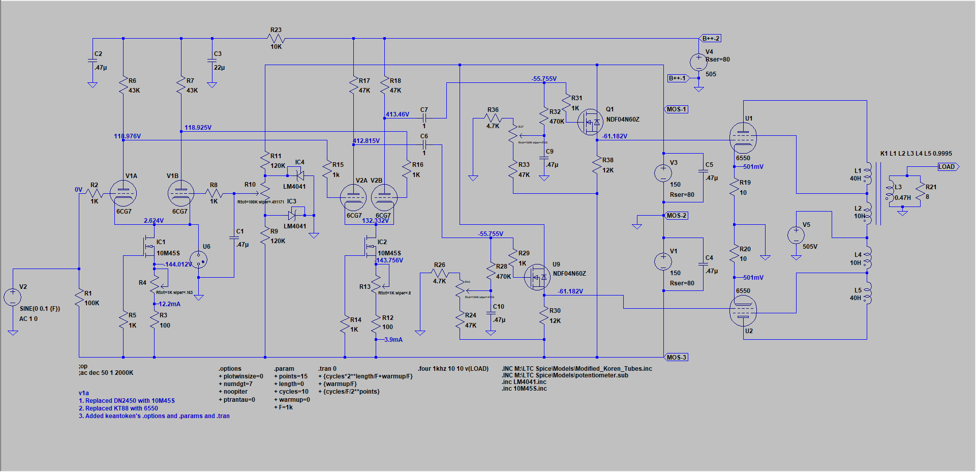

Here is what I have come up with to try and consistently get -300db noise floors.

The problem appears to be that I made the capacitors way too high to correct the FFT as per the tutorial starting at post #19.
Returning them to 0.1uF results in the sort of FFT depicted in the tutorial.
If I try 100uF the sim to runs glacially.
What is the solution here?
That's interesting Frans! I realized that a circle would be x = sin(phi) and y =cos(phi) but didn't know where to get the phi. Your use of freq instead puzzles me a lot, but hey, if it works it works!
I'll check it out,
Edit: It gets more and more artsy, special for Anthony...;-)

Resoution to capacitor size issue
While LTSpice is happy with a capacitor value of "0.1u" it isn't happy with "1".
I have found that if I specify my capacitor value as "1F" the simulation runs normally.
