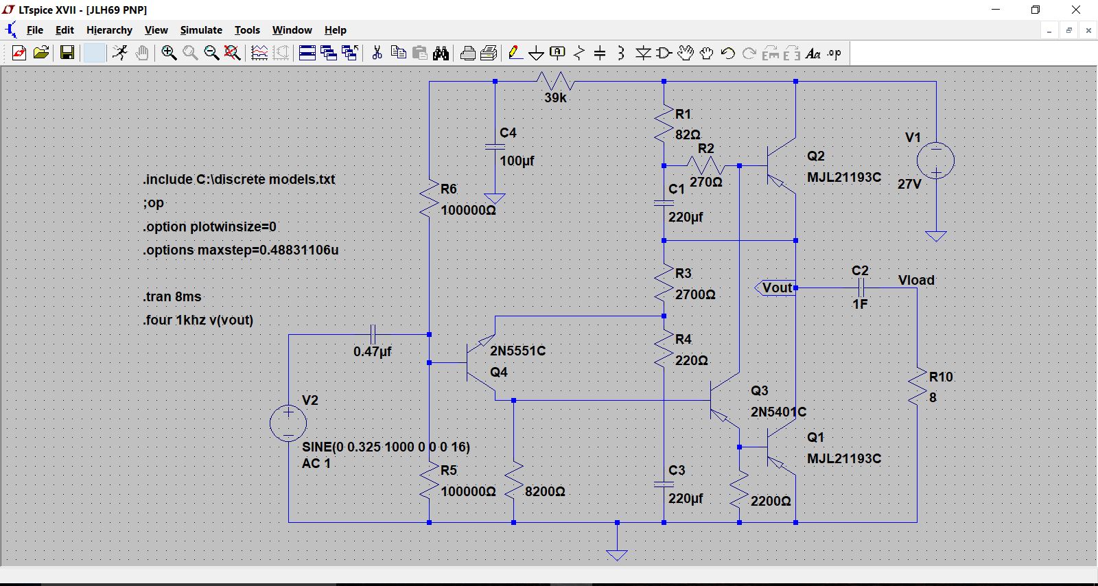

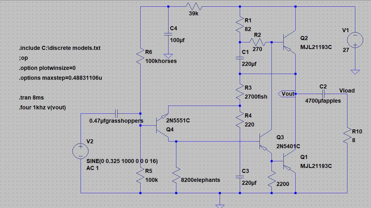

OK, basic questions and something that bugs me. Units!
LT seems to have a problem with F for capacitance. I noticed this a couple of years ago and didn't realise what was happening.

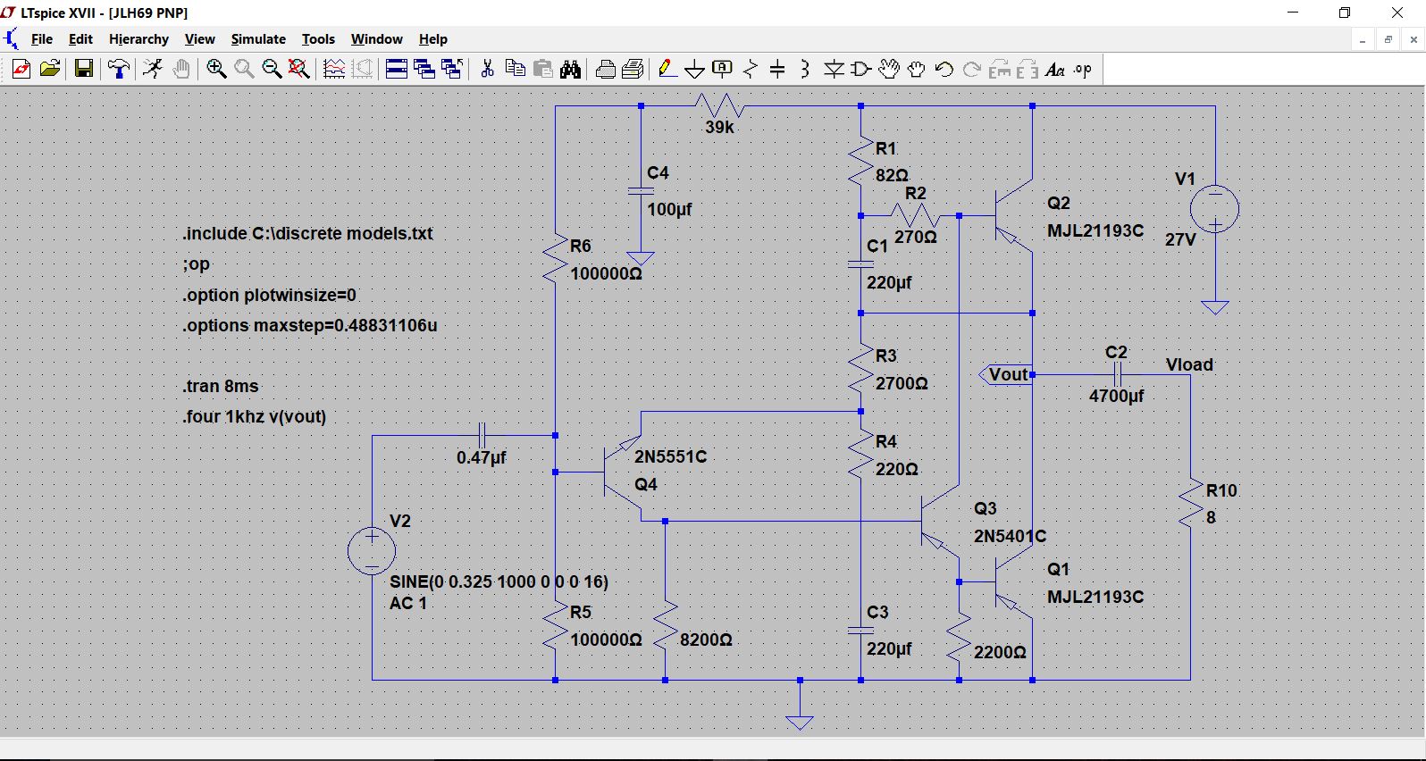

For example, to remove the time constant of a large electrolytic to get a more accurate FFT I can make the cap massive. So a 4700uF speaker coupling cap becomes 1F, and it doesn't work. 800,000uF works but not 1F.

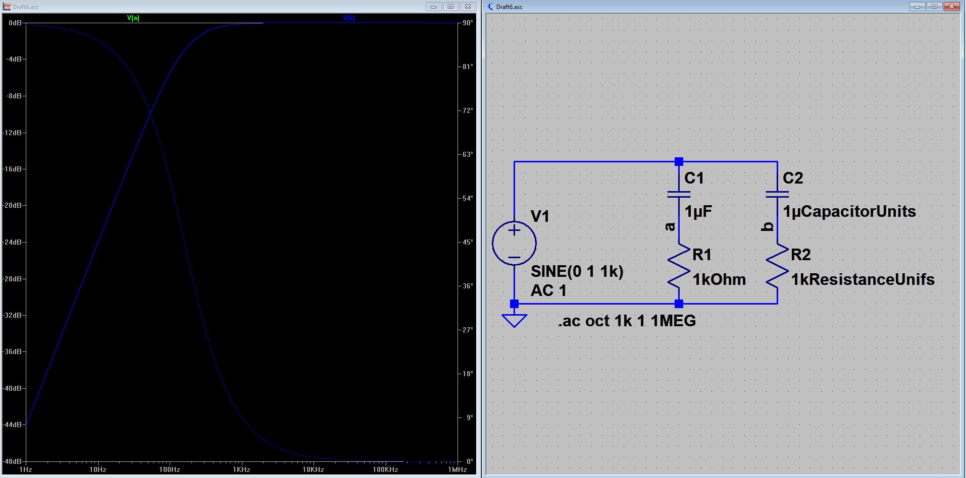

I only twigged the other day that 1 (for 1F) will work or 10 (for 10F) will work, but add the basic unit 'F' and it doesn't.
So I tried it for ohms and volts and found those are accepted. But not F.
The first sim works (ohms and volts added)

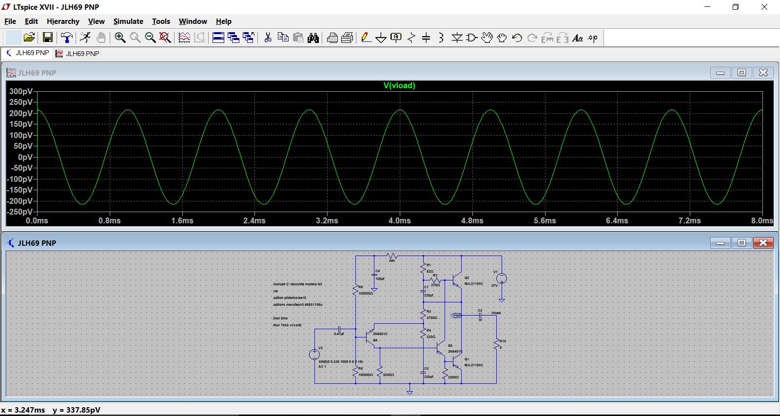

The second sim with a 1F speakers coupling cap does not run. The AC output voltage is a few pico volts. If I make the cap '1' then I get the full output voltage as expected.
It seems 1F actually equates to 1 femto farad.
Am I missing something

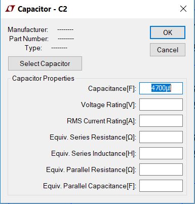

See http://cds.linear.com/docs/en/software-and-simulation/LTspiceGettingStartedGuide.pdf page 23
Use Labels to Specify Units in Circuit Elements Attributes
‹ K = k = kilo = 103
‹ MEG = meg = 106
‹ m = M = milli = 10-3
‹ u = U = micro = 10-6
‹ G = g = giga = 109
‹ T = t = terra = 1012
‹ n = N = nano = 10-9
‹ p = P = pico = 10-12
‹ f = F = femto = 10-15
Important
Use MEG to specify 106, not M
Enter 1 for 1 Farad, not 1F
