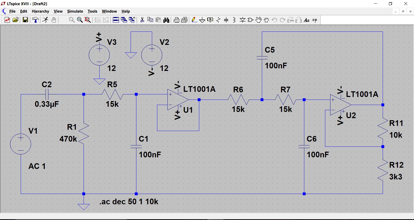

Attached is a random circuit file. Does this open correctly ? It should look as shown below.
That only works for the wire and ground, not the resistor and the rest

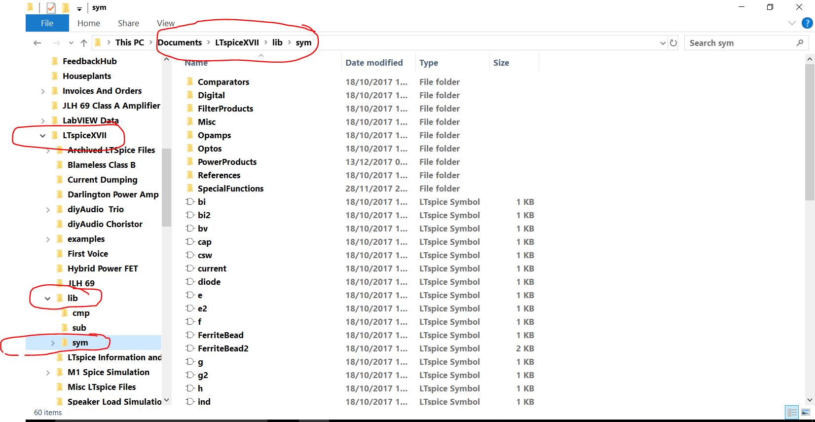

Yeah you're probably right. It's working now. There where two folders one in Documents and one in Program files. The folder in documents had nothing so i just copied everything from the LTSpice folder in program files to that one and it fixed it. Thanks alot.Perhaps dayveed1 should start his own thread instead of cluttering up this tutorial thread?
