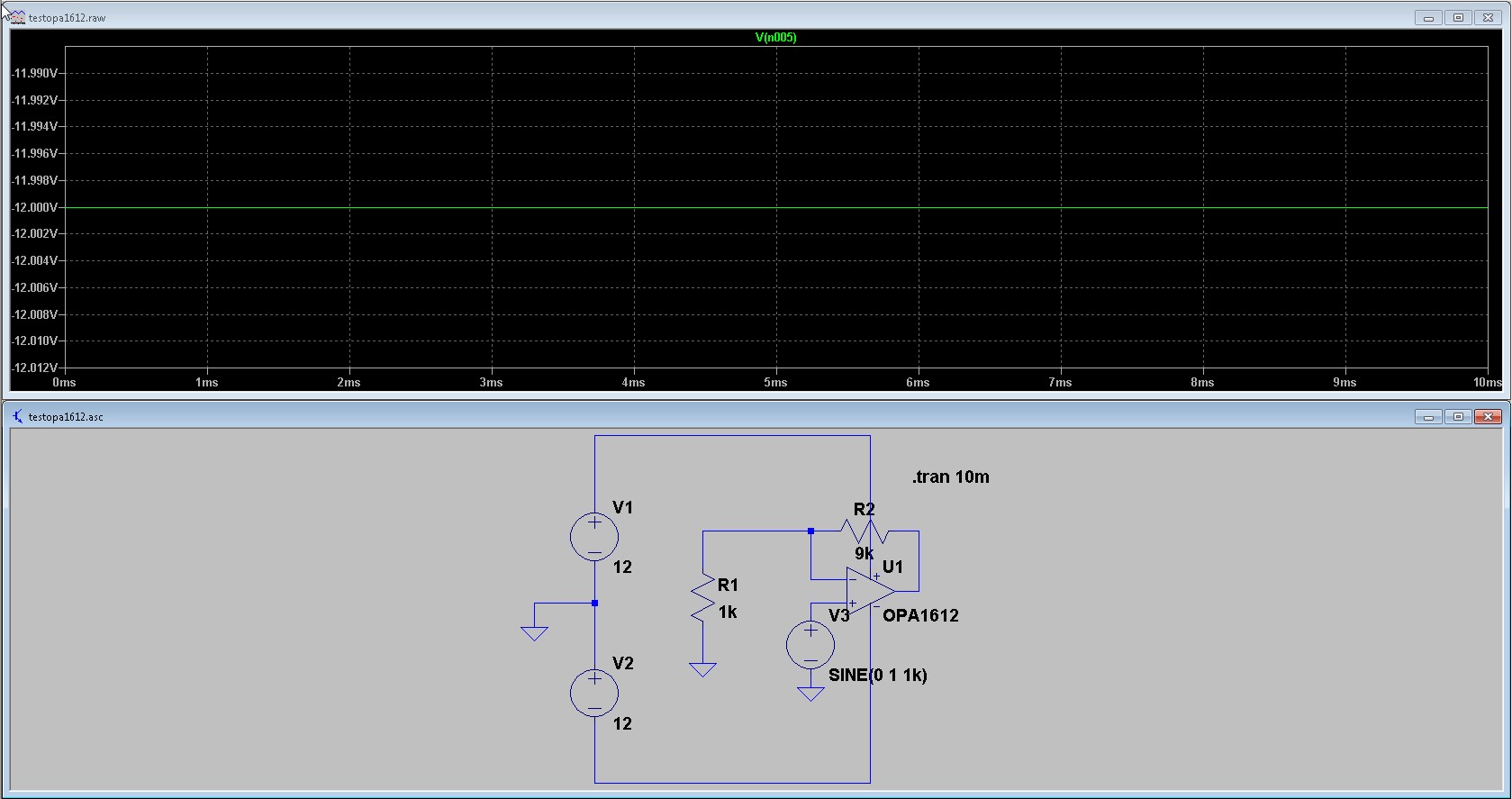

Wel it do, except in the old version.
Do not understand why the model has other pin numbers then the part itself, who do use 1, 2, 3 ,4 ,5 while model says 3, 2, 4, 7, 6 for example, change that this way I get the error back..
regards
LTspice goes by the pinout order, not the specific pinout / node names.
Pinout 3 = Pinout Order 1 (+IN)
Pinout 2 = Pinout Order 2 (-IN)
Pinout 7 = Pinout Order 3 (+V)
Pinout 4 = Pinout Order 4 (-V)
Pinout 6 = Pinout Order 5 (OUT)

You're correct, thanks, why didn't I think of that? 😀
Your not alone. 😀
Oke thanks, now I now how the pinout order works, LTspice looks at part pinout order, and looks to names in stead op pins in lib, or both.
But still, the model do not work in 32 bit version, maybe the 64bit is capable to read more kinds of models.

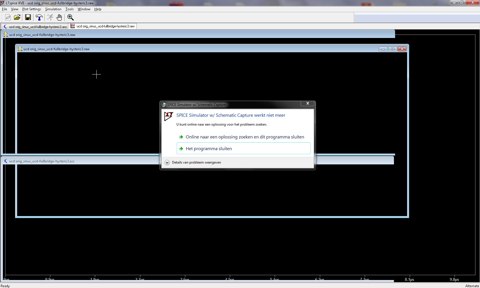

And the 64 bit do crash, I can not sim with it sithout crash, sometimes it crasg right away when simulate or after 2 minutes or less.

The new version of ltspice do crash on the moment it start graph, there is a bug, or it is a problem with the audio card, I have removed it and back to old version, these crashes is never be repaired, but crashing all the time is quite annoying.

I had contact with the writer of LTspice 64 bit about the crashes, I did capture it, seems it opens two .RAW windows at once and then crash, if I leave it open software do not crash.
This was his answer about it.
Very interesting. I review the code opening the .raw file....
So maybe it is corrected soon.
