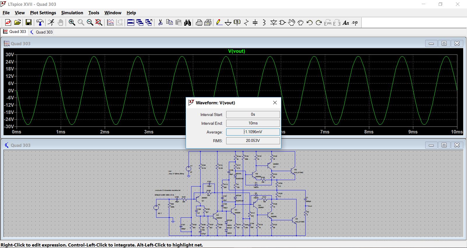

Thanks again Mooly - very useful link, which I have bookmarked. Thinking more, I suppose the averaging system in Spice is to allow for the complex (non-symmetrical) waveform for which the "0.637" function is not appropriate, but then you always have the option of selecting the part of the waveform you want averaging. As long as you understand what's going on - which I now do, so thanks!
Hope you won't mind me asking another (possibly related) question. I am doing power dissipation thinking re thermal design. My 303 sim. gives me a 0-50W sine wave at the load (presumably a plot of instantaneous value). Taking an average by same Spice method, I get ~26W. Which of these is the figure I should be using as the starting point for thermal calculations? What does the 26W average given by Spice mean in this case?

I can't even get 50 wrms/8ohm from my sim, at least not unless I increase the supply a few volts.

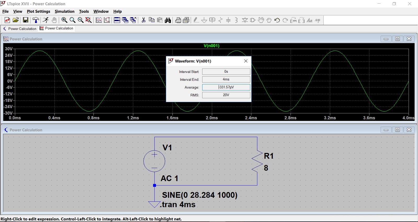

Here is a voltage source set for 28.284 volts peak which is the same as 20vrms which would give 50 wrms dissipation in the load.

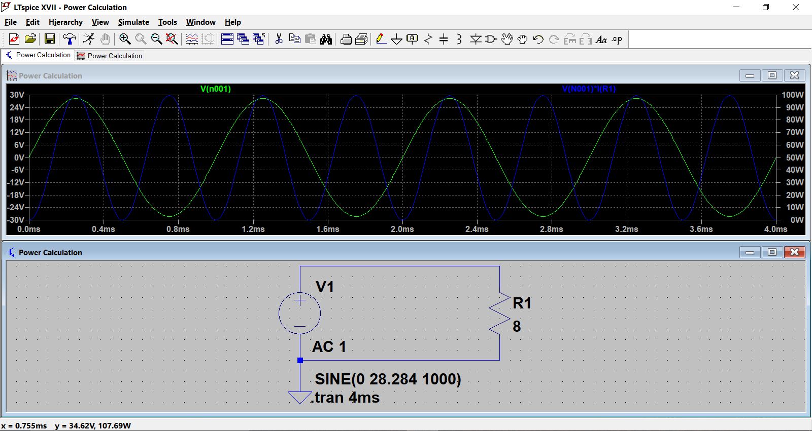

If we now hover over the resistor and click 'ALT' and left click we get a trace of what LT call 'instantaneous power dissipation' which is amps times volts in the part concerned.
The peak voltage is 28.284 volts which gives a peak current of 28.284/8 which is 3.5355A
Multiplying those out gives a power of (3.5355*3.5355)*8 which is 100 watts.
So LT is correct and the instantaneous power at our chosen sampling point of the peak voltage works out.
The 'RMS' power is 50 wrms based on the rms voltage and load impedance.
