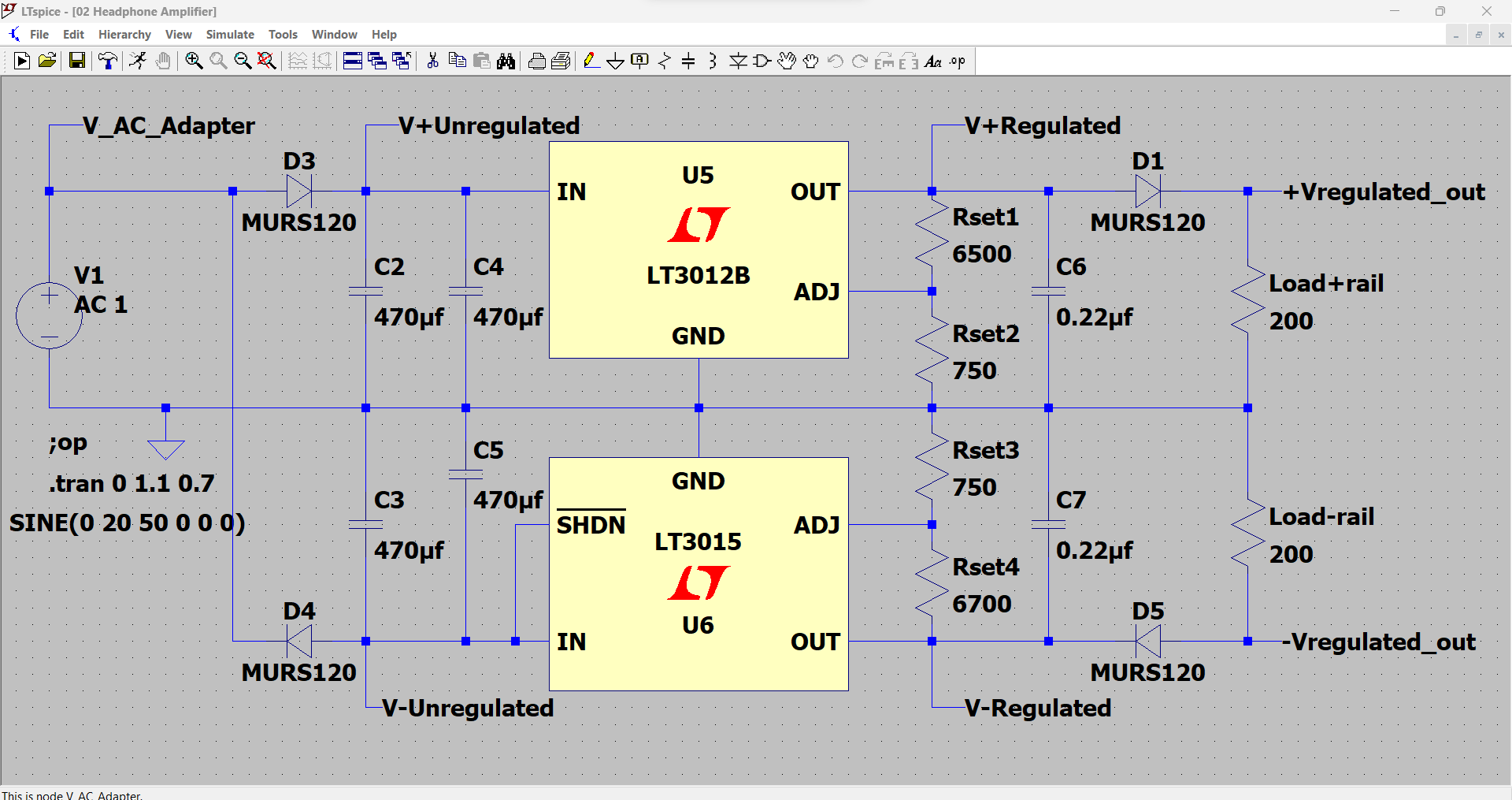

This might be easier if it does what you are after, use the LT3012 and 3015 models.

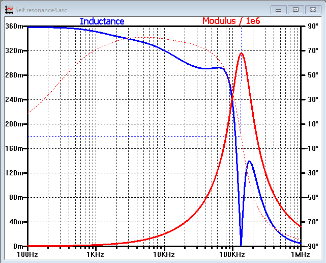

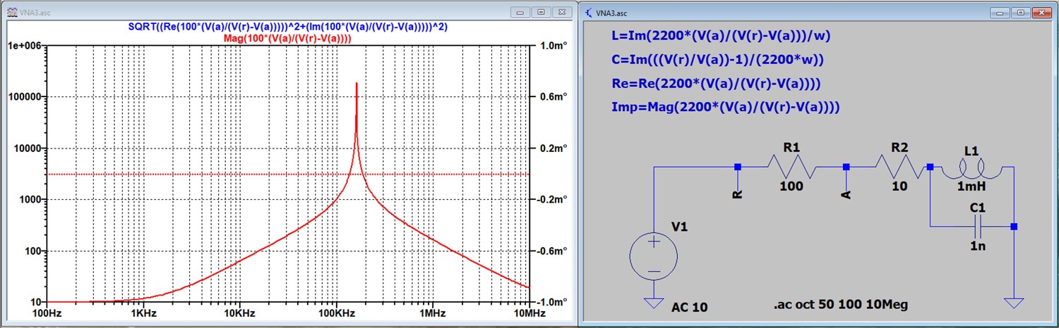

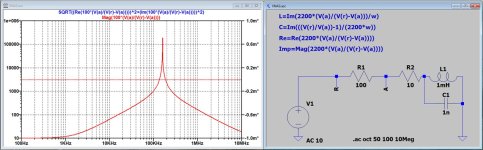

I have a phase problem in the current LTSpice XVII release that was not there in the past.
See attached diagram, a sim for a complex impedance.
Steering it the way a VNA does with a serial resistor an taking the signals from point A and R, one can get all the information, like value of inductance, capacity, resistance and impedance.
Here it is where things are going wrong.
For impedance the command "Mag" can be used, which in fact in Sqrt(Re^2+Im^2).
What "Mag" produces in the current LTSpice version is a correct impedance, but the phase is zero.
When doing the SQRT version, outcome is the same, still with zero phase, exactly on top of the Mag lines.
An older image is also attached from a different circuit, with the phase visible in dotted red, just as it should be.
When repeating the sim today for this model, the phase becomes zero, but the magnitude or modulus is correct.
Hans
Re(), Im(), Mag() and Ph() return real values by definition, according to the help (for Version IV, as I don't use the broken newer versions). LTspice stores them as complex values with phase set to zero in order to keep the data format the same (no actual domain change).
"The functions Re(x) and Im(x) are available for complex data and
return a complex number with the real part equal to the real or imaginary part
of the argument respectively and the imaginary part equal to zero. The functions
Ph(x) and Mag(x) are also available for complex data and return a complex number
with the real part equal to the phase angle or magnitude of the argument
respectively and the imaginary part equal to zero."
Deriving full impedance -- with magnitude and phase -- with a mag() function seem wrong to me anyway as impedance is complex but mag() never is.
I'd simply use V(a)/I(R1)

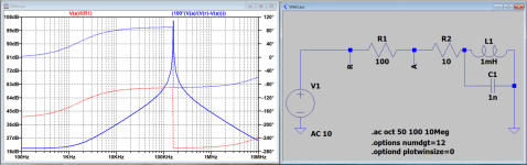

KSTR, Thx for taking the time to answer my question.
And yes, you are right that taking V(a)/I(R1) should give the right answer.
By the way, V(a)/I(R1) is mathematically exactly the same as the used R1*V(a)/(V(r)-V(a))=R1*V(a)/(I(R1)*R1)=V(a)/I(R1)
So in future I will simply leave the "Mag" in front of it, an operator that always gave the correct phase in the past.
Who needs the magnitude of a complex impedance without a phase, and also sqrt(Re^2+Im^2) should have given the phase, but it didn't either., so I don't see any use of this "Mag" operator any more.

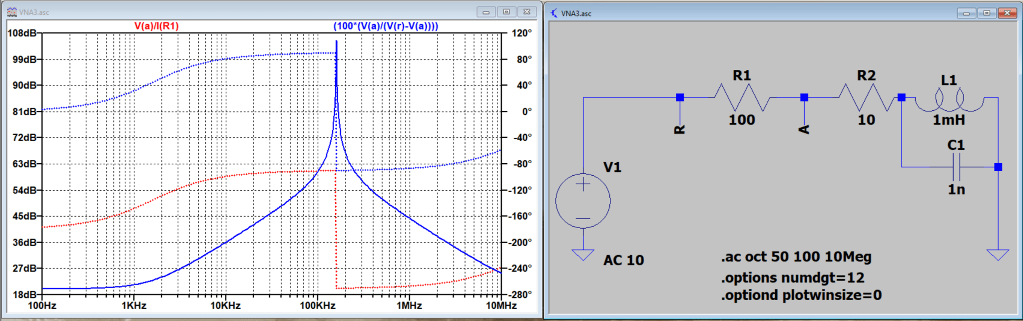

One last thing about this topic.
I simulated in the attachment both V(a)/I(R1) and R1*V(a)/(V(r)-V(a)), who as shown above are identical.
The modulus of the complex impedance in both cases is the same, but phase should start at zero degrees, which is not the case for V(a)/I(R1) ??
But this case can be closed.
Hans

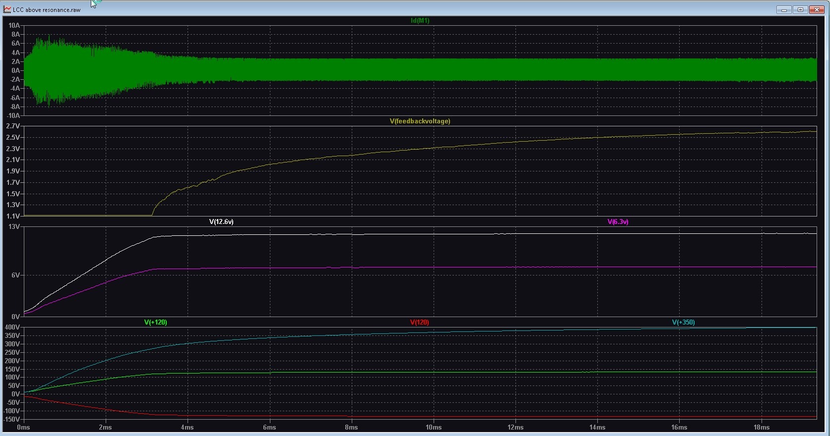

I have a question about smps transformer simulation in a LCC smps type converter.
Because a LCC is a current source output the transformer is designed like ;
The values of the leakage inductance Ls, the magnetizing inductance Lh and the transformer turns ratio n are based on the cantilever-model of a two winding transformer.
I did use the normal halfbridge calculation with excellentIT but can even use a full bridge to get higher inductance, the current source of the LCC needs high inductance as the cantilever model ordered. (if I am right.
After calculate the inductances I do not get the proper voltages, even not with a normal half bridge, the high voltage 350 volts do not go further then 240 volts and the 120 volts go not further as 90 volts, the low voltages of 15 volts however go much higher, so when I lower that inductance, the high voltages do rize and the low voltage do drop as needed.
What is going on here?, for LCC i have a lot of papers who cover the resonance stuff, but not the transformer as she say it needs high impedance for LCC so it is less visible load as possible in design, I now the resonance voltage does go high and is a current source, who need a higher impedance.
I do calculate the inductances in exellentIT and do calculate the inductance per winding primairy (ExcellentIT do not give secondairy inductances on;y windings) so I do winding x calculated single winding inductance, possible this is not right as proportional stuff is needed?.
For LLC I have no problems designed whatsoever, much stuff for it, but I need high voltages so LCC is the best bet.
For sim part I think here are the guys I need for help.
regards.

And mine question here why LT spice give wrong voltages, special the high 350 volts when calculate with ExcellenIT.
Here it is.
