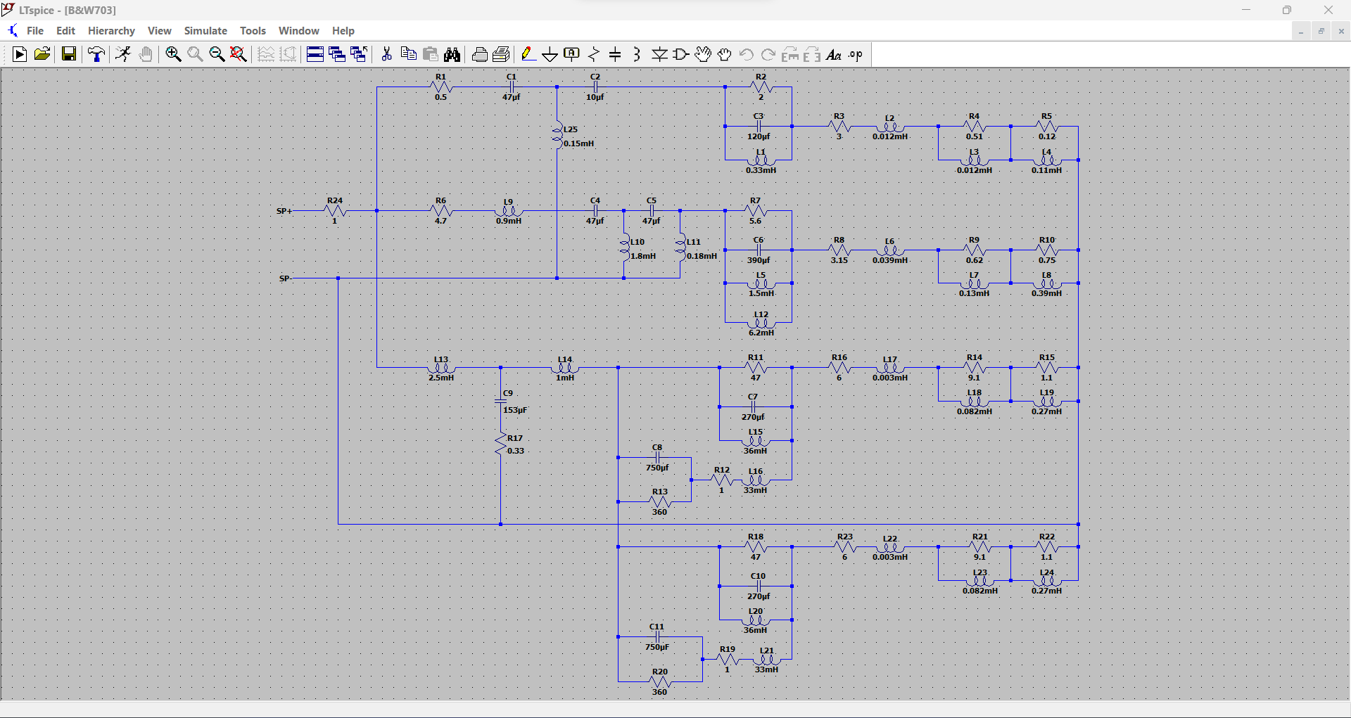

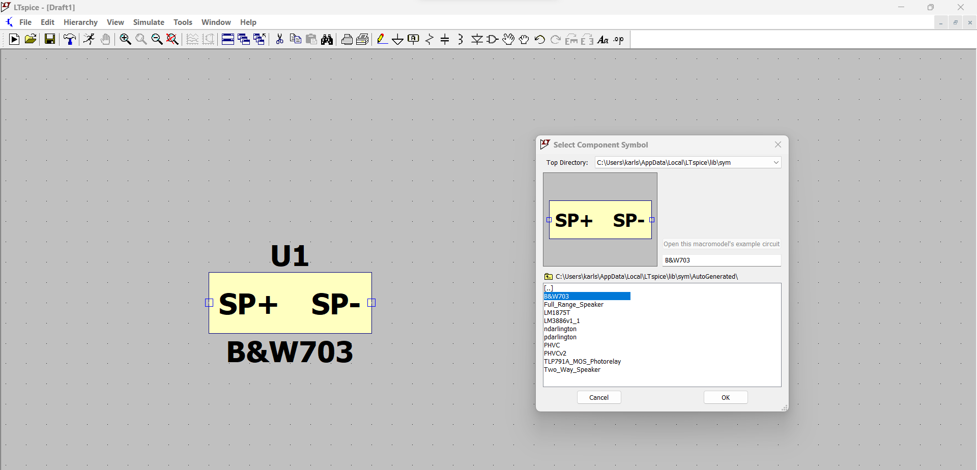

If you can come up with a viable equivalent 'circuit' of the driver then it can be made into a symbol that can be called up whenever needed.
For example this (and creating the circuit for a speaker impedance was beyond my paygrade before you ask )
See also post #2272
https://www.diyaudio.com/community/...from-beginner-to-advanced.260627/post-6320675
To this:
See also post #2272
To this:
Hi Mooly,
thank you for your help.
Kindest regards,
M
Yes, I know that.If you can come up with a viable equivalent 'circuit' of the driver then it can be made into a symbol that can be called up whenever needed.
Ha, ha, this is replacing one problem - from data to an equivalent impedance with another - from data to equivalent circuit, both of which I do not know how to do.For example this (and creating the circuit for a speaker impedance was beyond my paygrade before you ask )

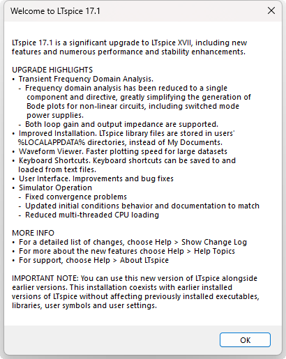

I've just updated from v17.0.x to v17.1. LTspice library filesl are now in user's %LOCALAPPDATA% directories instead of My Documents.
Naturally, some of my old sims won't run becasuse models can't be found. Times like this I wonder why I can't resist updating! Fortunately, v17.0 will still run alongside v17.1.
What's the best way to get all my component models from the old My Documents location to my %LOCALAPPDATA% directory? Copy and skip files that already exist there?

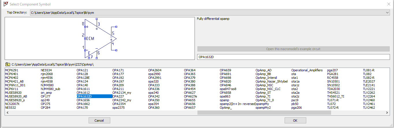

Pspice model from the TI website:
https://www.ti.com/product/OPA1632#design-development
You can of course auto-generate a symbol from within LTspice but I took a stab at creating one similar to the symbol in the "Application Diagram" on page 1 of the datasheet. I verified the symbol's pin order against the SPICE model. You will need to rename the symbol file to OPA1632.asy.
Caveat: I haven't tested this myself.
Totally off topic, you're aware that TI has some newer alternatives, that also don't get as hot.Friends, does any of you have an LTspice model and symbol for the TI OPA1632?
I've seen it in some LTspice circuits in old threads, but can't locate it.

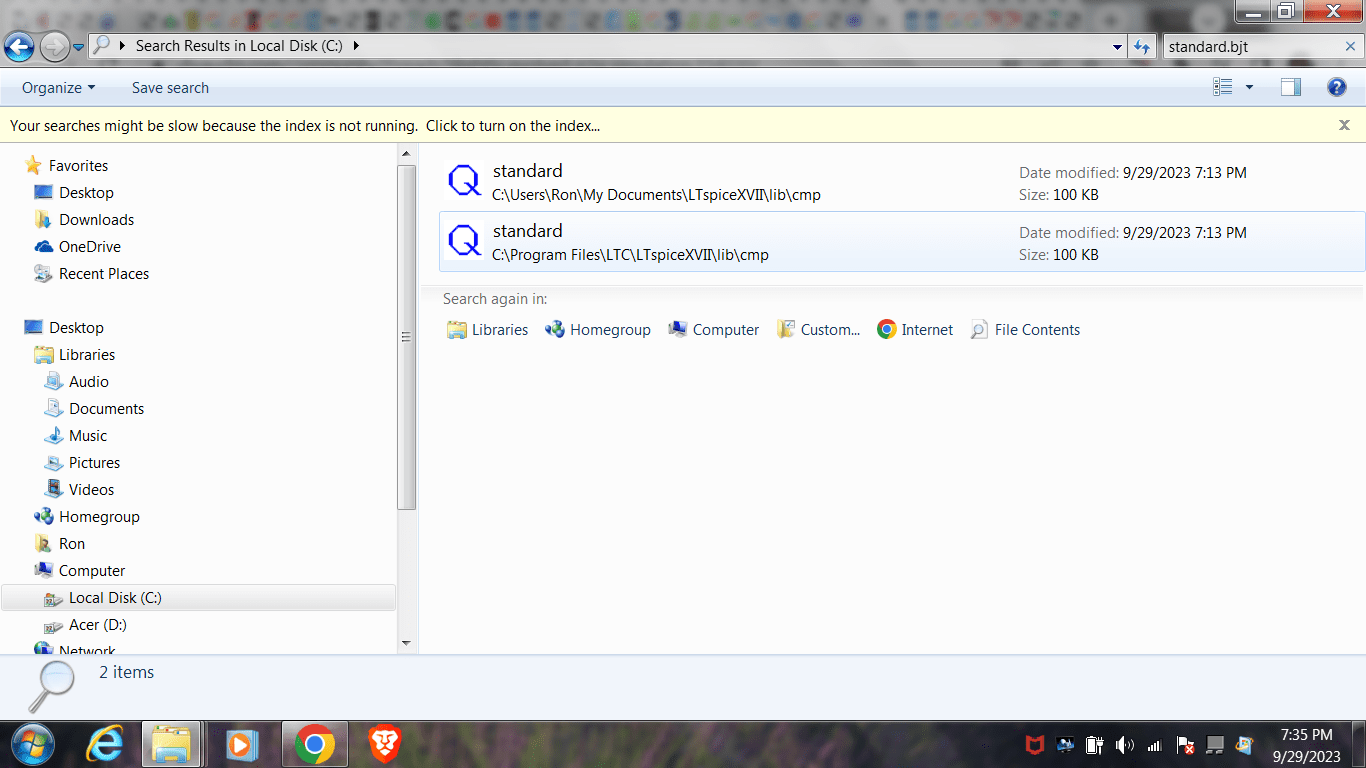

When I install LT Spice. For windows 7. Notice that there are two standard.bjt files.
Which one do I update. Which one can be deleted. Ok I think the idea is a user can only edit his own copy. And the one in the program directory can only be modified by a user with admin rights. Still confusing. Will try both.

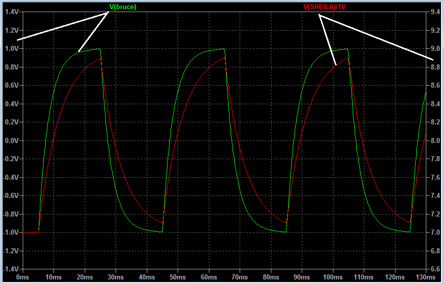

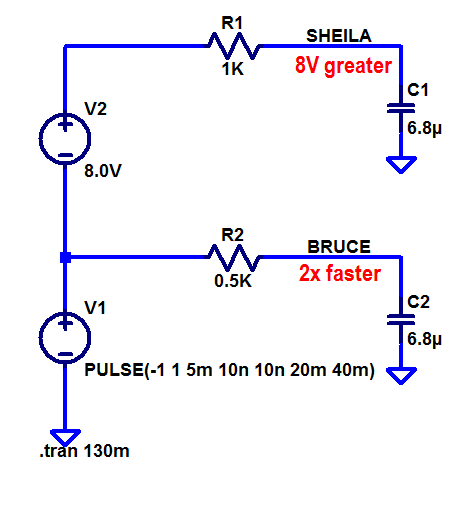

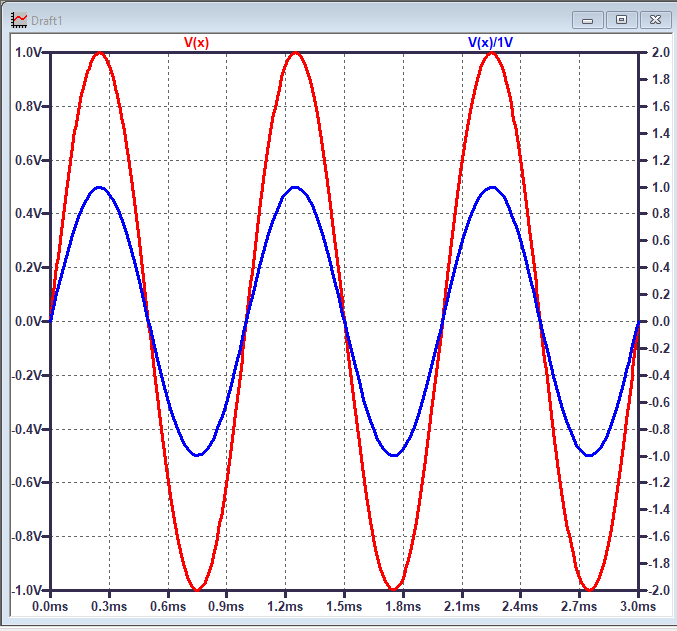

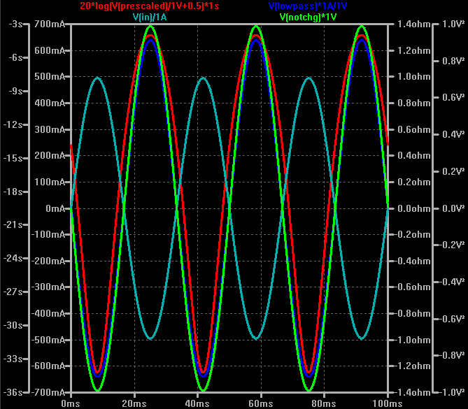

Forcing axis is a bit of a pain in general.Question: is there a way to force a curve to use the right Y-axis instead of the left one?
I have a combined graph with unequal axis ranges and I want to move one curve to the right to give it it's own axis range.
Jan
What I sometimes do, is use some extra sources who will set the max and min.
They do nothing more or less than that.
I assume you could do something similar with right axis as well.
In LTspice IV, vertical axes are grouped by the unit of the displayed quantity... which you can modify by multipying with "unity unit modifiers".Question: is there a way to force a curve to use the right Y-axis instead of the left one?
Jan
The multiple axes don't indicate which curves they're associated with, which makes more than two axes impractical.
Nope :-(Not sure how to extend it to .AC analysis however.
Only way is to use several plot panes.
Well it's not just the numers. Traditionally the right axis is phase. I want it to show current ...
Probably not possible unless I insert a current-to-phase converter ;-)
Jan
Except that it doesn't work here. It has no effect at all.
And how do you get a curve to 'move' to the right axis?
Jan
Jan
Brilliant! And elegant. Who wrote that program again?In LTspice IV, vertical axes are grouped by the unit of the displayed quantity... which you can modify by multipying with "unity unit modifiers".
Jan
You don't. Left and right axes are added in alternating fashion each time you add a curve with a new unit.And how do you get a curve to 'move' to the right axis?
For Bode plots etc, use plot panes. Still better than nothing.
