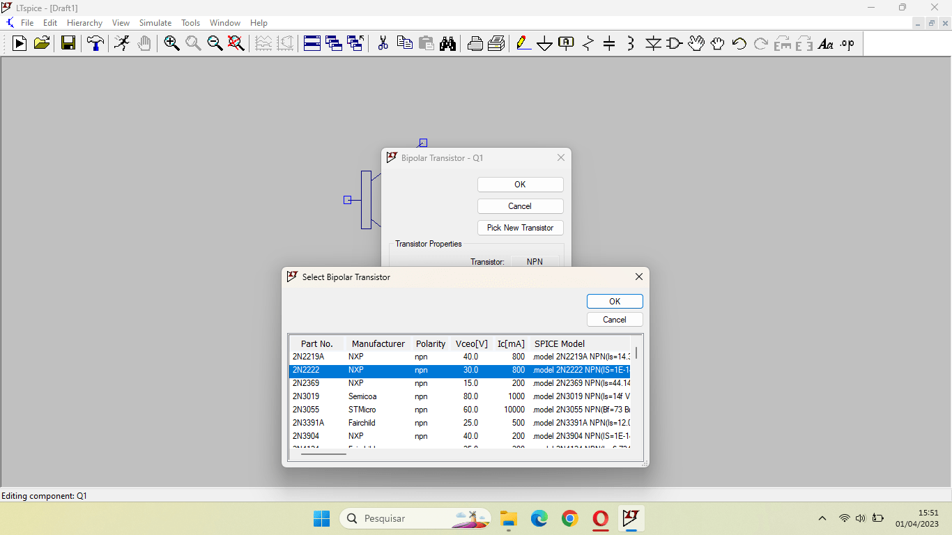

Not sure what your problem is. The 3 methods for using 3rd party bjt models that I use are:Hello everyone, I thank the owner of the topic for the information, but I have this question: what should I do for the 2sc5200 model, for example, to feel here. I tried several ways to copy the cordel.txt file but without success.
1. Use .op to add ".lib D:\SPICE\lib\Cordell-Models.txt" to the schematic that points to the 2SC5200 model,
including files on the web like ".lib http://www.minek.com/lib/minek.lib". You have to change "NPN" on the schematic to "2SC5200".
2. Use .op to add ".mod NPN 2SC5200 ....." to the schematic. You have to change "NPN" on the schematic to "2SC5200".
3. Add ".mod NPN 2SC5200 ..." to the "standard.bjt" file. This is the only method that makes 2SC5200 available in the select new part list.

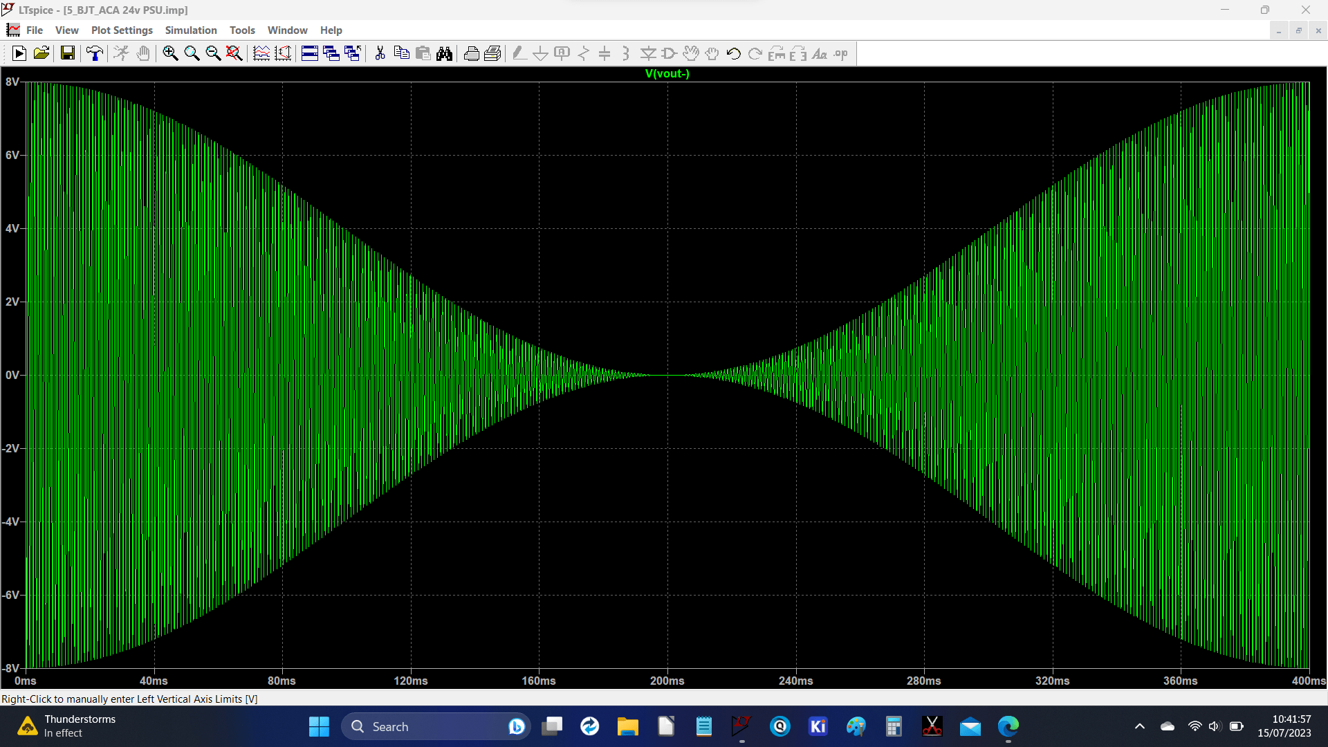

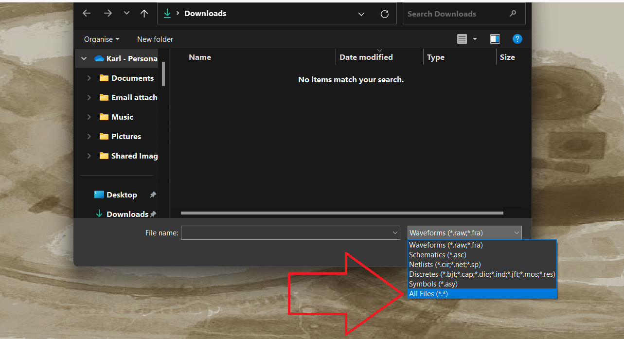

I accidently clicked something and generated a .IMP file (presumably impedance) and I've no idea what I did to generate this. I was doodling with a sim of the ACA amp and looking at FFT's. This is what appeared. You can see I am on the output node.
I'll attach the .IMP file in a zipped folder. It will open in LT if you browse for the file using LT and set the options in the dropdown to 'all file types' to make it visible. The file does not auto delete which is how I found it this morning (I have .raw, .net etc to delete on closing)
I will also attach the ACA file if anyone cares to try and recreate it. Should click and run with default models.

Seems the .imp file is a impulse response file that is generated by running a FFT on the FFT waveform.
I found the info at the ltspice usergroup - https://groups.io/g/LTspice/topic/99912388

Oh well done you've nailed it with that.Seems the .imp file is a impulse response file that is generated by running a FFT on the FFT waveform.
I can see what I must have done now, I ran the FFT and reduced the "Number of Data Points Samples in Time" from the default 262144 to something lower like 32768 to get the detail I wanted. From there I must have lost concentration and run the FFT again, as you say on the FFT just done, but now with a much higher sample point setting. That gives some weird results and creates the IMP file which by the way seems non searchable to locate, at least in an easy way.

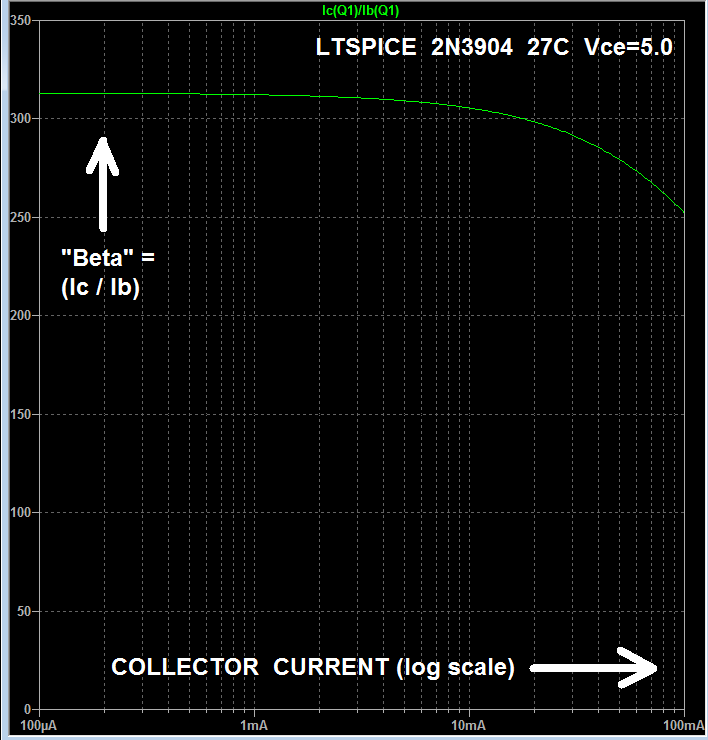

Recently I stumbled across a side issue, which turned out to be a delightful little "homework problem" in the application of LTSPICE.
I don't know about you, but I found it difficult to invent strategies that would put collector current on the horizontal axis. A mental blind spot. Eventually I (think I) succeeded as shown below.
Fool around with it and have some fun! It's not an IQ test, it's just a happy little LTSPICE puzzle. A brain teaser.
BTW it can be done with the TI-TINA simulator too. But this is an LTSPICE thread.
_

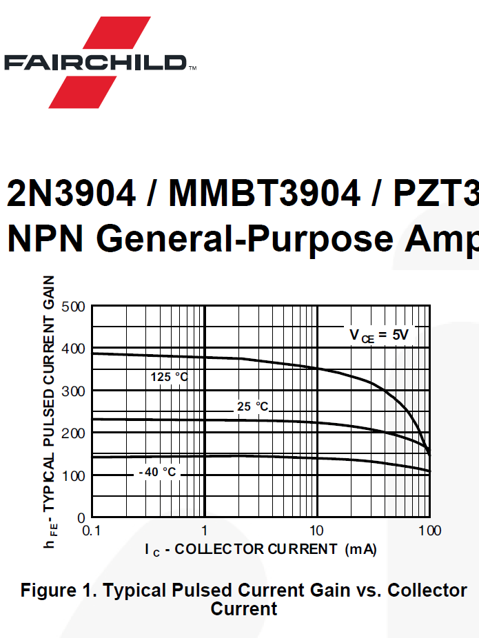

Problem: Use LTSPICE to reproduce the middle (room temperature) trace in Figure 1 of the 2N3904 datasheet. Namely, have LTSPICE plot "Beta" (Icollector / Ibase) versus collector current, for a 2N3904 at room temperature and Vce = constant 5.00 volts. Beta should be on the vertical axis with a linear scale, and Icollector should be on the horizontal axis with a log scale.

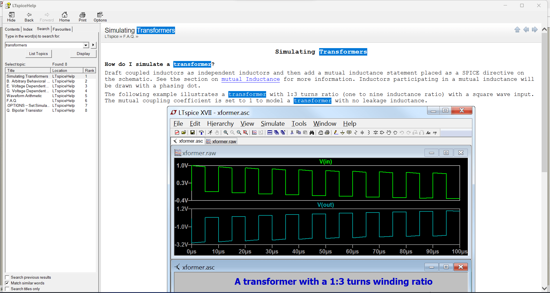

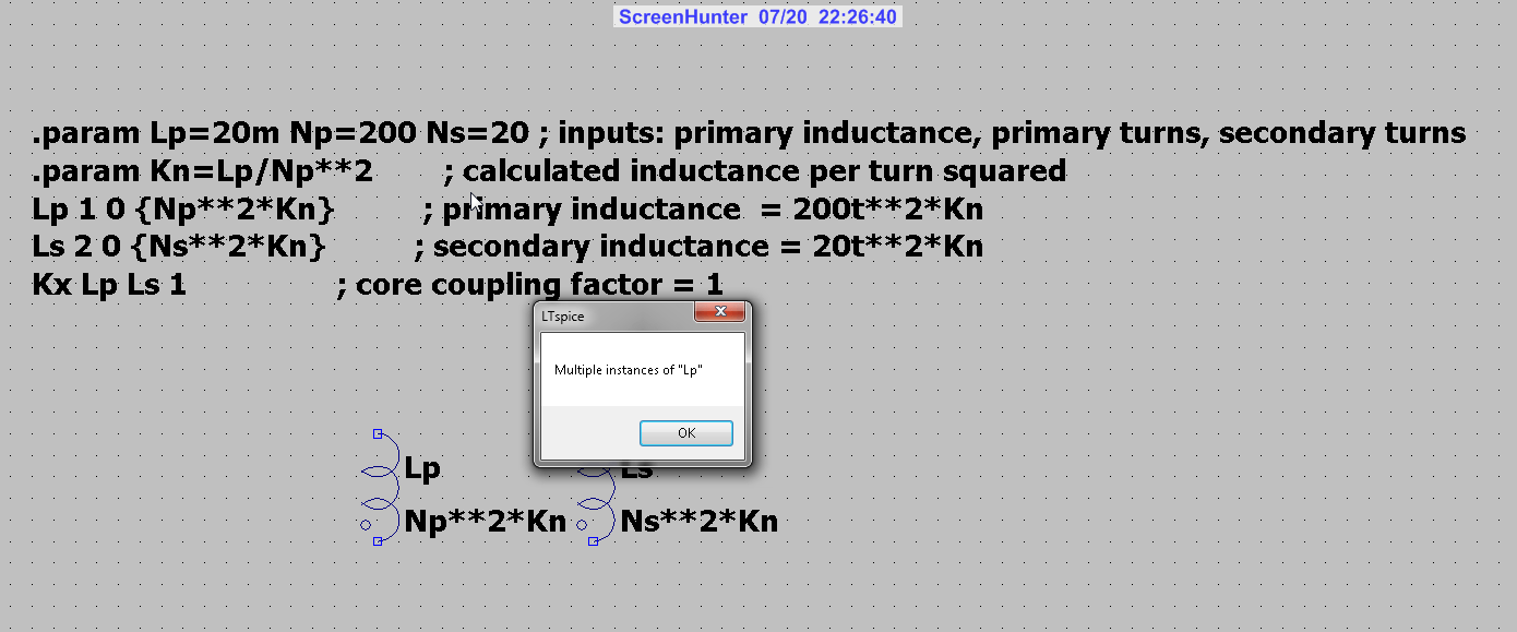

Youv'e defined Lp as 20m then again in a formula that refers back to the original definition.Hi All
I did try to setup a sim for transformer as in this pic, seen on internet.
I get a error, so can someone help me out what I did wrong.
thnks.
Lp cannot be both a reference designator and its value. Sorry if I don't try to make sense of the rest of it.Hi All
thnks.
I have this from wiki, but has little info. I did it a other way do work fine.Lp cannot be both a reference designator and its value. Sorry if I don't try to make sense of the rest of it.

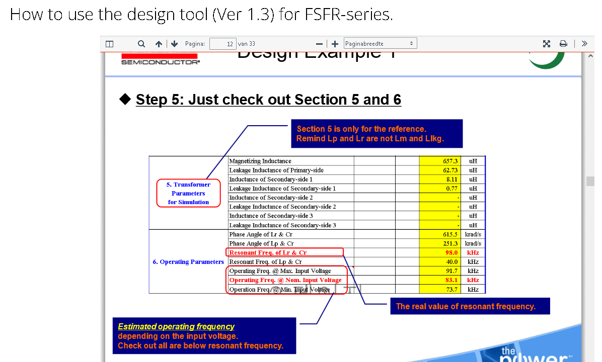

Hi all guys and womans.
I have a question about simulating LLC converters, I have succes but have a question about the calculator, the picture states that the transformer
in section 5 are for simulation, but how do I put this into LTspice, I have use Lp and Lr and have later include the leakage inductance into Lr so I can make
transformer K =1. I have a formula who can calculate leakage with secondary winding shorted K=√(1-(Lshort/Lp). and use this in LTspice and left the Lp as calculated. I presume that LTspice do handle this K as leakage inductance?
Little bit complicated. I can simulate and have locking feedback in reach of 50 mA to 10 amp with M =8 Q = 0.29.
Thanks in advance.
