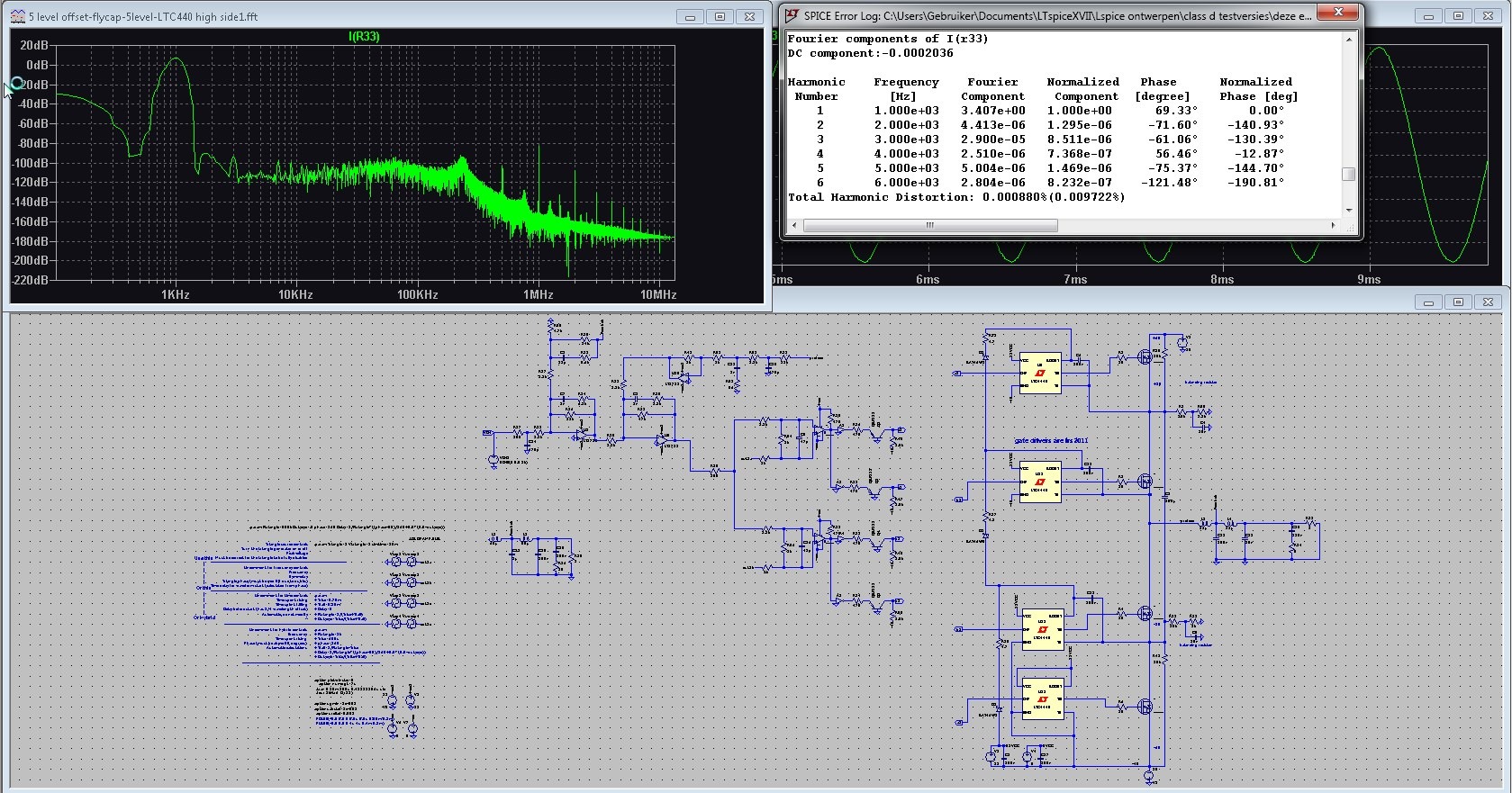

It can do it for you but then you need to design a generator slowly ramping up amplitude and an analyser (notch filter and level meter) in LTspice as well. Certainly doable (and a nice design excercise ... but worth the effort? I don't think so.Well, I was hoping that I could directly graph it, but that may not be possible.
Graphing it separately is possible of course but basically being a lazy person I would hope LTspice would do it for me ...
Jan
Yes. I tend to do sanity checks with distortionless/idealized circuits to avoid pitfalls.BTW, if you want to do an FFT you need to make sure the number of cycles, the minimum time step and FFT points all need to be coordinated for low noise FFT graphs. Does a .four have the same constraints?
Jan

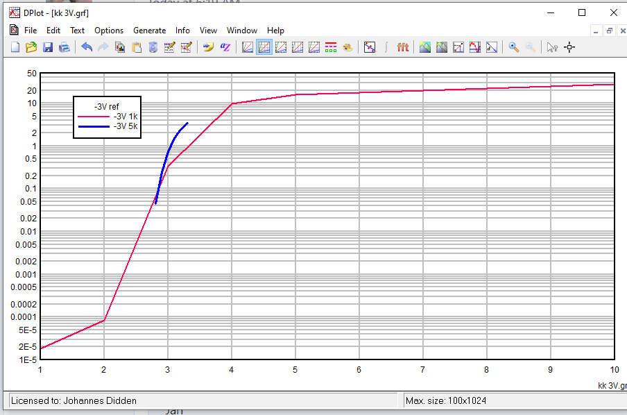

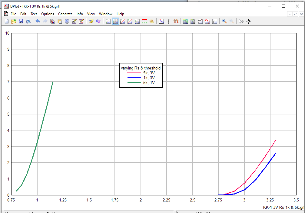

For instance, look at the attached. The green curve is with a 1V threshold, intended to limit the output voltage to 1V.
At 1V nominal input, the distortion is alrready about 3.3%.
The red and blue lines are with a 3V threshold, intending to limit the output to nominal 3V. At that 3V, the distortion is less than 1%.

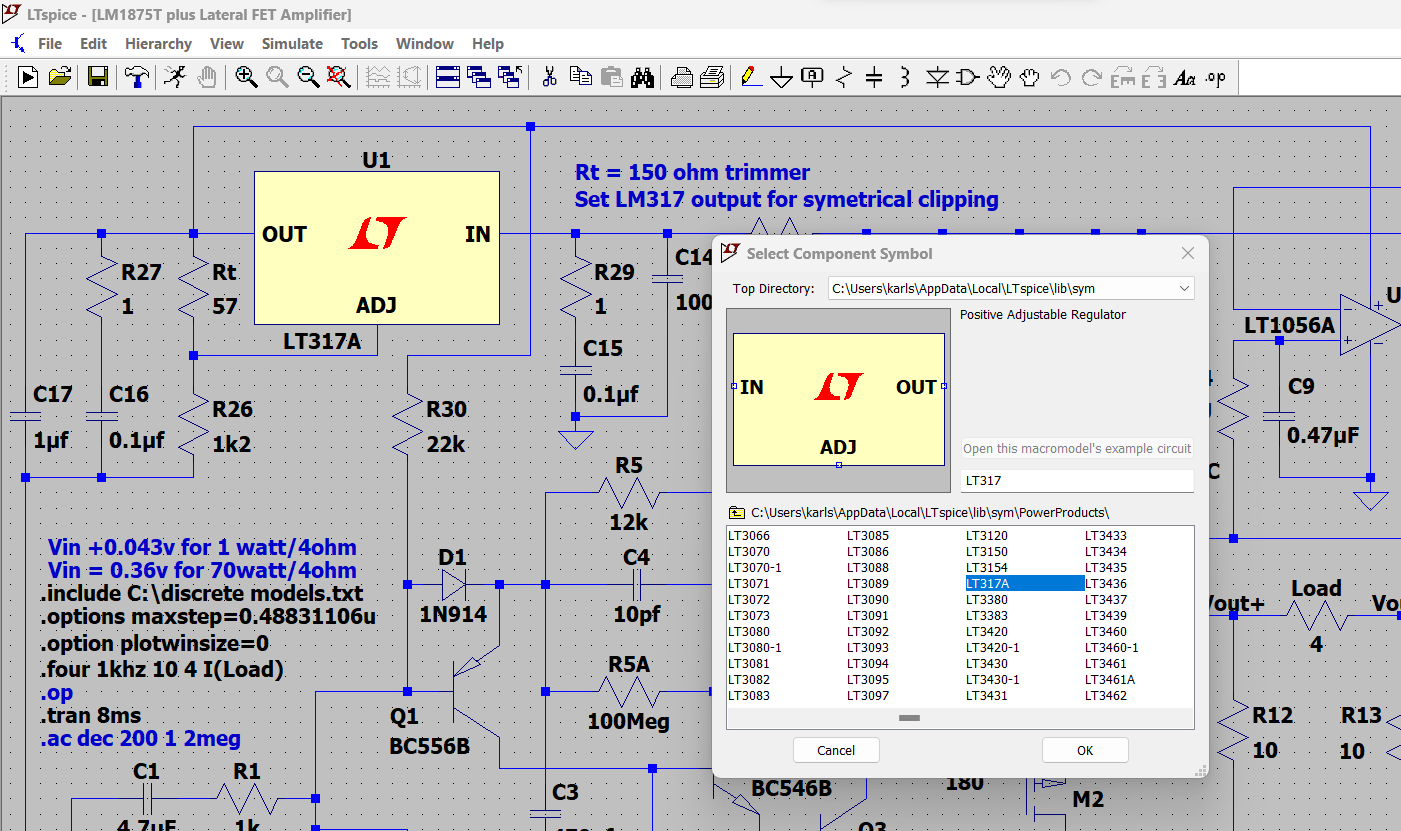

I have started a new thread covering the installation of the latest version of LT. Work in progress, comments and tips welcome. It will all hopefully get tidied up as it progresses.

The purpose of this thread is to show how to both install and to use LTspice, hereafter just referred to as LT, the free circuit simulation program from Linear Technology (now Analog.com). I consider myself very much at the beginner end of the spectrum, but I'm hoping that as the thread develops we can gather input from those more seasoned users amongst you all...
A picture... or two or three... are worth a thousand words.
Can you believe it took me many days to figure out how to include a simple model for a device into a simulation. For a newbie it needs to be a click by click instruction with pictures.
Credits... firstly to Bob Cordell and his excellent book "Audio Power Amplifiers". I can say with certainty that I would still be staring at the blank grey workspace of LT had it not been for Bobs excellent introduction to this fantastic program. I would urge anyone with an interest in simulating amplifiers to "go buy the book". You won't regret it.
Thanks also to Keantoken who has a prety comprehensive WIKI on the site. Take a wander over when you've a few minutes spare and have a read.
So lets get started.
LT is best downloaded from Analog.com Be sure to download LT IV (for the purposes of this tutorial), or you may wish to install both versions (LT IV and LTXVII) and retain LT IV as a legacy program.
Old URL which currently redirects correctly to Analog Devices.
Linear Technology - Design Simulation and Device Models
Direct Analog.com URL
LTspice from Analog.com
The version marked for Windows XP is LTIV. All other options are for LTXVII. There is also a Windows and Mac version with this thread being based on the Windows version.
Install LT as you would any other program. On Windows the installer will probably say you have UAC (user account control) enabled and that it may cause issues with file paths. I have used LT on Vista, W7 and W8.1 with no unresolvable issues by leaving UAC on.
When you have installed LT you should find you have a desktop icon to open it... the usual stuff. What you should now is change the icon (or whatever means you yourself use to open programs) to run as administrator. This is important because LT will not run and update correctly if this is not done.
To do this, right click the icon and using the <properties> tab, change the shortcut to "Run as administrator". This picture show it for Windows 8.1, W7 and Vista are similar.
Next thing we do is open LT and set a few basic options. Setting these options as shown ensures that LT doesn't accumulate a lot of temporary files... even then its not foolproof... we'll cover that later.
Nearly there, but first lets get to know where LT lives on your PC and how it handles files and folders. This is important in order to keep your system tidy and to make it easy to keep track of things.
Depending on your operating system, go to the run box and type C:\Program Files.
You should see something like this with LTC being the folder of interest. Click your way through the folder to open it. You will see this.
The <scad3> line is the program shortcut. If you are using W8.1 then this is probably the best place to alter the settings mentioned above to "run as admin". There is a folder of examples in there too, as well as all the models and files LT needs to run.
I recommend that you DONT add to, or change anything in those folders at this stage.
Lets just jump ahead of ourselves at this point because there is something worth mentioning. If you run a simulation (such as from one of the examples), or you create one of your own, then LT by default wants to save it back in the LTC folder in program files when your done or when you close it. My advice... dont let it. Save all your work in a normal folder in your documents. This then leaves all the program files untouched. If you want to use an example as a starting point then I recommend the first thing you do is save the simulation again under a different name and as suggested, save it to documents or some dedicated area away from the LT folder in program files. Doing that preserves the original installation and leaves all the files and examples untouched.
So if you are creating your own simulation and design then I suggest just opening LT first and then click <file> followed by <new schematic> followed by <file> once again and then <save as> giving your intended design both a name and then saving the blank workspace somewhere such as your documents folder.
So we now have LT installed, we can move on to actually using it to do something useful. This will be your first simulation.
Note on updating LTspice. Updates to the library files are frequent. By default LT seems to warn you after 60 days have elapsed that you have not updated the installation. These updates are mainly for database of models adding new ones as they become available. The updates are incremental and simply add new items to the already installed files. The update typically takes around 3 minutes to complete, however you must be logged on as an administrator (in Windows) for the update to run correctly.
To manually check for and install updates
1/ Open LT with elevated privileges. In Windows this means right clicking the icon you use to launch the program and selecting the 'run as admin' option.
2/ Under 'Tools' there is a dropdown menu. Select 'Sync release to allow LT to check for and install updates.
When the update is complete the program automatically closes with a message saying the update was successful.
