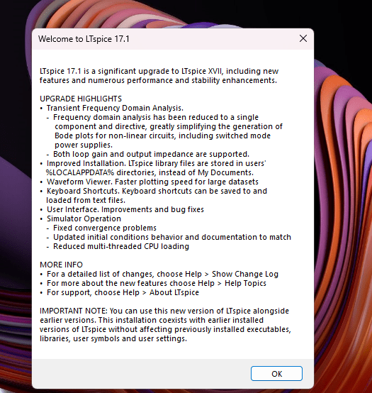

Not sure if it has been mentioned anywhere but I spotted this on the latest installer of LTspice XV11. I was doing an install on an old laptop and gave it a whirl. A quick install for sure. Haven't really tried it beyond the most basic stuff. I couldn't just find where the program lives after install either which is a bit odd unless it added to the existing install. Bit of a mystery is that.
The installer is here for anyone interested. Based on my experience if you open the link then it will immediately launch the installer, it is NOT a page about the new version. Copy and paste the code below if you want it.
https://LTspice.analog.com/download/latest/LTspice64.msi
According to the beta documentation, it can be installed on the same PC as the released version without conflict. It is a completely separate installation from the stable release version so it is probably safe to install (although I myself will probably wait until the actual release of version 17.1).
Thanks Ray. I had a bit more of a play earlier and one advantage (I think) is that by storing the user files in %localappdata% directories means that they are not indexed (again I think that is what will happen). If so then that could be advantageous to making and restoring disk images because the index file is not recommended to be included in a backup and programs such as Macrium automatically exclude the index file. That means a quick restore actually takes a long time to fully complete after the restore has finished as Windows has to reindex all those LT small files.

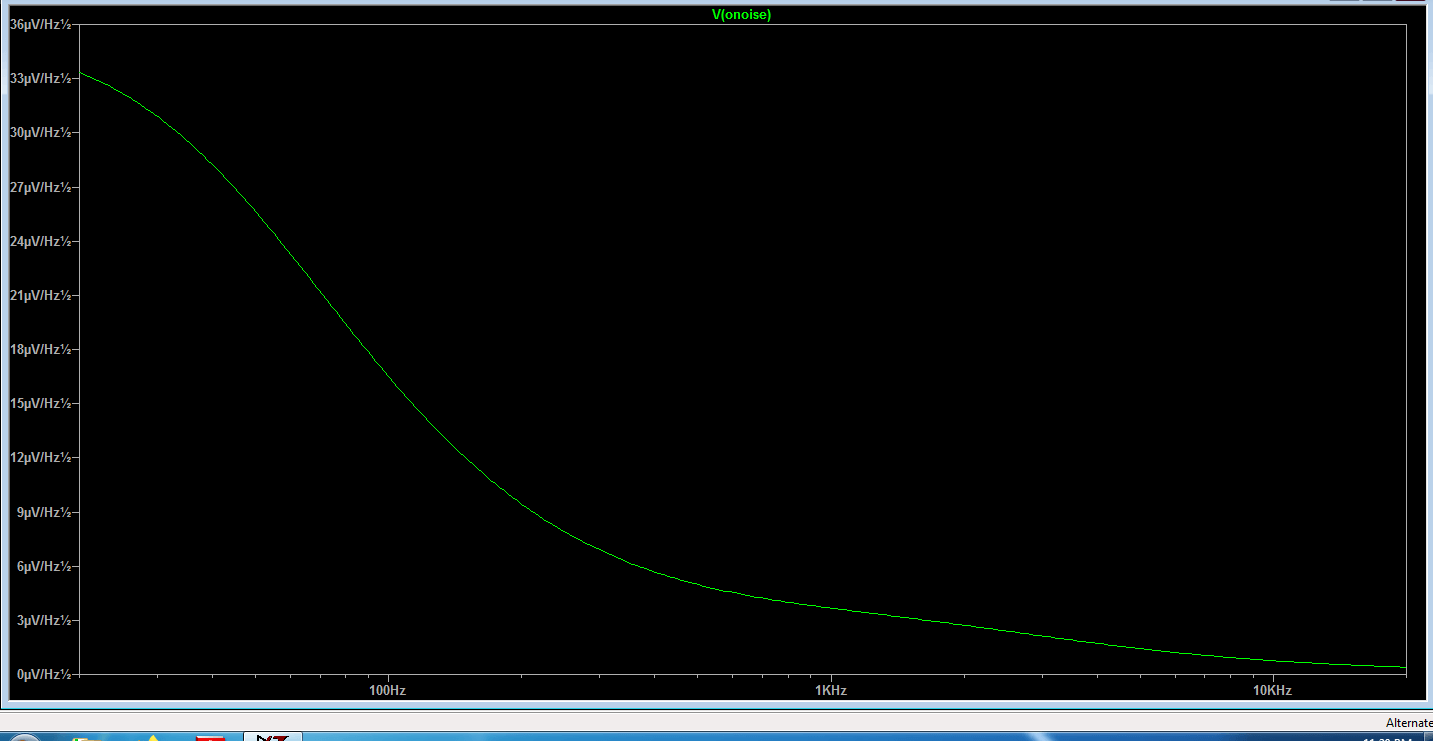

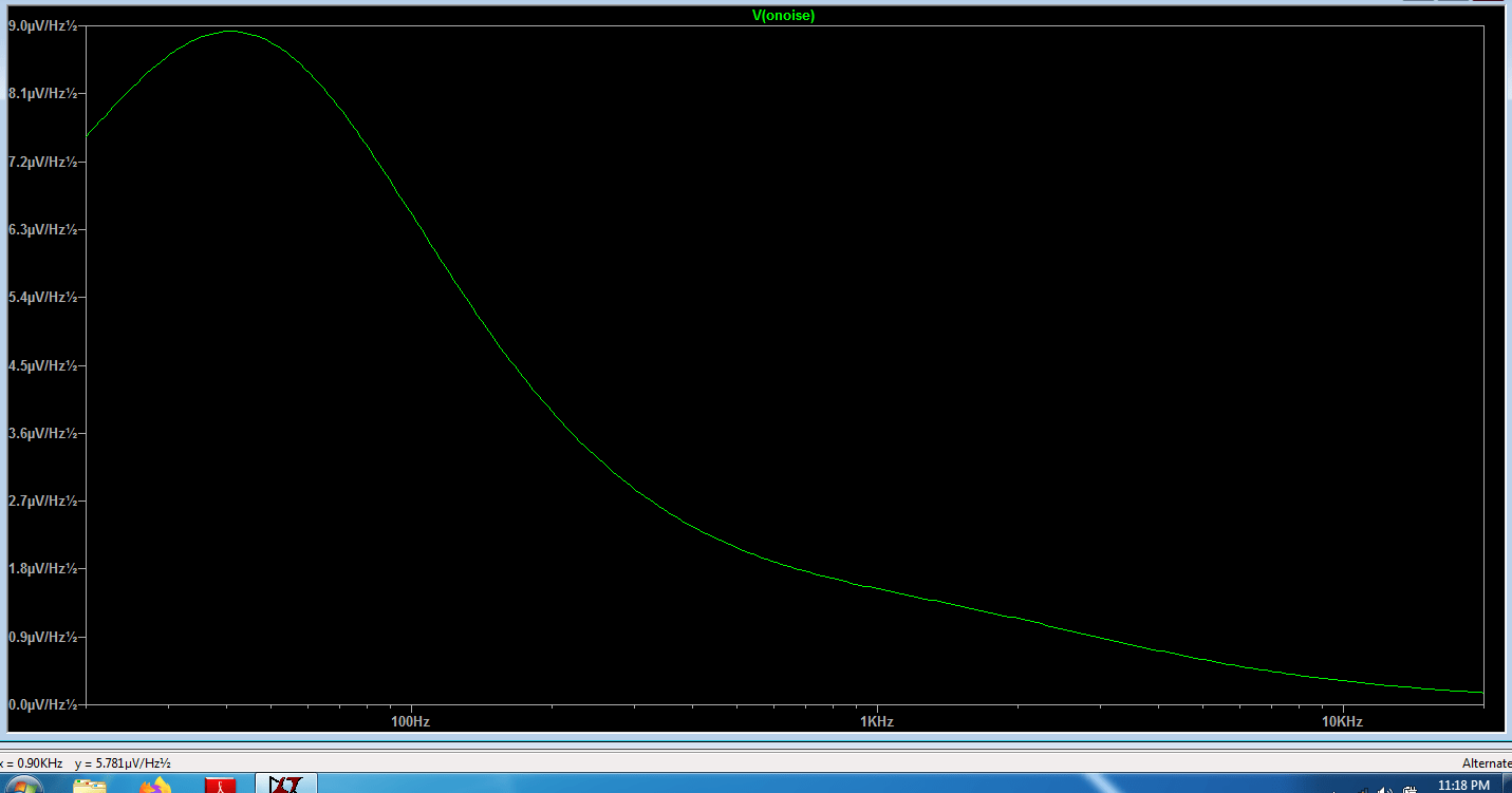

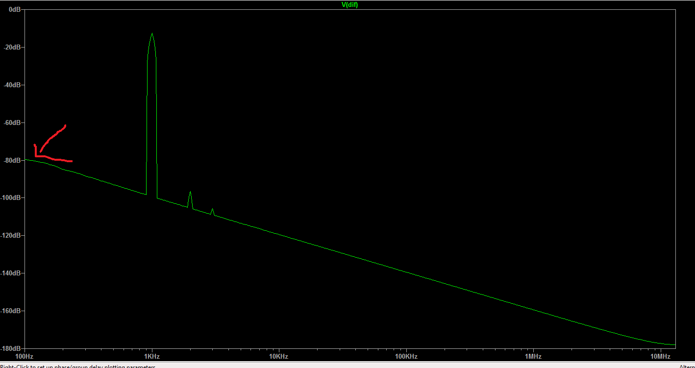

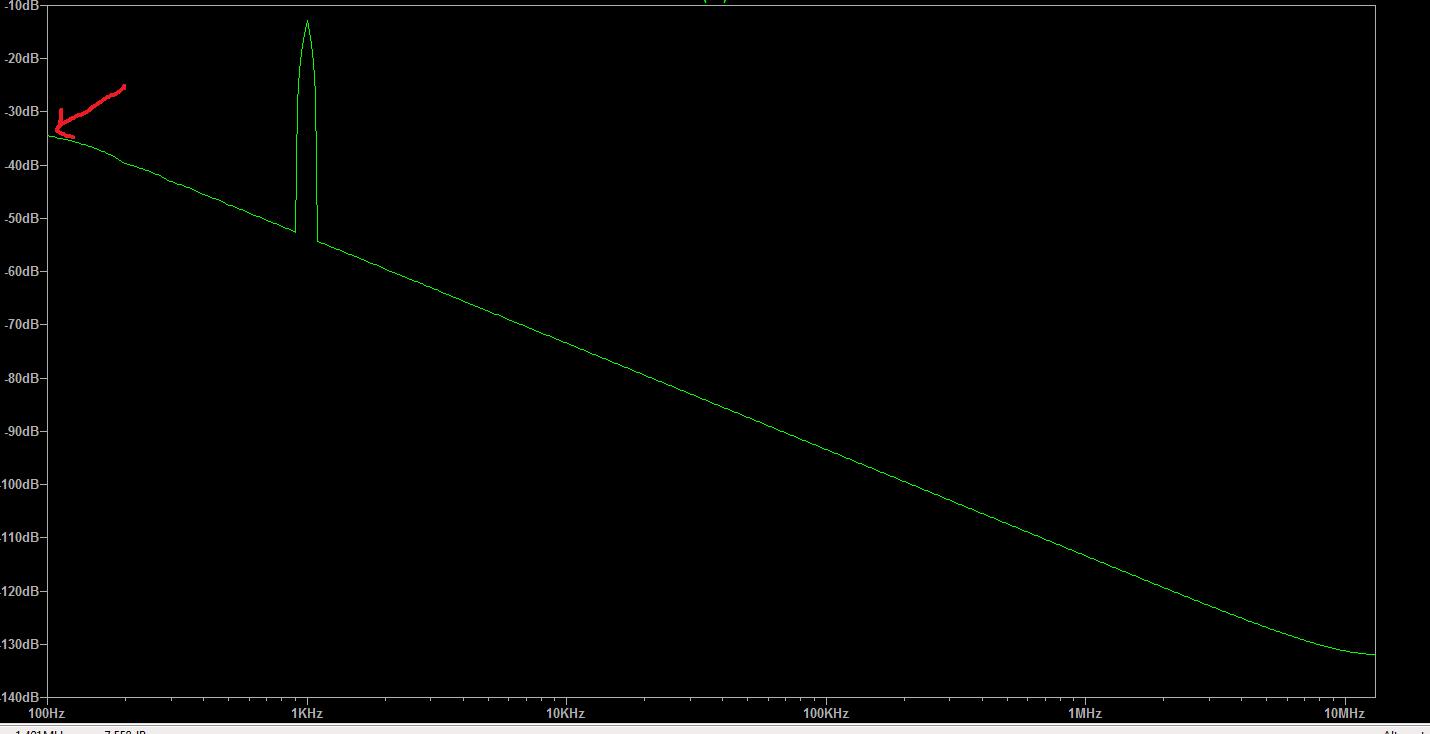

Hi guys! There's something I don't understand about LTspice noise simulations.If I perform the .noise command and a fft on the same circuit i get two results.I always thought that the FFT baseline represents the noise of the circuit, but that doesn't correlate with the noise density result from the .noise command in a circuit where I should get the lower noise where the .noise command returns me the higher noise density throughout all the adio band. Those two circuits have exactly identical input source and output load , and identical input and output signal amplitudes.Can someone explain what the baseline in the fft graph shows?
