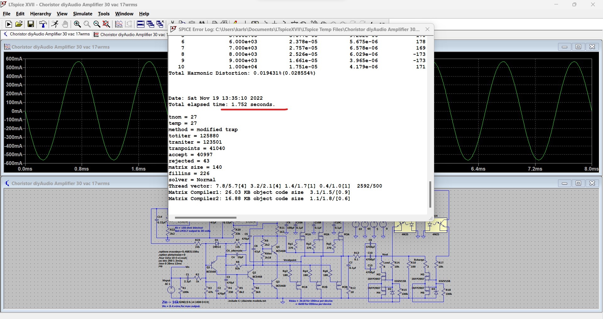

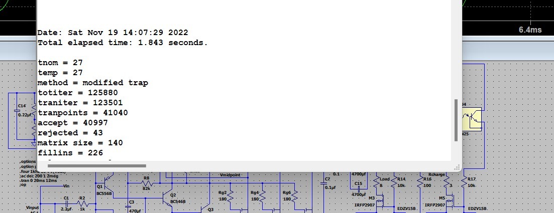

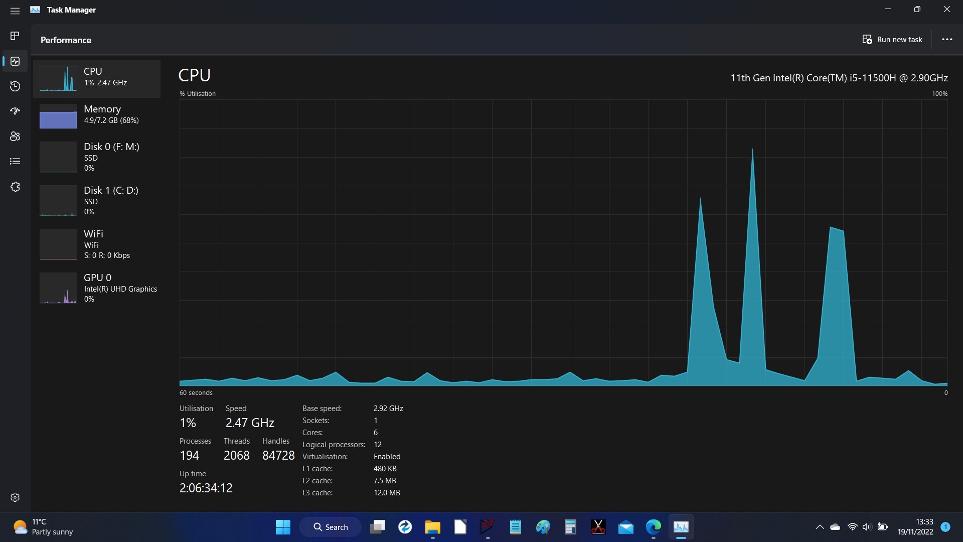

Even quite complex ones like this run in well under 2 seconds and the CPU wasn't very high.

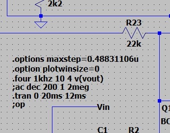

.options maxstep, now onto recall/figure out what that's for
.OPTIONS -- Set simulator options

Maximum step size for transient analysis |

I think in my case it is the min step size that is so small that it needs a huge number of steps thus runs very slow.
The step size is set by LTspice depending on how fast voltages and currents change from step to step. So a circuit with quickly varying values gets a small timestep assigned.
With slow circuits, LTspice may use a timestep that is so large that details get lost, so it makes sense to set a maxtimestep in such a case.

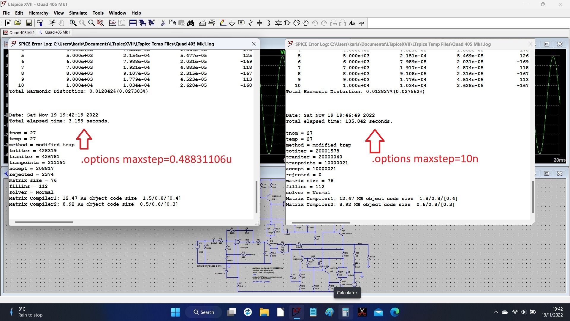

This is the Quad 405 with the timestep calculated manually and then run again using 10ns as a timestep. Look also at the numbers at the left, now I'm in the 10's of millions.
I set the timestep to something like {1/f/4096}, where .par f=1k, 10k, etc. and the stimulus frequency. .tran 0 {5/f} {1/f} {1/f/4096} .options plotwinsize=0 nothing more.
