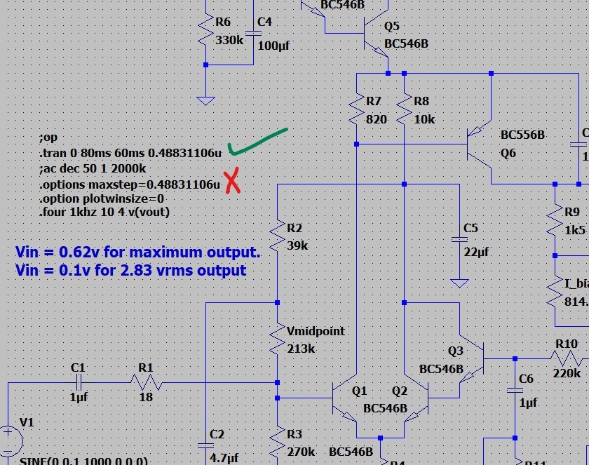

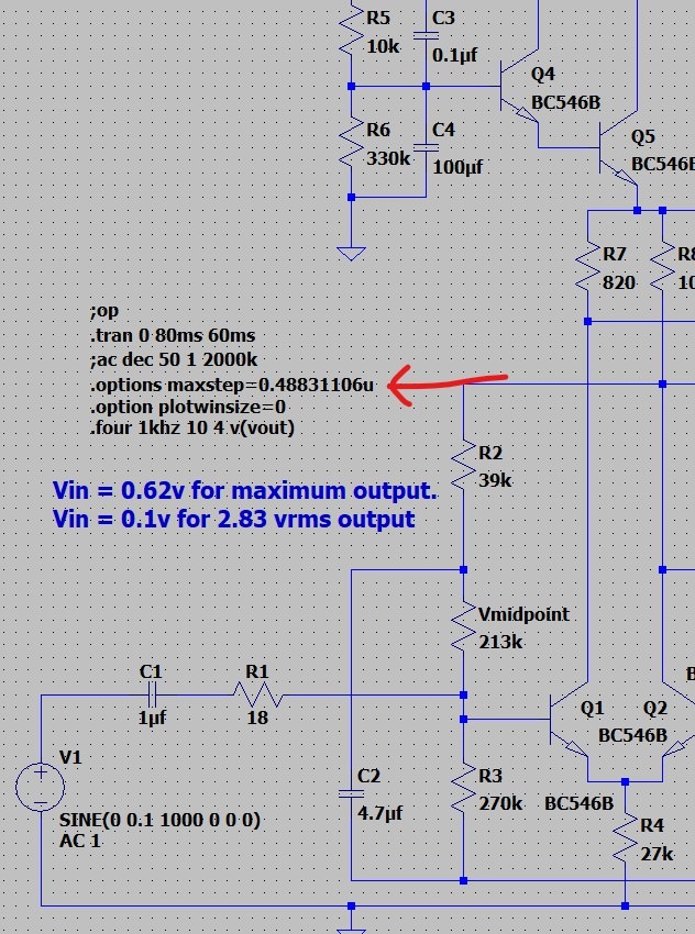

I've noticed something different recently but I'm honestly not sure if its me or LT. I think it must be LT because what worked in the past now does not.
Its the timestep. In the past I could always just add the timestep as a .op command as here. This is an old sim and it runs correctly. The distortion comes out at the expected value. All good.
If I delete that .op statement and then re apply it the distortion is massive and gets worse the longer the sim runs. It took me a while to suss out but now the timestep has to be entered into the 'Transient' sim tab so that it appears as one statement.
So old sims that have the timestep entered as a copy and paste still seem to work OK but if altered they do not, and the timestep has to be re entered onto the Transient tab. I discovered this when simply resaving a circuit under a different name to modify something and the distortion results were really poor. Delete the .op entry for timestep and reapply it via the Transient tab and it all works.
Hope that makes sense 🙂

Just trying all the above again and now its seems to work as expected....
Ignore for now. If the issue occurs again I'll come back with it. Its odd what happened.

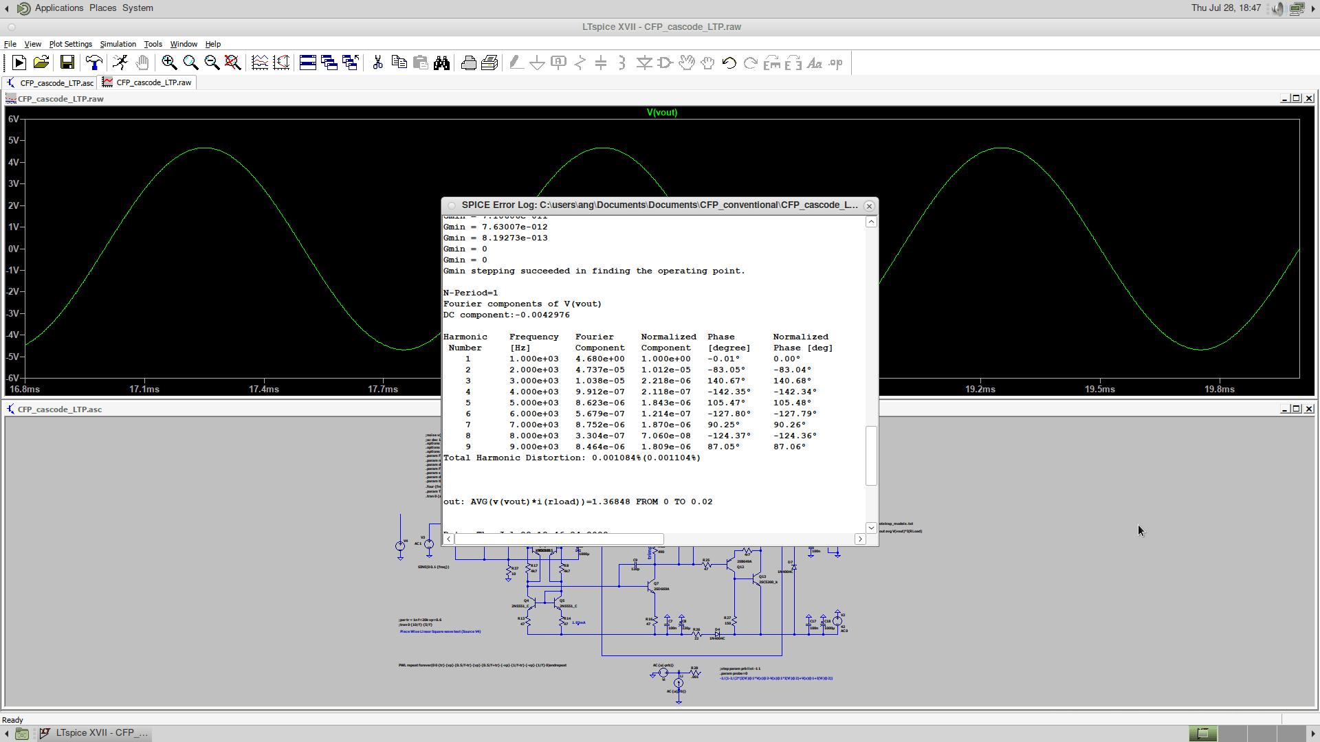

Hello again guys,
I'm not so sure if this is the proper thread to post my query but since it is LTSpice specific, I might as well ask it here.
Has any one of you manage to refine the text on THD windowing under Wine on Linux?
I'm on pure Arch with Mate as the desktop environment. I tried installing and enabling compton (window compositor) but I get the same result. I used to work on Xfce on the lighter/speedier side but screen tearing is terrible especially when scaling windows.
Thanks!
Thanks!

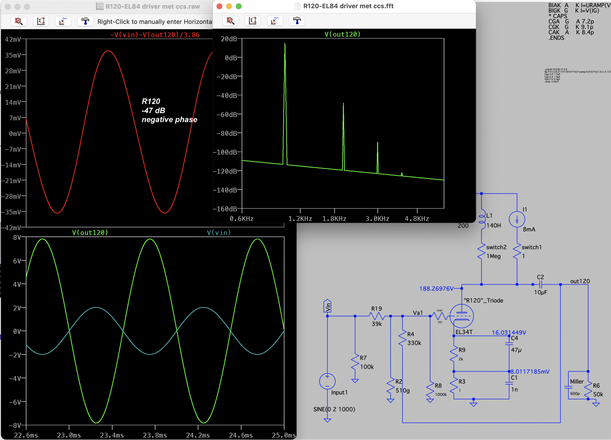

I would like to have a variable: GAIN.
I have seen a simulation where it was used in a formula.
Here is what I want to use it for: to see the distortion in the output. And be able to quickly change components and see the effect.
I now have determined the gain from the screen (where gain = 3.86) but two decimal accuracy is only found with checking various values sequentially, which costs me some time to manually approximate the real value. [On a distortion meter there is that nice knob 'phase' which is handsome to null the distortion to its lowest point.]
Finally fixed it! By following the instructions at Wine-ArchWicki and installing ms-fonts via extraction from an ISO windows installer, it worked real nice!Hello again guys,

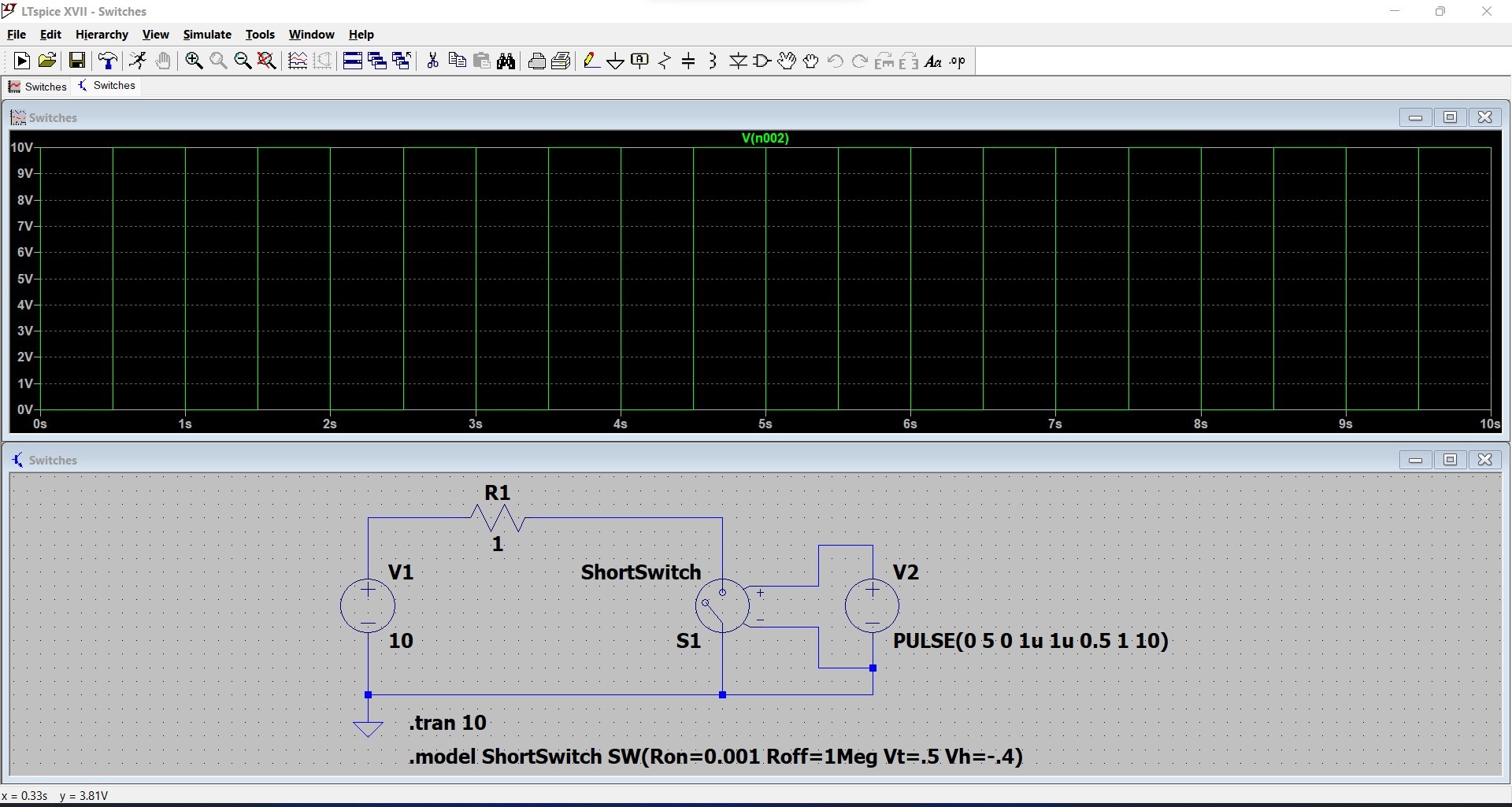

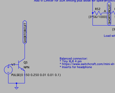

Its a good tip is that and useful for testing things like outputs of regulators (with a switched load).
(Have you tried using the voltage controlled switch? which will give you a 'perfect' short that is not dependent on polarity)
I've tried the switch but I can never remember the model as you need one for the switch component. I've used it once and you do get a nice impulse spike too. I should really dig out a switch model and make a sub-circuit model for the library then simply include it in.
If you don't put some resistance in you will end up with a stupidly high current, so adding some in-series resistance is useful to simulate either a path of resistance and/or a wet path of resistance.
You can do point-to-point shorts simply doing the same but with two labels and a switch. Then move the labels around.
Try this:
https://www.analog.com/en/technical-articles/ltspiceiv-voltage-controlled-switches.html#:~:text=LTspice: Voltage Controlled Switches 1 Insert the symbol,enter the unique model name, “MYSW”. More items
The control voltage does not need ground referencing as I show here. It can float.
