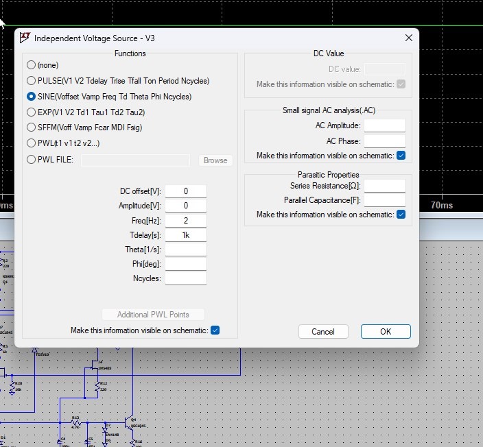

When I do that I get this. I need to delete and set a new one to let it work.
But heee now I have after restart of the computer did try again, now it is
oke again.

Maybe, because it can have a bug there.
What it did is shift the values so frequency was in delay etc.
Looks ike it did not recognize the dot in voltage like 0.2 volts.
The rest do fine, looks it is quicker also.
I never did see it,.
I've never had that happen in W11 tbh.
The only time you used to see something like that was changing from pulse to sine or vice versa and all the details were carried over. You just altered them though.

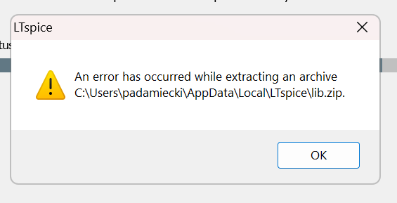

Hi!
I tried to install a few times with and option "for all" and only "for me" new 24vLTSpice, both on W10 and 11 and got this error:
what could went wrong, the installation then rolls back?

Difficult to say without having it in front of you. I assume this is LT24 you are trying to install which is the very latest version.
You might find something here but even this isn't 100% applicable now:
https://www.diyaudio.com/community/...-2023-version-of-ltspice.394676/#post-7240021
As you will see in that thread, I fully uninstalled the previous version first and and also trawled the registry to delete all LT entries.
Custom filepath's you had before for your own models and so on will possibly also not work.

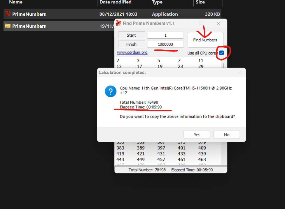

Try this if you like (nothing is installed, it runs self contained). Set to 1,000,000 and tick 'use all cores'.
Cpu Name: Intel(R) Core(TM) i5-8500 CPU @ 3.00GHz +6
Total Number: 78498
Elapsed Time: 00:12:46
So I should get a faster CPU with more cores?
Jan
Total Number: 78498
Jan
It would certainly help I think plus SSD drives are a must, they make a massive difference generally. I'm on a Dell laptop.
