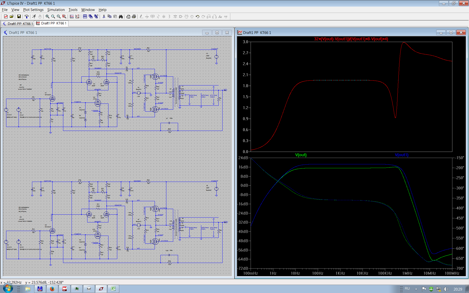

There is no need to use the equation, LTSpice is able to plot the output impedance directly (assuming the amp simulation works and all the SPICE models used are fairly accurate). You can do this by shorting the input of the amp to ground, connect a 1A current source to the output of the secondary and ground, then plot the output voltage, please try it and see if this works for you.For its calculation I used euation Rout=Rload1*Rload2*(Uout2-Uout1)/(Uout1*Rload2-Uout2*Rload1)

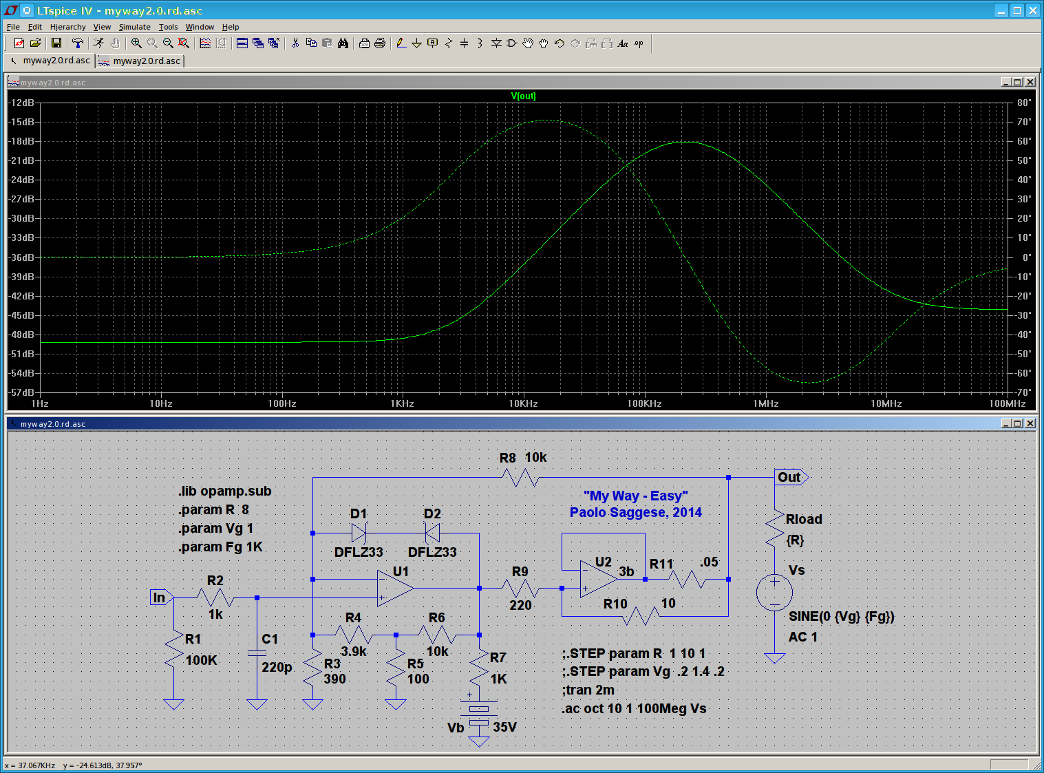

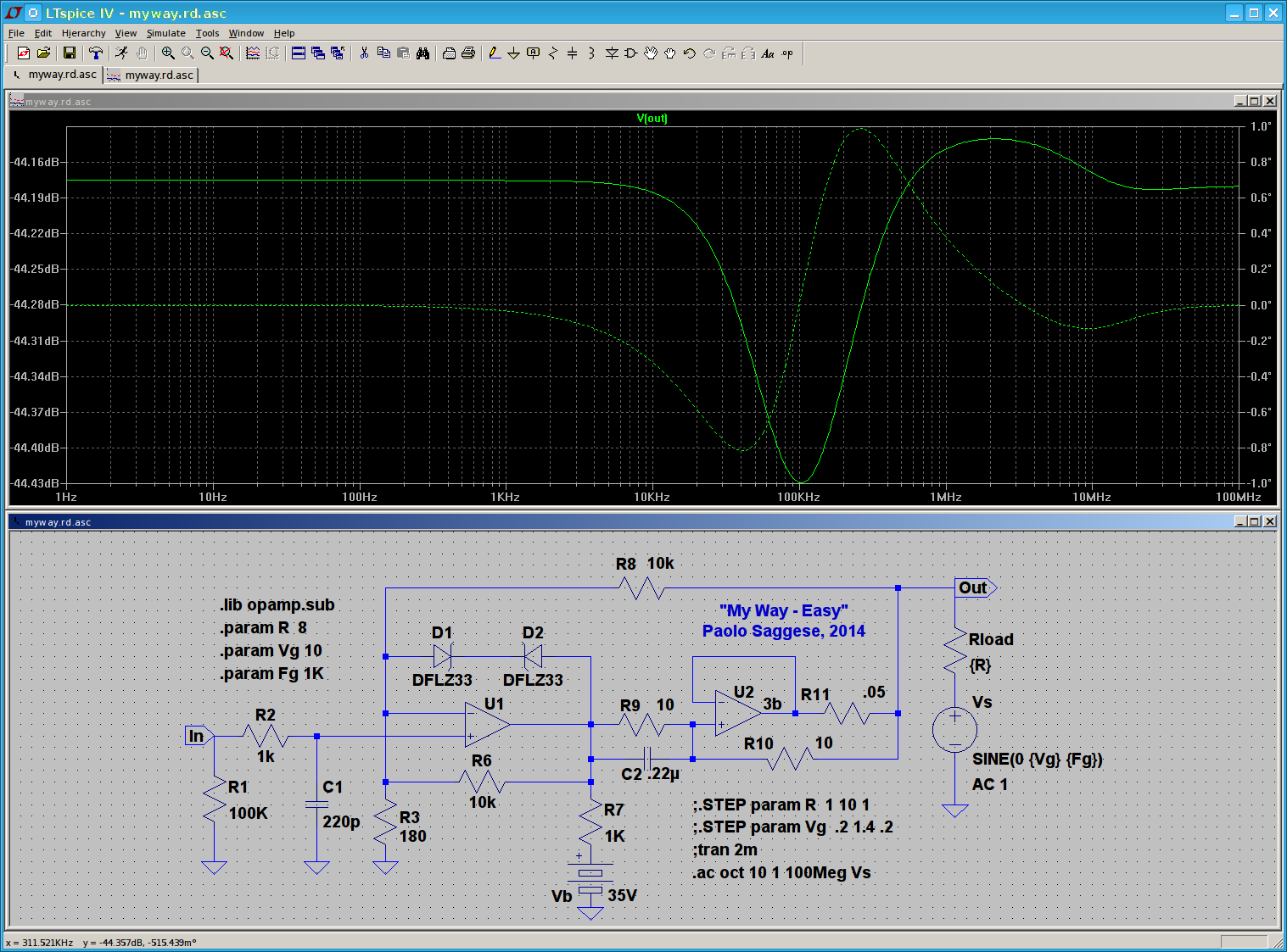

much better than that, you can connect a sine voltage source in series with a resistor equal to the typical amp load (e.g. 8 ohm) at the amplifier output and plot the amplitude/phase diagram WRT frequency (AC response).There is no need to use the equation, LTSpice is able to plot the output impedance directly (assuming the amp simulation works and all the SPICE models used are fairly accurate). You can do this by shorting the input of the amp to ground, connect a 1A current source to the output of the secondary and ground, then plot the output voltage, please try it and see if this works for you.
This will tell you not only the output "impedance" (resistance) at DC (which can be easily calculated from the attenuation shown on the plot), but will actually show you how it will behave (modulo and phase) with varying frequency.
That's a much more useful information. 😉
(P.S.: do not believe that the typical behavior of a conventional, real-world amp is to have a nicely low, almost constant and purely resistive output impedance as shown in one of the attached plots: quite the contrary! Try and see for yourself...)

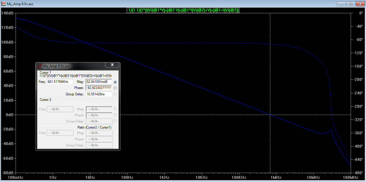

Not sure where to ask this question so I try here. I'm simulating the open loop gain of a circuit. The phase margin (87 deg) and gain margin (24 dB) looks OK, but there is a slight gain peak at around 28MHz, and I would like to know if it's a sign of oscillation.
I suspect not looking at the vertical scale. You are covering 220db. Same for the horizontal axis, a range of DC to 100MHz. lA real build with real devices would be totally different to anything a simulator shows at those kind of levels.

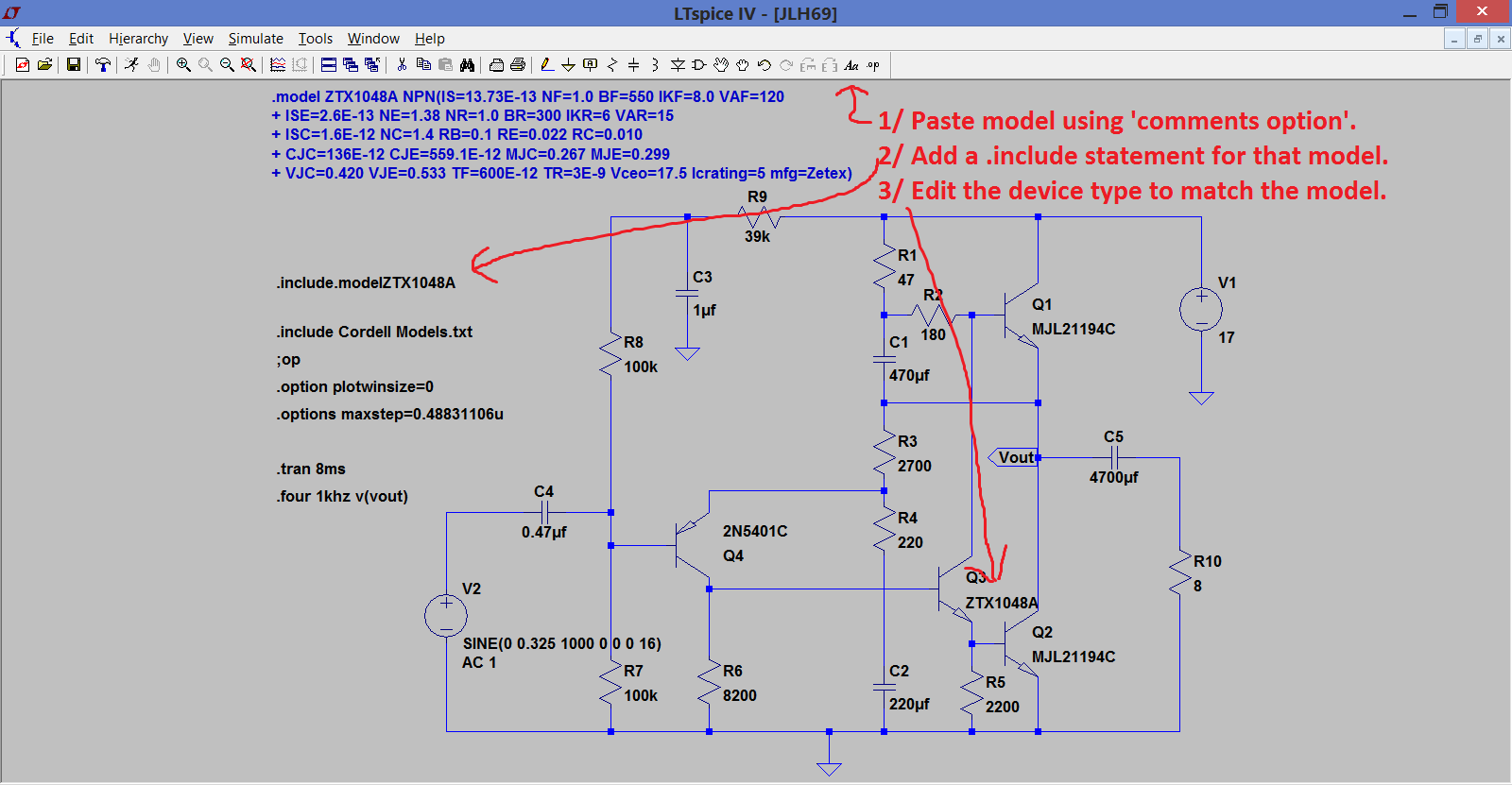

How do I include Cordell models in the asc so that everyone that wants to play can use the same models as everyone else?
Has this been explained in this Thread, including models in the asc. file rather than having them in a look up folder?
Just posted this in the Symasym Thread
I didn't cover this as an option because I felt it was visually messy (if more than say one model is needed).
The diagram shows the steps. You need to acquire the model wanted and make sure it is in a form usable by LT and then paste the model onto the diagram as shown.

I wholeheartedly agree, but it is the most straight-forward way to guarantee that specific models will be used in your simulation.I didn't cover this as an option because I felt it was visually messy (if more than say one model is needed) . . . . .
