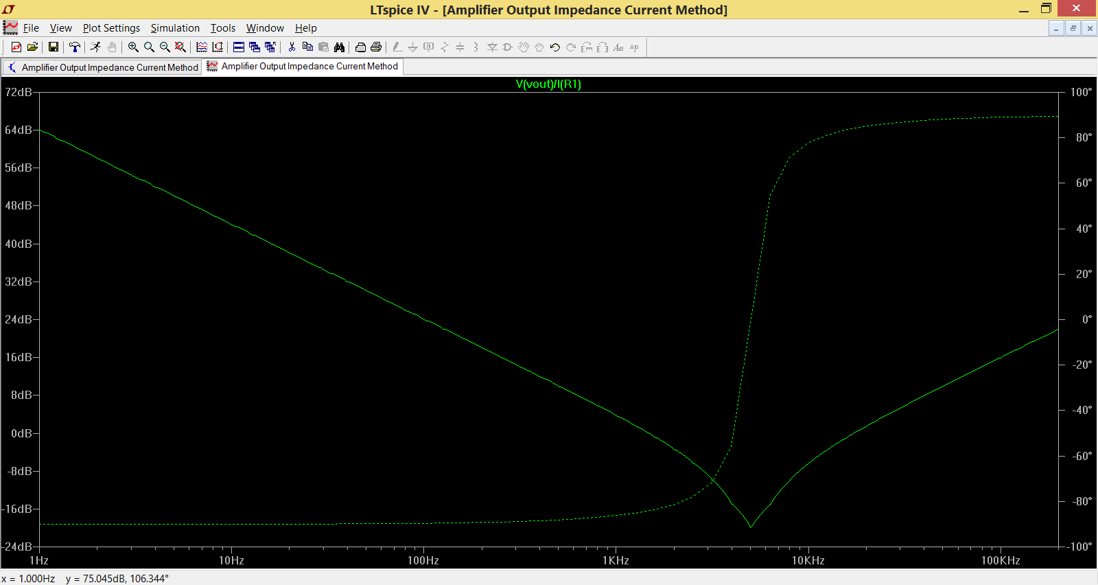

Right-click the Y axis and select Logarithmic or Linear. When the scale is in db LTSpice omits the unit name.

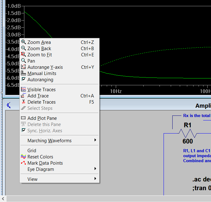

I must be doing something very basically wrong here. If I go over the axis I see the "ruler" symbol appear. If I right click I see this.

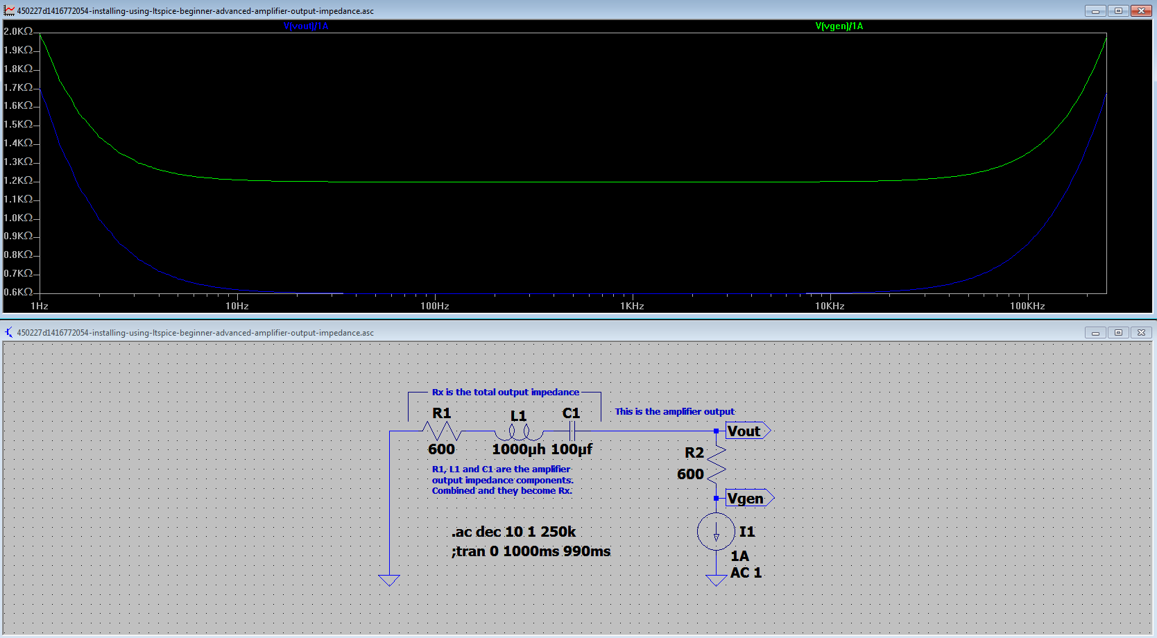

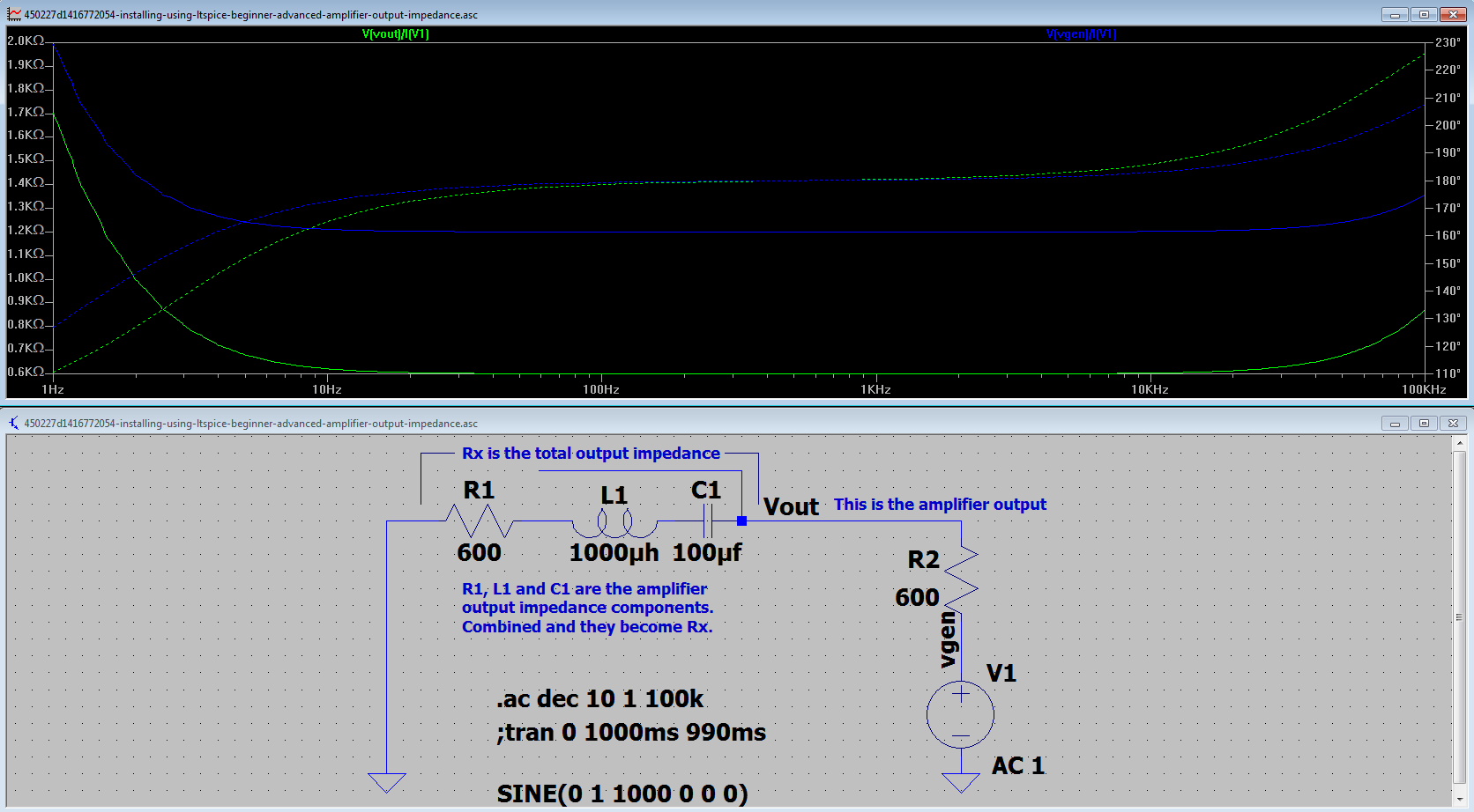

Measuring amplifier output impedance.
Thanks to FdW and keantoken I now know how to get the Y axis to display the apparent Z out in "ohms" and I think I understand using the "current" method rather than the "voltage method" to derive a value for Zout. In some very quick trial runs they seem to produce identical results. Next step is to put some different values into the circuit and try and prove it works by calulating it out as a check.

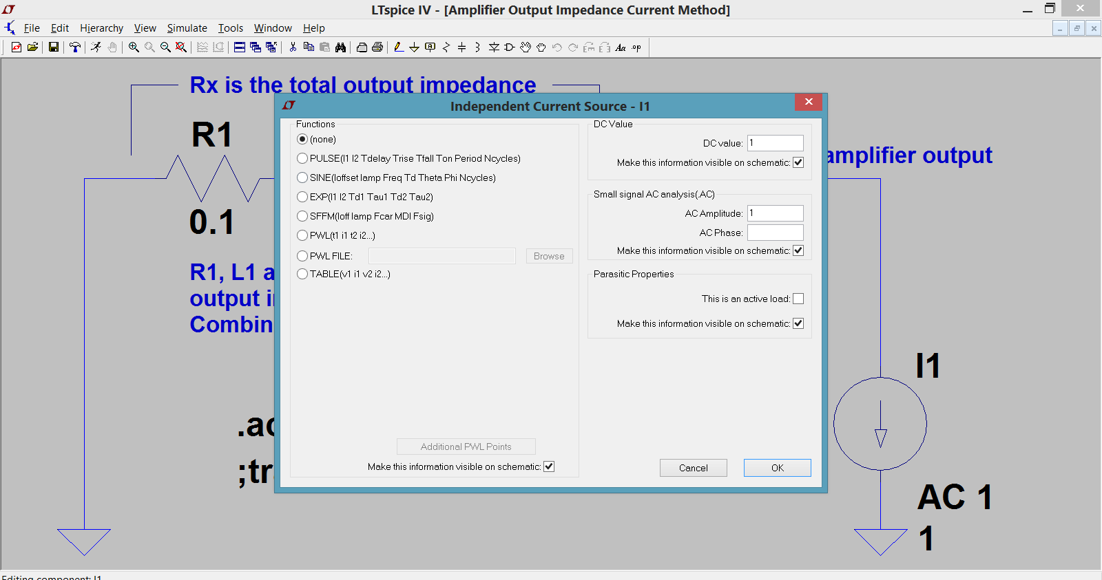

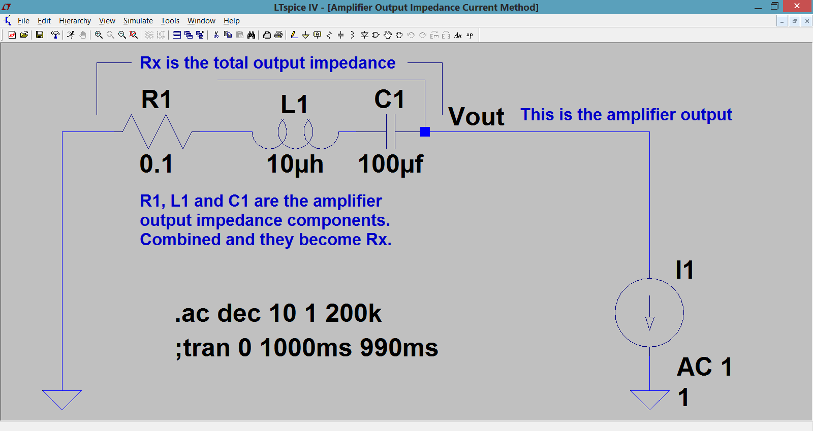

So here is the new circuit. The voltage source has been replaced with a current source (that is selectable in the standard LT parts section). The only changes are that the 600 ohm resistor that was unrealistically high for an amplifier output impedance is now a more reasonable 0.1 ohms and the inductor is now 10uh. I'm leaving the cap as 100uf at this stage as it makes for a nice simulation. The "AC Analysis" has now been changed to cover 1Hz to 200kHz and because we are using a current source, the series backfeed resistor has been omitted.
And the settings for AC Analysis. Even though this is now a current source we have similar options to the more familiar voltage source.

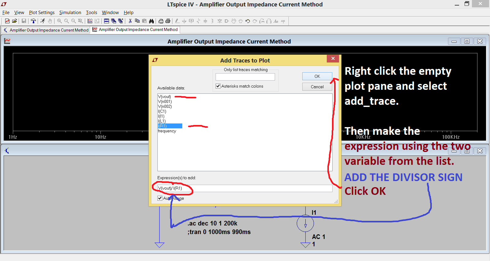

We can now run the sim and enter our expression to calculate Zout. Zout at any given frequency is Zout = Vout/IR1. That is because the current that flows in R1 is what develops the voltage across the amplifiers internal output impedance and we see that as Vout. Knowing those two variables we can work out what the unknown series amplifier output impedance must be. What we are plotting is that calculation, and displaying the result in ohms on the Y axis together with frequency on the X axis.
So we run the sim but this time we do not probe Vout, we right click the empty "plot pane" and select "new trace". Pick Vout and IR1 from the list making sure the divisor sign is added. Then click OK.

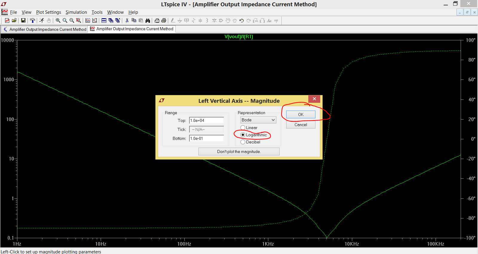

You should now see a plot that looks like this. What we need to do though is to change the units at the left into ohms (Thanks keantoken🙂)
If you now move the cursor to the left of the screen (over the Y axis) you will see it change to a ruler symbol. Left click and select "logarithmic". Also make sure that "Bode" is selected as default. When you click OK the units at the left should change to ohms.
Now you should hopefully see this. Notice how the impedance dips to a minimum of around 0.1 ohms at around 5kHz. Below this point, the effect of the 100uf cap is dominant and causes the expected LF roll off. Above and the inductor comes into play causing HF roll off. However its a little more complicated than than that, and I want to go on and try and "prove" the results.

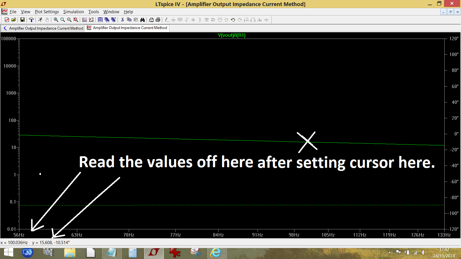

This is now the point I wanted to do a quick check by working it all out long hand 😱 I have picked two frequencies of interest, 100Hz and 20kHz. If we run the sim and look at the graph, we can, by mousing over those two points on the curve, read off the impedance. Don't try and read the graph directly, use the numerical readout at the bottom left of the screen. Here is a shot with the area around 100Hz zoomed in up close and the values shown at the bottom.
I make the values around 15.6 ohm and 1.18 ohm respectively. Now to prove it by calculation and also by reconfiguring the sim to something more familiar as a double check.

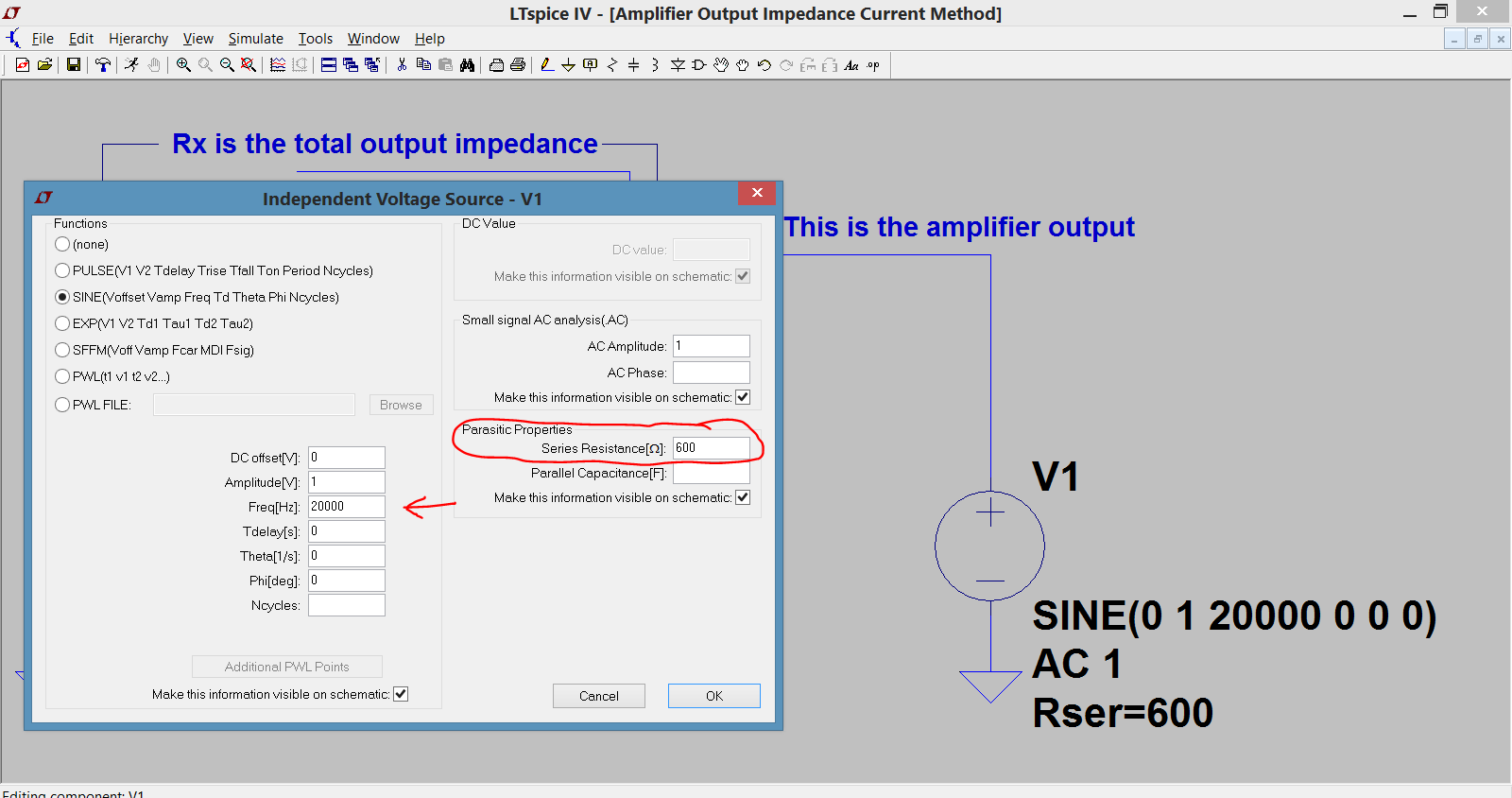

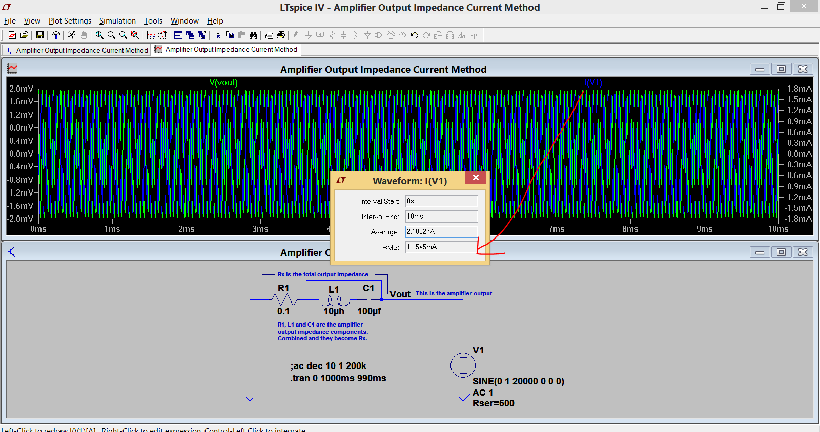

We can run another check that brings us back to more familiar territory. If we set the sim up again but this time with a voltage source together with its series resistor we can simply read off the RMS current in the series backfeed resistor and also the RMS voltage at the amplifier output. Remember to set
the voltage source to the frequency required, 100Hz and 20kHz in this case and to change the sim type to "transient". For 20kHz we get a current 1.1545ma RMS in R2 and a voltage 1.364 vRMS at the output. Z= V/I which is 1.18 ohm.
Here it is set for 20kHz with the source current and output voltage displayed. Notice how I have added the 600 resistor directly into the voltage source as a series impedance.
So all methods seem to be giving the correct values which is really good.
