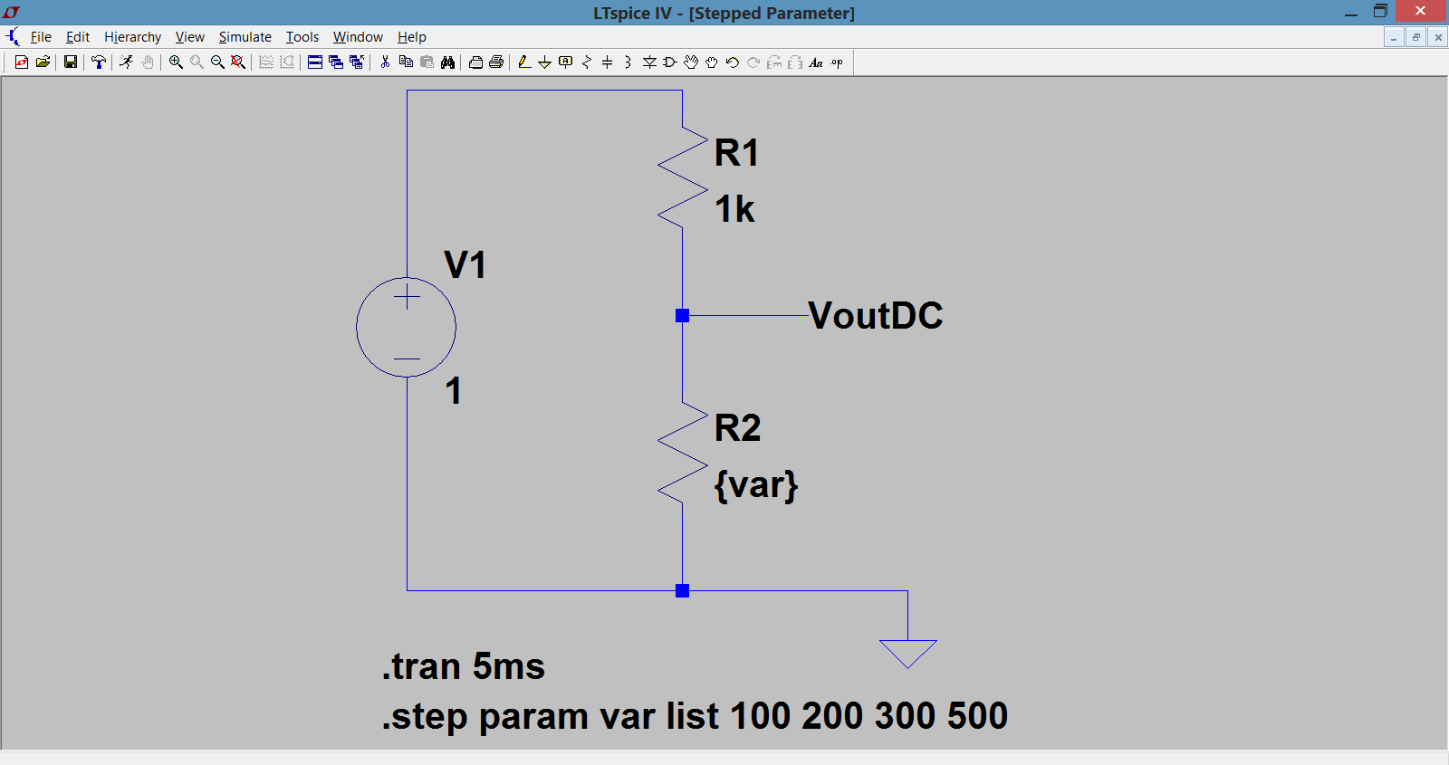

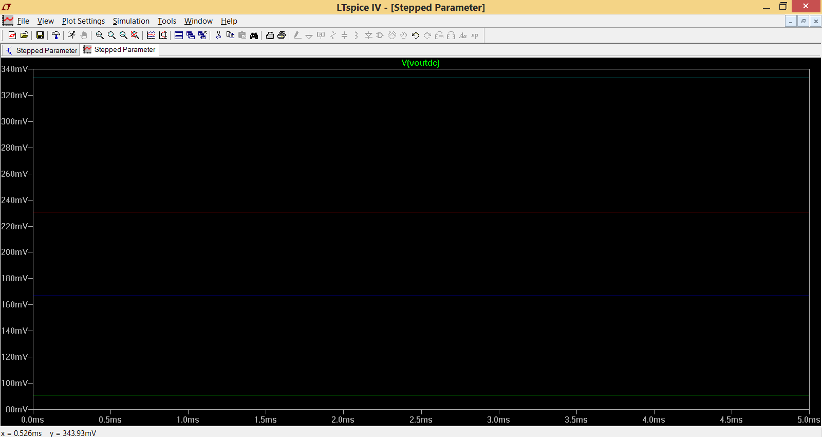

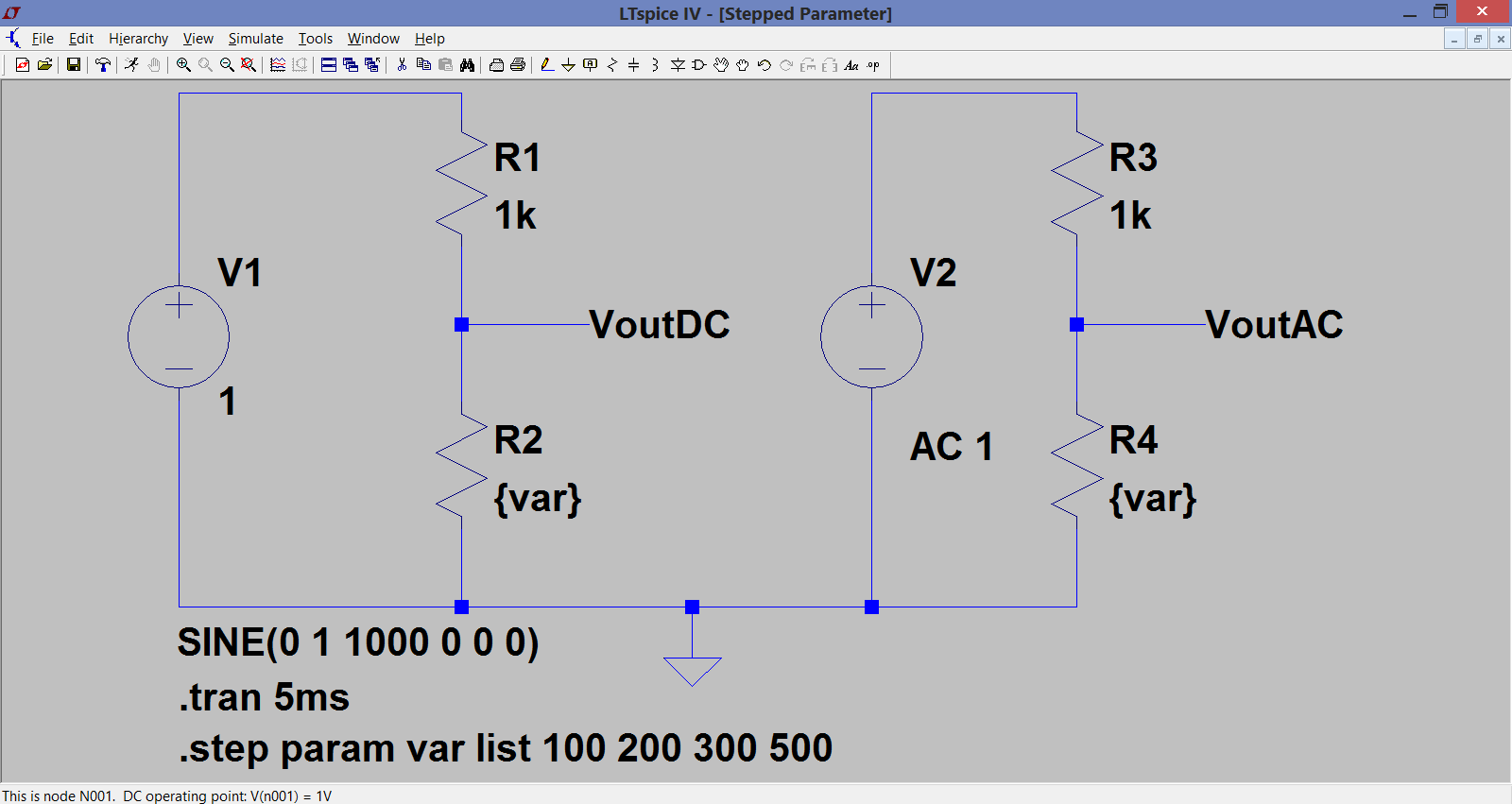

What we will do here is build on the basic command and hopefully take it in stages to something more useful. As a starting create the following circuit. Its just a DC voltage and two series resistors. The value of the lower one is the one we want to alter and so we give it a value of {var} Note the squiggly type bracket symbol that is used. Set the sim up to run as a "Transient" and use a value of 5ms (that value will make more sense later on). Now we need to choose values that we want to use for this variable and we shall pick 100, 200, 300 and 500 ohms. Next we need to enter those into the sim and we do this using the step param directive.
The full syntax is .step param var list 100 200 300 500
That will allow LT to call up each of those values in turn for ANY resistor marked {var} on our circuit diagram.
When you run the sim and probe Vout you will see three traces, each showing the DC voltage expected for each resistor.

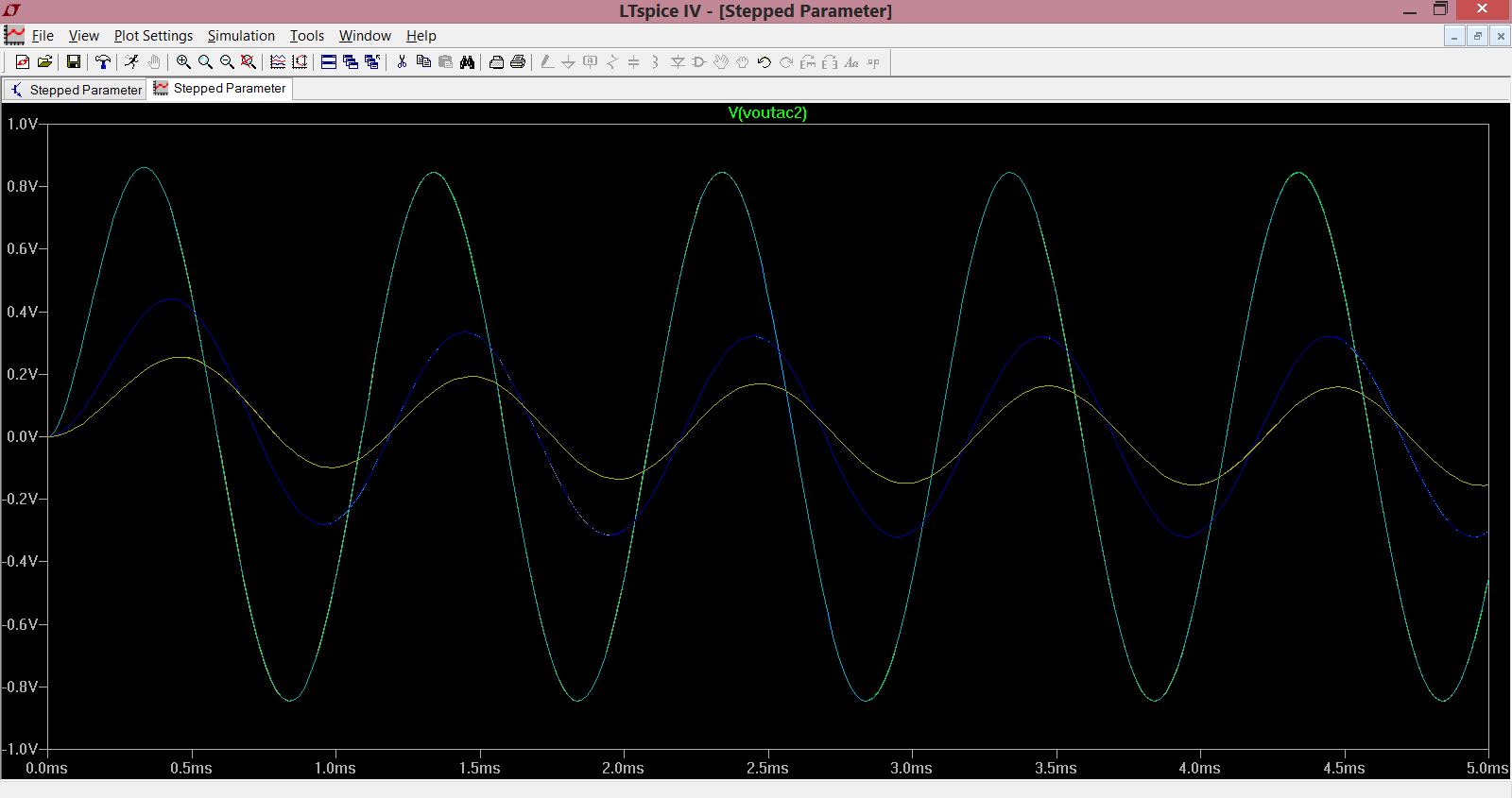

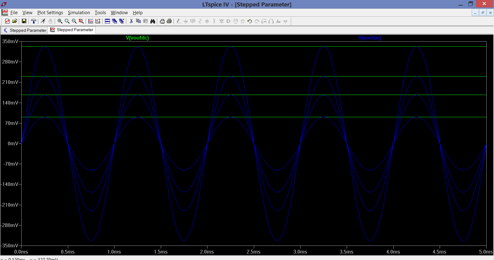

Next we will build on this and add another stepped component, in this case another resistor but this time fed from an AC source. Set the circuit up as shown with the AC source as 1 volt 1kHz. Label the output node VoutAC. Running the sim now produces two sets of traces and you can see that the peak voltage of the AC signal matches the DC values of the first sim.

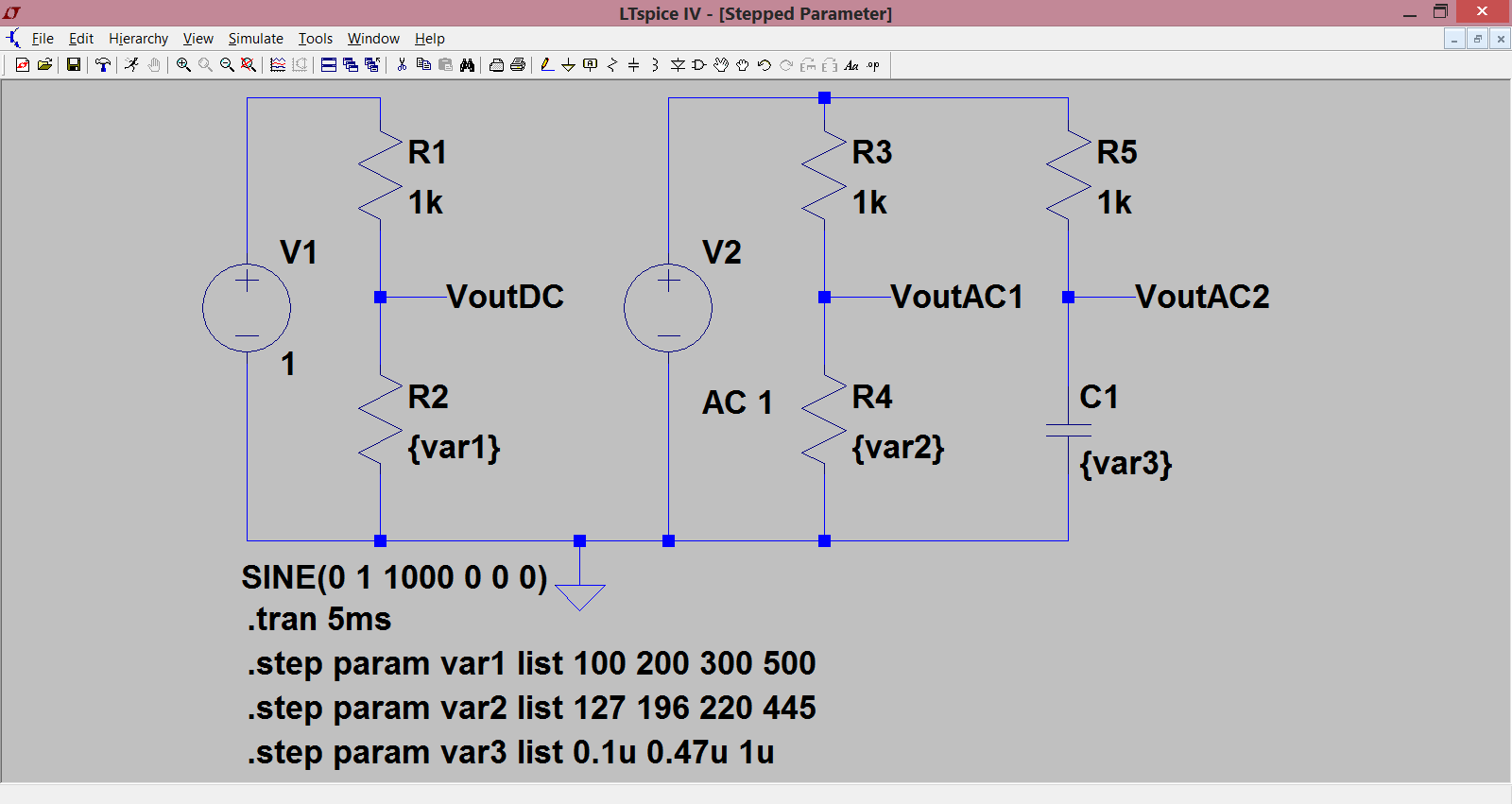

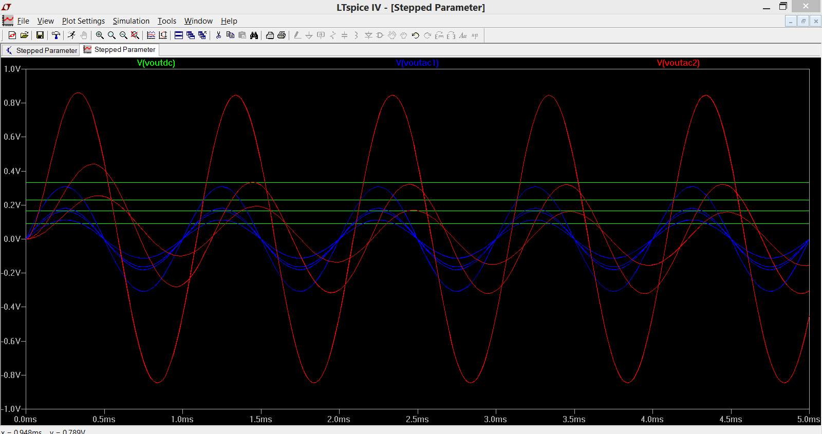

What if we want to step a couple of variables ? or three ? and make them all different. Have a look at this example. Here we have our DC source, the AC source which has had its output relabelled VoutAC1 and now we have added a resistor and cap divider also running off the same AC voltage source.
Look at the three variable components. We are now going to alter each to represent a single item in its own right so that stepping one does not interfere
with stepping of another. All we do is call each one {var1} and {var2} and so on and create a .op line for each list. Notice the cap list is 0.1u 0.47u etc signifying 0.1uf (microfard). If we run the sim we can display all traces together (which is messy) or just an individual one (by clicking on the trace of interest at the top of the plot pane). Here is the cap trace. Notice how each shows not just the "attenuation" of each cap but also the phase difference each introduces. Pretty neat eh :)
And here are just the cap traces.

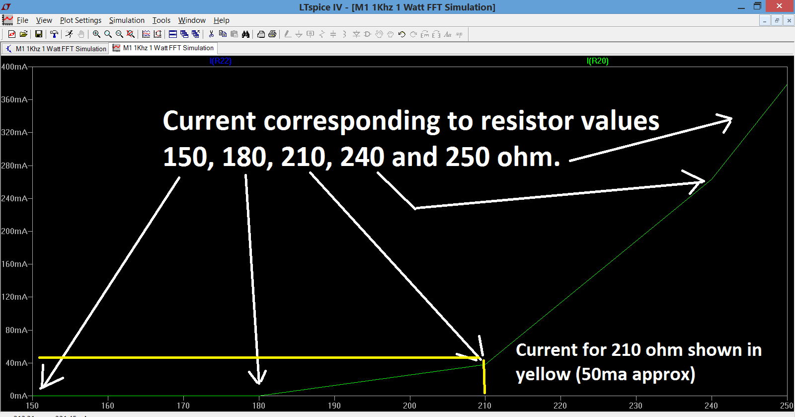

Stepping the bias of an amplifier.

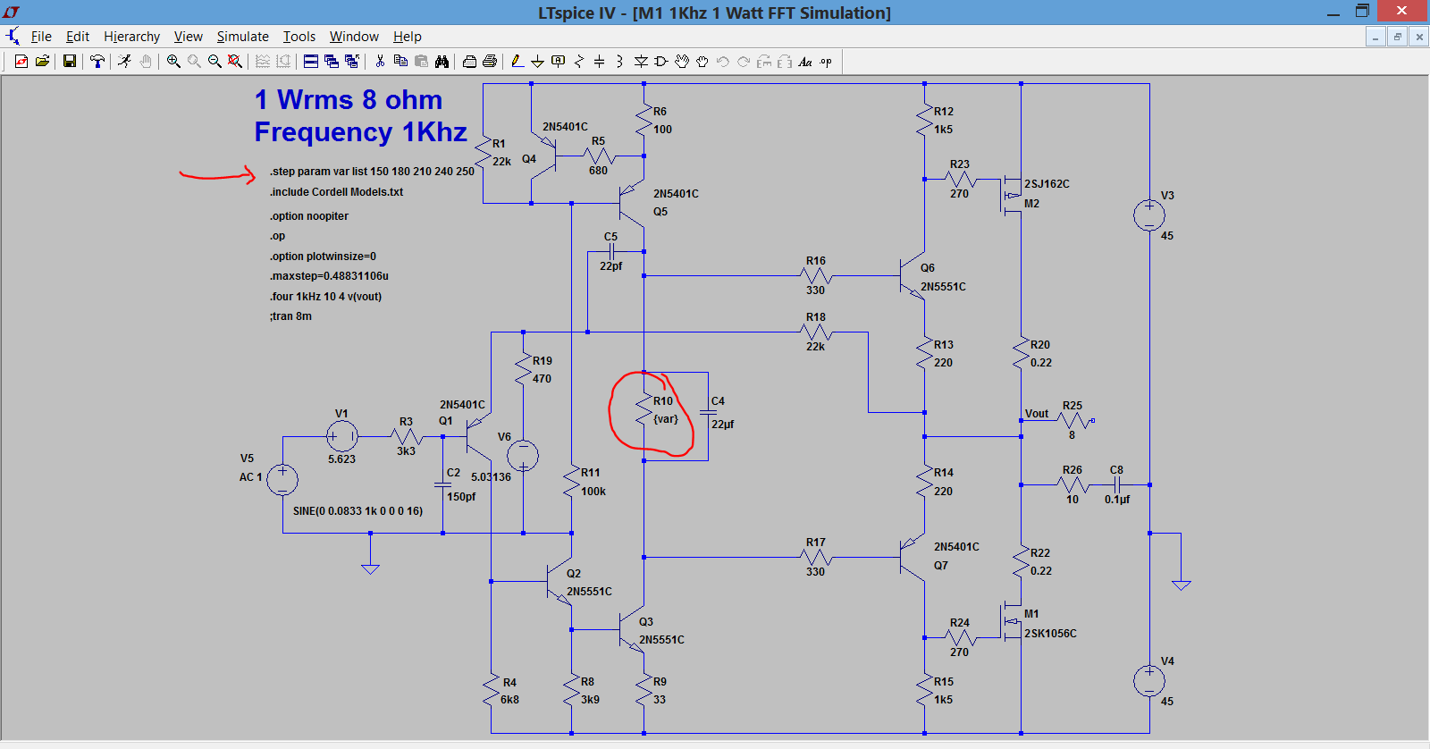

Lets now put some of this into practice on a real amp and for this I've chosen my own lateral fet design. In the first instance we will step the bias setting resistor R10 through five values between 150 and 250 ohm going up in 30 ohm steps. The Spice directive is .step param var list 150 180 210 240 270
and the resistor in question is R10. Set the sim to run as a "DC op pnt" and run.
If you now probe either of the two 0.22 ohms in the FET drains you will see this. Notice that because of the variable command the sim is now an active trace of what is going on.
You can see the five distinct points corresponding to the five resistor values chosen and for each point a corresponding bias current in the outputs.
More is better...

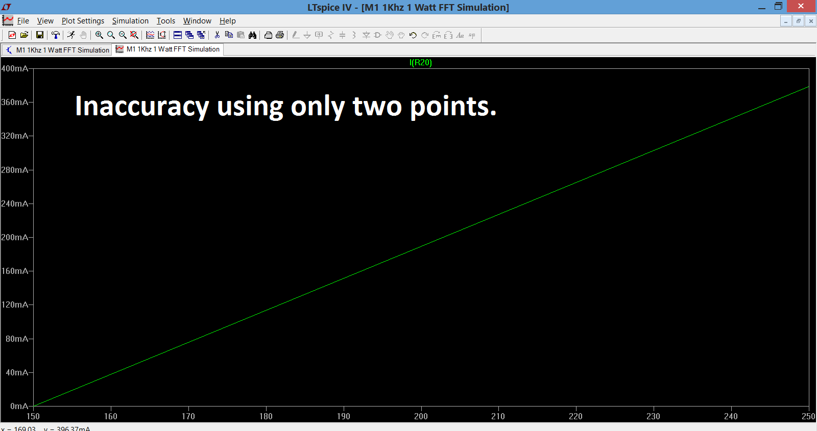

What then if we just picked an upper and lower value of resistance to try ? Well we could test it and see. Lets choose 150 and 250 ohms corresponding to our min and max values above and run the sim again.
This time we get a nice transfer characteristic but its not accurate. LT has just joined up the two dots. For example in the first run we could see that around 220 ohms might give a current of 100ma. Here though it gives nearer 250ma, and that is inaccurate. So we need more points and as such more really is better.

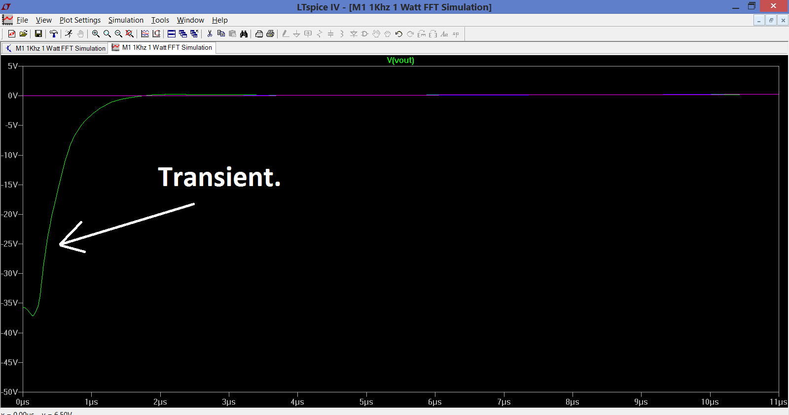

At this point it seems wise to mention a peculiarity I noticed with the sim. The keen eyed might have spotted that the 8 ohm load resistor is not connected and the reason for this is that the sim with the {var} command seems to generate a transient pulse right at the start that renders the readings meaningless (try it and measure the current in the lower 0.22 ohm). This shows the spike which is not present with a fixed single value for R10. If the load is present then this transient generates a massive current in the (lower) 0.22 ohm.
I have no explanation for the reason for this.

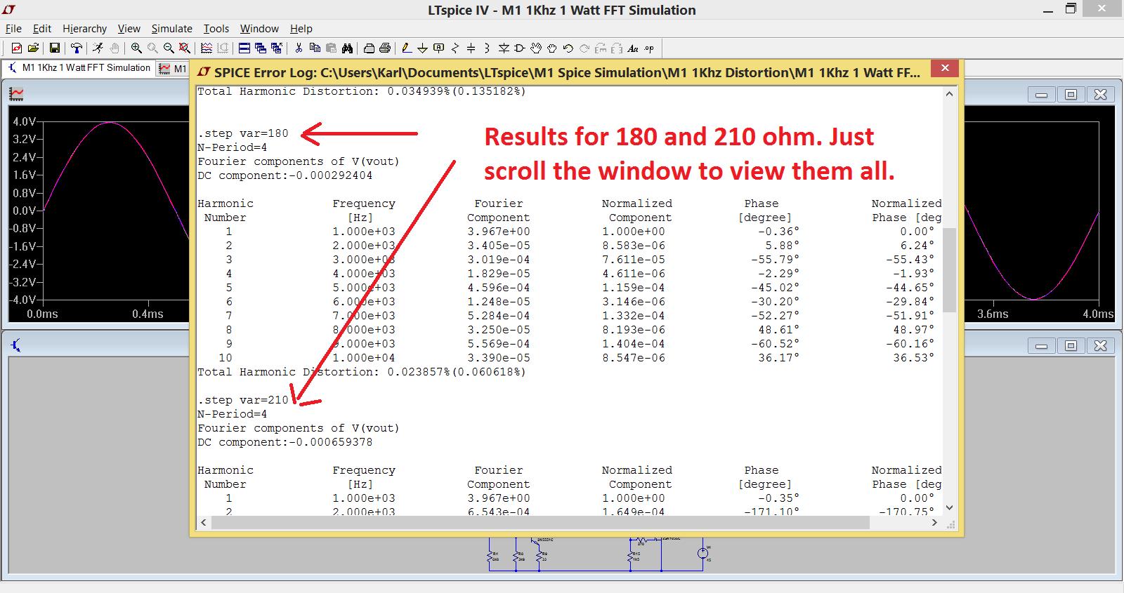

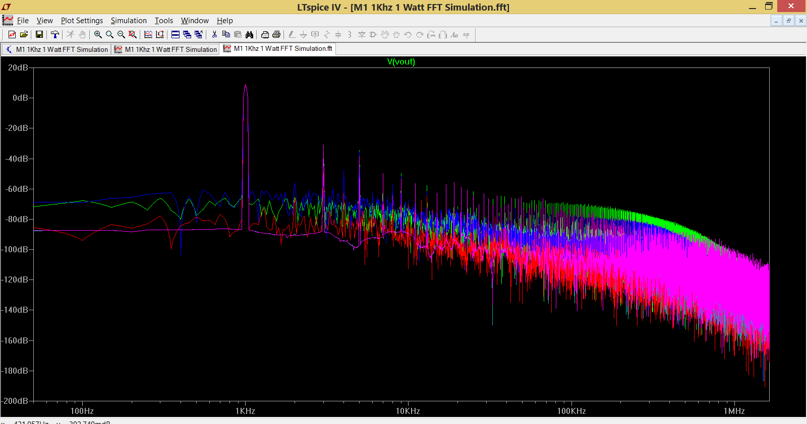

So continuing on... we can set the sim up and examine the effect of changes in bias current on distortion. We change from a "DC op pnt" sim to a "Transient" and reconnect the load resistor. Running the sim produces a complete entry in the spice error log that shows the distortion for each step
change in bias (refer to earlier installments on how to measure the distortion of an amplifier).
We can also look at the FFT plots and here we see a result for each change in bias. Slightly messy and meaningless.
The .asc file is attached along with the models needed. Keep them both in the same folder and the file will run straight off. The load resistor is disconnected.

A simple technique is to create two sets of components which are in circuit all the time, and switch one lot on and the other off, for each run. And the simplest switch, which can be repeated any number of times, is a resistor which takes 2 values of resistance in the steps - one ridiculously large, say 1TR, and the other likewise small, say 1fR - exactly equivalent to open circuit and close circuit links. Easy to do, and very useful ...
Ok, I think this is a (partial) solution:
create two distinct directives:
.step param X list .....(n)
.step param Z list .....(n)
replace value field in the components of interest by {X} and {Z}
run the sim
You will be given n times n results, of wich you need only the ones wich have X and Z the same figure (take a look at the Spice error log list)
Though I'm sure that there is some smarter way to do the same
