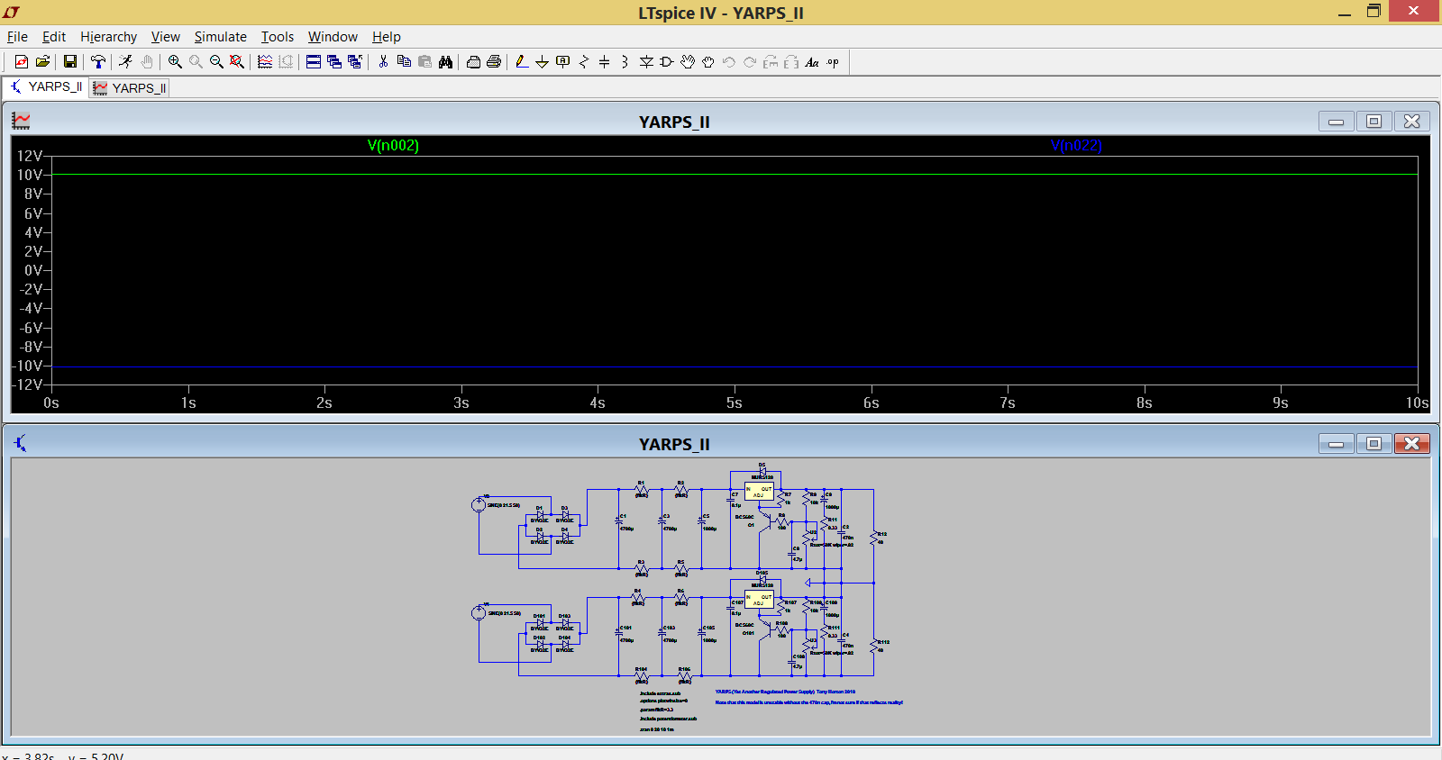

Hello,
I would like measure multiple OP on a diagram and put them in the log file
I try .meas op Ie(Q1) and It work, but if I had an other meas it does not work
Could you help me ?

That is something I have never tried. I'm not quite following you actually because the error log shows the transistor currents for all the devices... you mean something else ?
We can see all current in the view "Spice error Log" but this is not the log file
for a diagram.asc when you run simulation, a diagram.log file is created but not with the same content.
I need the values in the diagram.log
That is something I don't know I'm afraid. I'm sure if anyone else knows then they will hopefully chime in.
I don't follow what UlitmateX86 is asking - from the LTspice help file:
.MEAS statements are usually just put on the schematic as a SPICE directive or in the netlist with the rest of the simulation commands and circuit definition. The output is put in the .log file which can be viewed with menu command View=>SPICE Error Log. If the simulation includes a .step command, the .measure statements are executed for each step and the results are printed as tables in the .log file.
What other measure that didn't work???
Oops, I can see the error, but I'm not sure what causes it as I'm away from my computer (LTSpice). But why not use formula instead? You can label the circuit with meaningful labes to make this easier. And it would be easier for other to solve if you post the ASC file.
It looks like you are putting both values into OP in the .meas OP .... whatever, you should remove the other errors shown which may be the cause...
