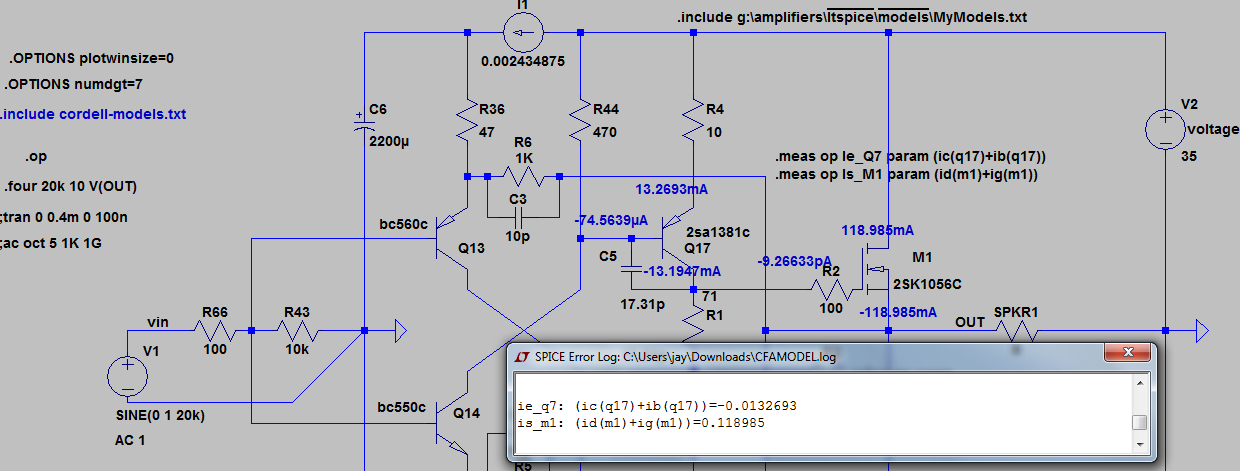

I try .meas op Ie(Q1) and It work
May be you have assumed that it worked while actually it didn't?
May be you are trying to do/achieve something which is not what others would do to do/achieve the exact same thing? (I think it is better if you ask a general question such that you are not tied to a procedure which might not be a best practice)
The operating points of the devices are already complete in the log file. "Ie" is not displayed but it is a function of "Ib" and "Ic". "Is" is also not displayed but it is a function of "Ig" and "Id" (but of course you should be aware of the issue with signed numeric in LTSpice).
So what for is these "Ie" and "Is"? If you need to build an equation, the following (see attachment) will do it, if it is what you want.
I displayed the simulated OP on the circuit (Ib/Ic/Ie/Ig/Id/Is) so you can compare and validate the result.
