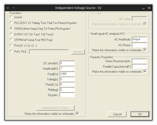

I did up to this point and change to .mod. It still gave me error. This is the error message:
Circuit: * C:\Users\Chicky\Desktop\Revera\Simulation\Adding Models 1.asc
Error on line 6 : v2 n004 0 sine(0 .1 1000 0 0 0) ac vinput

Right click on V2 and in the AC Amplitude box change "Vinput" to "1".

Thank you. I was wondering why the AC amplitude is "Vinput" instead of a number.Right click on V2 and in the AC Amplitude box change "Vinput" to "1".

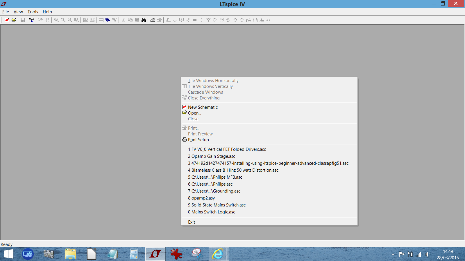

I get that same error message on W8.1 too. I also got it in W7. If you locate the file via LT it will not do this.
Also, once you have run a file then LT 'remembers' and you can instantly load it via LT just by right clicking the empty workspace and selecting the file. The last 10 files used are remembered in the order they were last accessed.

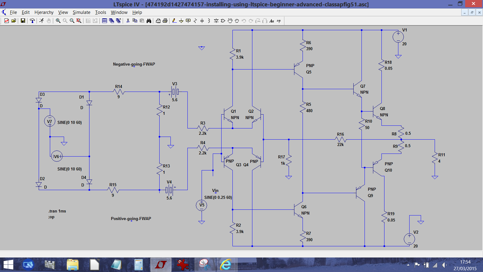

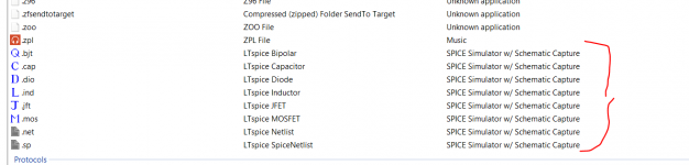

Hello Mooly. I was not successful using the LT route which gave the attached but not the actual schematics. The audioamp attachment is an example from the LT examples collection.

Those files open correctly for me. What are you seeing ?

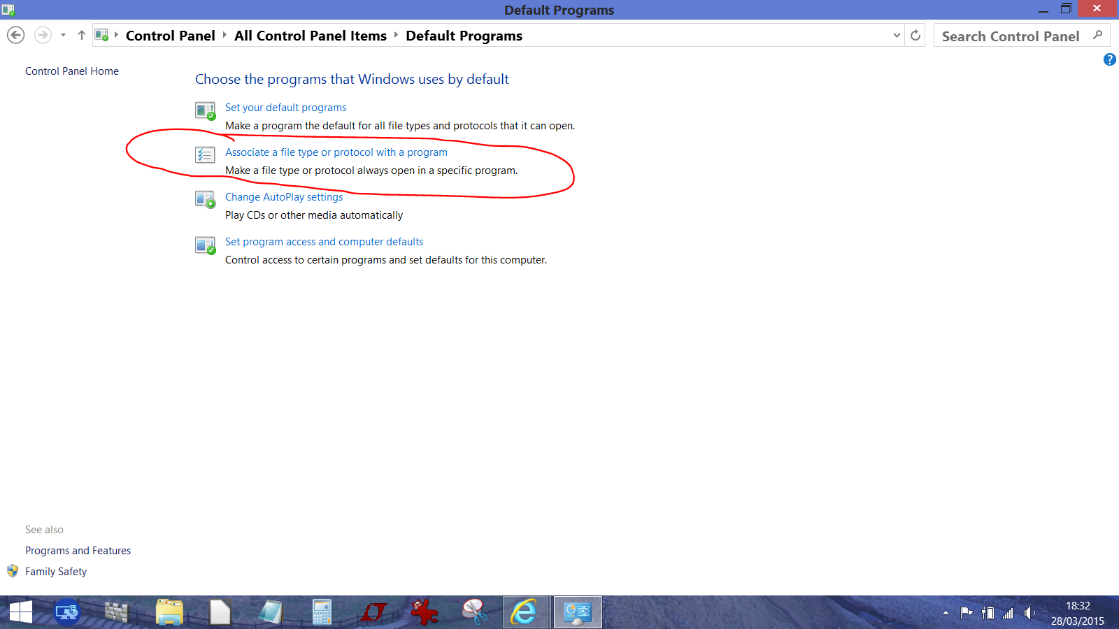

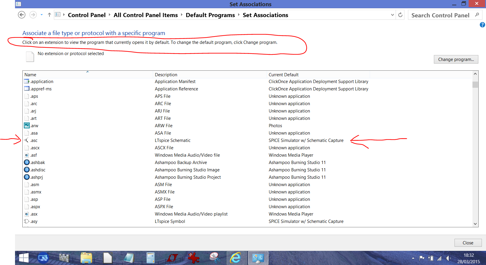

Does this help (W8.1). Go to Control Panel on your PC and click on Default Programs. Now click on Associate a file type or protocol with a program and make sure LT is the default. It will be similar in W7 and probably Vista.

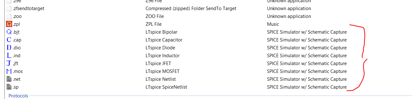

Edit... there are more to check. Look for .asc, .asy, .cir and the ones at the end of the list as shown in the attached image.
