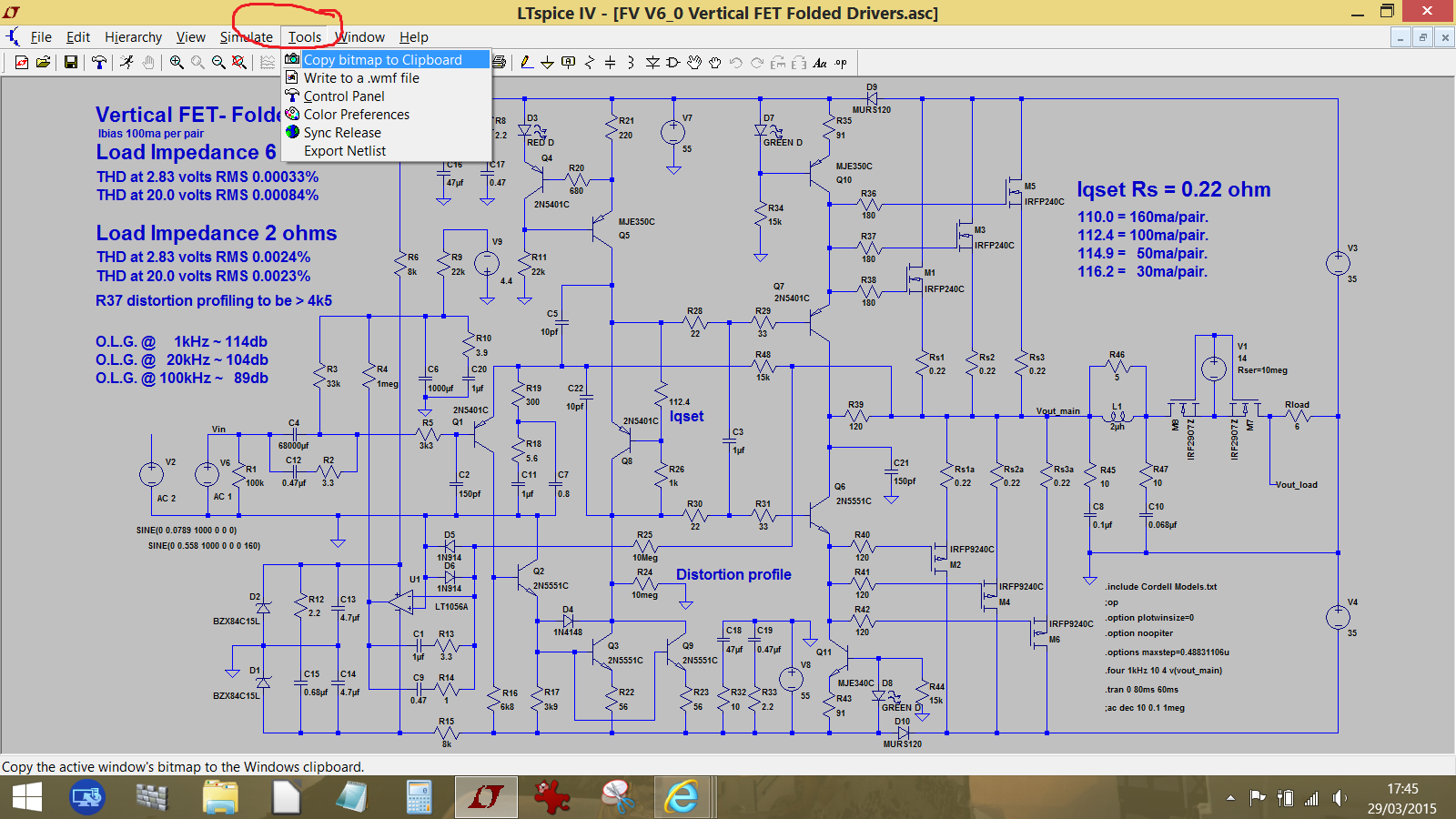

Also, I gone into tools and I don't know how to save as image. I always want to know how to copy the schematic from LTSpice into JPEG image. Can you elaborate a little?

Many ways. In the Tools menu the first option is Copy bitmap to Clipboard - select that, and then in any painting or image editing program, like Windows Paint, just do a Paste. Should see the image, and then save as JPEG, etc.Also, I gone into tools and I don't know how to save as image. I always want to know how to copy the schematic from LTSpice into JPEG image. Can you elaborate a little?

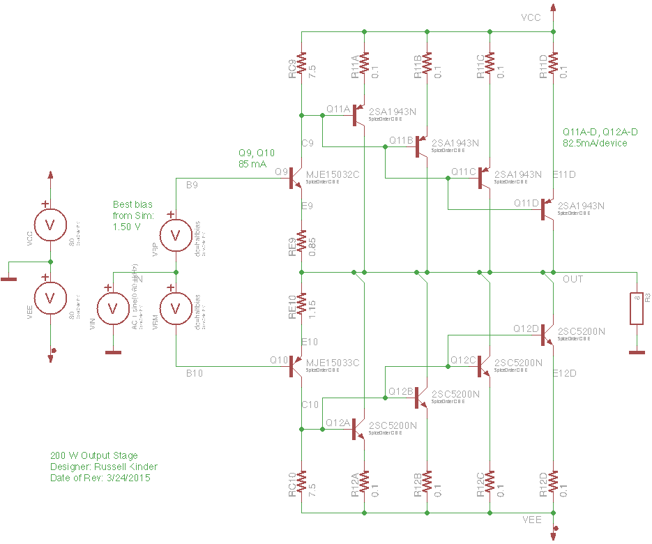

I've recently decided to do some audio amp design at home, using my old, trusty Mac. Will get a PC for the purpose later, but for now, it's my 7 year old iMac.
I found Eagle and LTspice native on the Mac, for free from their respective websites. I found a file called spice.ulp from the Eagle website that lets Eagle export a spice netlist. I edited spice.ulp, because it spits out a bunch of junk comment lines, which made the netlist harder to read. Fixed. Turns out the .ulp scripting language is pretty standard codespeak.
Schematic capture in LTspice works OK, but I can't make a PCB from an LTspice schematic, so Eagle is used. Also, it's ironic that LTspice for Mac has a reduced gui, and works using keyboard shortcuts.
So far, so good, and relatively easy. I thought I'd start by simulating an output power stage for a 200+ W amp. Here's the schematic, the netlist, and a transient simulation:

Thanks, you make my day. It's so easy.Many ways. In the Tools menu the first option is Copy bitmap to Clipboard - select that, and then in any painting or image editing program, like Windows Paint, just do a Paste. Should see the image, and then save as JPEG, etc.

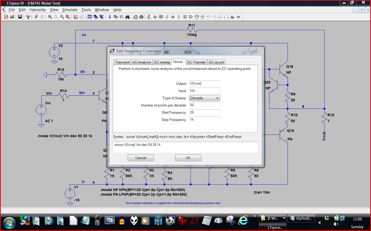

We use the <Noise> tab on the <Edit simulation> option as seen here.

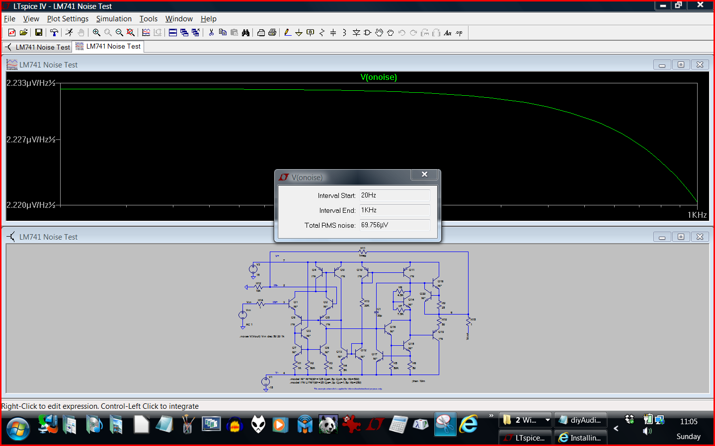

The 741 comes out at 2.2uv/√Hz when looking at the output. LT lets us look at the 'total' RMS value over the frequency range of interest and that is shown as 70uV. The opamp runs on -/+15 volts rails and so might be expected to swing around -/+12 volts at the output. 12 volts peak is 8.4 volts RMS. To see the RMS value just press and hold CTRL while clicking the trace designation a the top of the graph.
Taking these two figures we can then calculate using 20log (V1/V2) that there is a 101 db ratio or signal to noise ratio (which come out the same as the gain... coincidence).
