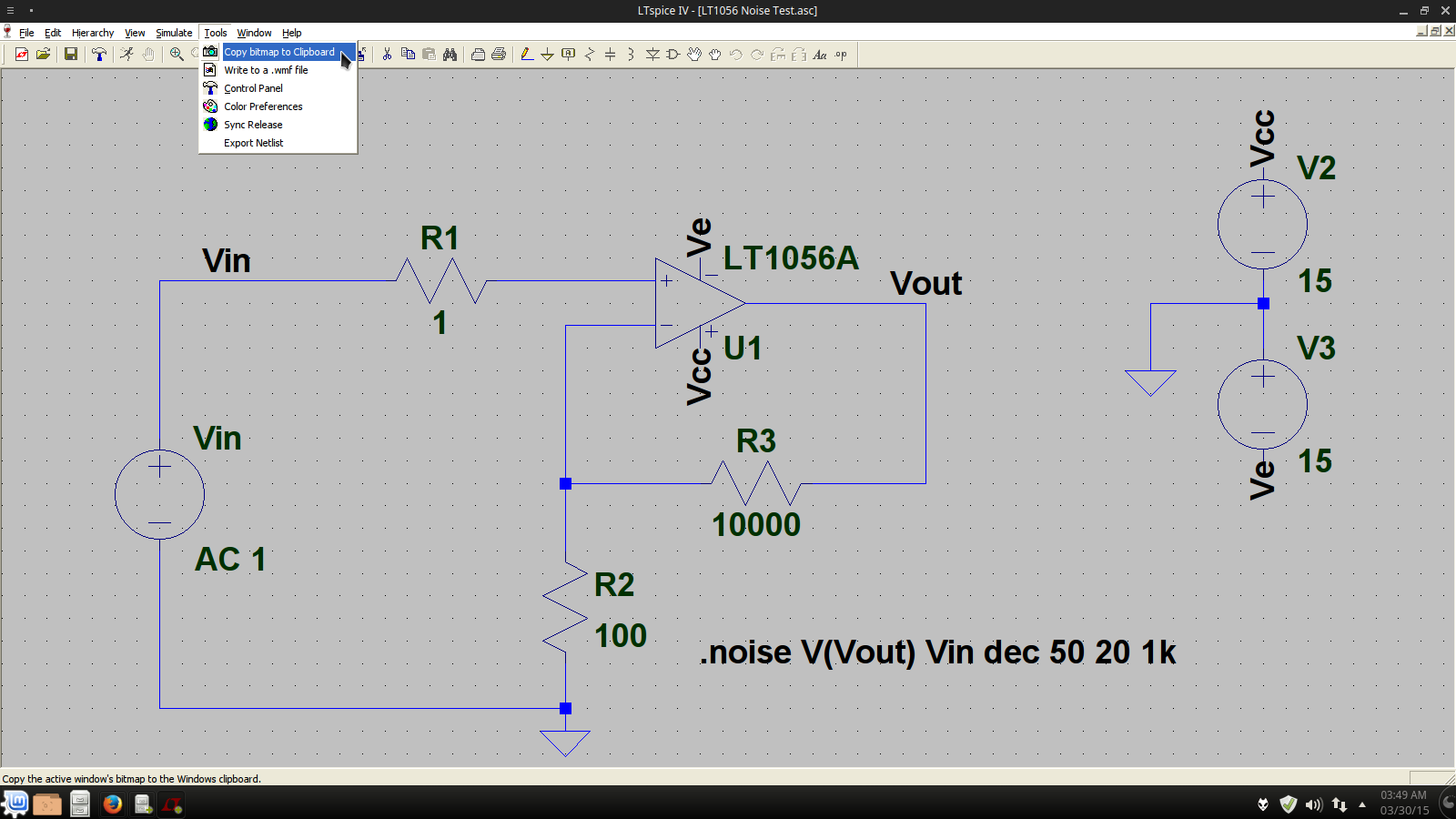

Pretty much every image in this thread has been done with the snipping tool. Vista onwards had it by default.
The other screen grab mode that can be useful is pressing CTRL and PrtnScr together which copies the contents of the screen to the clipboard. This is useful where the snipping tool doesn't work fully such as the example I posted above. Opening the snipping tool here would close the dropdown box under 'tools', the very thing that we wanted to capture.

Yes, it loses focus. Linux Mint KDE's snipping tool KSnapshot has a delay setting which works around that. 🙂 BTW the copy to clipboard function under tools is available in LTspice running under wine on Linux as seen in the KSnapshot below:

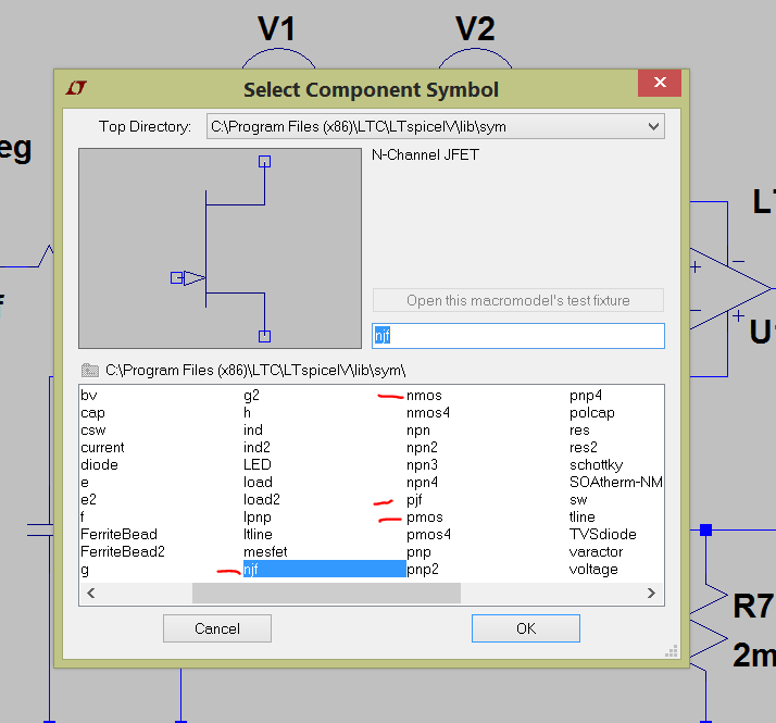

Hello Mooly. I hope that you [and hopefully others too] find time to instruct beginners in using Mosfets and Jfets in LTSpice models of audio amplifiers etc. Fortunately, there are many example schematics of simple diy amps from Mr. Pass for this valuable instruction.
Thank you, and best regards..
There are quite a few models for N and P channel JFET's and power FET's already included in LT as shown here. Working with other devices such as Lateral Fets means getting hold of and adding them in the same way as we have covered earlier.

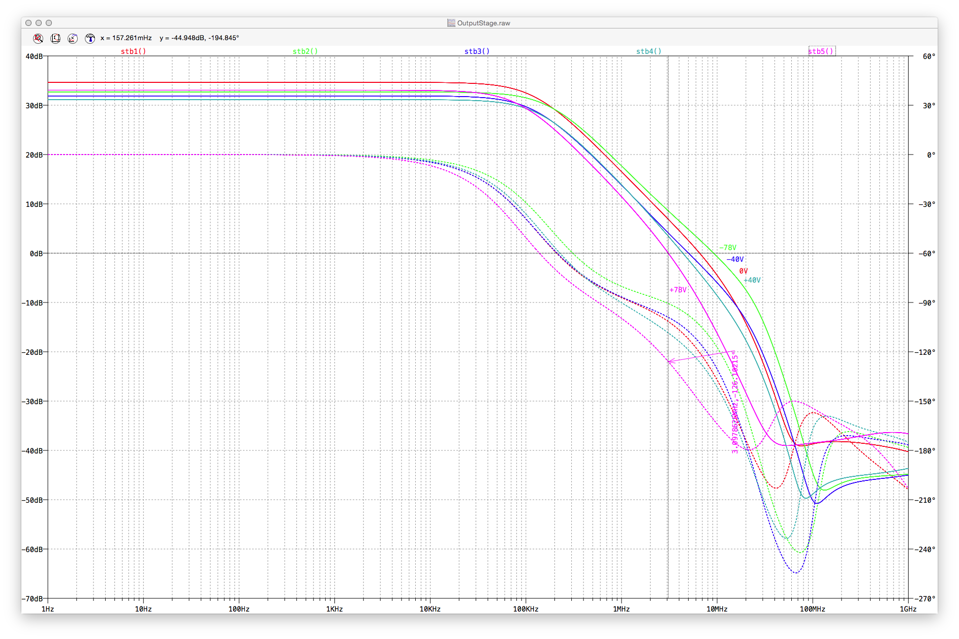

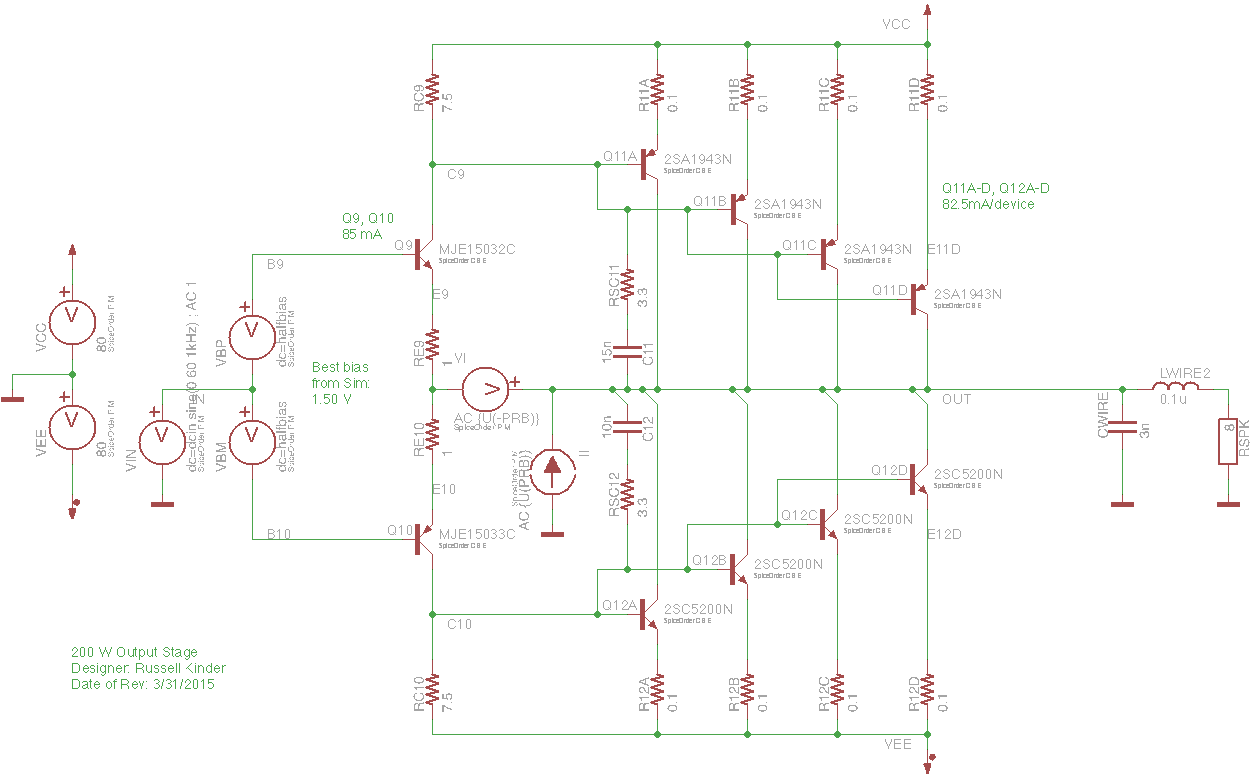

Tian et al Stability Analysis against output swing
OK, I think I've made this work. Multiple Tian stability plots across the signal swing. Thanks to jcx and fas42 for assistance.
I have a 250W CFP output stage I'm working on. I wanted to break the CFB local loop to check GM & PM at several points on the output swing, from -80V to +80V. Here's what I did.
Nested .step sweeps:
.param dcin=0 prb=0
.ac dec 100 1 1e9
.step param prb list -1 1 ; Tian loopbreak probe V1 and I1; set prb=0 to turn off probe
.step param dcin list -78 -40 0 40 78 ; run Tian loopbreak at each of these voltages
One .func in the plot.defs file for each of the dcin values:
.func stb1() -1/(1-1/(2*(I(VI)@1*V(OUT)@2-V(OUT)@1*I(VI)@2)+V(OUT)@1+I(VI)@2))
.func stb2() -1/(1-1/(2*(I(VI)@3*V(OUT)@4-V(OUT)@3*I(VI)@4)+V(OUT)@3+I(VI)@4))
.func stb3() -1/(1-1/(2*(I(VI)@5*V(OUT)@6-V(OUT)@5*I(VI)@6)+V(OUT)@5+I(VI)@6))
.func stb4() -1/(1-1/(2*(I(VI)@7*V(OUT)@8-V(OUT)@7*I(VI)@8)+V(OUT)@7+I(VI)@8))
.func stb5() -1/(1-1/(2*(I(VI)@9*V(OUT)@10-V(OUT)@9*I(VI)@10)+V(OUT)@9+I(VI)@10))
I think I'll start a thread on this, so others can see it, cause it's useful.
Here's the schematic and plots for your viewing pleasure:
