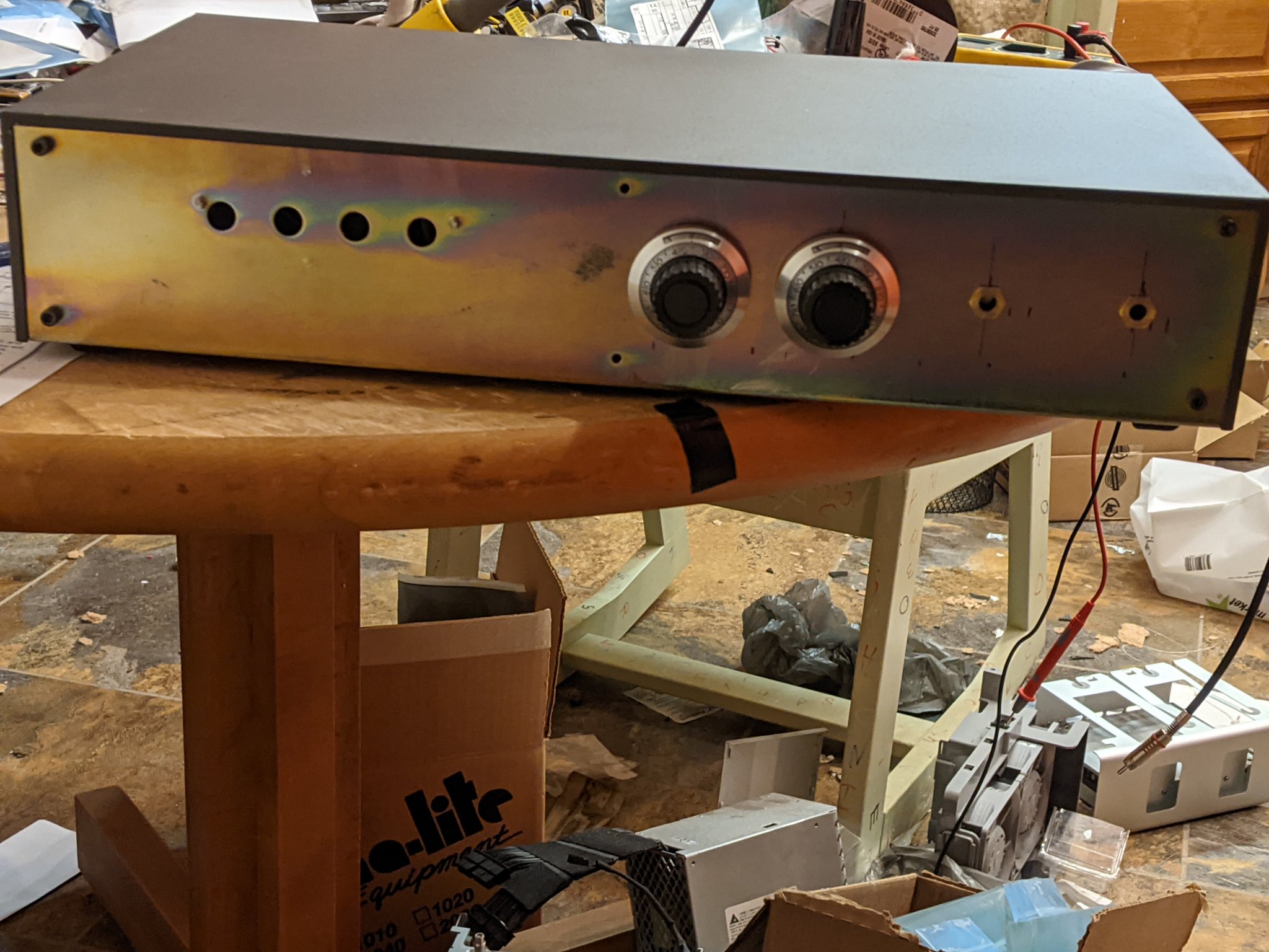

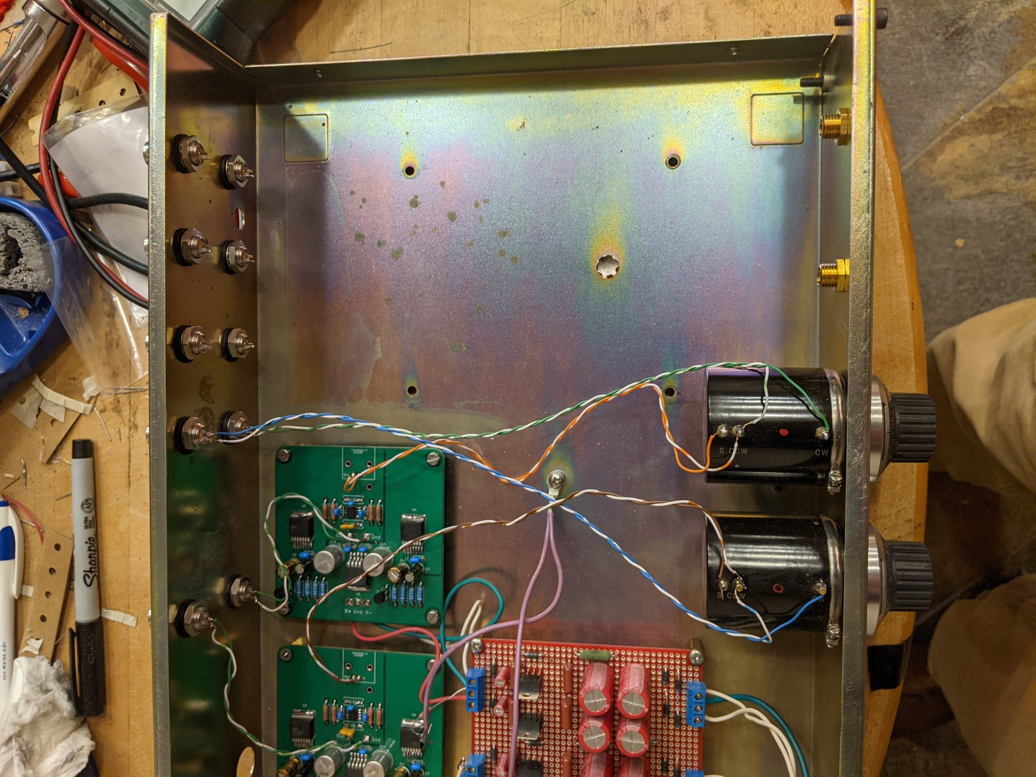

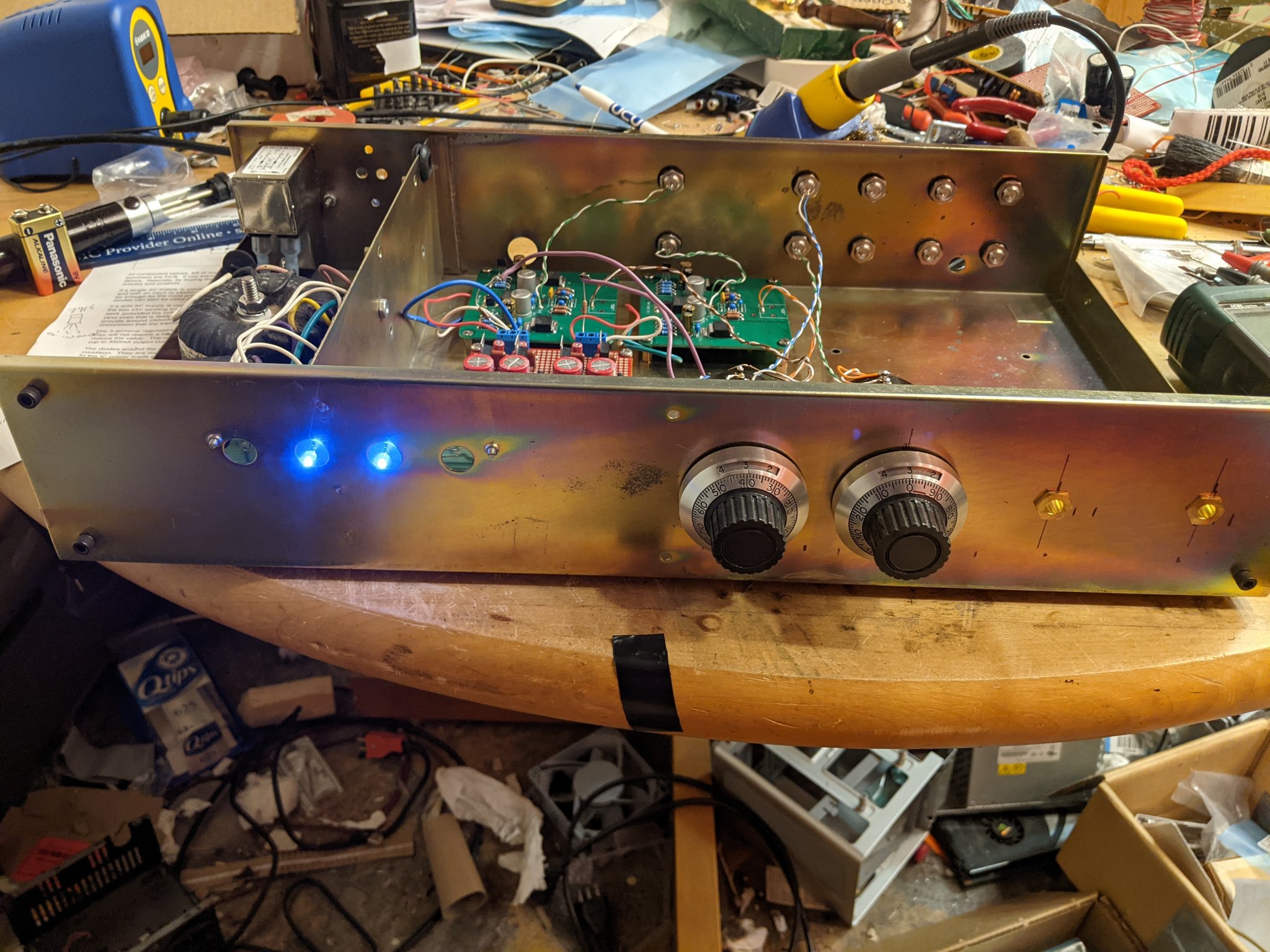

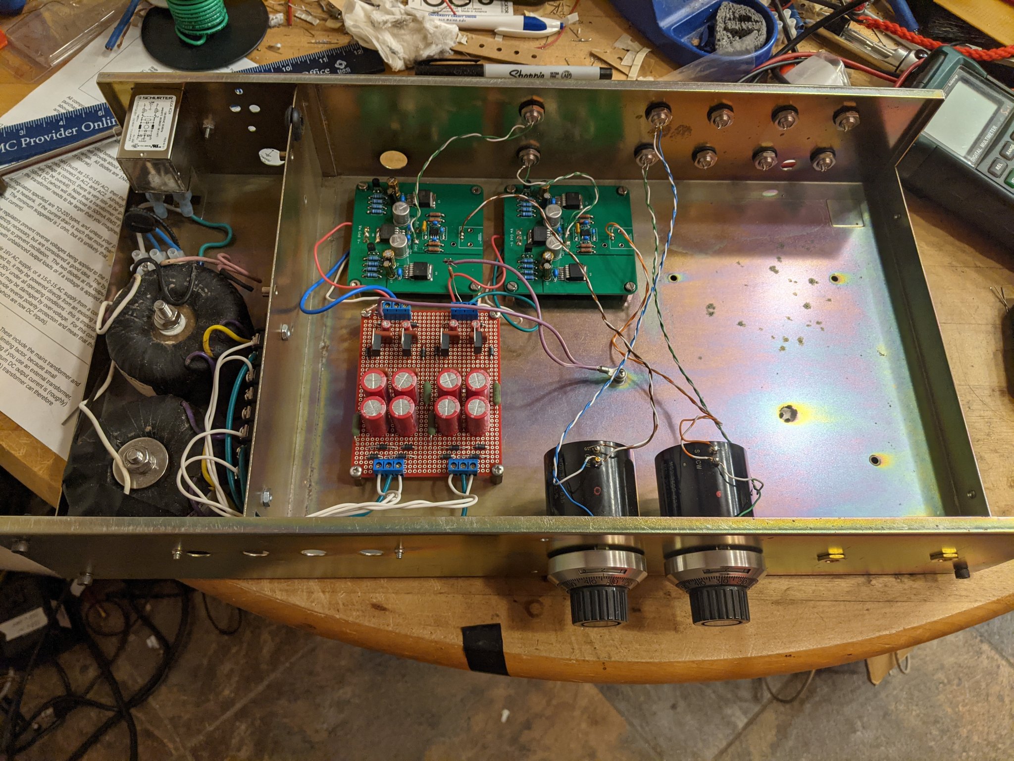

I haven't been able to do much diy recently, but over the last week or two I've finally started getting it into a more permanent chassis and I thought I'd share progress. Part of my goal here was to use up some of the surplus items I've collected over the last few years, partly due to my ebay habit. I decided on a dual mono build, partly because I had a pair of nice Holden & Fisher toroids I wanted to use (at 50VA these are way bigger than necessary). I'm using a steel case I got from Surplus Sales in Nebraska that previously had a prehistoric NABU pre-internet computer thing in it, a pair of big old 20-turn precision pots from some old equipment or other (one per channel - I like doing it this way for some reason), and a pair of Cole rotary switches (not visible in photos).

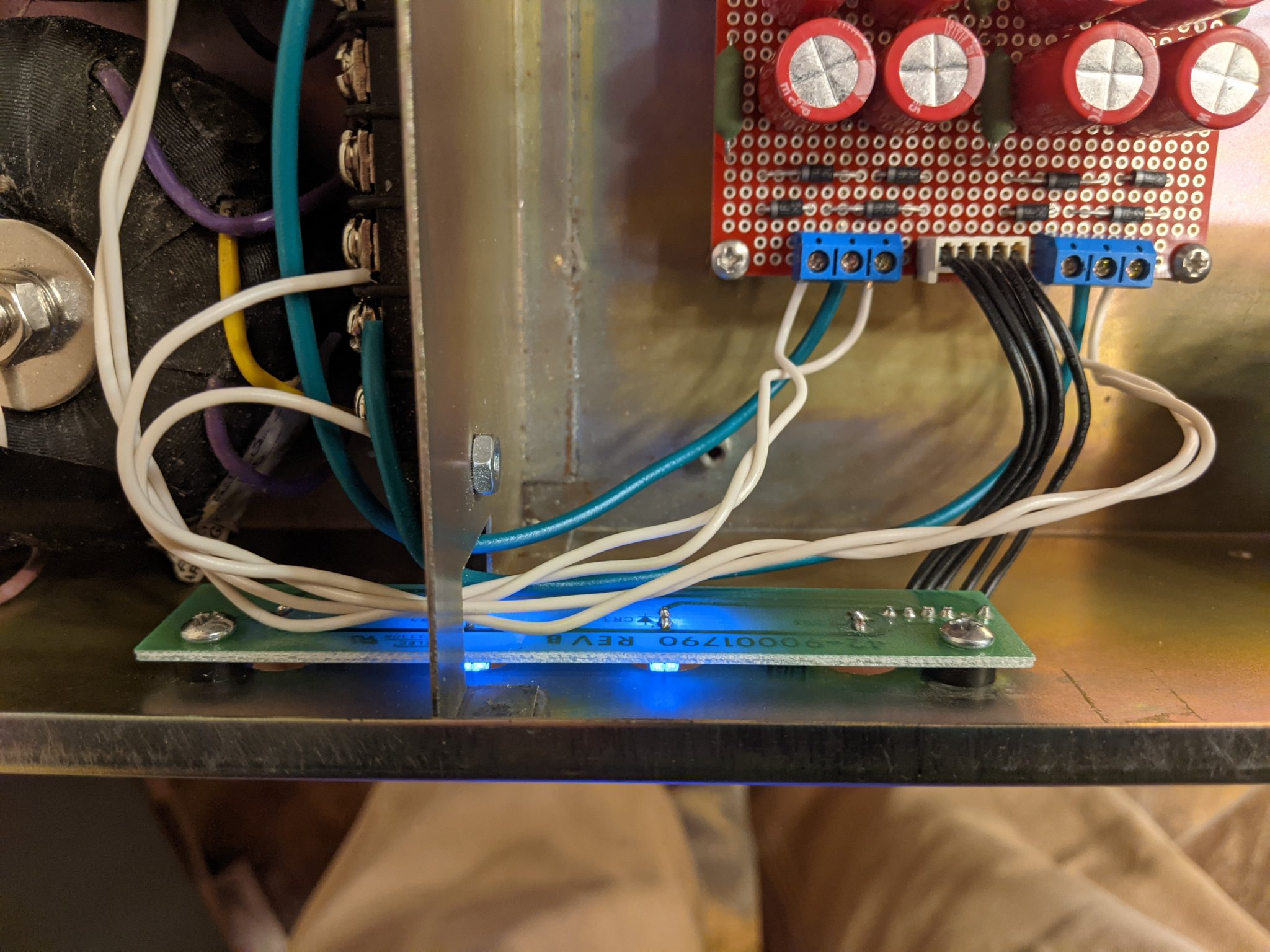

Present state of affairs is as shown, following putting the power indicator LEDs in this evening. Power switch and fuse in back panel at left, trafos are screened off by the convenient steel divider in the case, followed by dual 7815/7915 regulator circuits (one for each channel) and then the boards themselves are the same as reported earlier in the thread. Signal wiring will all be cleaned up in a final version. The little pcb supporting the indicator lights is repurposed from the chassis's earlier incarnation. For the present there's just one input so I can use it while I plan out the things that remain to be done. The front (and back?) of the chassis is going to be sanded/polished and then "blued". Should give a nice glossy near-black finish, with a little luck. I'll fit a small plate (maybe stainless?) over the four holes, so only the two I need are visible. Switches for the inputs are going to be on steel rods to make the signal wiring as short as possible; you can see the bushings on the front plate to the right of the volume pots. One switch per channel; if switching them separately gets annoying I might try some sort of mechanical linkage, like EUVL used somewhere else on the site. I had also planned to put the volume pots on rods also to get them as close as possible to the boards, but the way they connect to their dials makes it awkward; so for the time being I've put them in as seen.
One possibility I've been wondering about is to use relays to switch the inputs. I know relays can be helpful in keeping signal wiring short, but in this case it'll be short anyway. Are there other arguments for using them that I'm missing?

If mechanical switches will be close to the rear panel, I don’t see any important advantage of relay switches, as wires will be short. Something like Salas’ I-select would allow more tidy build.
With all those long unshielded wires, seems that steel case is your savior against hum. 🙂
I'll look into the I-select, but lacking any good reason to use relays I think I'll stay with the plan to mount the switches close to the back.
No hum problem as things are; at full volume with my ear against the speaker grille I can hear hum, but nothing is audible at normal volumes and/or distances. Nonetheless you may be right about the steel case being my saviour, of course, and in any event the long wires are bad practice, and should be shortened in the final version, just on general principles if nothing else. I tidied the ground wires up today (and increased the resistors on the LEDs, which were too bright). Photo attached. To shorten the input signal wires I will need to put the volume pots at the back; there's plenty of vertical room to mount one of the buffers above the other to make space for the pots, if I can figure out how to keep the dials on the front. Shouldn't be too hard.

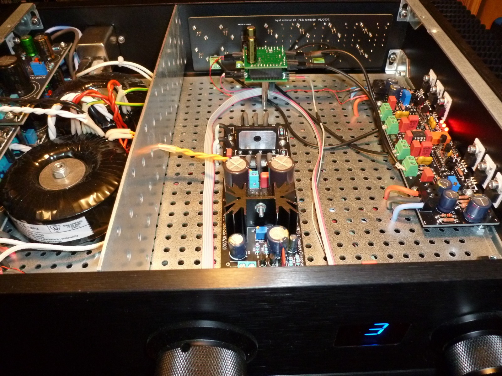

At attached picture, small green PCB is Meldano’s Muses V2 volume control in my preamplifier.

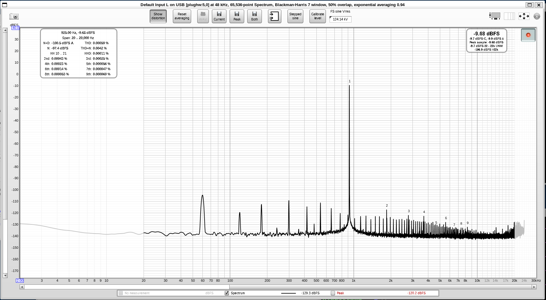

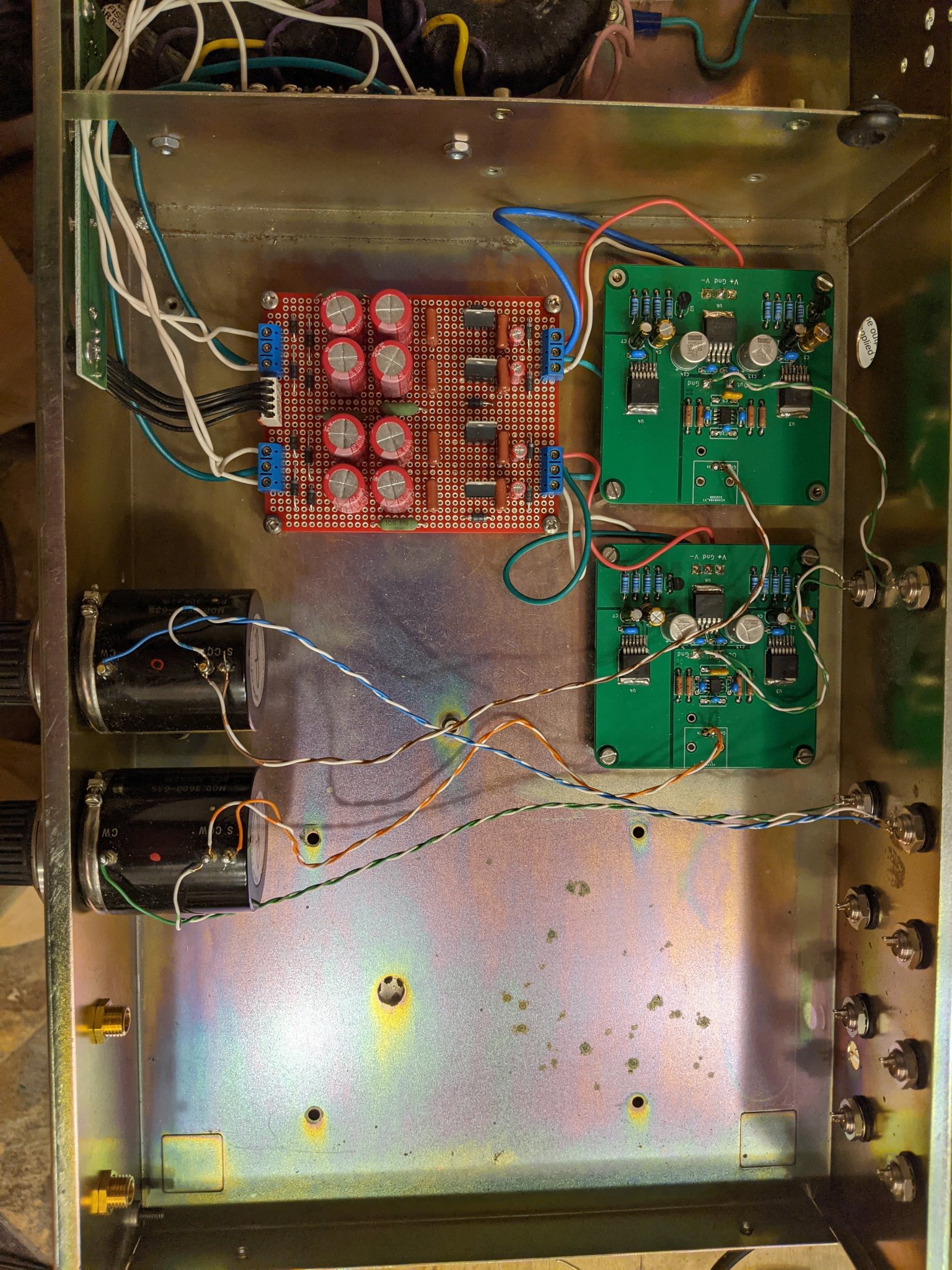

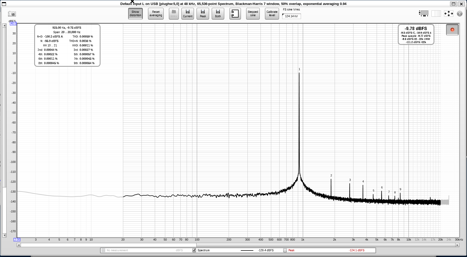

Hi Tombo,
So you may have had a good point about the long signal wiring, even if fhere is no audible hum. I spent a while fiddling about with REW again; the two plots below show first the loopback for the Focusrite Solo, and then the result when using the buffer. The settings on the Focusrite were the same in both cases, and the volume on the buffer preamp set to give the same output voltage (as measured by DMV) as the oscillator in the Focusrite. The numbers for each harmonic are very close to each other, so the buffer is adding little or no
distortion, but the noise is worse, all apparently multiples of 60Hz. This looks worse than the plots in post #153 whcih were the exact same buffer boards in a temporary case with external PSU (although the test setup may not have been exactly the same) so it seems likely the cause of the forest is having the PSU in the case, and the signal wiring picking the mains noise up.
None of this is audible, of course, being about 90dB down or more, but it's there so I want to see what can be done. I have some twisted and shielded/screened signal wiring I can try, so I'll try wiring up the inputs and volume pots with more care and see what happens.
Anything else simple I can try? Short of rebuilding with external PSU, that is? (I'm not fiddling around with switching inputs for the time being, just hardwiring one.)

If your arrangement is still the same as in the pictures in post #166, there are a couple of easy things to try. First, twist all your power wires (+,-, GND) tightly to reduce loop areas. Another thing would be to move the buffer boards further away from your power supply; you have lots of room.
You could do it in stages and remeasure with REW to see how the changes affect the noise.
Thanks for the input. Twisting the power wires is an easy thing to try, I'll certainly give it a go. And yes, I can move the buffer boards; in fact there's enough space to mount them vertically, so there are plenty of possibilities for where to put them without getting in the way of the input switches and extenders that will be going in the big space on the right.
I'm a little surprised that the steel dividor in the case isn't enough to shield everything from the transformers.

There will be no need to rework preamplifier and move power supply. All 60 Hz noise is EMI that unshielded wires pick up. As buffer has onboard super regulators and there are LM pre-regulators as well, nothing measurable will come through supply. As a reference, look at buffer output noise level with shorted input. That is calibrated measurement and 50 Hz noise is at 100 nV level or 140 dB below 1 V. Even that 100 nV doesn't come from the buffer output but is what well shielded measurement cable always picks up as a minimum environment noise.
Just use shielded cable for all signal paths and it will be fine. 🙂
Also, use only proper shielded interconnect cable between preamplifier and ADC input. That is also a point of noise pickup.
Why do you have REW reference level set as 124000 V (124 kV)? There is usually used 1V or max. interface input level. In case of Focusrite max. input is 7.75 V or + 20 dBU.

This makes perfect sense to me, if by "coming through supply" you mean electrically, through V+, V- and GND to the buffers. On the other hand the plots in post #153 don't show this EMi interference, and the only difference was the external PSU (same buffer boards, also long twisted-pair signal wiring, same position in house when measured, same Focusrite). So it looks like the problem should be connected with the internal PSU somehow. Is it possible the transformers or the 7815/7915 board are the source of the EMI? Of course it may be operator error with REW or the Focusrite - I'm hardly an expert 🙂
Just to be clear, by "shielded" do you mean single-core coax, with the core carrying the signal and the shield carrying the ground? Or something more sophisticated? I have some small two-core shielded cable here (although I can't remember why I bought it) so I could use that with the signal and ground carried by the core, and ground the shield at one end (presumably). Any better than one-core? At least, not any worse? Looking around other threads on the site advice on this point seems to vary a lot; some people (I think Mark Johnson said this somewhere) prefer carrying ground in the shield, and grounding the second core wire at one end only. Thoughts? (I don't have any quality single-core coax here, except heavier stuff I use for interconnects, which doesn't seem ideal.
I'm using single-core coax connected to an XLR, and the microphone input on the Focusrite. I'm using a 47k load acrss the preamp output. (Although I wonder whether there's any point in this. The Focusrite itself should be OK as a load, right?) If any of this doesn't sound right please let me know. In any event I used exactly the same cables to produce the loopback measurement, and that didn't show the EMI interference, so it seems unlikely to me that it's the cause.
I have no idea why it's set to that. 😳 It was probably set to that by default when I installed REW, and I never changed it. You see, I told you I wasn't an expert... although that was probably already pretty obvious.
