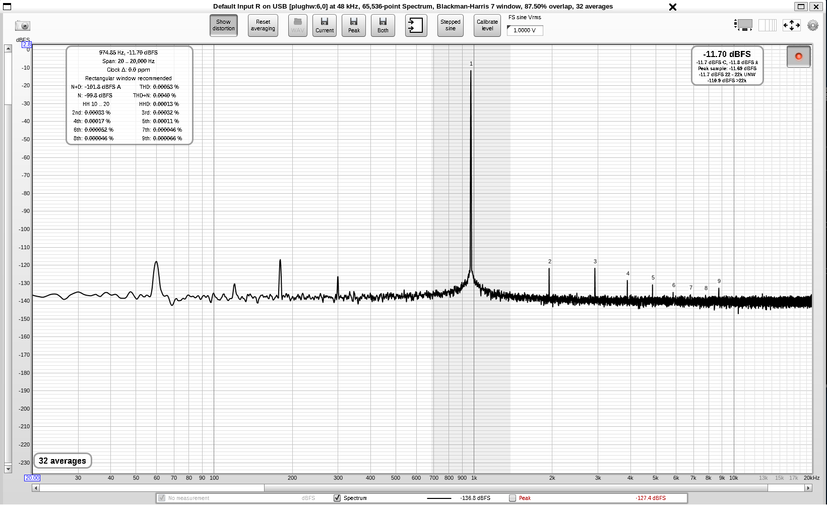

Hi All,

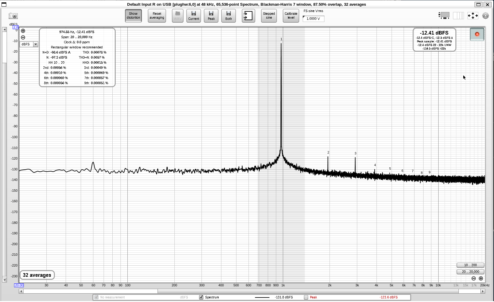

Following a morning used up with plumbers fixing things in the house, I've spent the afternoon playing with REW. Here are three measurements of Tombo56's buffer, done under the same circumstances as far as was possible, namely an input voltage of 0.5V peak-to-peak, and volume set to unity gain (or as close as the AVC would allow). The first is from the preamp I built previously, the second and third from the new experimental one in the photo a couple of posts above. The difference between the second and third is that volume has been controlled by the pots on the input in the second (with the AVC on "full"), and by the AVC on the output in the second (with the input pots on full).
The plot for the first buffer, which was built with much more care with the layout than the experimental rig, doesn't have the peaks at multiples of 60 Hz that the others show. Considering my almost criminal lack of care in building the experimental rig this is hardly surprising; running signal wires more carefully (!) might well reduce these peaks, although they're pretty small in absolute terms. Also the power supply for the second and third plots is just thrown together with parts from my junkbox, which shows how good tombo56's on-board is.
The absolute best of the three seems to be the one using the AVC and not the pot on the input, although the differences in distortion and noise are surely not audible.
Nothing is perfect, though. Firstly, listening to music on the experimental version was tiring; something in the upper registers seemed (subjectively) a little harsh. This doesn't happen at all with the other preamp based on the same buffers. I can think of two possible explanations; I didn't have anything in for C5 (which seems less likely to be the problem), or I may have been inadvertently listening louder than I usually do.
If the second it may be linked to trying to use the AVC instead of the input pot. Please correct me if any of the following sounds wrong. There are seven "clicks" up from silence on this AVC, each of which is the same number of turns, hence the same voltage difference. (There is a problem with one of the pins on one of them, hence seven, not eight.) So the last step is an increase in a ratio of 7 to 6, which is around 1.34 dB, whereas the step between 2 and 3 is 3.5dB. In practice, if I want to avoid using the pot on the input then on my system a buffer with unity gain puts me at the top end where the volume control is more useful (which is more or less what ZM hinted might happen earlier, I think), whereas these buffers (with a gain of 1.33) leave me already in the middle since anything above is too loud and the increments up or down are too coarse to be useful. So the moral of the story if someone else want to be try transformers like these as a cheap AVC then their success or failure really depends on whether you usually listen to music near 10, or near 2 or 3.

tombo is my guy, not so allergic on OT
You got it right. 😛
@njepitt, don’t bother with what might be off topic. You can discuss and compare other input buffers here.
C5 absence will not affect high frequency distortion, so I suspect it is higher listening level responsible. Transformers may not have linear response at high frequency (as is known for Edcor in example). It would be good to check FR using REW sweep mode.

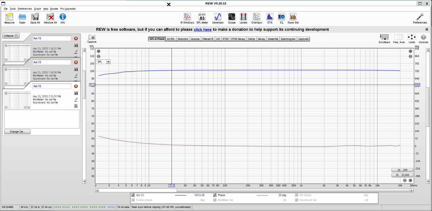

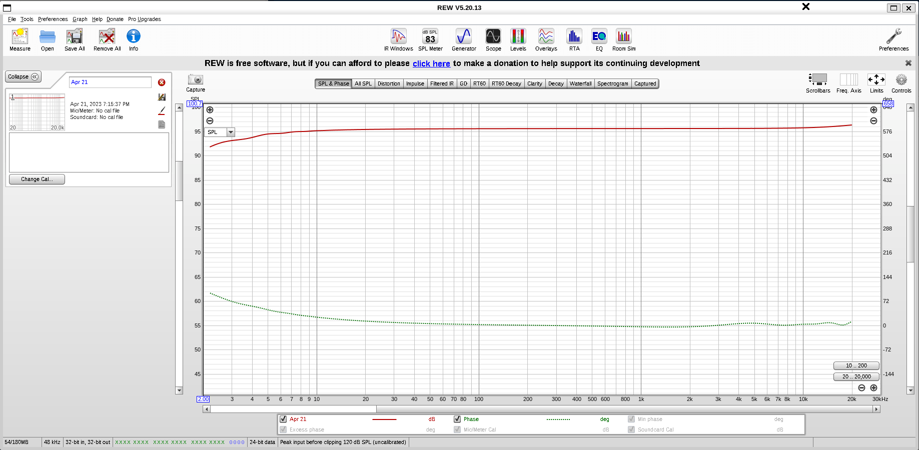

Hi Tombo,
I hadn't used REW to give a sweep response before, except when using a mic to measure speakers, so I hope this is what you meant. Here are two sweeps I did with the same conditions on REW, as far as I could tell, one for Tombo's buffer (the first one, without AVC), and the second with the Cedarburg buffers using the AVC. I don't think output volume was the same on the two preamps, but settings on the Focusrite were the same. As far as I can see there isn't a lot to choose between them; both look pretty flat to me, and there doesn't seems to be any smoking gun in the higher frequencies from the Edcor transformers. I am presuming that any strange frequency response would show up with any of the buffers. Let me know if you had something different in mind, or if some other settings would be more appropriate.
Transformer doesn’t exhibit any peaks in FR response, so that reason for perceived distortion can be ruled out. Although, only Cedarburg buffer was measured with AVC at the output, I don’t believe it is possible that other buffers would produce different FR.
What next? Answer is simple. You have combination which works well. Use Cedarburg with AVC and enjoy listening. 😀

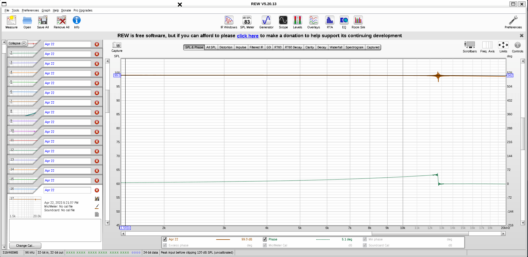

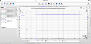

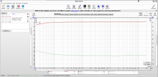

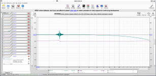

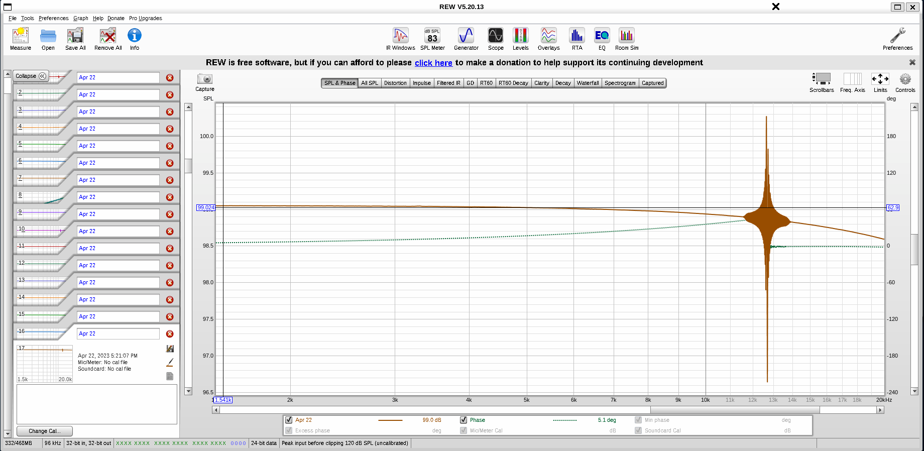

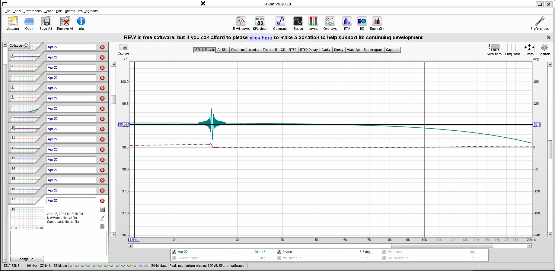

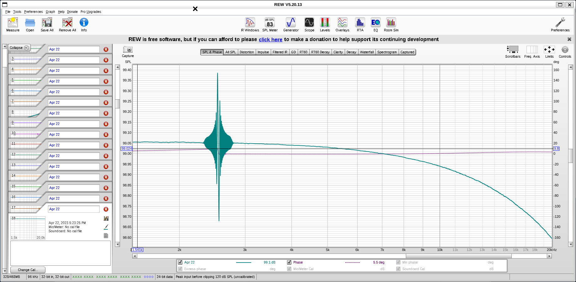

I had a go at higher resolution sweeps and a "smaller dB window", as ZM asked. I only scanned from 1500Hz up. Something a little odd appeared. This is all still using the Cedarburg buffers and the Edcors, with volume pots set to max, and only adjusting volume with the AVC. Something is causing these "ringing" events, which happen about half the time, do not seems to happen at the same frequency every time, and only happen once every sweep if they appear at all. My best guess is that these are artefacts of the measurement, but it is possible that some kind of outside interference is being picked up, I suppose. Did I perhaps set something wrong in REW? I don't find the interface very intuitive, but note I'm using the linux version, which may not look the same as the windows or mac versions, and (as always) it's very possible I'm doing something wrong. The only thing that struck me was the abrupt shift in phase that happens at the same time; that doesn't look like an analogue process to me.
The screenshots below show two scans, both shown with wider and narrower resolution. Like I said above, about half the time these "blips" don't appear.
Thoughts?

My guess was something like that. Are these caused generated by the computer itself, or the Focusrite? If the laptop, do you think these are produced when using a computer to play back music? They're pretty small, but maybe not completely ignorable.
Nothing else about these scans looks remarkable, right? Do they have the resolution you asked for?
I'm good...... my remark was for your benefit, not me being suspicious or expecting different results
blips - who cares, digital ones, most important is that you are not hearing any while listening, hardly anything related to 'puter side, more likely to measuring software/settings
and certainly not having origin in liner domain, which was target of investigation in first place

Work on battery while taking measurements. Lot of noise comes from the laptop power supply.
