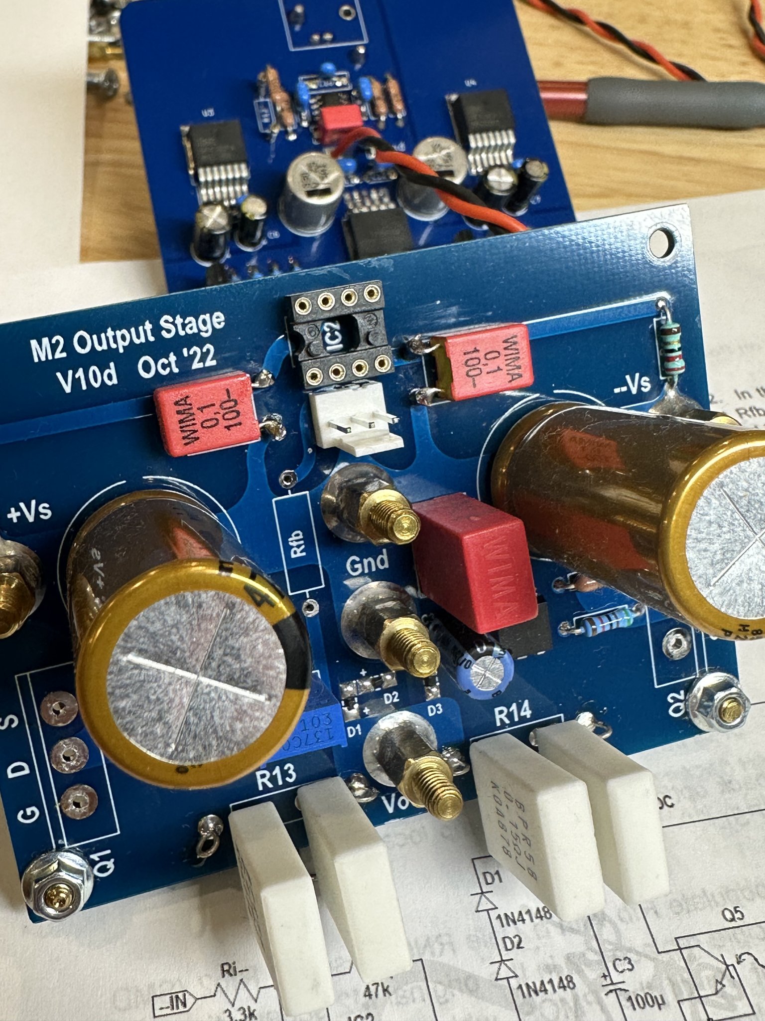

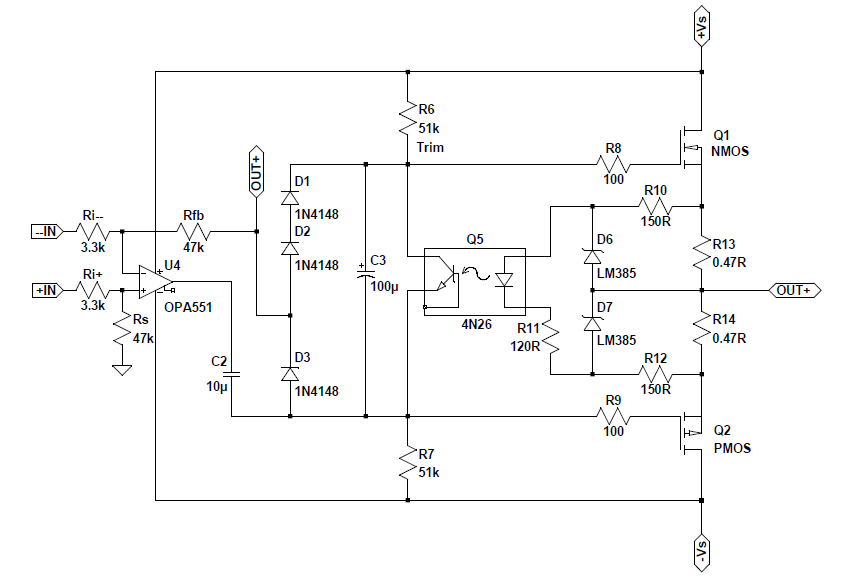

This buffer has been the front end to my M2 Clone amp for some time and now its time for a change. My plan is to replace the M2 Clone boards with EUVL's M2OPS amp boards. Since no more Iron for gain, the buffer will be adjusted to provide 12dB.
My question is how/where to connect these two boards?
For M2OPS SE input, -In will is jumperd to GND.
I'm thinking buffer signal output should connect directly to the vacated M2OPS opamp (U4) pin6 location.
Next question, does C2 need to be in the signal path since TomboBuffer has ultra low DC offset at output?
Power for the buffer could use pins4/7 from U4 socket or come directly from power supply board, which would be preferred?
M2OPS schematic is attached.
Thanks!
That would be the right connection point. C2 should remain as Q2 gate is not on the ground potential.
But, that buffer can’t provide more than 11 Vrms at the output (with readjustment of on-board regulators to +/- 18V supply. Is this enough for intended use? M2 output stage can provide more.
