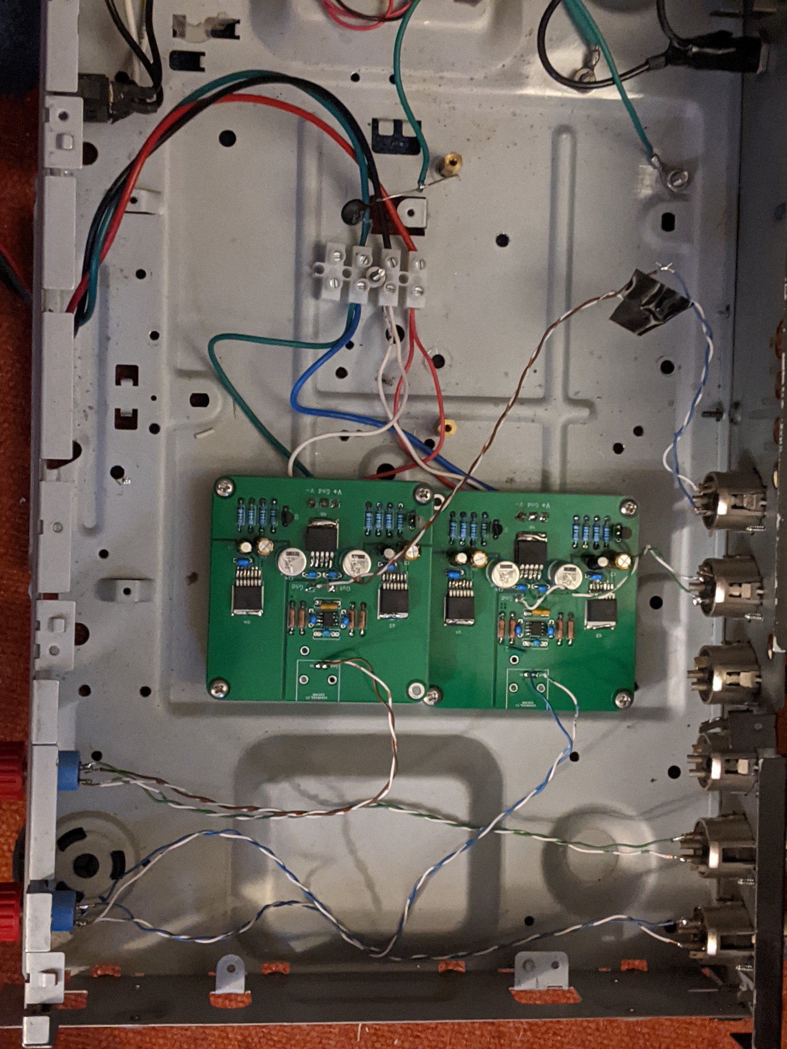

Here's a progress report and some pics...

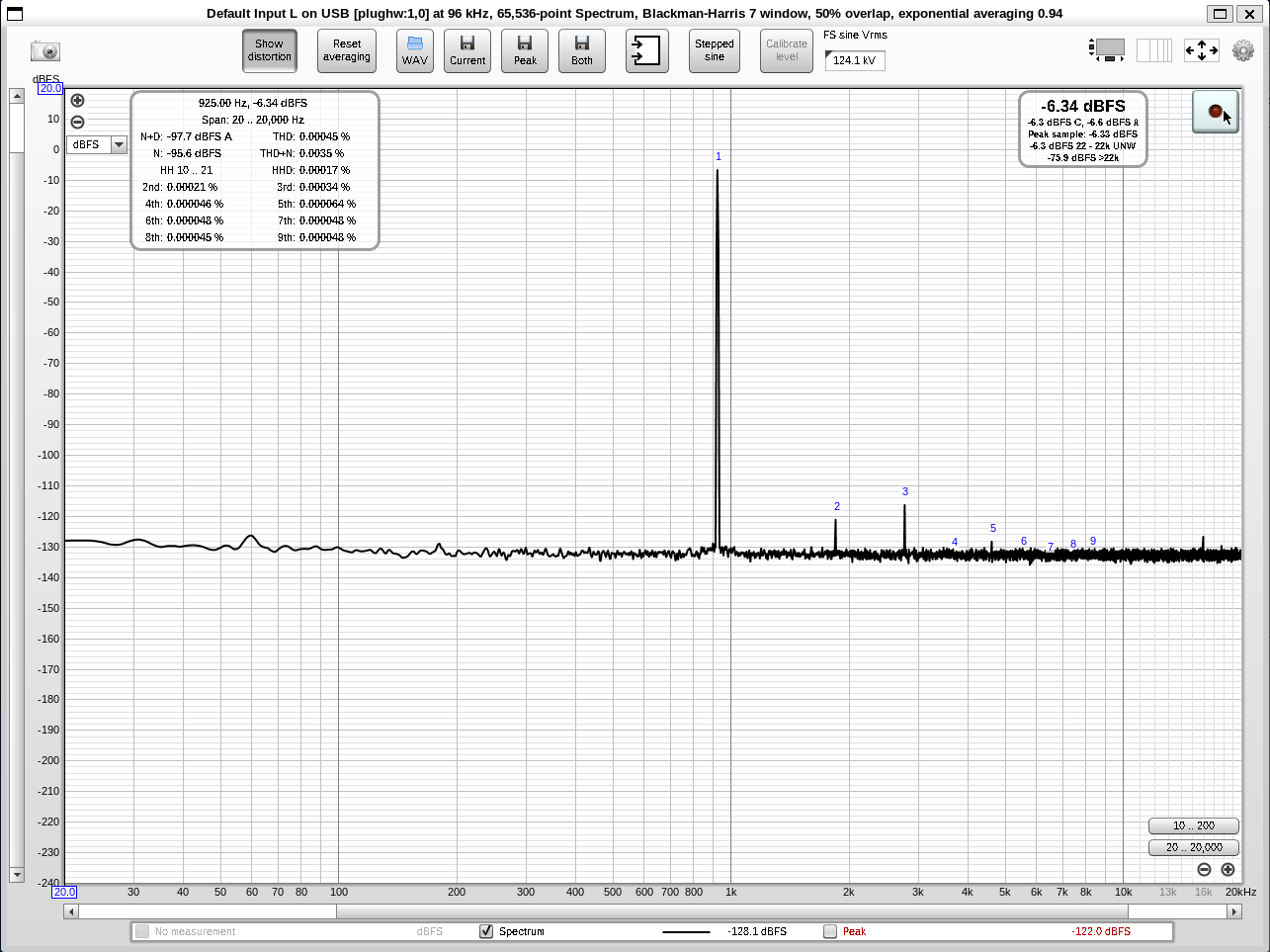

I have the buffers up and running in a temporary chassis, which was recently used for my first version of ZM's Iron Pre and was available to get power to the boards and signal in and out. (The wiring is temporary and chaotic...) I tried it first with an EI transformer and the p2p Good Gemini shunt PSU that I wrote about elsewhere; that setup is shown in the first photo. Seemed to work just fine, at least on REW, but the plot showed several bumps from mains 60Hz and harmonics. My guess is that the EI transformer was interfering with the chaotic wiring, so I tried again with an external supply - a 7815/7915 doodad I made years ago using a schematic from Rod Elliott's site; shown in the second photo, with much better results.

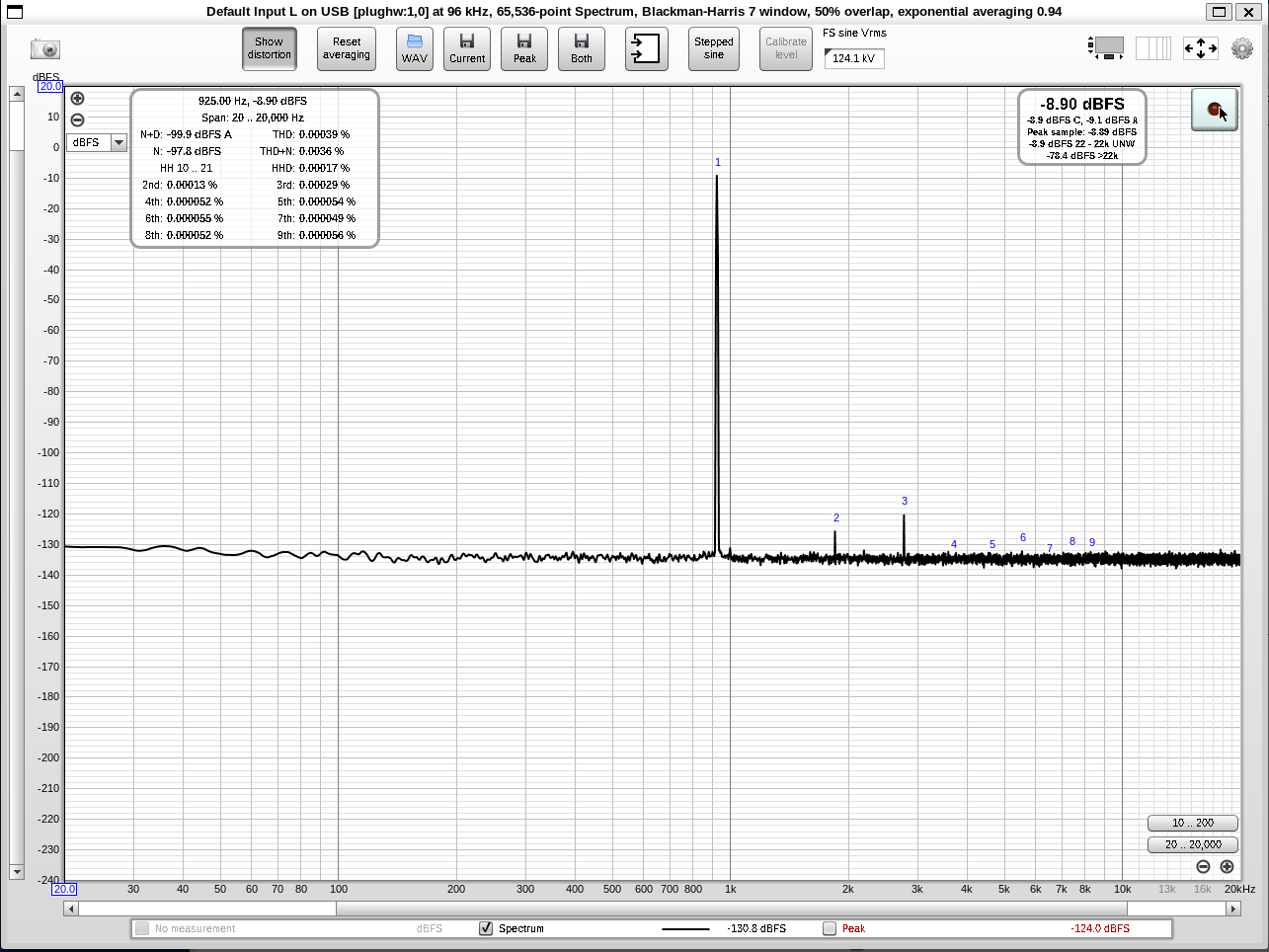

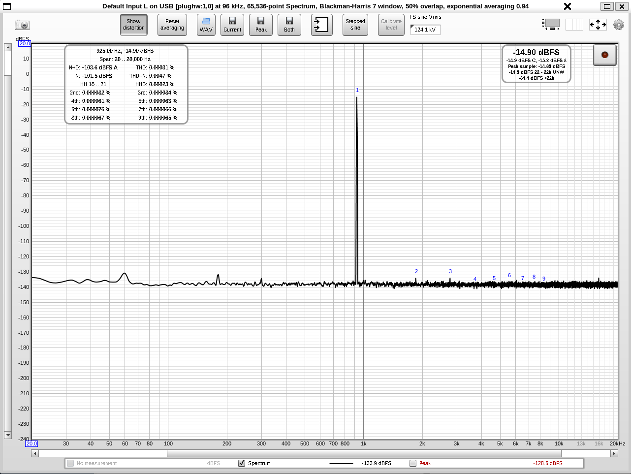

I used REW with a Focusrite Solo and laptop. The plots show, in order: a loopback, right channel at full output and then partial output (about where I usually seem to end up listening, about 0.2V). Left channel is very similar so I omitted it. Just 0.00045% THD! Considering the loopback already showed 0.00039% I'm sure that my measurement techniques (or perhaps the Focusrite) are the limiting factor here, not the buffers. Either way an expcetional outcome, I;d say...
I have it hooked up it my system and it sounds great! Now I have to decide how to arrange things more permanently. An AVC seems a good idea (maybe ZM's Iron Turtle?), but there are so many things to try... 🙂

EI transformers have strong stray fields and, in combination with long unshielded input wires, some 60 Hz noise would show on the measurements. 7815/7915 supply is a very good solution.

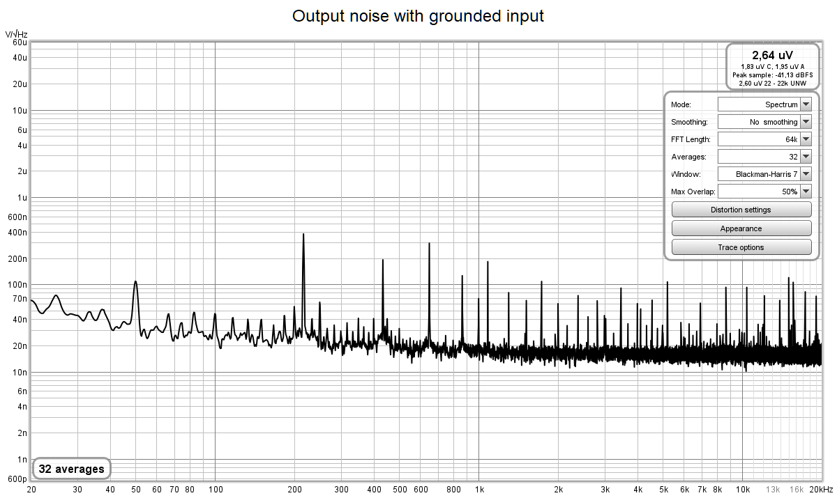

If shielded cable would be used at input, I think that EI transformer in the same case would be fine. Rest of cabling can remain as is. PCB itself is designed to provide high isolation from surrounding EMI. Here is one noise measurement made on the bench with dual big unshielded EI transformers (old lab PS) only 20 cm apart from the buffer:
This measurement was made with calibrated LNA (1000x Low Noise Amplifier). 50 Hz EMI noise is at 100 nV or -140 dBV level.

Tombo: I haven't tried the shielded input wires with the EI, since I'm looking into a more permanent chassis which may make the point moot. Your noise measurements are very impressive; can I ask what setup you used? It looks like you're using REW, but what interface? Your earlier THD and N measurements also show much lower noise than mine, which might be due to better equipment or (more likely) a better setup and more experience. Interested to hear more if you have the time.
As you say, some practice helps to get better results. I was making a lot of mistakes in the beginning. Noise measurements are possible only with additional Low Noise Amplifier. I’m using this one: Groner's LNA
along with Focusrite Scarlett Solo gen.3 and some good cabling.
Lot of information is available in the REW thread: Measurement with REW
When preparing for the next measurements, just ask to check setup with you.
