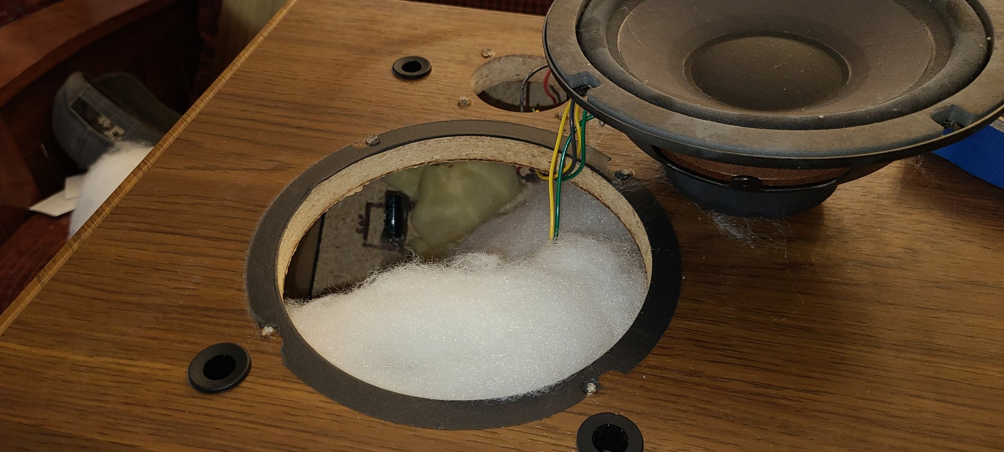

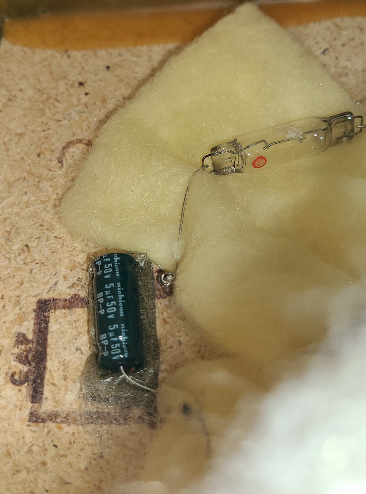

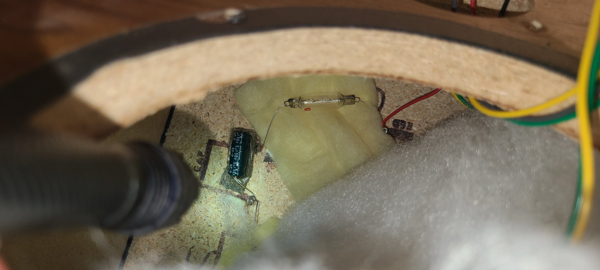

OK, here is what I have so far. The capacitor and bulb fuse are located against the inside rear of the cabinet. The cap is hot glued to the wall but looks like it can easily be removed. The bulb fuse is wire-wrapped pretty tightly to the terminal. It looks to me that the bulb fuse is OK. Should I remove the capacitor to test it? I do not have a replacement yet because I wanted to check the exact rating from the original.
I do not see the resistor, though!
It is going to be difficult getting my soldering iron in there while holding the new capacitor in place for attachment. Any suggestions on how to do this replacement?

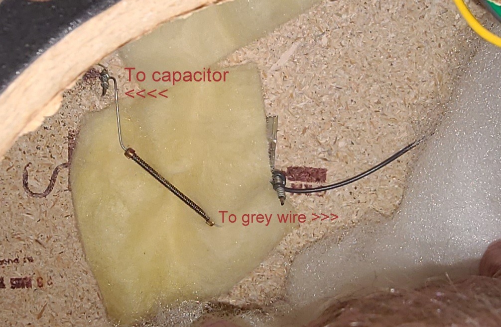

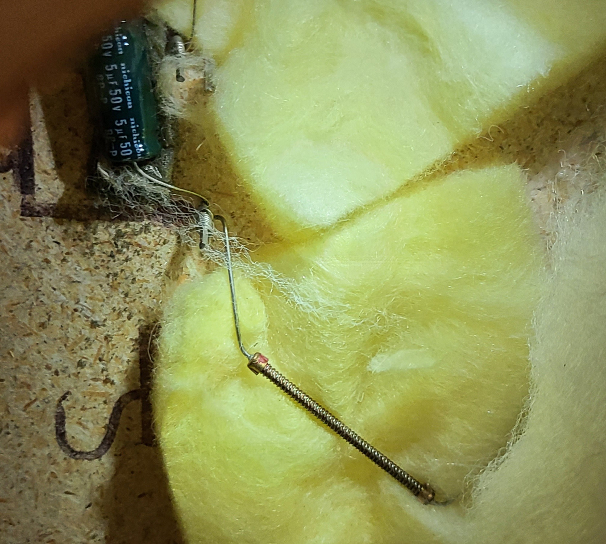

After pulling back more of the filler from the capacitor, I uncovered the wire-wrapped resistor (I assume that is what it is); one end is connected to the cap, and the other end is connected to the grey wire.
If that is the wire-wrapped resistor, do those go bad? Should I replace it as well as the capacitor?

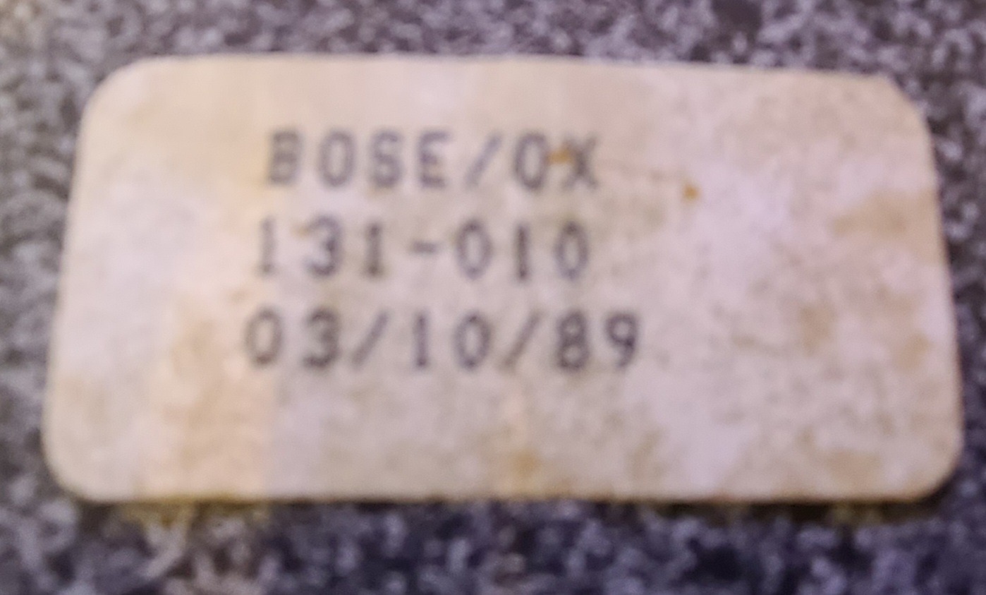

The small piece of paper is the sticker that is attached to the rear of the front-facing woofer/driver.

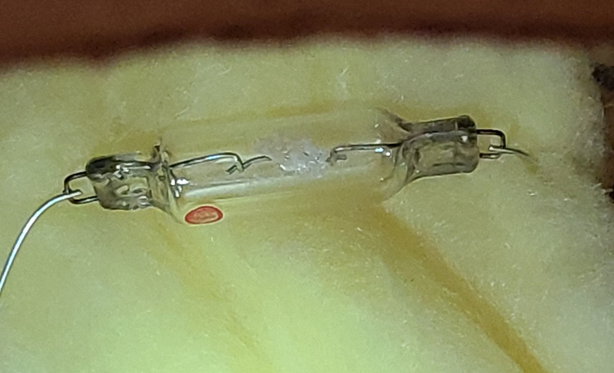

May be I'm wrong, but just looking at them, it seems to me the capacitor is quite like new, even too new (could it have already been replaced by the previous owner?) and the lamp broken.
However, in order to re-solder a components I think you would first have carefully detach it from the panel reattaching it after resoldering. IMO
Edit to add: the lamp seems good, in the first pic there is a white spot on the glass which misled me.

@ulogon I also thought the bulb fuse was blown, but it looks as though that spot on it is something that is stuck to the glass. I can scrape it with my fingernail. I have no idea if the previous owner replaced the original capacitor(s), and I don't know the brand that Bose would have used at manufacture. I have been reading that, ideally, a cap should be removed for proper testing. But I would hate to do that and have to reattach it should it be good.
Edit---- Looking closer at that capacitor, I believe it is the original because it is tightly wire-wrapped to its connections just like the other wire connections.

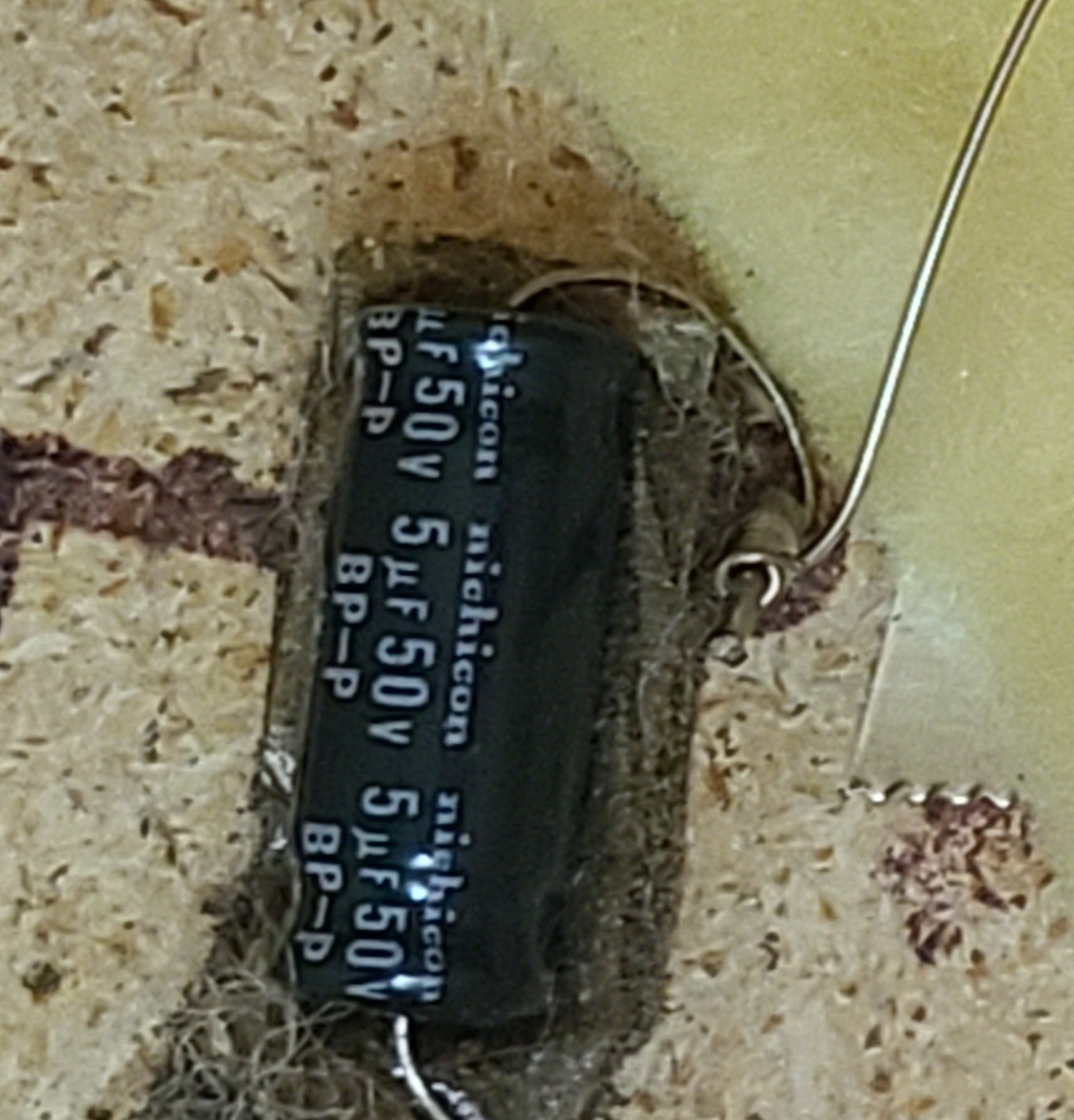

Is this dark green colour like these (please read the Bose related notes in the description)?

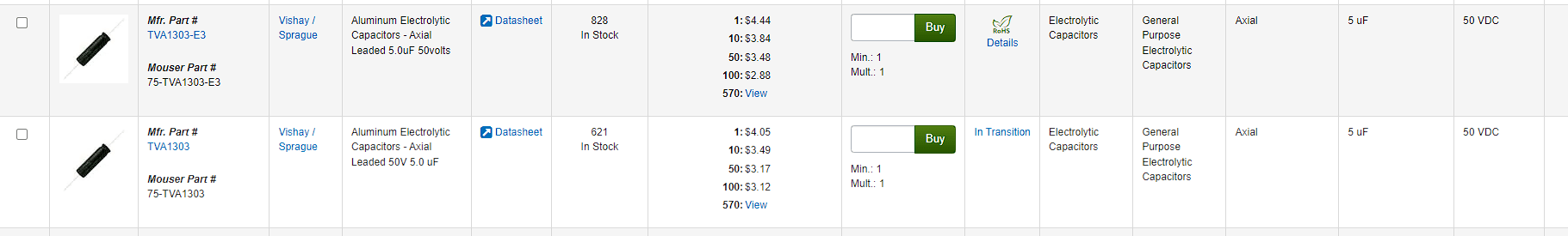

Yep, those look like it but I need axial, and 5uf.@ulogon Is this dark green colour like these (please read the Bose related notes in the description)?
I am unable to spend any extensive sheckles on these right now. I was hoping that a $1-$2 capacitor was all that they needed since they are 35 years old!
No no no, it wasn't to tell you to buy them, but just to have a further clue regarding the hypothesis that it is original.Yep, those look like it but I need axial, and 5uf.
I am unable to spend any extensive sheckles on these right now. I was hoping that a $1-$2 capacitor was all that they needed, being 35 years old!
It's a good quality 5 uF Nichicon NP electrolytic capacitor as originally fitted and is unlikely to be out of spec by any significant amount.
That's an unusual wire wound resistor, but as long as its up to the job...
Could you measure the resistance of both the lamp and the resistor and report back your readings?
EDIT: Remember to subtract the resistance of your multimeter leads from the total reading.

What about either of these?
Not those as they appear to be polarised types. Check the Datasheet.
You need a bipolar (non-polar or NP) type - usually available as 4.7 uF which would be just fine.
Everything looks fine. If it had been really overpowered, that resistor would have shown it. That one looks fine.
You can test the lamp by hooking up the speaker and playing some music, doesn't have to be loud. With the speakers sitting out (maybe set the woofer on a towel) flick the lamp with your finger and listen to the tweeter for it to cut out. If it doesn't, all good.
Again, HIGHLY doubt the cap is bad.

A good quality Nichicon NP electrolytic capacitor is fitted, but it is now 37 years old. However, a small departure from the original capacitance and ESR values may not be too significant in the context of this 1st order HF filter - so SpineyNorman may simply decide to leave it in circuit.
If it were me, I would put a fresh capacitor in as a matter of course - especially since I'd gone to all the trouble of opening up the loudspeaker.
