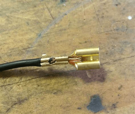

Those connectors are only suitable for joining wire to wire, not wire to tweeter terminal.
Post a photo of the terminals on the new tweeters, or wait for @6thplanet to tell us if crimp connectors are applicable to them.

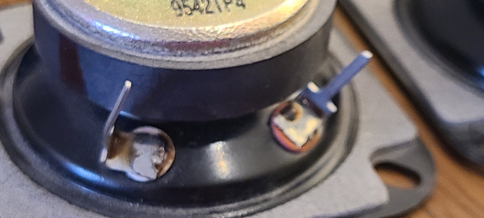

Describe what the terminals look like or post a photo. Are they wire wrap posts by any chance?
Was the image you attached in post #13 that of the original Bose 401 tweeter or of the mismatching 8 ohm replacement?
Just a thought, if it was you who fitted that mismatching tweeter you had no difficulty with the soldering process - right?

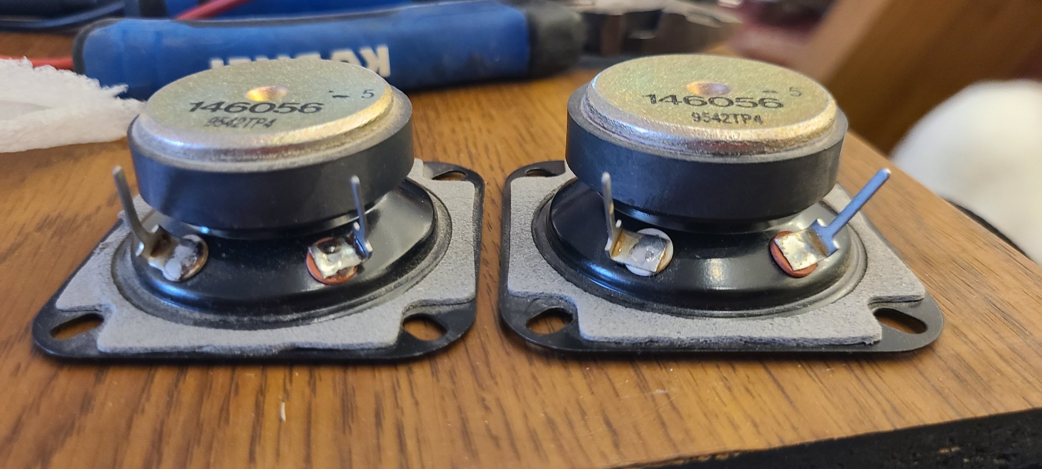

The connections on the new tweets are wire-wrap posts. Yes, I soldered the mismatched tweeter. I have done a lot of electrical work and have no problem soldering, but @6thplanet was so helpful with these new tweets, I am being extra careful so as not to damage them in any way!
If I may, that way the quantity of metal increases with no a real reason and proportionally the heat necessary to melt the proportionally increased quantity of tin alloy will increase in an unwanted manner. IMOSo wrap several turns of the single core wire around the post as tightly as possible by hand.
Then heat the wrap and apply solder.
IF tweeters were mine I would heat the posts just as much as necessary for a modest amount of tin to cover their let's say 1 cm long reclined on one side horizontally to avoid the tin dripping vertically onto the post support.
Then I would do the same with a small length of stripped wire.
And then simply by bringing them closer and holding them firmly with a any "tool" capable of keeping them firmly in place, I would bring the tip of the soldering iron (which I would not use with a power higher than 30W) closer just that short period of time to fuse them together.
Done.
IMO Much safer (and effective).

Really doesn't need solder.
Since wrapping by hand does not produce the huge pressure of a wire wrap tool I suggested the application of solder to seal out the air and produce a corrosion-free joint.
@ulogon Your method is quite appropriate (and safe!) in this situation, but wherever possible I make a sound mechanical connection before soldering.

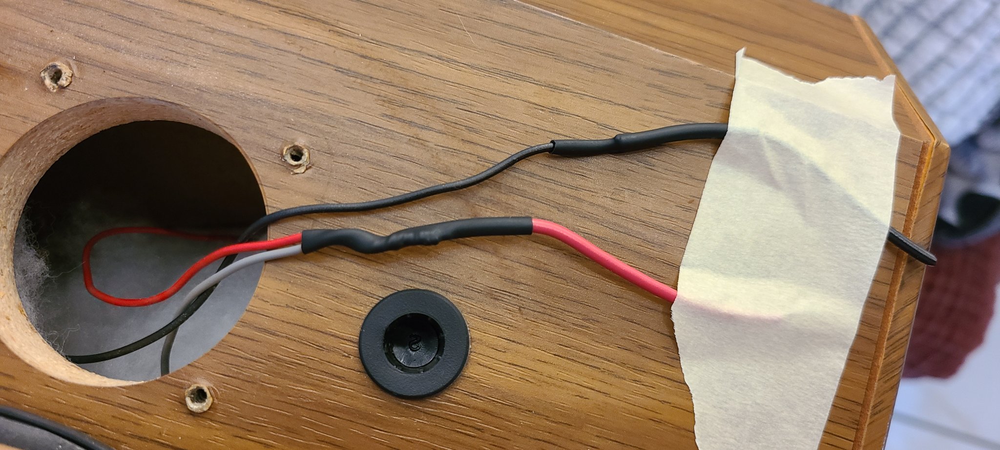

Please note that this, wanting, can be solved easily and elegantly by crimping or soldering two wires together in a single terminal without even touching the tweeter posts.And remember to allow for the fact that two wires (the red and the grey) must be wrapped on the positive post.
Also because if I didn't agree with a single wire hand wrapping with no tool, than much more with one made with even two wires by those who have never done it before and want to rightly protect their precious tweeters at all costs.

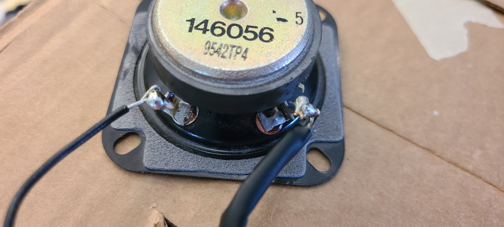

I agree.The soldering on that original tweeter is none too neat!
I really don't know why he bent the wire and used a lot of tin.

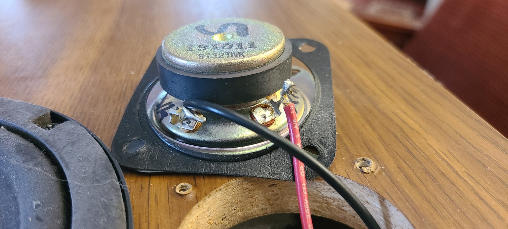

Something tells me this is not a factory Bose connection.
According to your upper image in post #134, it wasn't an original Bose tweeter!
The wires have been extended by the person putting in this tweeter.
