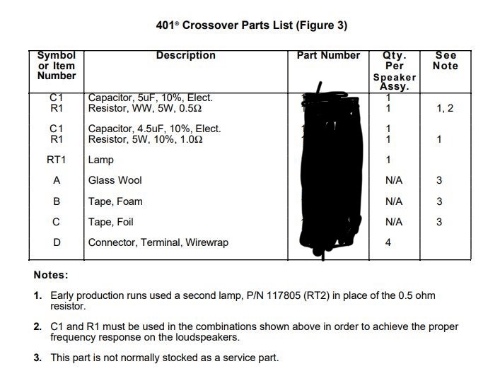

I do have a multimeter and it can test capacitance. And I am still trying to locate a pair of suitable replacement caps. I do have a question regarding the official schematic and parts list @6thplanet provided a while back. It showed: C1 Capacitor, 5uf, 10%, Electrolytic. R1 Resistor, WW, 5 watts, .5 ohm.Good question!

Then a second line: C1 Capacitor, 4.5uf, 10%, Electrolytic. R1 Resistor, 5 watt, 10%, 1.0 ohm.
Am I to read correctly that the caps and resistors in the second line of C1 and R1 are suitable replacements should those in the first line be unavailable?

The exact value of capacitor will depend on the amount of resistance in series with it
Yours will be 5 uF to match the resistor and lamp fitted to your particular speaker.

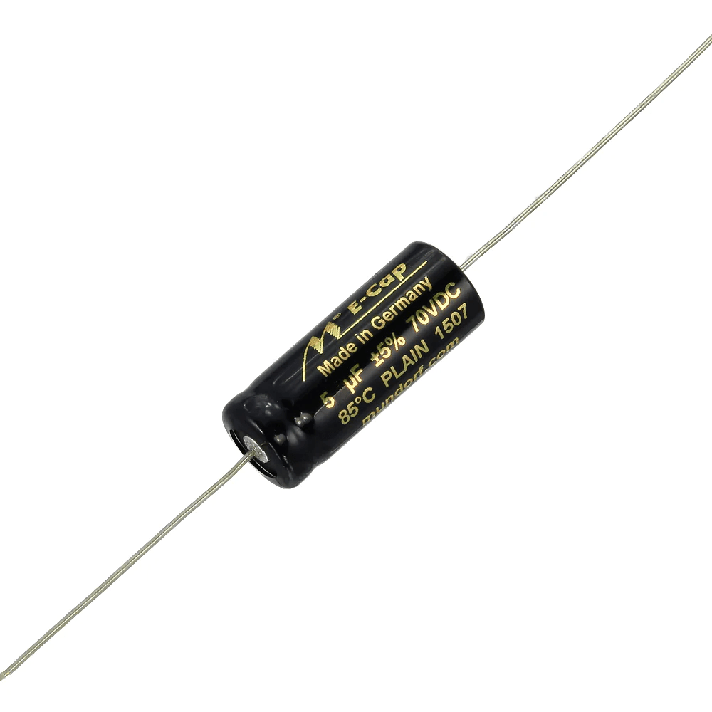

I don't know if you can get them over there, but Mundorf of Germany do a 5 uF Bipolar E-Cap.
I'll try answering your question directly.
To the best of my knowledge, 4.5 uF NP electrolytic capacitors are not obtainable, whereas 5.0 uF ones are.
A workable compromise in either scenario would be to employ the readily available value of 4.7 uF.
P.S. There is no need to replace the lamp and resistor if they are in working order, so be sure to measure their resistances and to carry out 6thplanet's tap test on the lamp. There are opinions that there is no need to replace the capacitor, but I suggest you could at least measure its capacitance.
Just thinkin'..... that cap is worth more than the speakers.
