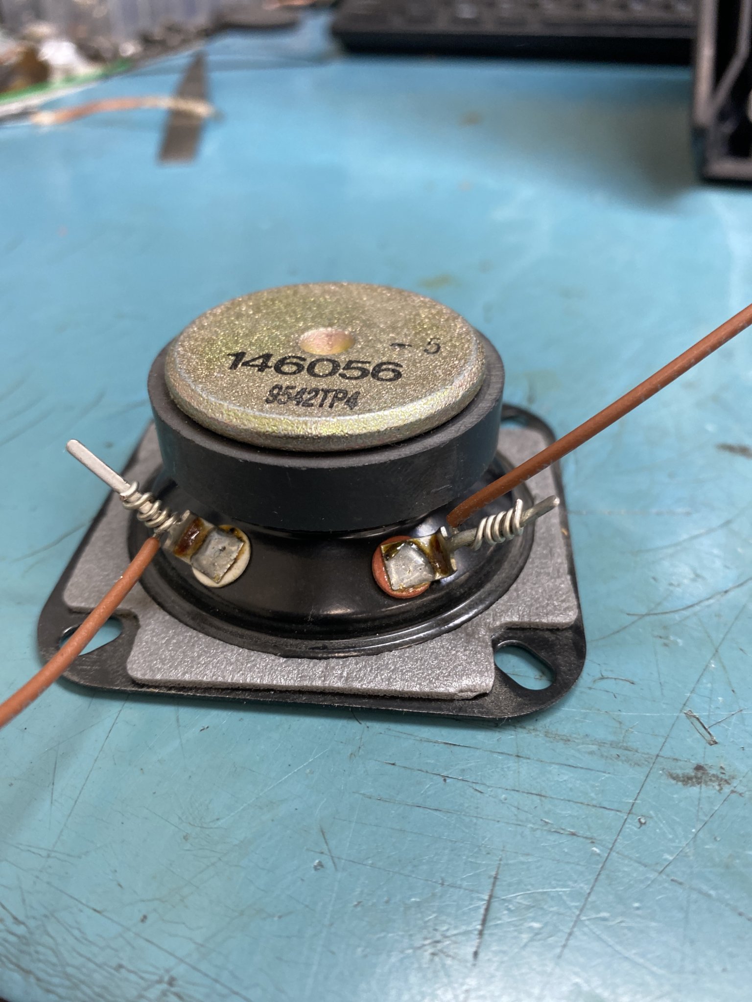

The upper image in #134 is the original Bose tweeter in the right tower. The lower image in #134 is the new Bose tweeter I just installed into the left tower; the speaker that has been the primary concern because that is the one with the mismatched third-party 8-ohm tweeter.
I just finished replacing the old original Bose tweeter in the right tower with the new Bose tweeter. I have reattached the speakers to my receiver and am listening now.

Please check the diameter of the tweeter wires that also seems to me larger compared to those that reaches the binding posts on the rear panel of your loudspeakers.This is odd. I cut the wires about two inches away from the terminals and found that the grey wire had been spliced with the red and then shrinkwrapped. The black wire also has shrink wrap. Something tells me this is not a factory Bose connection.

Those two wires I found connected to the right twoer's original Bose tweeter are somewhat thicker gauge, but only slightly.We are all anxiously awaiting your hopefully final response...
This is enough to create a difference that my "fanatical" accuracy would not be able to bear...Those two wires I found connected to the right twoer's original Bose tweeter are somewhat thicker gauge, but only slightly.

It would appear that the problem was down to the fitting of a mismatching, third party tweeter in the left speaker, possibly aggravated by a failing tweeter in the right speaker.

And yes, definitely easy of assembly. No other cost of a crimp on connector, no extra connections, no added costs for soldering/soldering process.
I have a pneumatic tool that does it instantly.
A pneumatic wire wrap tool will apply sufficient pressure to effectively cold weld the wire to the four sharp corners of the square post.
I can't see that wrapping just by using your bare hands could produce the same air excluding, anti-corrosion contact points.
