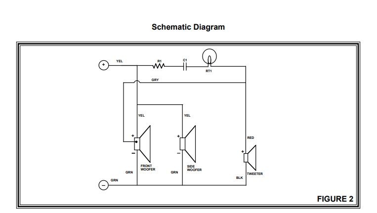

And if the grey wire in question is going to remain a mystery: SpineyNorman can you let us know if the front woofer actually has 3 terminals on it? The way the schematic is drawn leads me to believe that's the case, but I'm speculating.
And I'm even more confused since the terminal block picture has a yellow and grey wire tied together on one side.

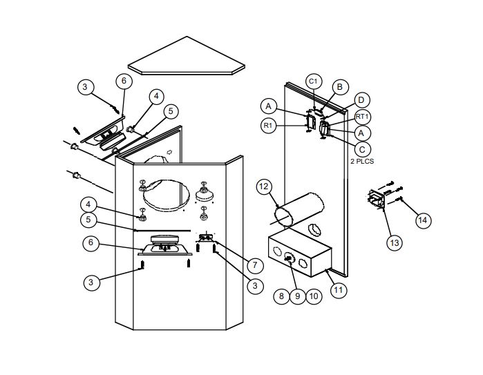

@6thplanet Regarding the parts list above, what is meant by "WW" for the 1st R1? R1: Resistor, WW, 5 watts, .5ohm
Also, what years are considered those in the "early production" that require the second bulb fuse?

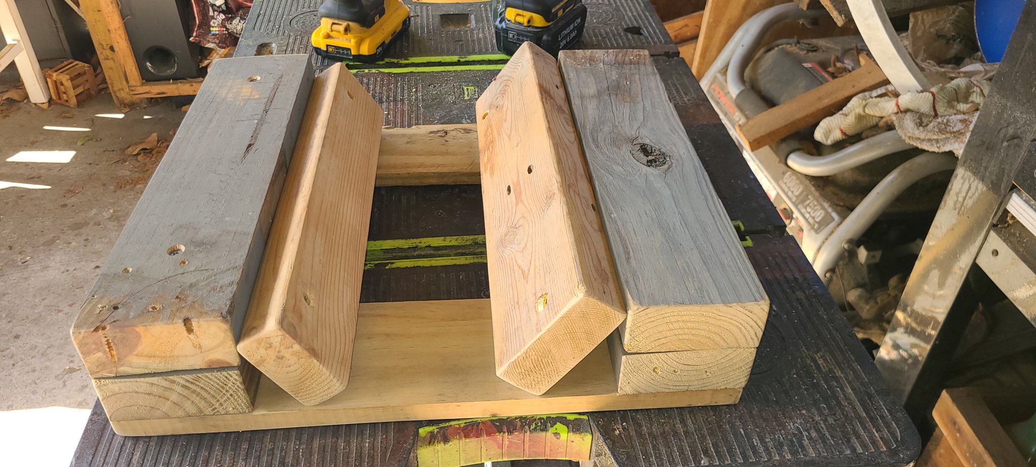

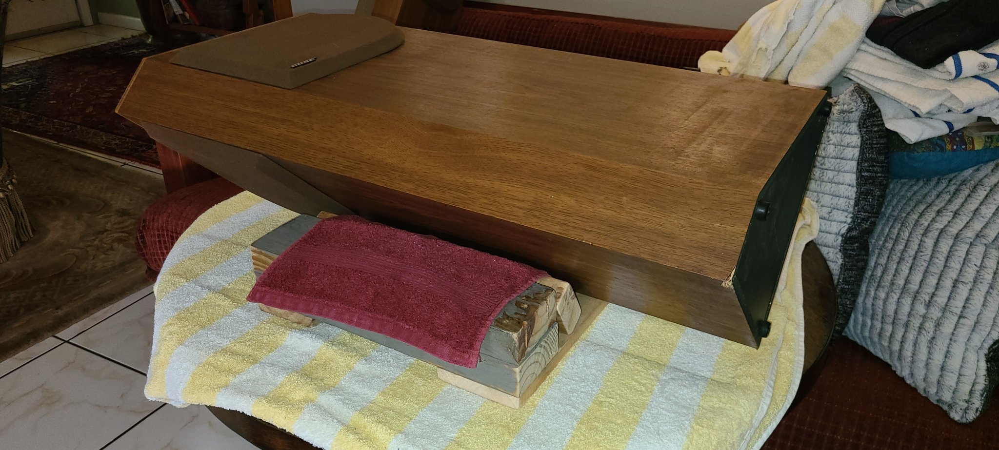

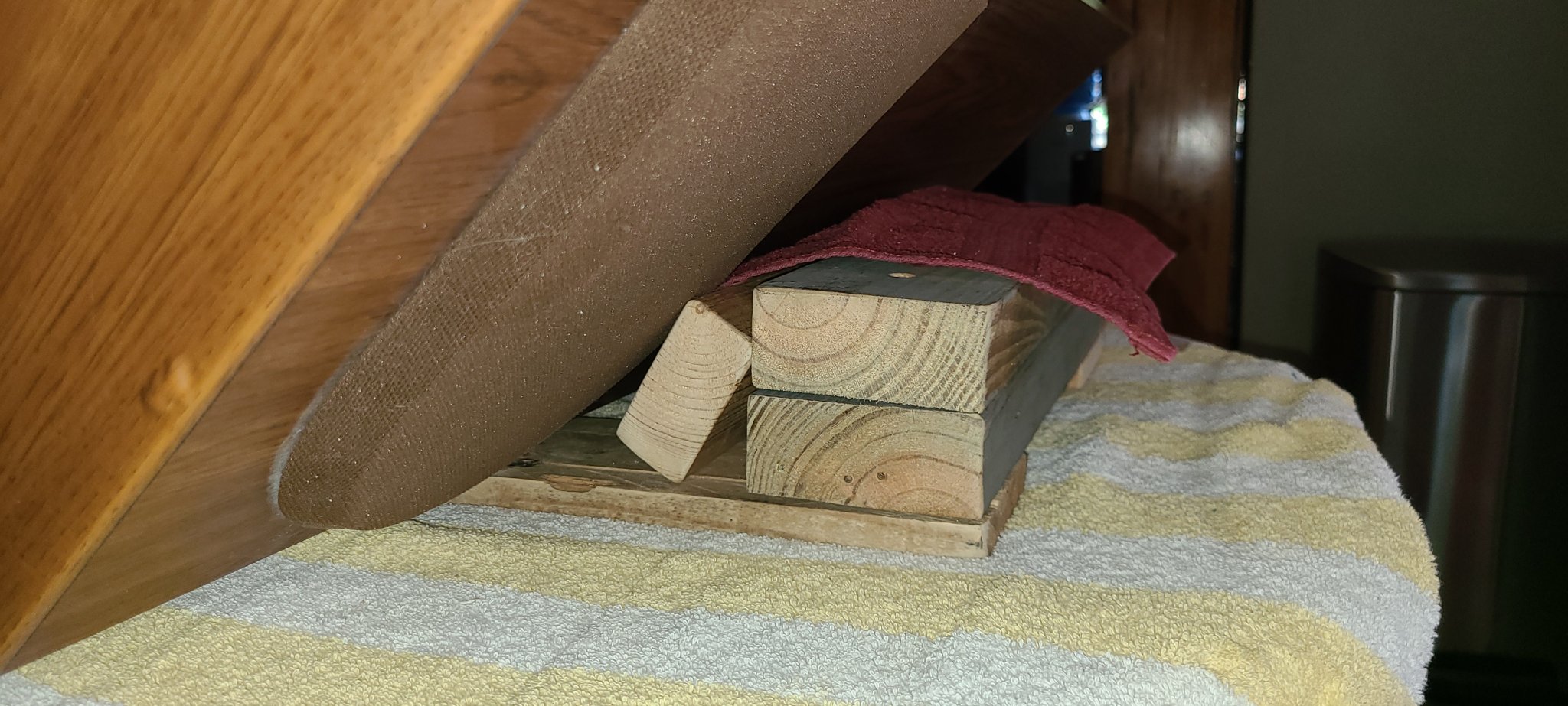

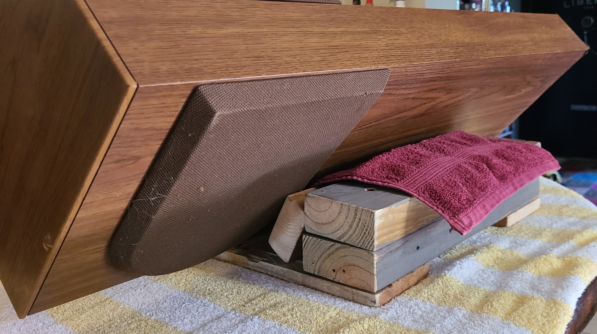

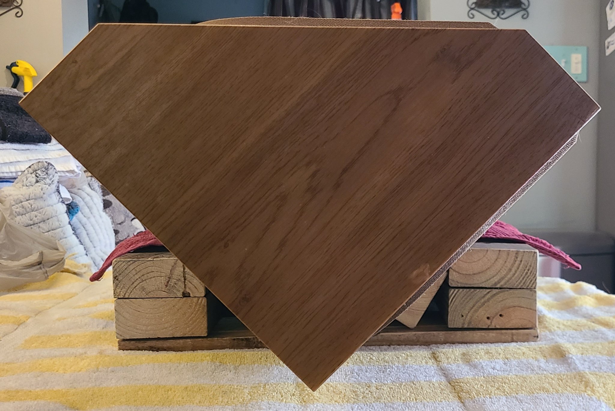

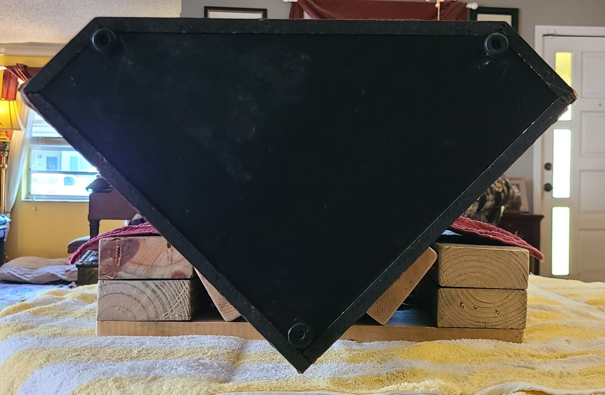

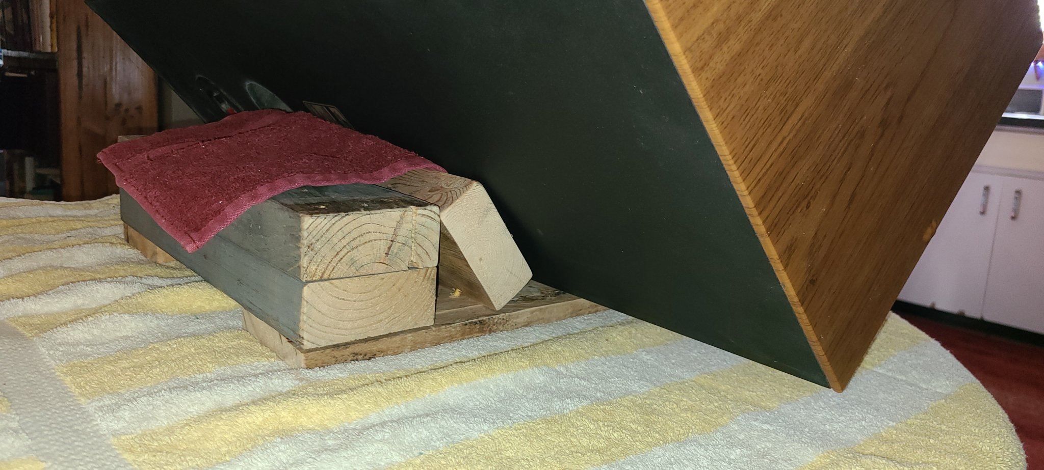

I constructed a stabilizing base to secure the speaker while working on it. The washcloths are temporary, I am going to cover the base with a large towel.
