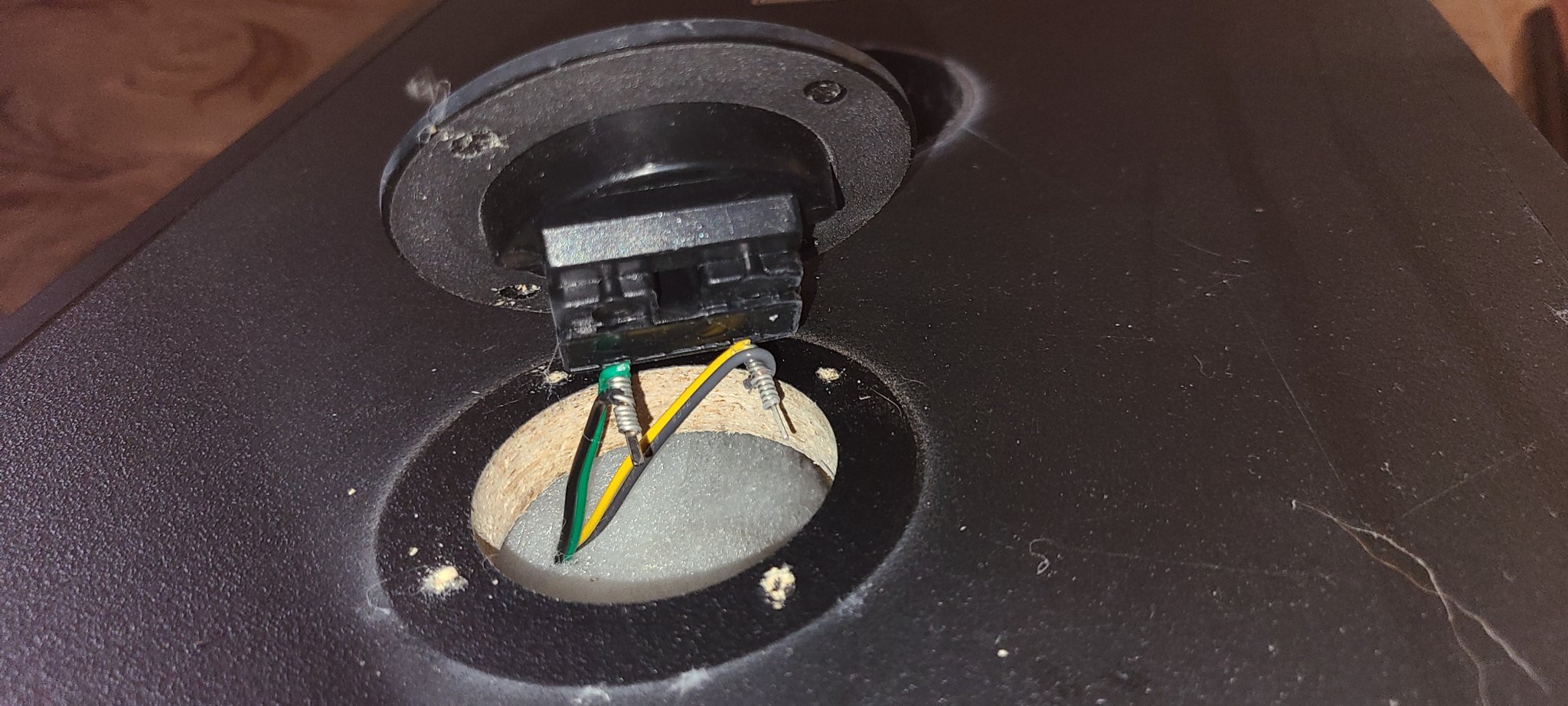

Are the connections to the woofer terminals wire wrapped?
If so, and you require to disconnect the woofers for ease of access, please note my remarks in post #15.
Oh, and take careful note of which colour of wire goes where!

Yes, I believe the woofer connections are wire-wrapped. I will take your advice from #15 as well as the wire colors and their path! Since I am going this in-depth, would it make sense to replace all of the wire with one of a heavier gauge?Yes, you have no other option.

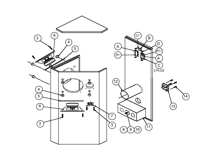

Will you provide the legend for the exploded speaker diagram?
legend

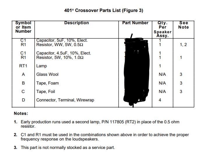

The parts you are interested in are clearly labelled, i.e., C1, RT1 and R1.
Where C1 is a capacitor, RT1 is a lamp and R1 is a resistor (but may be a second lamp).

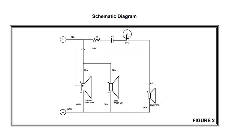

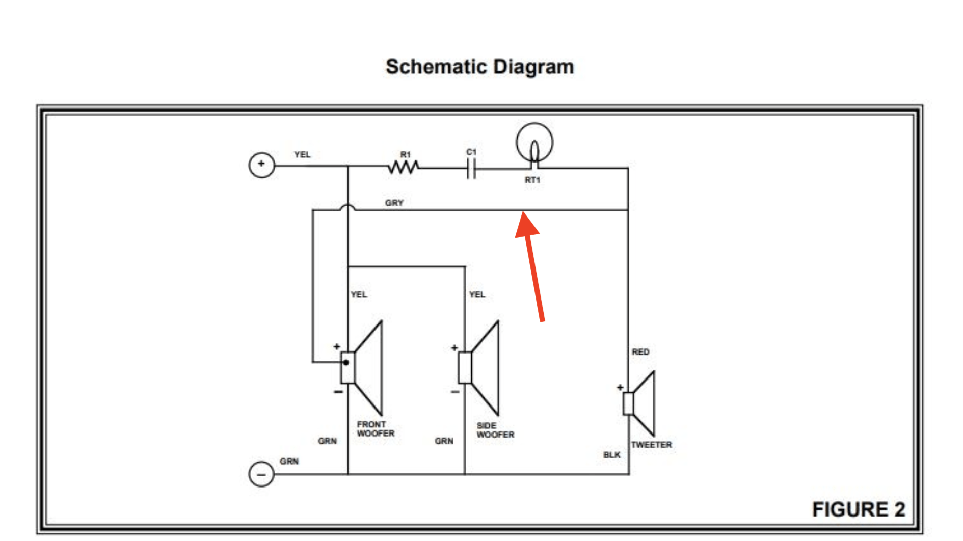

I find this part of the circuit interesting.
Yeah, I was going to ask about that!
What it does do is to furnish a good reason not to replace the existing wiring!
Could it be there to add inductance in parallel with the tweeter to form a second order HF crossover?
