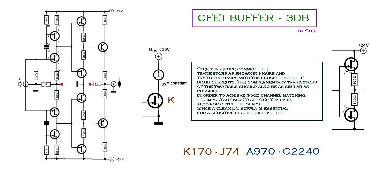

Stee Topology is extreme, it's only 1,4 degrees, Topology >>>CFET BUFFER<<< verified Photoshop SIMULATIONS!:smash:
Please click here --->http://www.diyaudio.com/forums/attachments/solid-state/150830d1261245600-jfet-audio-buffer-cfet-buffet.gif
Full Balance! ---> http://www.esafono.it/What do you think? :confused:
Here is the SPICE
C:\USERS\BOBBY\DESKTOP\MODEL.CIR Transient Analysis

Spice
Dear Ultima Thule
I gave SPICE, you can play in Photoshop SIMULATIONS!
It seems you're saying that:
1: Phase shift between the input and output of an amplifier (NOT stereo phase shift) is bad.
2: That phase shift between input and output decreases the effectiveness of feedback because the two signals being compared are out of phase. Thus the NFB becomes preoccupied with phase, which it can't completely remove.
3: Tubes don't have this issue, guessing by the way you describe this distortion as "transistor sound".
Am I right?
Also, I don't know what you mean by "reserve profits". Could you use a different word or phrase?
I am interested and want to understand what you're saying.
- keantoken
Am I right?
- keantoken
Vdif = v(A)-v(B) - Green
Output voltage = db(v(C)) - Blue
Amplification without feedback = Output voltage/Vdif = db(v(C)/(v(A)-v(B))) - Purple
Reserve gain= Amplification without feedback - Output voltage - Red vertical
For sinus:
Output voltage = Vdif * Amplification without feedback
The frequency is increasing, decreasing amplification without feedback, Vdif growing, increasing angle of rotation of the output signal. Rotation of the output signal gives a picture of the whole amplifier. Tubes have a lot MHz bandwidth, transistors no!
Especially output transformers (needed ) in tube power amps..
Show us THD vs. frequency (measured!!) graph (or THD at 20kHz, or IMD19+20kHz) in one of many of your realized amps!
Your theory about as "big" as possible overal NFB is totaly wrong (known 30years), this caused "transistor" sound- stabiltity issues in real world (maybee not so in your simulations without output stages),saturation in very nonlinear stages,e.g bipolar difamp without degeneration, very short linear region, resistive loaded output of diffamp, VAS without buffer or other attempt to linearize it before feedback and many others mistakes..
I'm talking about the tube and transistor, no talking about the whole amplifier. Tube has a much smaller RC constant as the transistor, I'm talking about. It can provide a rotation signal, the internal RC making decrease amplification. I'm not talking about what is also connected to the tube or transistor.
40 years of my amps have better sound than the DPA.
:p:p, very interesting, wasn´t it so called "ínner sounds" heard by nobody , only you??
Tubes-You can not (practicaly) realize power amp with tubes without output transformer. So talking about advantages in nonrealistic simulations is nonsense. So You can simulate audio power apmlifier with GaS Mosfets...Speedy enough??
And also much smaller output current, so transformer is innevitable..
Join height - condenser speakers directly to the anode, then take the transformer only for low frequencies. RC is a constant, not dependent on the current is dependent on the physical characteristics of vacuum tubes and transistors.
