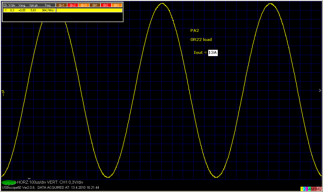

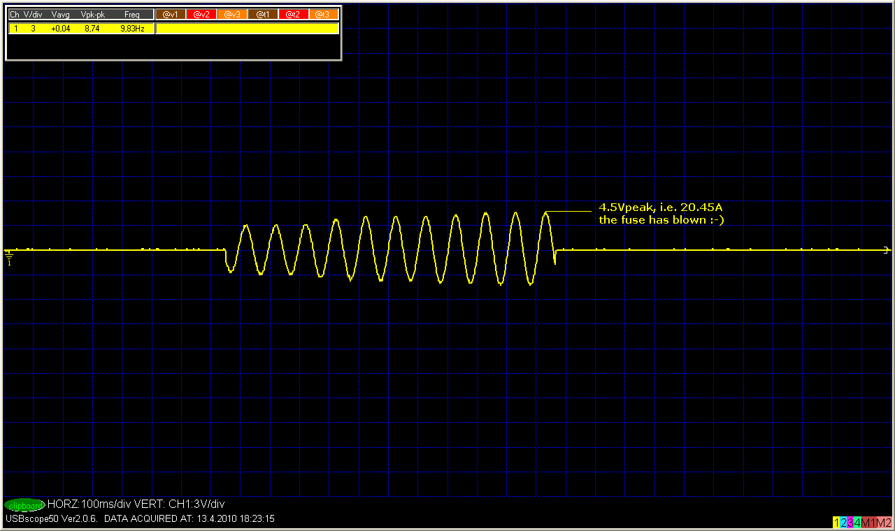

I have just tried more. At first, I have blown the PSU rail fuses. Then I have measured quite nice 13Apeak output current into 0R22, 1kHz sine. This is with 2 pairs of MJL21193/94.

Federmann, in case you would like to test with 0R22 load, please take into account that such load may change stability of the amplifier significantly.
No worries.
27-5,83≈21V, Transistor power 21V*13A=273W
In your 55W amplifier it is 2 * MJL21193/94 ? (2 * 200W +2 * 200W?)
Current limit is more than 13A?
PMA: What is your transformer, please?
Performance on 1 channel 27V * 13A ≈ 350W
Performance on 2-Channel 700W?
This amplifier is only for me and for my purposes. The current is limited only by PSU and fuses, and paralleled transistors have such SOA that they withstand short circuit (tested), with quite low supply voltage used.
If I built that amplifier for a customer, it would have a current protection circuits. Now it is just a research stage 😀
