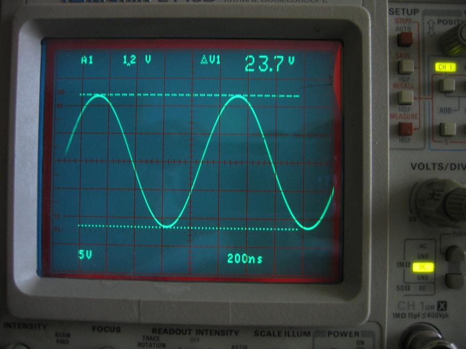

Oh no, but PA2 is only 2 x 55W amplifier. I assume that Sendy was meaning your 1kW amplifier (you have 20x more power than PA2), which is much more capable to yield high currents.
55W = 42Vp-p.
You showed very nice sinus, there is no current limit.
I have just tried more. At first, I have blown the PSU rail fuses. Then I have measured quite nice 13Apeak output current into 0R22, 1kHz sine. This is with 2 pairs of MJL21193/94.
no,55W = 42Vp-p.
55W into 8r0 is equivalent to 29.7Vpk = 59.3Vpp.
55W into 4r0 is equivalent to 21Vpk = 42Vpp.
You must specify the power and the load for the information to be of any use.
Which occupies the current restrictions? Is not seen working?
How much is the rail voltage? How much power is the amplifier?
It is the PA2 amplifier. Rail voltage is 2 x 27V at idle, and it yields some 2 x 55W/4ohm. Clipping was shown somewhere (solid solid state amplifier thread).

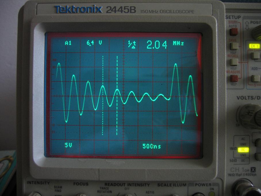

Federmann, in case you would like to test with 0R22 load, please take into account that such load may change stability of the amplifier significantly.

27-5,83≈21V, Transistor power 21V*13A=273W
In your 55W amplifier it is 2 * MJL21193/94 ? (2 * 200W +2 * 200W?)
Current limit is more than 13A?
PMA: What is your transformer, please?
Performance on 1 channel 27V * 13A ≈ 350W
Performance on 2-Channel 700W?
Yes. It is determined by F4A fuses 😀
OK Pavel!
But the current no limitation on amplifier.
This amplifier is only for me and for my purposes. The current is limited only by PSU and fuses, and paralleled transistors have such SOA that they withstand short circuit (tested), with quite low supply voltage used.
