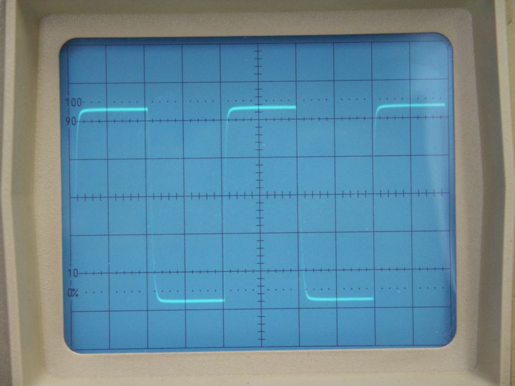

Many local feedback, overall feedback... 20kHz, 110V p-p into eight...mosfet amp with EC...little bit smoother, isn't it true ? 😎

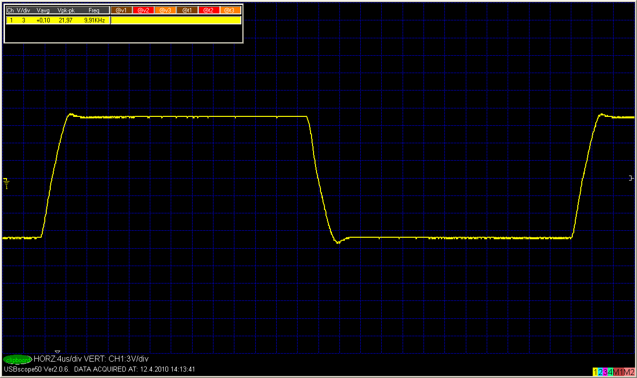

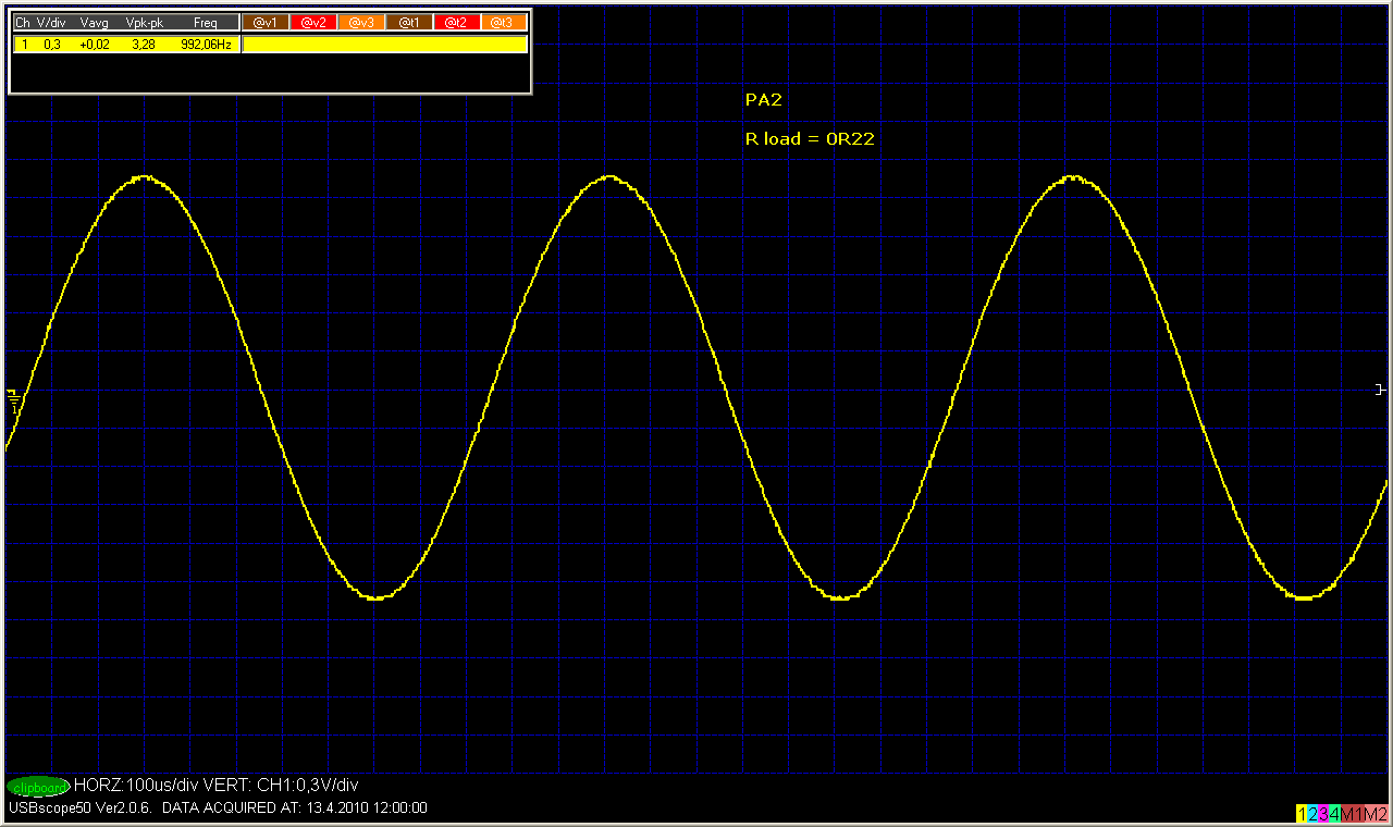

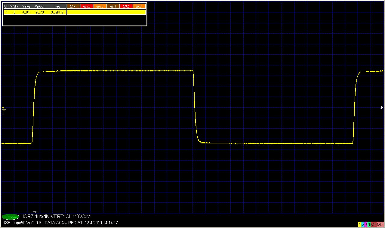

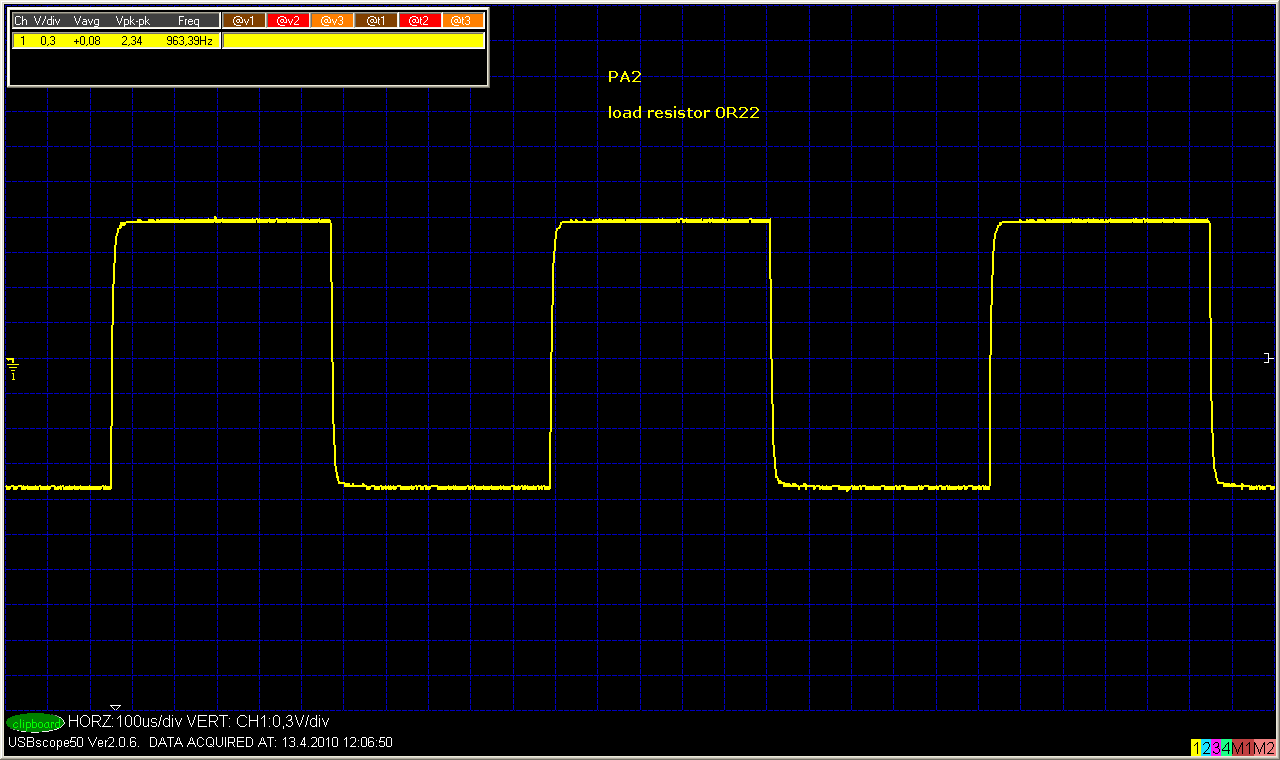

Why without load ? Are you prefer to use amplifiers without any load ?
Pleas, send here overcurrent protection test in your "HQQF" - 500W or 1000W amplifier, full supply voltage, 400Hz sinewave, 80% output voltage with no load and with load 0,1 ohm, 5-10 sec duration. Storage scope is recommended.
Impossible, than in 0,1R load may be less than 2V, oh no ? I"m waiting how are your overcurrent protections exact. You may set output voltage at 4-6V with no load and than test it with 0,1 ohms. 🙄
Mr. Federmann, Sendy is suggesting you to check your current protection by this way (he probably means your zener diode current protection).
