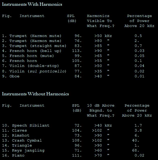

Acoustic signal 100Hz + 1 period 100kHz
Peak, rising edge, falling edge, always different.
Amplifier suppresses 100kHz -1dB, Vdif large 100mV, input transistors in the non-linear, the emergence of mutual modulation of signals. Distortion is non-periodic, distortion is heard, how much bias?
Distortion is generated by rapid changes. Distortion is not measured at a constant signal. The human ear hears what does not belong there.
have you some music that have some 100KHZ component mixed
with the classical 20/20KHZ range?...NEVER an amp will encounter this
situation, and if it s the case, then something is wrong in your
signal sources...
Wrong is when the absence of a frequency above 20kHz!

I do not care what is in Wikipedia, I do not care what is measured, THD, TIM-Transient Intermodulation distortion, SID slew-induced distortion, DIM-dynamic Intermodulation distortion and many more.
No measurements correlate with sound, no measure does not respond to what is heard. I'm looking for dependence between the rotation of the output signal, and by what is heard. There is no one who would deal with it, anyone not looking for such, I know it is not.
