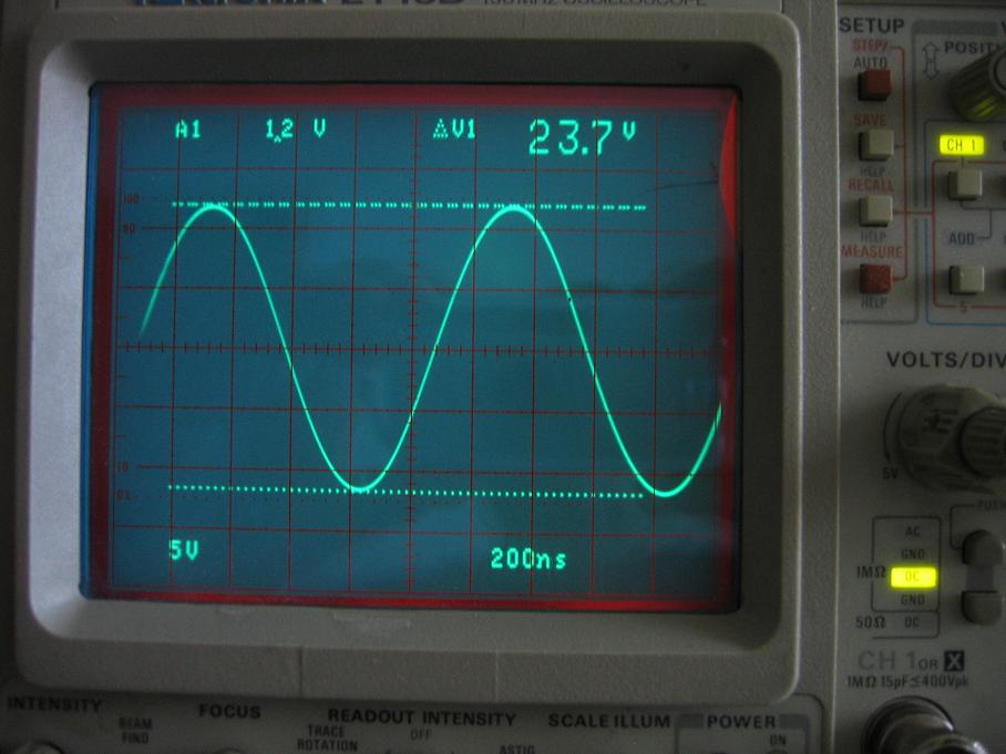

The basic problem of the uA741 is very low slew rate, 0.5V/us. Compared to this, the circuit I am showing has a slew rate of 250V/us. Thus, it can never dynamically saturate in audio use, especially if RC input filter tuned somewhere at 500kHz is used.
I have also shown the full-scale, 24Vp-p output at 1MHz. With uA741, it is only 8kHz!!

Answer my question - I have shown 24Vp-p 1MHz undistorted measured, not simulated, output. You speak about uA741 that distorts at 8kHz full scale sine due to slew rate of 0.5V/us. Why do you use such example??

Linear change (amplitude and phase) is normally not called distortion. As a 'distortion' we mean nonlinear distortion, i.e. creation of new frequency components not present in an original input signal. You speak about shape of amplitude and phase plot.
Your example with uA741 has nothing in common with phase shift. You are showing strong nonlinear distortion, resulting from slew rate limit. This nonlinear distortion creates new harmonics. Thus, your question on 5.7 degrees makes not much sense. You can ask for wide bandwidth, but you must same time ask for high slew rate.
