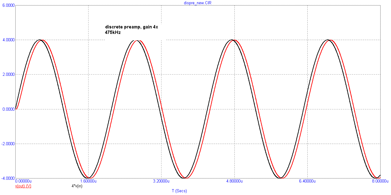

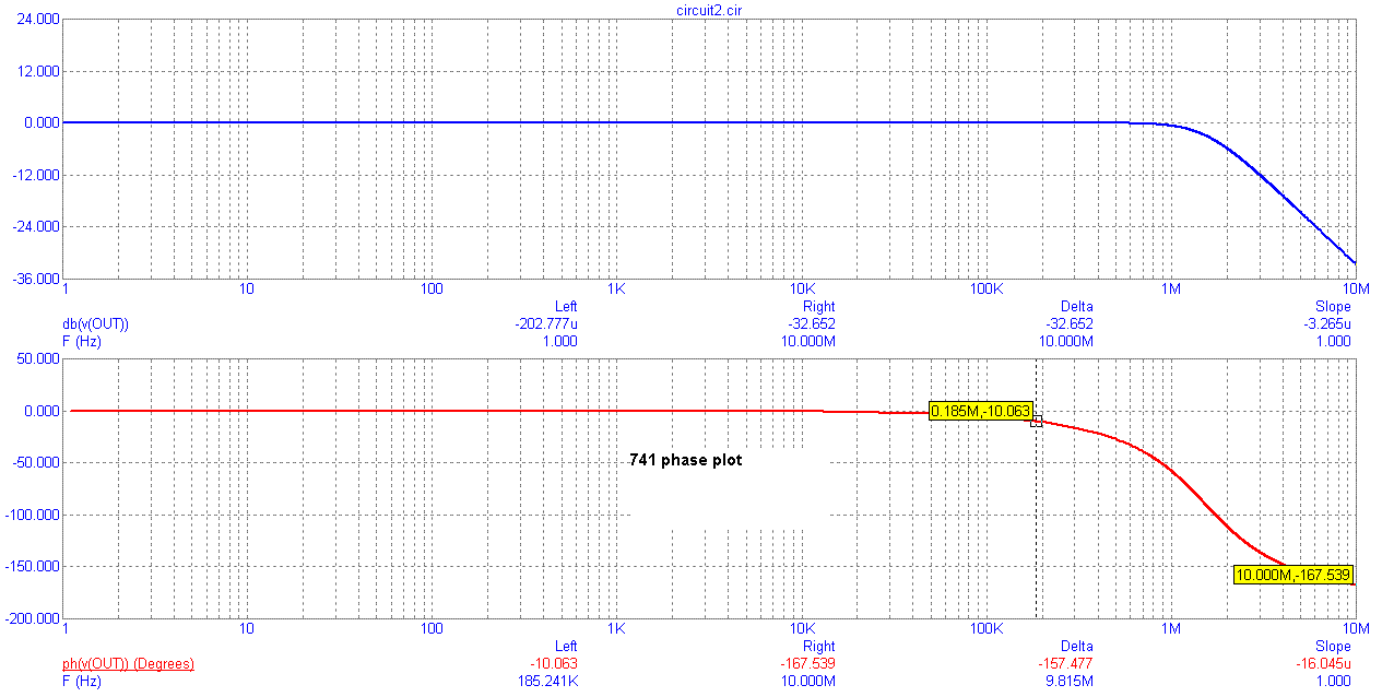

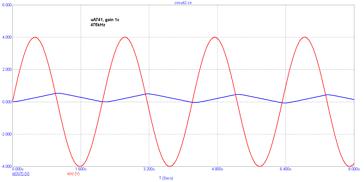

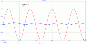

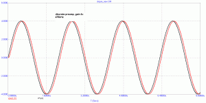

Federmann, here is discrete preamp and uA741 at 475kHz for expected output 4Vp. Also, a phase plot of uA741 (it falls to -10 ° at 180kHz, not at 475kHz)
Phase plots are simulated for small signal in MC!

I'm not talking about topology, I'm not talking about frequency. I'm talking about the delay expressed in angular extent.
For all amplifiers will apply: delayed 10 °, it would Vdif = arcsinus 10°

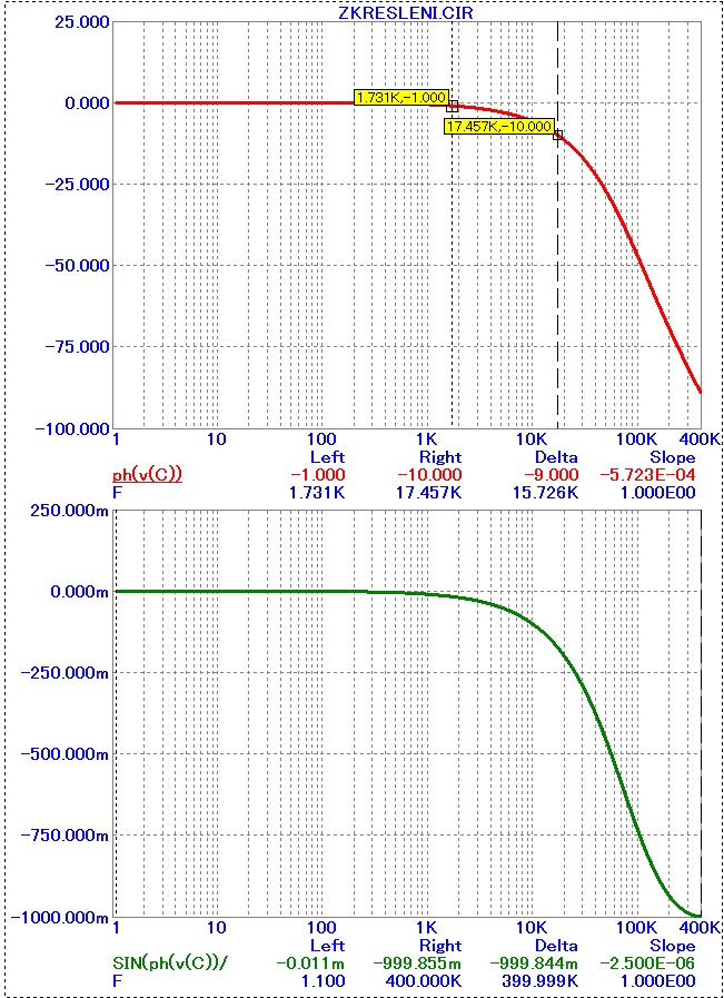

You are wrong 10 ° for 741 when 17.457 kHz, not at 180kHz!
Think, I wish good night.
I view, that the maximum acceptable delay is 5.7 ° for the entire frequency band to 200kHz. Sinus 5.7 ° is exactly 1 / 10 output signal, but you certainly read on my web.
I'm interested in the views and experience of others.
I also wrote: „is exactly 1 / 10 output signal, but you certainly read on my web.“
There can read that 1/10 signal, the power output is 1/100 of 1%. We can talk about the distortion of 1%.
