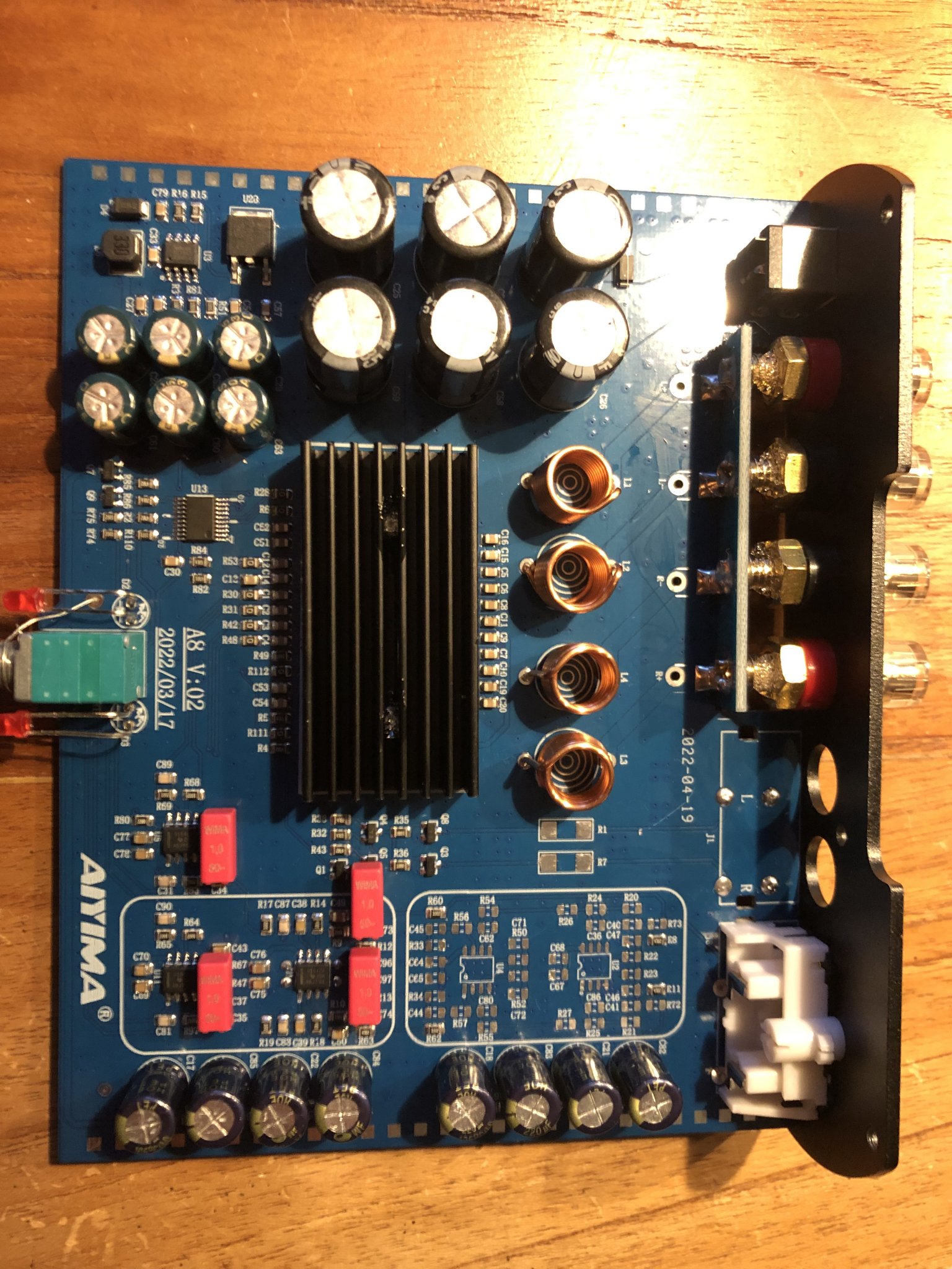

The newer A02 revision (17-03-2022) of Aiyima A8 has a “mystery” part……..
Got it today and operated the patient directly. Sorry for taking a picture after the mods. It now has 3 x OPA1642 and Wima MKS 1 uF in 2.5 mm pitch. It is breaking in as I write this ;)
Please find the differences.

I think it is the soldering of 4 x 100 nF MKS at the inputs. Forgot to connect my ESD wrist strap. A first and a good lesson. Also it lacked the 6 x 1000/35 bulk caps as I ordered those. Searched and also found a miniscule piece of solder tin but not at the pins so I can’t find a root cause except being in a hurry which is one of the worst reasons.
Gain was lower than with the previous one. Sounded pretty good, better than a vanilla Sabaj A10a. That A10a better stays vanilla ;)

Got the new one and the patient got an operation directly as usual. The patient survived and is playing now. 3 x OPA1642, 6 x 470 uF 35V Panasonic FC, 4 x Wima MKS 1 uF 2.5mm. Good stuff, sounds great with deep and tight bass.
Got it from Aiyima which sells stuff on Aliexpress. Requested the A02 version and got one but it could be that all recent ones being sold are rev. A02.
A casing has been drilled/prepared for a regulated linear PSU 22V 3A (LDO). A bit on the light side but when results are OK a 5A version will follow.
