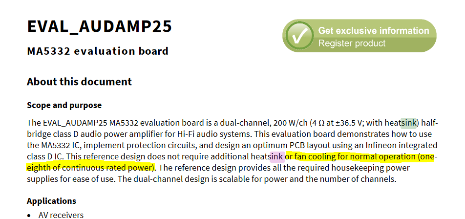

OK, thank’s for picture. They are more optimistic in the lower of these two videosView attachment 1106851
I have no firsthand experience, only what the eval board manual tells me so YMMV.
https://www.infineon.com/cms/en/pro...cs/ma5332ms/#!?videoId=6mUSJP_1Mg1JvPk7MoENJ1
At 3:50 into the video the crazyness begins. Actually 212 watts in and 200 watts out. So only 12 watts to heat the board. Impressive
But guess they have soldered the epad;-)
And in 60 seconds it overheats
Guess also they use kind load.
It will of course be even better with a small heatsink or heatcoupled to a metal plate. Se the distortion raises at 80 watts without.

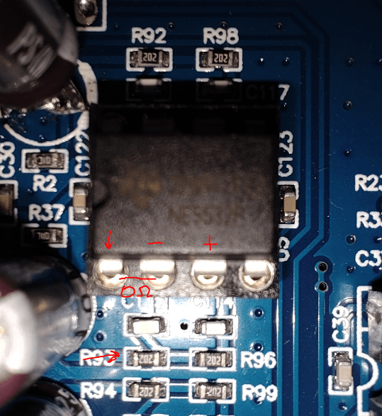

since I only use balanced inputs, I yoinked the OPA1656 out of my PA3S amps. No more worrying about it clipping into SE mode and introducing noise. I then swapped the LME4970s in voltage follower stage of my cheap DAC with the 1656 and it made a significant improvement! The 1656 is killer
It is directly tied inverting input to output. I think the 1656 pulled well ahead because I changed the I/V to 1k resistors for 1V:1mA. The dual pllel 9038q2m can output 7.3XmA in current mode per output so the total output is near 7Vrms Hot-Cold on the XLRs. The 49720 starts to fall on its face above 4V output.
I also changed the high pass / DC filter to a .47uF film cap on the bottom of the PCB and the R to 100k (e.g. R2 in that photo taken before the full mods)
Oh, and I reflowed the epads on the PA3s and supplemented the 1k on the volume pot contacts with a 10k to ground. MA12070 is silent with that 10k to ground. Can have floating/open inputs and just dead silence. The heatsinks dont even go above room temperature any more.

Strange is the 49720 fakes?It is directly tied inverting input to output. I think the 1656 pulled well ahead because I changed the I/V to 1k resistors for 1V:1mA. The dual pllel 9038q2m can output 7.3XmA in current mode per output so the total output is near 7Vrms Hot-Cold on the XLRs. The 49720 starts to fall on its face above 4V output.

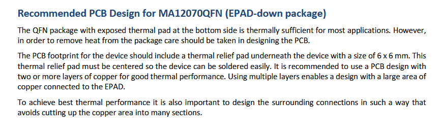

My take is: THe epad is listed as a connection by the IC manufacturer. It is not listed as epad/NC. Infineon documentation shows the epad to be minimum viable:
And the thermal conduction to ambient top/plastic coated areas) is awful. Again, from the datasheet.
It's like running a DAC's AVCC from a noisy LDO. Will it work? Of course. Will you get full rated performance? Absolutely not. But most MFG's probably don't want to pay for wave soldering two sides of a PCB.

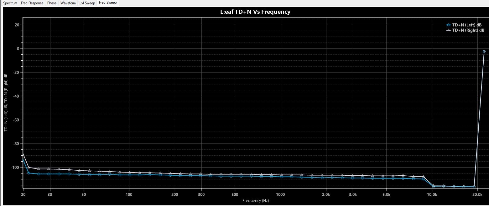

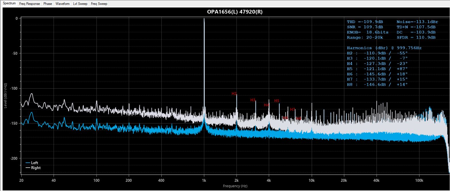

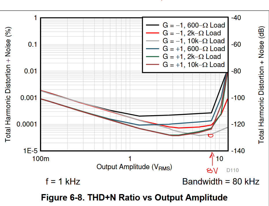

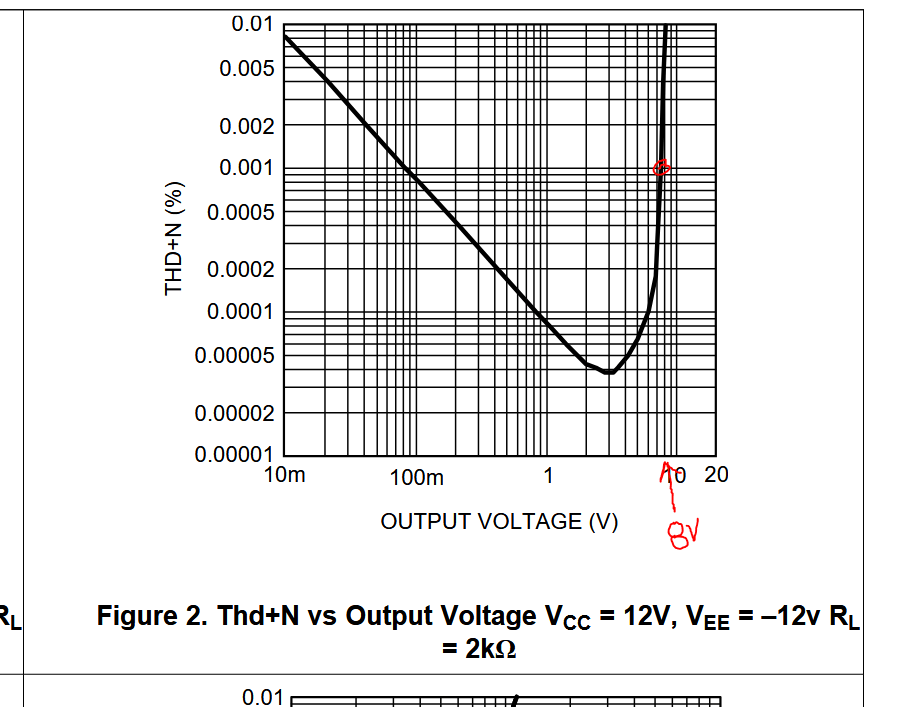

I got them directly from Mouser, so definitely not fakes. But I am not outputting 4Vrms. Instead, it is greater than 5.7Vrms or 8Vpp on each leg of the XLR (so the full differential opposing potential difference reaches >16V across the + XLR and -XLR).Strange is the 49720 fakes?
4 V should be no trouble if the supply voltage is high enough
Comparing the LME49720:
To the OPA1656 at 8V:
It makes a bit more sense.Both the I/V and the folower are set up on the inverting input. OPA1656 really likes this. If I dropped 2Vpp then they should be about equal. If I dropped 4Vpp then the 49720 should pull ahead. When I modded the output, I thought my DriveRack clone wanted a hot signal (because gain staging should be done as near the source as possible). That proved to be.... a mistaken belief. https://www.audiosciencereview.com/...ese-drivehack-pa2-hopeful-improvements.39071/
I might look for some 700-800 ohm 0603 1% resistors to swap in and see if I can coax out more THD+N numbers. (currently https://www.diyaudio.com/community/threads/es9038q2m-board.314935/post-7180448 ). I did fix the frequency imbalance on the right channel. I thought I harvested 4x 01D marked resistors but I grabbed 2x 01D and 2x 01C so I swapped two 01C with 2x 01C on the right channel. I have since swapped those again with the proper 01D so I'm not artificially elevating the highpass filter of a single channel. .47uF and 1k makes for a 338Hz filter which shows well on the RMS vs Frequency measure I posted. .47uF and 100k, as I intended, has a HPf of 3.38Hz.

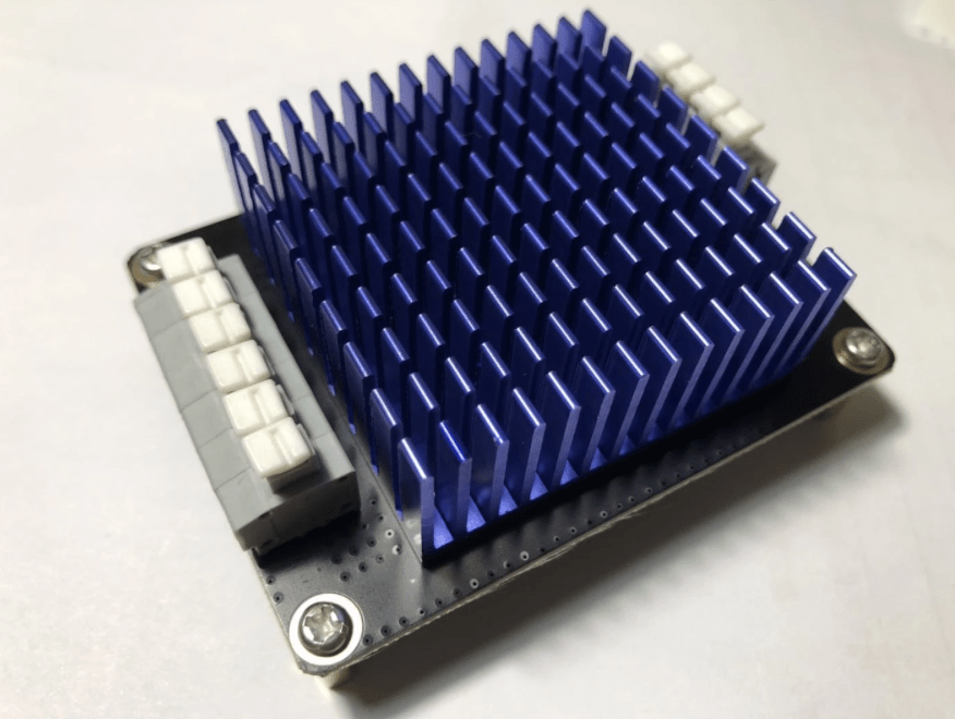

Anyone tried one of these yet? I am tempted, but for £40 I feel it would be better to get a half decent TPA3255 implementation..

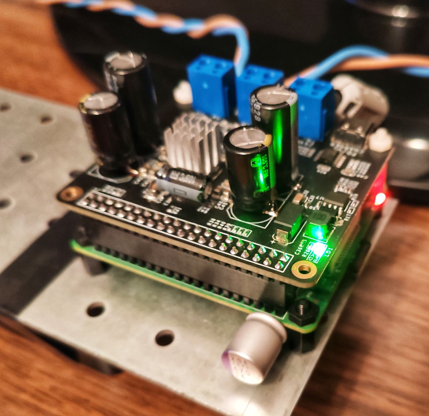

Well, bitten the (ok, affordable) bullet and ordered this module:
https://www.aliexpress.com/item/100...store_pc_home.smartJustForYou_6000601971963.0
Will be interesting to see how it compares back to back with the basic TPA3116D2 that precedes it.
