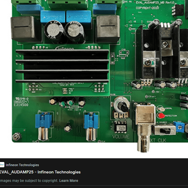

For the new 200w part they even make fun of heatsinks: https://www.infineon.com/cms/en/pro...cs/ma5332ms/#!?videoId=6mUSJP_1Mg1JvPk7MoENJ1

I think their marketing seems fairly geared towards this - heatsink-less and no-filter (or rather, just a ferrite bead) output. I was going the opposite way and trying to decide whether it's worth getting one side of a heatsink near the vent of a ported speaker, probably overkill to be fair.For the new 200w part they even make fun of heatsinks: https://www.infineon.com/cms/en/pro...cs/ma5332ms/#!?videoId=6mUSJP_1Mg1JvPk7MoENJ1

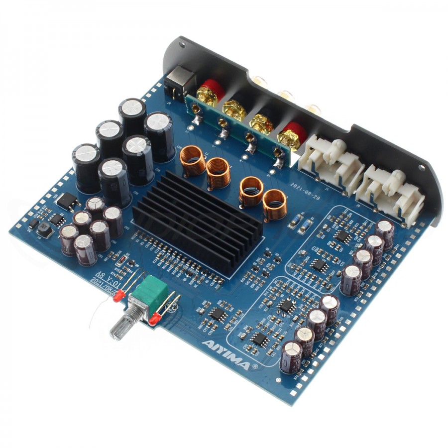

I was just looking at the Aiyima A8 internals. Looks clean but what do I know. Not the biggest heatsink but I'm sure it's enough.

ETA: I think the board styled after the eval module as shown several times in this thread is built to-spec though. It also has at least some ferrite beads which is more than some amps cough*topping*cough. Though for being literally filterless, the topping amps do sound impressive. The MA12070 seems like it is faitly easy to please.
Why are those air-core inductors needed in the output? They filter out high frequencies or what, and why?
According to the data sheet this chip is not really inductor-less but requires >1uH series inductors to make it short-circuit proof. You often find ferrite beads here - but these could saturate at higher currents. Thus an air-coil is not the worst bet. Its disadvantage of a high fringing field could be avoided by chosing a toroidal shape (Rogowski coil) instead. Btw - I wonder if its inductance even comes close to 1uH.Why are those air-core inductors needed in the output? They filter out high frequencies or what, and why?
I saw a discussion about another amp using the same chip and not using any inductor. Someone said it still works because the connected speaker supplies the inductance. So maybe those shiny exposed copper coils are just there for looks n marketing to plebs like me who know very little about audio circuits?According to the data sheet this chip is not really inductor-less but requires >1uH series inductors to make it short-circuit proof. You often find ferrite beads here - but these could saturate at higher currents. Thus an air-coil is not the worst bet. Its disadvantage of a high fringing field could be avoided by chosing a toroidal shape (Rogowski coil) instead. Btw - I wonder if its inductance even comes close to 1uH.
Do you think with or without or depending on size and quality the inductors can make any audible difference to the sound?
Maybe you could read the datasheet? All class D amplifiers till now needed either ferrite beads or coils to form an output filter including the loudspeaker coil. It is not marketing. Saying it is "filterless" is mainly marketing. The Chi-Fi design rule is to make the filters as cheap as possible so underrated parts, minuscule ferrite beads or the usual ... no filter at all. A coil + caps = good. A ferrite bead + caps = adequate. A single air coil = mmmmm but better than nothing. Nothing at all = not OK. Selection criterium for an MA12070 amplifier is to pick one with any form of filtering. No filtering is bad choice.

The A8 is one of the better cheap MA12070 designs.

Either way, that board which I think is a carbon copy of Infineon's eval board actually does a ton of things right. Since it is wired for BAL it;s pretty obvious they meant it for active speakers or something where the wire lengths are super short. A little expensive if you want PBTL, and I guess once you add the PSU it's not particularly inexpensive either but yeah. It;s like a pure datasheet board (which isn;t bad in this case). TI also tends to make some really killer eval boards. I could only do an 8k VR setup over a 50' fiber DP cable due to a TI eval board for a DP1.2x repeater.
Only for 25W though... at 10% distortion. The MA5332 is internally closest to an IRF209x chip. Thermally, the MA12070 is in a whole other league. Infineon also has a whole page (3-5 images) about heatsink mounting on the flip side of the PCB (the chip faces the other PCB).For the new 200w part they even make fun of heatsinks: https://www.infineon.com/cms/en/pro...cs/ma5332ms/#!?videoId=6mUSJP_1Mg1JvPk7MoENJ1
thank you, from someone who doesn't know enough to get anything from reading the datasheet.
If you will, what in particular do you like about the A8 design compared to some others?
For the 12070?.
In the video they show ma5332 with 2 x 100w out and less than 220w in. And without heatsink
