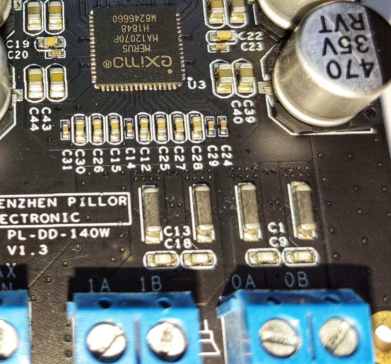

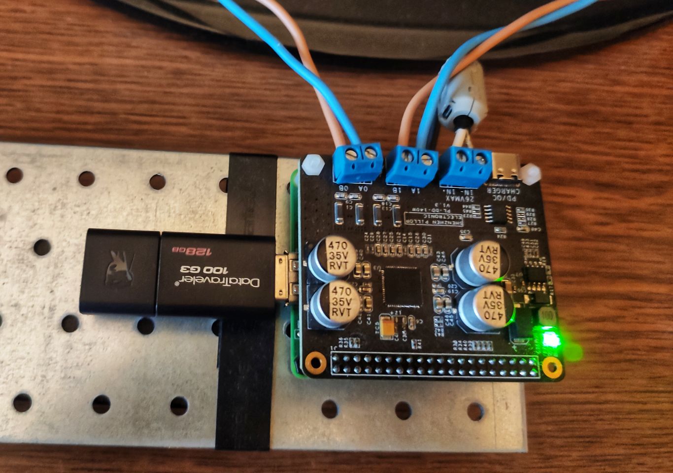

No. I have a raspberry hat: RPi-3A+, 19 volt psu meanwell gst90, software YoctoAP x64. But the installed parts probably do not match the design or are fakes - electrolytic capacitors and ferrites. I want to replace them.

Ferrite beads are as per the datasheet. Maybe not the exact model, but I havce a difficult time believing that ferrites from the same mfg with slightly different shapes but similar overall volume will be much different. The poly caps are as per the datashooet as well, just with double the amount and a higher capacitance. I haven;t seen that design before. Looks close to the reference/EVM sort of https://www.newark.com/infineon/ref...|ptaid||&CMP=KNC-GUSA-PMAX-Shopping-High-ROAS
User manual for MERUS™ MA120xxx reference boards - L0A, L0B, L1A, L1B, SMD ferrite bead, Z = 56 Ω, Fair-Rite 2512065007Y6. Size 1206. On my board, ferrites of a different size are installed. Fake?
It is the same with electrolytic capacitors, the manufacturer is unknown, there can be any marking on them. This is an ancient Chinese game. I plan to replace with Panasonic fm 330/35

Replacing the ceramic 4 x 1 nF at the outputs for 100V rated film caps is an easy improvement. I would leave the beads. Use SMD electrolytic caps. The used caps are generic chinese quality. A member here once found out the brand but it is nothing special.
While I just gambled it would be good to use ultra low ESR caps. It was that FC was in stock or I would have chosen ultra low ESR caps for PVDD. It surprises me that it sounds better with just 1500 uF. Probably the SMPS likes less capacitance.
Parts shortage is becoming a nuisance. In large can snap in I could only get Yageo caps produced in 2016.
The use of ultra low impedance electrolytic capacitors (hybrid polymer or os-son) requires special care, especially if shunt ceramic capacitors are used. High probability of occurrence of resonances. It is necessary to carry out measurements with an oscilloscope after installation is completed.

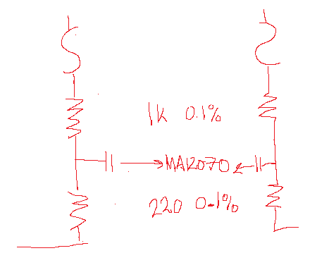

Should not give any issues unless one couples it directly (user error) or shorts inputs to each other or GND. I meant to short the caps and to use better quality ones earlier in the chain. Netto result is the same (electrically). From onboard X5R to external film so to speak. With these boards there is almost no possibility to directly replace existing mediocre caps for better stuff. I shorted the caps in a few devices and used external caps without issues. Point is to use small film caps with short lead wires. I found the Wima 1 µF 50V in 2.5 mm for use as input caps for the opamps but I fear the PCB tracks will peel off this time.
The A8 has about 24 caps around it.... of which not all need to be replaced but still. Meanwhile the A8 has moved to my main system. I am satisfied with the results till now. Don't ask me the why and how as I simply just do something in this device (with thought, against principle but convenient) but it has nicer highs after the cap replacement too. I think it is musical, precise, has deep bass and good stereo imaging. In fact I want to keep it alive and refrain from risky jobs.
The issue with the chip is that doing things like we want it will cost a lot of money so modding existing boards is the practical way of dealing with it. Drawback is that "low cost" is spelled all over the boards.
Should not give any issues unless one couples it directly (user error) or shorts inputs to GND. I meant to short the caps and to use better quality ones earlier in the chain. Netto result is the same (electrically). From onboard X5R to external film so to speak. With these boards there is almost no possibility to directly replace existing mediocre caps for better stuff. I shorted the caps in a few devices and used external caps without issues. Point is to use small film caps with short lead wires.
No shorted inputs and coupled with MKS 4.7 uF short wires.
Proctection mode even with no inputs.
Measured all input pins? They all should have the same DC offset. Could be a very thin tin whisker (also between inputs). I have a PL-AD-160 with shorted input caps waiting to be powered on. Not today though as I will be away a few days.
