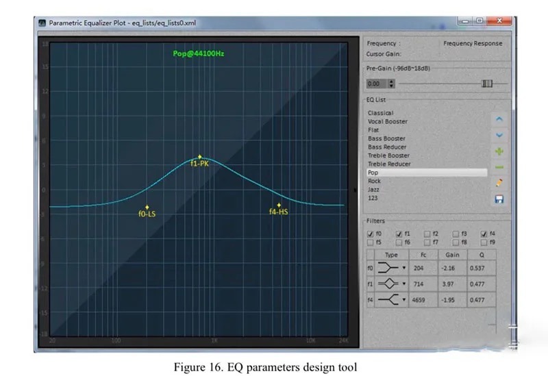

Some questions. Are there 2.1 ampboards with bluetooth available(preferably the chips that have integrated DSP functionality and can be set by non-large-company individuals/consumers like me) ? If one needs separate BT board and separate ampboard is there an I2S board in the 2.1 setup that works out of the box without I2C previous setup like I read some had trouble with, I think the DSP BT settings alone will give me enough headaches (For a project like PaulCarmody Isetta but digital BTdsp xo). The I2S datasheet shows some specs a little inferior to analog input, why, and will BTchip I2S out to I2S ampboard outperform an analog combination??

For many other applications, it might sound 95% as good (totally acceptable to most causal users) that a DSP based crossover can work. I did a little digging and found the cute little BT 5.0 board with TWS (so you can stick one in each cabinet for left & right) and have ability to program DSP XO, and EQ. All for $13 (minus your amp). It’s analog out though - so not sure if your I2S requirement is met but this leaves the majority of 2 Ch Class D or AB chip amps open for a remote BT active speaker application. I think 2.1 is also supported.

The Tinysine boards use the 1701 DSP so you need to learn SigmaStudio. If you have a good understanding of basic DSP concepts and filtering then SigmaStudio isn't hard to learn. I think people have a harder time getting the programmer to work than actually using SigmaStudio. And SigmaStudio is very well supported by Analog Devices: there's a helpful Wiki (with examples and tutorials) and you can join their "Engineer's Zone" forum to ask or search topics. Several people have also written SigmaStudio tutorials.

Has anyone here started working on a MA2304DNS design? It uses the same switching technology as the MA12070 but has embedded DSP. The DSP looks at least comparable to what you get with the ADAU1701, and it should be great for building active speakers with crossovers, EQ, DRC, delay, etc... Since it can provide up to 19ms of delay, it could also be a good choice for multi-amp line arrays with electronic curvature.
Their design software looks easy to use, but there is limited community support for DIY users, so it is unlikely that there will be low-cost modules available for a while, at least. The evaluation board is about $220, but chips are available now from Digikey/Mouser for about $7.
