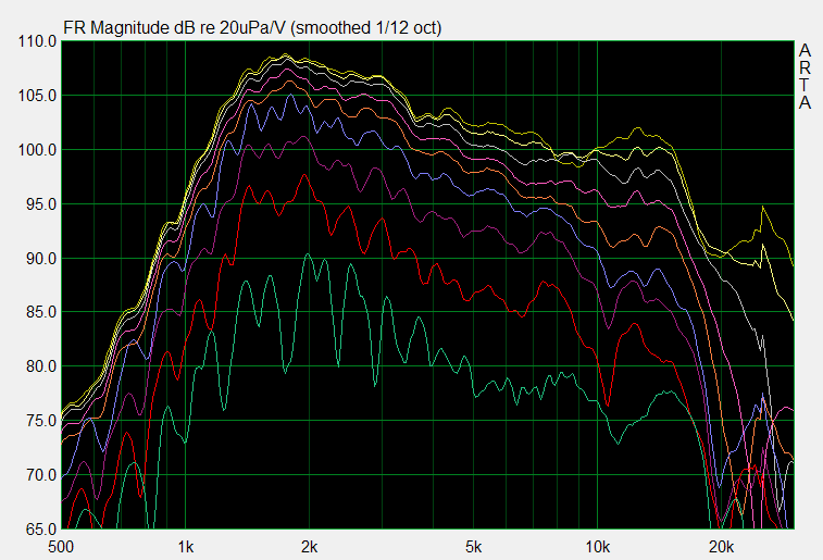

I have never done EXACTLY that measurement, but when I was first playing around with the tweeter (a single unit) I took this measurement with the tweeter mounted using only one screw holding it to the top of a baffle, so close to being in "free air". See attached. I didn't record the measurement angles but it mgiht be something like 0-11-22-33-44-55-66 degrees, or perhaps 0-22-44-66-90. Regardless, you get the idea.
What you can see is the waveguide not all that effective around 2kHz, but is increasingly so at higher frequencies. This means the driver alone is tending towards omni at the low end of its passband (where the traces bunch together).
When you compare this to the back-to-back (dipole) implementation SHOWN HERE, the on axis response shape remains about the same as the single driver, but around 1kHz the response is no longer quasi-omni but has taken on a dipole character. No sign of peaks or dips like you find for a two point-source model with the same separation, which I found very surprising. So my guess is that the front and rear tweeters interact to form a null at 90 deg around 2kHz, but above that the increasing directivity from the waveguide causes them to see each other less and less, and you get two independent sources, one frontward firing and one rearward firing. I can only guess that the waveguide makes this all happen by having the right directivity at just the right frequencies.
These tweeters are cheap (Dayton ND25FW-4 from PE at $17 each), so you can pick up a pair and try it out yourself. A pair can be used to make the least expensive dipole tweeter that I am aware of, and the distortion performance is really not too bad.
That seems (to me) very surprising. A 1" dome tweeter should be a monopole at 1kHz, even up to several kHz. In the Note II I think you were using the OX20, which is only a 3/4" dome however, your top plot shows the rear tweeter down around 16dB as measured in front (green trace). How were these tweeters (the OX20) mounted? Was a small baffle used? I haven't seen a pic of the speakers with the grill screen off showing that detail.
Why do you think the rear tweeter output was not more omni and seen in the front? For example, attached is data I found on the web of the OX20 hanging from a string. It's very omni around 2-3kHz.
Pic Legend: Green = 0deg, Red=45deg, light blue=90deg, blue=180deg.
. The Note used the OX20, in a small wave guide, from 6k up. The NaO II, which is what the first 2 figures are from, uses Seas Excel T25 front which is flush mounted on the 11" wide baffle and a 27TDFC rear tweeter mounted on a 5" diameter stand off, 2 1/4" tall.
