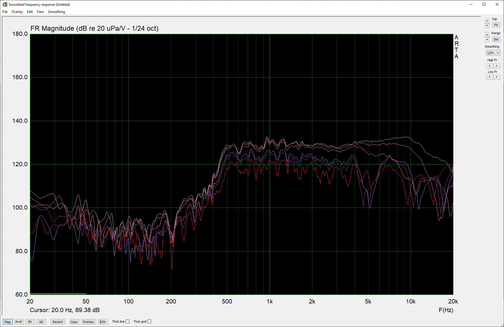

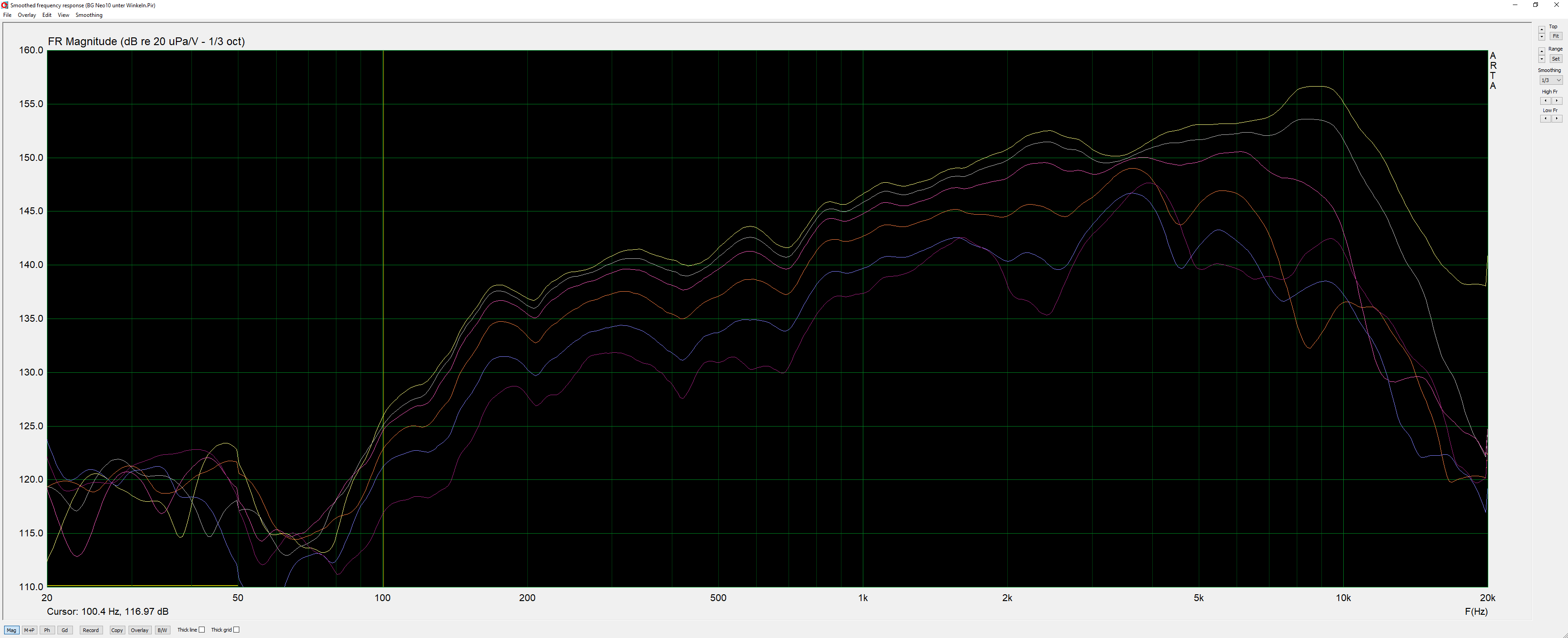

Hi all,
I made some measurements of a planar driver (I'll tell you later which it is 🙂 )
The measurements are - from top to bottom 0° - 15° - 30° - 45° - 60° -75°, measured at a distance of about 80cm.
For a dipole loudspeaker in the sense of the idea of this thread, what would be - from your point of view - the usable range, considering only the frequency response?
The lower end of the usable range will most probably be determined by the distorsion measurements, so I would be particulary interested in your opinion about the maximum upper crossover frequency.
What would be perfect / very good / acceptable)?
Best regards
Matthias

It might be possible to use all or part of this range. To me, the metrics that limit the frequency range within which a particular driver can be used are:
  • Distortion: A driver may have output, but if the distortion is too high at the SPL level that you wish it to reproduce then it is not suitable. I typically set a limit of 1% distortion at a relatively high SPL level compared to what the driver might experience in the loudspeaker system to set frequency limits based on this criteria
  • Directivity: The curves in your measurement appear to show relatively constant directivity, except around 3.5kHz. It is up to the designer to decide whether this kind of response pattern change is acceptable in the loudspeaker system, or if the driver should be crossed over to another one above/below the problem area in order to exclude it
  • The Need for Frequency Response Shaping: for example in your measurement, the response tilts down towards low frequency, amounting to about 15dB between 200 Hz and 2k Hz. This will need to be equalized (flattened) as part of the crossover, especially if the band is wide. How will that be done? The signal to the driver can be lifted (power is increased) or cut (power is reduced) to shape the response. If lifting, how will the driver respond with more power applied (e.g. will distortion increase at higher SPLs?) and will the higher power exceed the amount that the driver can dissipate safely?
  • Other Performance Metrics: Does the driver have ringing or energy storage issues within the passband? A cumulative spectral decay ("waterfall") plot or burst decay plot (a la Linkwitz) can reveal problems like these.
Apart from the frequency responses, a few additional measurements ( especially distortion) are needed to really know the useful range of this driver. So far it is looking good. Can you get and post some more data?
@bentoronto: ok, here you are...
  • it is a planar driver, open back, front and back radiation can be considered as nearly identical.
  • measurements were done in my living room (7.5*7.5m), with at least 2m distance to all walls
  • height above floor was about 1m, for both, the microphone and the driver
  • driver and microphone stayed at the same position during all measurements, only the driver itself was turned around according to the angle to be measured
  • the driver was measured without any baffle, except that it was mounted on top of a 30cm wide baffle with the woofers, which are intended to play below this driver. So it was 'nude' to the top, left, right, but not to the bottom edge
  • microphone used was a Beyerdynamic MM1, with an individual calibration file to correct the frequency response.
Though measurements neither are 100% accurate, nor calibrated, the shown picture should be good enough to show the general behaviour of the driver.
Well, well, well... a very worthwhile contribution.
My first impression is that readers of this thread will now realize that their intuitive notion of how dipoles work - based on textbook physics - is misleading. There is little indication that the rear wave is sneaking around and cancelling the front wave*, at least in the band tested here and right to 80 degrees. The drop is small and hard to proportion to wavelengths, it is not the expected drop as the freq does down the scale. On the contrary, the polar response in your room and as tested is really good.
I think the intuitive feel people have is that at some freq related to the dimensions of the baffle, the response drops off a cliff. And you must insert a Linkwitz correction. Unless your secret driver is a lot larger than I imagine, there is no drop-off point even for a rectangular driver that ought to show one.
Now a days, with woke audiophiles using DSP, we look for orderliness, transient speed, and low distortion; because freq bumps and dips and trends (like your plots) can be easily adjusted, assuming they still appear when measured at listening chairs.
Just a first rough peek at the drivers, but those curves look pretty good to me.
B.
*DIY posters are always forgetting that dipoles ought to be adding together exactly as often as cancelling together; must be some kind of natural pessimism here.
@Charlie,
thanks for your suggestions.
with the design goal to have a (horizontal) dipole behavior as good as possible, I could imagine, that the behavior of that driver at 3500Hz is not really acceptable. However, I have no real experience or comparisons to assess, if this would cause an audible problem.
Assuming, that I add a dipole tweeter, which has a very good constant directivity, I wonder, at which point I should crossover to be safe.
It is not only the behavior at 3500Hz where I'm asking myself, if this is compromising the dipole radiation, maybe also the frequency range above 2000Hz, where the driver shows increased beaming.
0°/15°/30° are very good, but with increasing angle it does not look as good anymore.
But is this really relevant?
By the way, I will use the software Acourate to design my crossovers.
So nearly every imaginable filter will be possible, even Neville-Thiele or the fantastic proprietary filters designed by Uli Brüggemann, which I mentioned one year ago in this thread: Neville Thiele xover filter discussion

Those curves are quite good, esp for something with as wide a band and esp polar.
Unlike the stupid way we use woofers, the goals are (1) to keep the driver's resonance out of play (where sound and longevity can be compromised) and (2) to eliminate where the driver's FR seems faulty. And apropos high end, not to sweat getting full output once over 10kHz, only your dog will notice.
The slope of the XO is what determines how far away the crossover must be. My guess is that builders tend to underestimate how much bad sound is coming out of mid and upper range drivers due to the XO not being high enough or sharp enough.
B.
It looks to my old eyeballs that it can handle 200-12kHz very fine (which would need maybe a 500 Hz XO. That's a lot. Maybe not loud. Distortion? Hate to admit it, but some of those planars could compete with ESLs, almost.

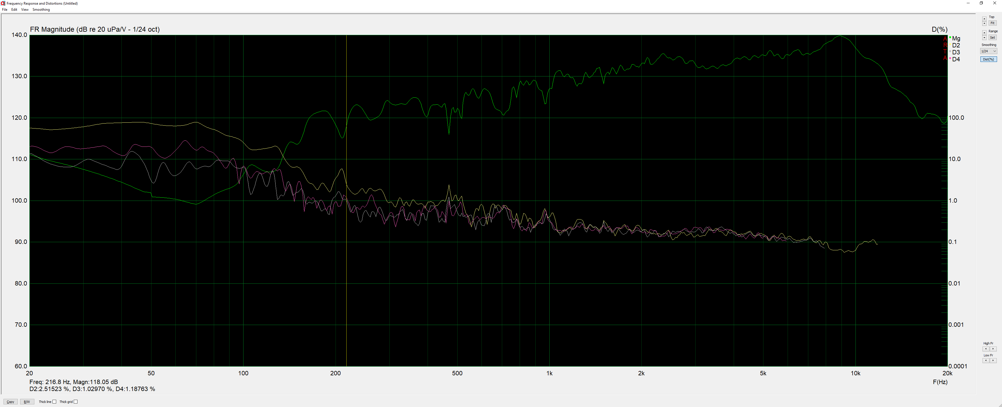

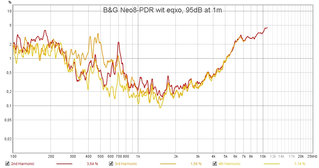

Hi, I was pretty sure it was a Neo8 or Neo10 or clone.
I use Neo8 nude dipole with LR2 800/3500Hz, measurements below. Distortion in low end and nonlinear dispersion in upper end are limiting factors. Crossover steepness is also important when considering xo points.

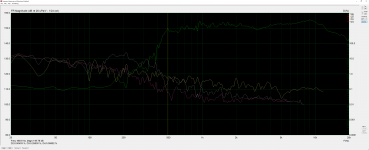

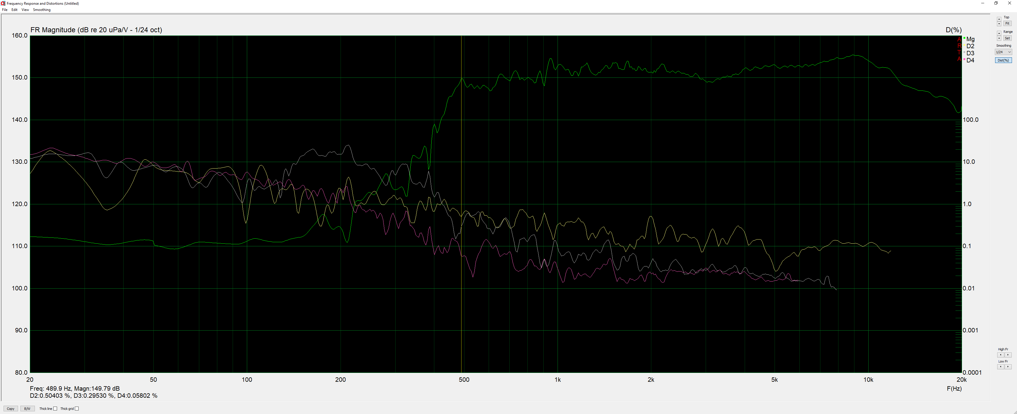

At the moment, I'm not able to callibrate my measurement system, so I can only provide two measurements, which I called 'normal' and loud'.
Meaningfulness is limited, but at least it shows a tendency.
And it shows exactly, what Juhazi is writing:
Especially D3 at the lower frequencies is significantly increasing with higher volume.
Fortunately, with Acourate Convolver, I am able to switch between to crossover profiles very fast.
So if necessary, I would be able to switch between different crossover profiles for different volume levels.

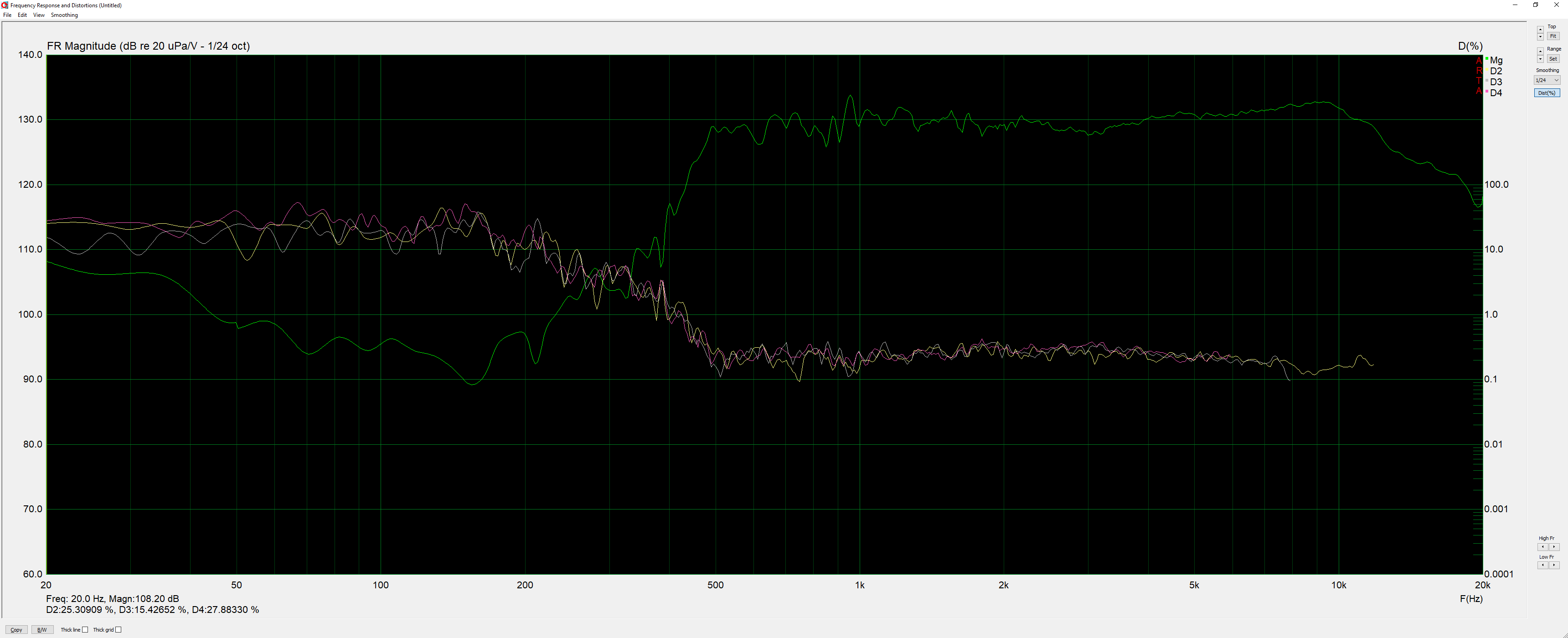

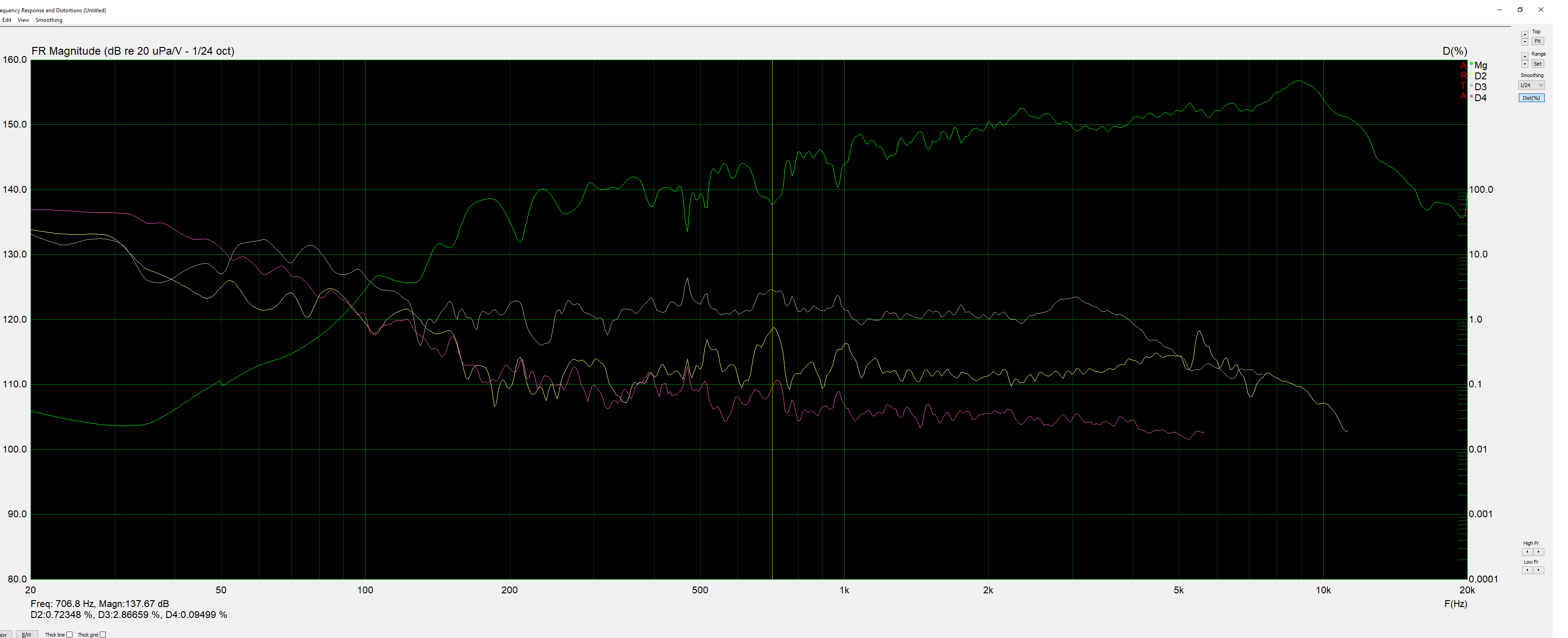

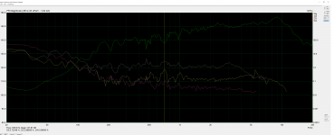

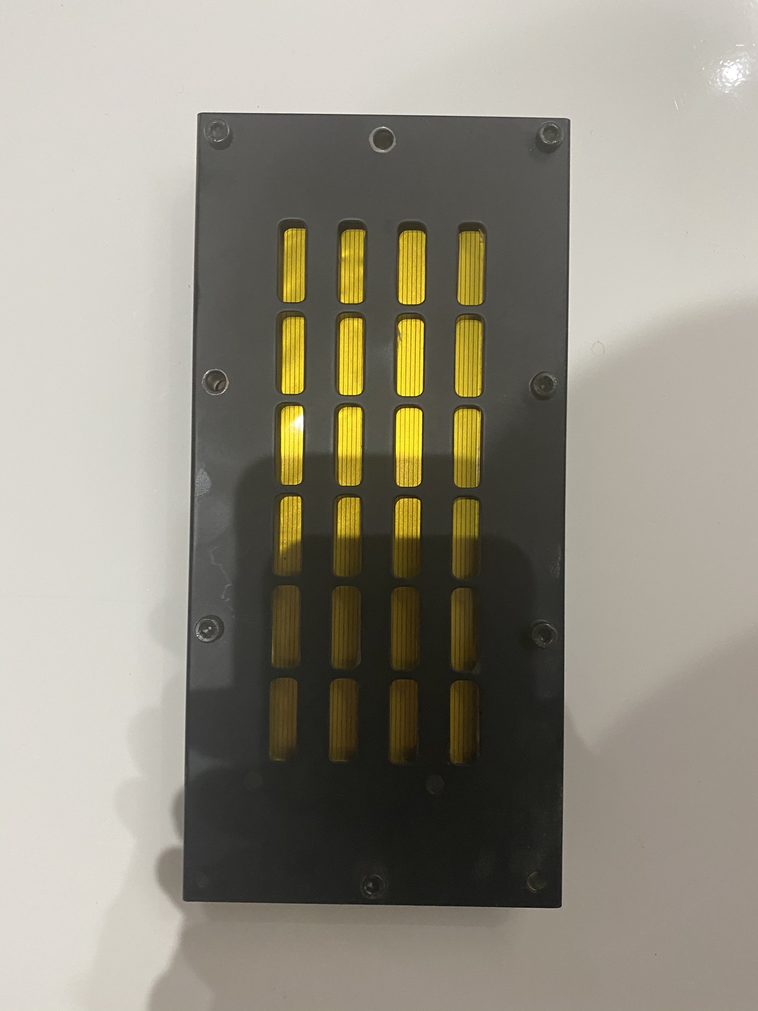

Motivated by this interesting conversion, I remembered myself, that I still have a very old pair of prototypes of the famous Fostex FS21RP in my collection.
The difference between the prototype and the original driver is, that it has no front panel and therefore the width is only 120mm instead of 159mm.
This makes it even more interesting for a true (horizontal) dipole speaker.
So I measured them, just for comparison.
Find the files attached.
I'm somehow shocked in a positiv way. This driver looks much better over a wide range than the Neo10.
So maybe, for the purpose we are discussing here, the better choice.
If the Fostex are not designed to go as low as the planars, that's an advantage that shows up in their FR and HD.
Some fried egg tweeters measure really well too. I once made an array of 9 per side and never before had brass instruments sound as good. And perhaps PE has 9 dome tweeters for the price of one planar with neodymium magnets.
And into the mix of issues is XO point. Really swell to have one driver go from 120 Hz to 3kHz rather than a break in the middle of the music band and requiring endless arguments about crossovers in this forum.
