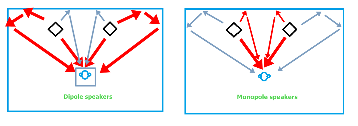

With dipole pattern we get less early sidewall reflections, which are more harmful than late ones. My experience has shown that best placement for dipoles is along the long wall, angledd towards the listener. Most likely that would work best with omnis too. I have omnis at my summer cabin!

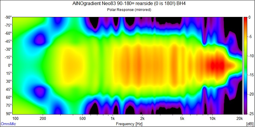

A full-range multiway dipole should have also tweeter range radiating to backside. My first versions had a tweeter with horn, then I added a rearside tilted dome, then Neo3 planar. Yes I could easily hear these differenccies, and measured decay spectrum changed as well (frontside response eq'd same).
That's my understanding too, one of the major advantages of dipoles, to help give the minimum delay of 6ms, Charlie appeared to be saying even that didn't matter to him if they were spectrally the same? It can widen the stereo image maybe?

My general impression of the difference between a dipole and a monopole in relation to the room is that a dipole gives a "they are here" feeling because, I presume, the sound includes the character of my familiar room, whilst a monopole gives more of an "I am there" feeling. I like both, at times, but it tends to depend on the music/recording which I prefer.

Ben, I have done and seen several backside directivity measurements of dipoles and cardioids here at diyaudio! There aren't many of those sad to say, perhaps because in most cases they aren't pretty and smooth...
Keysir went on to design D&D 8c later on 2-way: Waveguide + Cardioid-like
My AINOgradient thread has many published too, here as spectrogram of the whole 4-way system https://www.diyaudio.com/forums/mul...aborative-speaker-project-52.html#post4498866
