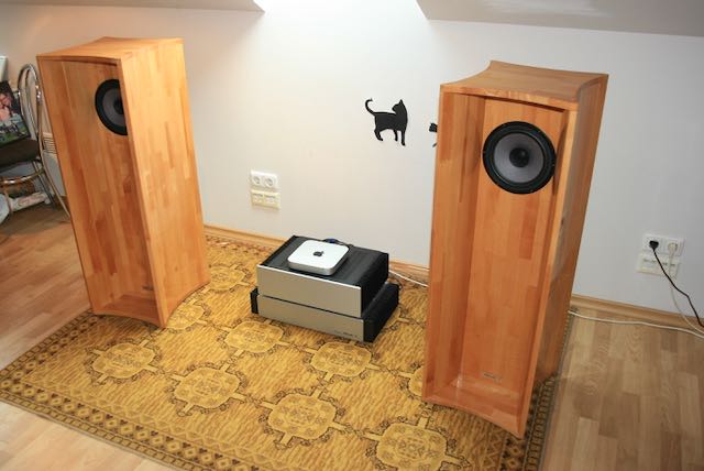

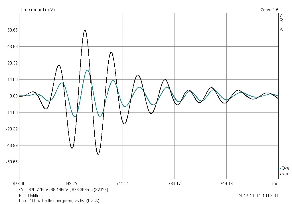

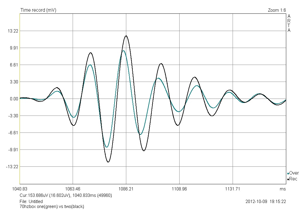

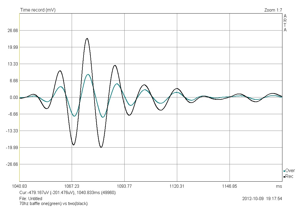

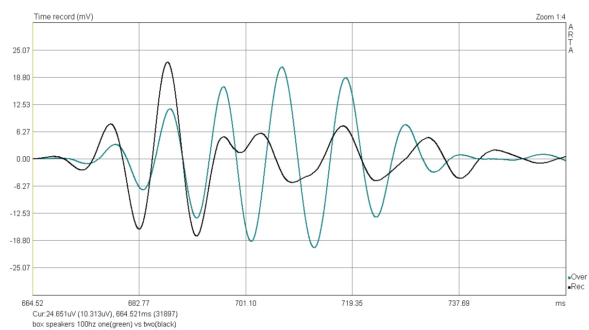

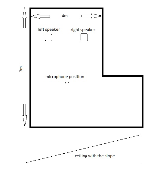

I found my old files almost 10years old. Where i have measured and compared box vs dipole speakers in room. Box speakers where clone of Proac 2.5, and dipole speakers where H frame fullrange design.
It is very interesting to see not only simulations but real measurements . I did sine bursts. I was comparing box vs open baffle in room.They are very different but what surprised me most was the difference how mono sound played through stereo speakers vs only one speaker/box versus baffle. In ideal case we would like to have summed sound twice the amplitude but in reality is just not the case.
Unfortunately i can't remember all details about how measurements were done, but i was surprised when doing measurements so i have checked everything to make sure i make everything correct. So i am pretty sure about what i get. But still can't believe how different waveforms are. Does these measurements makes sense to you? Just wanted to share.
Dipoles sums very nicely when played mono file over stereo pair, but box speakers not so well from the pictures.
