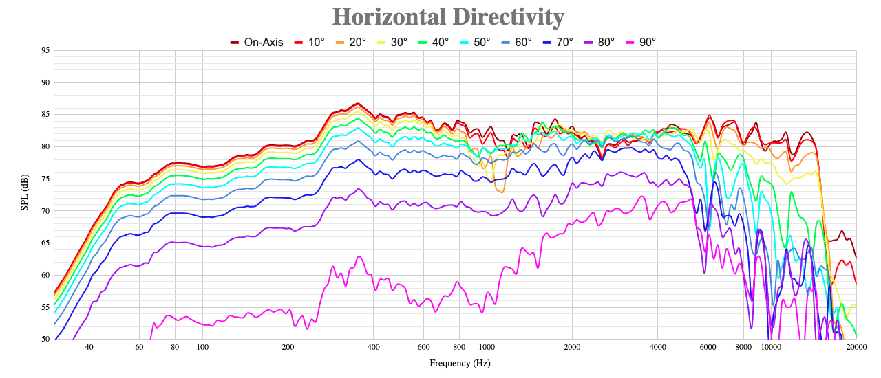

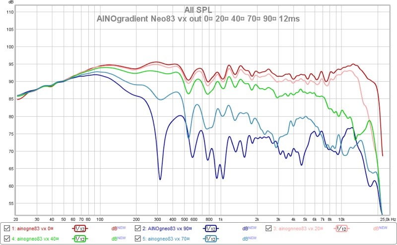

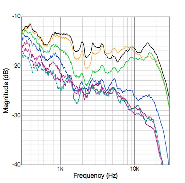

I didn't critizice ML, but panels in general. ML is propably the best, being curved
Sorry, measurements below are from different sources, different methods, but all 0-90deg.
Magnepan SLR by ASR - horizontal https://www.audiosciencereview.com/forum/index.php?threads/magnepan-lrs-speaker-review.16068/
and ML by Stereophile
vs. narrow baffle multiway

+-4db response linearity on-axis and than the same deviation off axis which results in the same dispersion as a 10+ inch cone driver I wouldn't call excellent, not even remotely acceptable imo. If this is excellent for you then what is bad, I cannot imagine it any worse? A pair of Neumann KH120 A, have a response linearity of +-1db and those cost like 600 a piece, so about 20x times less, I would hope that if you spend 20x times as much it gets better not worse, but that may be me...Some advantages are (1) not a box and (2) works with the room to create satisfying orchestral sound.
Odd to find Juhazi criticizing the ML dispersion when his link shows excellent dispersion beyond 45-degrees.
Also absurd comment, I think it is pretty well known here that on and off-axis linearity is a big part of the perceived sound and one cannot just eq direcitivity problems away anyway, even than why buy such an expensive speaker to than have to fix it yourself at home?My music room has only one chair, unfashionable sound absorbing furnishings (like wall to wall carpet with underlayer) and DSP so dispersion (or FR for that matter) isn't a problem for me.
??? By far the number one property of what makes a speaker good audibility wise is frequency response of the on and off axis sound, so I am not sure how you imagined the fact that it is a dipole or panel speaker is going to swamp that huge shortcoming??For sure, the sound quality in other respects swamps the shortcoming of dispersion front or rear.
