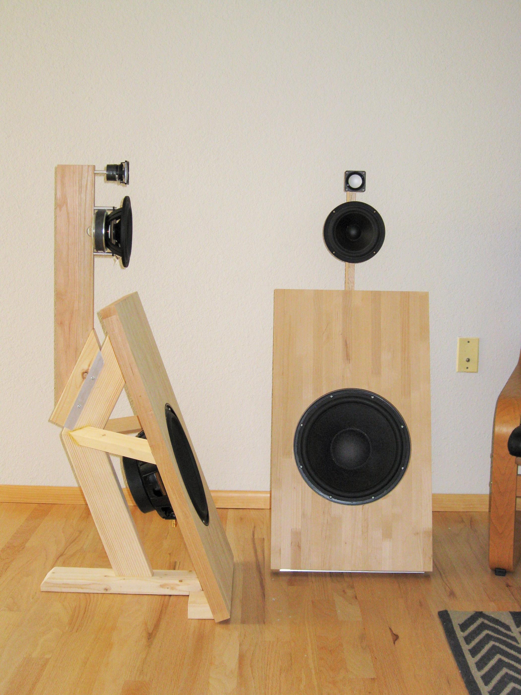

This speaker would likely show some warts under close inspection - there will be increasing directivity around the crossover between the large mid and the tweeter, because of the size of the mid driver for example. The system was more to answer the question of whether I could pull off a nude 3-way system that met my 20-20k dipole goal. It also represents a low-cost design in some respects - I certainly did not use any exotic/expensive drivers. It really was meant to be a sort of a jumping off point for the next iteration of the design. In the next version I am planning to use a planar midrange and tweeter, which I have in hand now, and this should help to improve the performance around 1-2k Hz.
I am simultaneously going to reinvent my system from 2014 (see attached) by drawing on some thing I have learned since that time. I will hang the main baffle and drivers instead of supporting them from the floor, and use the back-to-back dome tweeter in place of the small fullranger. I am pretty optimistic that this will result in some nice improvements all around to the speaker.

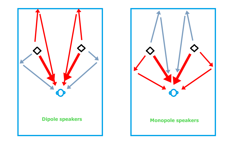

Except both SL and I agreed that they should be toed in slightly:
ORION separation is 8'. They are slightly towed in. The listener is at the apex of an equilateral triangle. Distance to the wall behind the speakers is 4', and to the side walls 2'.

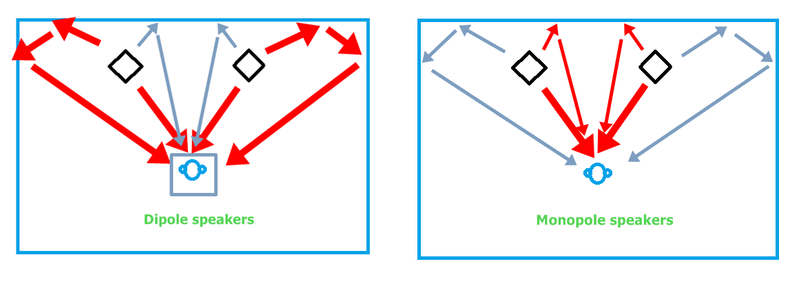

My room is like the smallest one pictured there, but speakers are 7' apart and LP is 5' from them, infact, even more between them I often find preferable. SL also suggested toeing them in so the null is "reflected" to the LP. In a much larger room I can imagine how Charlie suggests could be better.
The reason why I toe-in my dipoles is to get more late reflections and less early ones. This happens best when speakers are on the long wall. I have noticed that many try to dampen the front wall, which will mostly kill the dipole sound IMHO. Diffusing is ok, as well as long distance to FW.

Very interesting thread. What you surmise about the the tweeter is a bit in line with what I attempted to do in my current 3-way dipole as far as final response. I'm still planning on a 4-way setup, but when, I don't know. Like you, I'm going to make my own midrange dipole (if my idea works) and have options for the tweeter, dome or ribbon.My guess about what is happening is this:
At "low" frequencies around 1kHz even with the waveguide the radiation is nearly monopole. So placing two back-to-back creates a dipole. At some frequency the pattern should break down because of the distance between the two domes and the size of the waveguide. Modeled as two monopoles, the response should become replete with nulls and other undesirables. But this doesn't happen, and that was quite surprising. Instead the dipole response pattern just continues all the way up until the top end around 18k or so. I think that the increased directivity from the waveguide causes the front and back radiation to no longer interact, and so you just get a front and rear lobe
I, too, want 20-20K dipole response. My current (first) attempt was to get some experience with dipoles. The woofer dipole is two Peerless 10" drivers in an H-frame. The midrange is a single Scan-Speak 15M/4531 on a rectangular baffle, 7-3/4" wide with the tweeter mounted inline above it. Knowing that the tweeter can't be dipole in this scheme, my goal was to have woofer and mid as true dipoles (horizontally) with the tweeter providing a pseudo-dipole response. That is, the front hemisphere using a monopole tweeter should measure as a true dipole would measure. I selected the Vifa DXT tweeter due to the partial horn loading that provides additional sensitivity at its low end with a faster rolloff and (I hoped) a bit of additional directionality. Eliminating tweeter flare, the usual issue for a monopole tweeter, that also integrated well off-axis with the mid in the crossover was the goal.
The first step was to measure raw off-axis responses of the tweeter. I was surprised to find that the DXT still required significant diffraction control on the baffle, something that shouldn't be a significant problem for a true dipole tweeter, or so I suspect. With that out of the way, on to the crossover.
I had a significant advantage when designing the crossover. I'm using The Ultimate Equalizer (UE) from Bodzio Software. It provides nearly perfect matching of raw driver output to meet the target response, phase as well. I'm using it in linear phase mode. Likewise for the woofer low end extension (correction similar to Linkwitz Transform), so that came later.
My next step was to test the UE system response on-axis for a wide variety of crossovers. By changing the crossover selection and measuring immediately, I confirmed that no matter what I selected, the response on-axis would be exactly what was selected. This was limited to the M/T since the W/M crossover would be 250Hz. But this would validate any crossover work for W/M anyway, giving me full confidence for it as well.
As you've probably read at PETT, I then made a series of measured off-axis summed responses for various crossovers. I eventually settled on doing all crossover design testing at 45 degrees off-axis. This was because I knew that what I selected as a crossover for the on-axis would be perfect, so I only needed to evaluate the off-axis. In one evening I made dozens of crossover tests at 45 degrees until I found the result that gave the best off-axis response. I expected it to be high Fc at low order, but it required low Fc at high order, specifically 1200Hz LR8. Fortunately, with the DXT high sensitivity and 8th order highpass, the tweeter isn't stressed at the listening levels I use, even higher than I find comfortable. The 8th order group delay is moot, since the UE can provide linear phase. I've measured it. The same must hold true for the W/M crossover, 250Hz LR8 as well.
So what I have is something akin to what you observed. The tweeter response off-axis mates well with the midrange rolloff in the off-axis, making the system response in the front hemisphere mimic a true dipole system, 20-20K. It lacks the tweeter response in the back hemisphere, of course, but I don't find that to be any worse than my 3-way monopole system that I've recently re-assembled for testing and comparison, at least with regard to the tweeter section.

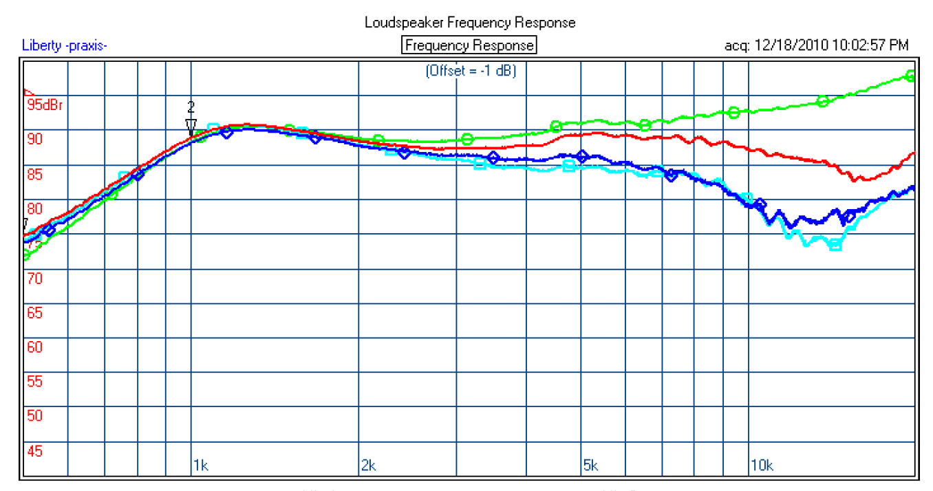

What I found very surprising for my back to back dome-in-waveguide arrangement was the lack of those features, all the way down to 1.5kHz. This allowed me to use the tweeter crossed over very low, under 2kHz. The crossover was something like a high Fc low order one because it also had to flatten the tilt in the response. This sort of crossover provided a lot of attenuation in the lower part of the passband, and the tweeter seemed to be OK like this until you really blasted the level.
Measurement data is posted HERE.

Measuring the rear response of just a single tweeter in your arrangement would help show what's happening in the diffraction response of the tweeter for the rear hemisphere.Hi John,
I recall seeing this back to back dome tweeter design of yours, especially the dipole nulls.
The rather severe offset on the plane of the tweeters has to be having a significant effect.

It is very dependent on the tweeters used. For example, here is the response of my NaO II 3-way top end with rear tweeter on and off. There is no significant dipole effect on axis. very little front radiation from the rear tweeter, as shown.
That seems (to me) very surprising. A 1" dome tweeter should be a monopole at 1kHz, even up to several kHz. In the NaO II I think you were using the OX20, which is only a 3/4" dome however, your top plot shows the rear tweeter down around 16dB as measured in front (green trace). How were these tweeters (the OX20) mounted? Was a small baffle used? I haven't seen a pic of the speakers with the grill screen off showing that detail.
Why do you think the rear tweeter output was not more omni and seen in the front? For example, attached is data I found on the web of the OX20 hanging from a string. It's very omni around 2-3kHz whereas your measurements on the NaO II II do not show that.
Pic Legend: Green = 0deg, Red=45deg, light blue=90deg, blue=180deg.
